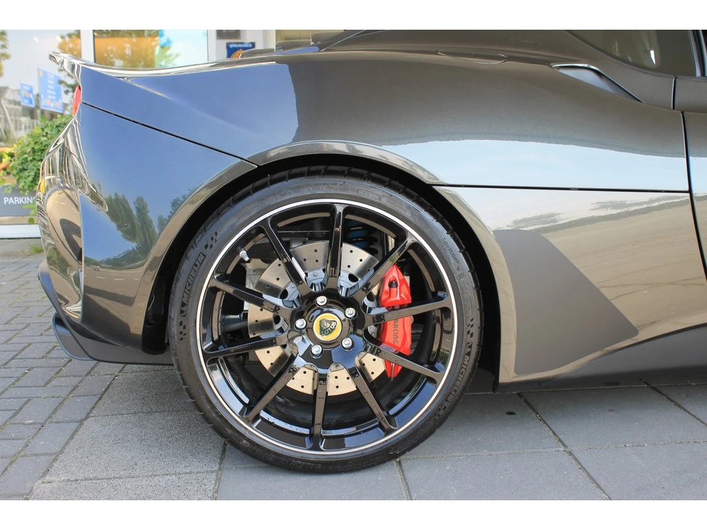

2021.... I purchased a new Evora GT410 Sport. After a couple of hundred miles I changed the OEM pads to EBC Red Stuff to reduce dust on the black shiny rims.
It is an improvement with much lower dust production indeed.
I haven't felt much of a difference on initial bite/travel compared to the OEM.
Now 4.000 mls on the odo, I am happy with them...........
I live in Cont. Europe; you can purchase the pads (without discs etc.) in the UK and Netherlands.
