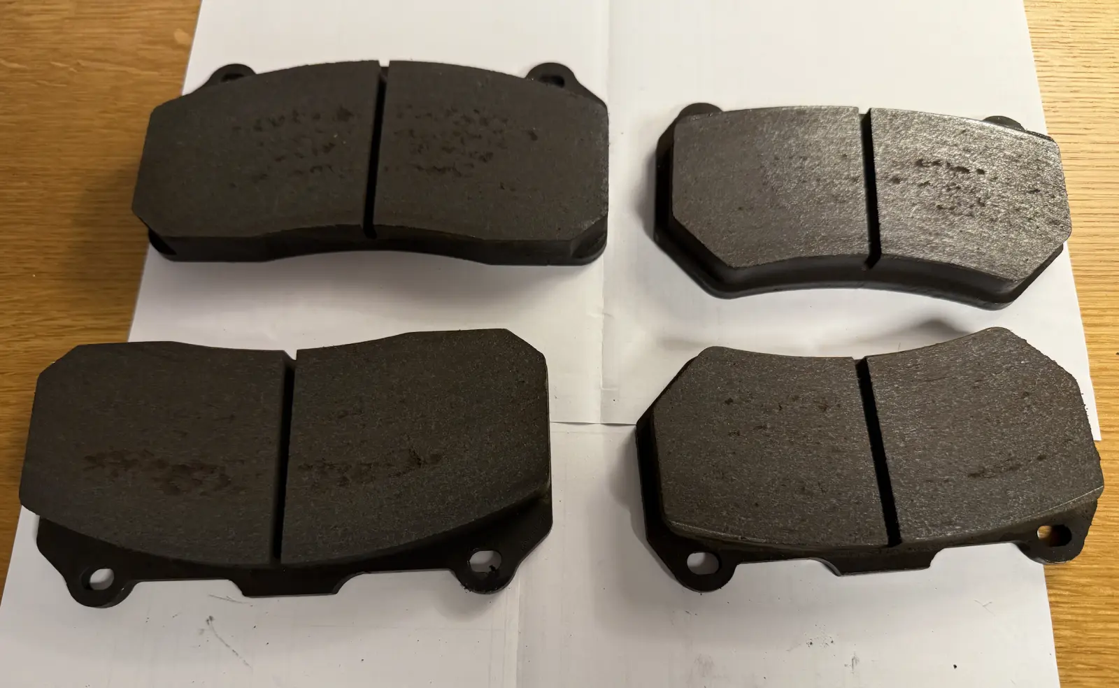

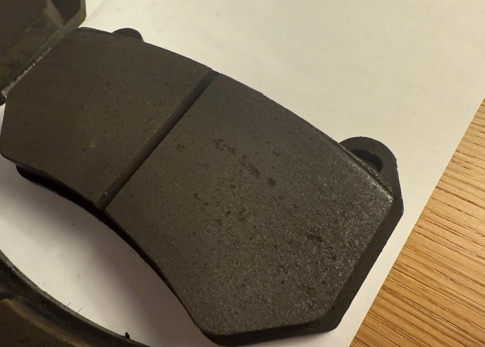

Those are the pads after +-1000km of driving, the rear pads seem to be wearing unevenly on some spots

I’m into my second week on the 910’s and may be swapping them for Red Stuff I still have new in the box. The low speed grabbiness is a bit more than I prefer, and although not a huge deal, dust has turned out to be more pronounced on the fronts than I was expecting (the rears have been great, but I don’t know weather that big a front/rear difference is to be expected). I’ll give it another couple weeks and see. Appreciate the posts on this thread so far.
