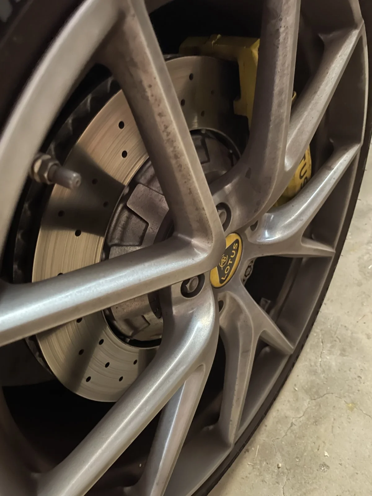

Hi there
The brake dust on these cars is pretty nuts.
Has anyone come up with a solution to this?
Either pads or some sort of treatment I can put on the wheels?
Thanks a ton
Ugh. I pretty much have silver wheels for 2 days and then gunmetal until the next wash.
People are experimenting with low dust brake pads but I haven’t seen anyone come out with a clear solution. Meaning- just a different pad with OEM fit and performance with lower dust.
