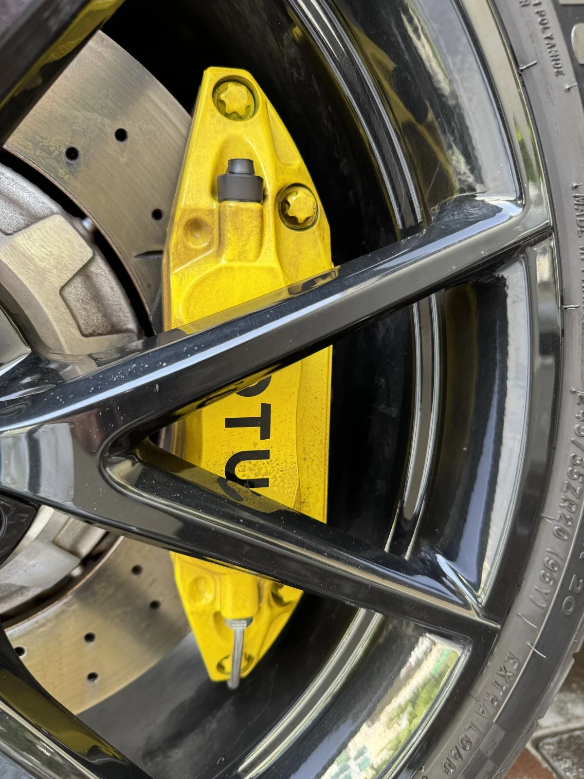

Talking about brake dust and calipers. I struggle to make and keep the callipers (yellow) clean :s, i wash my car myself and have pretty much all the tools available.. i use the (aggressive) wheel cleaner stray and use that also the my callipers… but no way the black stains are going.
Any help for this is much appreciated. Thanks

I have yellow calipers too. I had my wheels & calipers ceramic coated. I washed my car for the 1st time this past weekend after 500 miles. Wheels & calipers came clean with minimal effort. I suggest you have this done. It will save you a lot of elbow grease.

Thanks! Will do ceramic in the wheels and callipers
I ceramic coated my wheels and calipers and it's certainly easy to clean them, but the issue is that within 10 miles of driving, there's a layer of brake dust. The calipers stay clean, but the wheels are perpetually "dirty" as soon as any driving is involved. I am afraid the only solution is to go with low dust pads, or at least different pads where the dust isn't as tenacious when grabbing onto wheels.

I would be careful with aggressive and harsh cleaners. Don't let them dry, especially baking in the sun. If the black stains are already etched on the yellow paint, your only option may be to lightly polish them to get rid of them, or at least lighten them significantly. Then ceramic coat your wheels and ONLY USE MILD SOAP AND WATER to wash your wheels and calipers. There is no reason to use aggressive chemicals to wash wheels.

Thanks.. im afraid that the aggressive cleaner has already etched the paint :( because nothing removes it

You can try a cleaner wax or light polish. Don't use anything motorised or powered. Just polish with your hands. It should brighten up significantly. The caliper is not clear coated so it is only high temp enamel that's protecting it. Aggressive cleaners may soften the paint and allow dirt to embed, which is what you see. Once you polish it, clean it off and ceramic coat it. You should be good to go after that.

Thanks for the help, much appreciated! Will do that right away
I apply Sonax to wheels and calipers before washing the car (in the shade) and thoroughly, THOROUGHLY rinse the sonax off once the color change subsides. Then foam cannon the car and wheels. Wheels and calipers then get a microfiber wipe down. Cleans them up nicely.

Being a Mobile detailer, You definitely don’t want not to regularly use an aggressive wheel cleaner each time you wash them. Just a good car soap would be fine. An aggressive wheel cleaner is for wheels with caked on brake dust that’s been neglected.
Here’s what I’d try. Least aggressive to most.
1. I’d first try using a good non acidic wheel cleaner, I’d recommend Mag wheel cleaner and dilute it to your liking, it’s a dark green liquid, then use a Detail brush to agitate the surface (in the shade) rinse off completely.
2. Spray some soap and water and use a medium clay bar to see if it’ll remove it.
3. Try a little bit of polish on a light polishing pad, polish by hand. This should be the best way to remove it.
4. (Most aggressive)
If it’s Still there, (in the shade with gloves on) spray an iron remover on it, let it sit for a few seconds, and agitate it for no longer than(20sec -30 sec), then rinse it off completely as it’s very very acidic. It’ll turn a dark purple if it’s removing iron.
it’s still there, you might need to get it painted. But being a new car it shouldn’t be.
Just do the less aggressive options first.

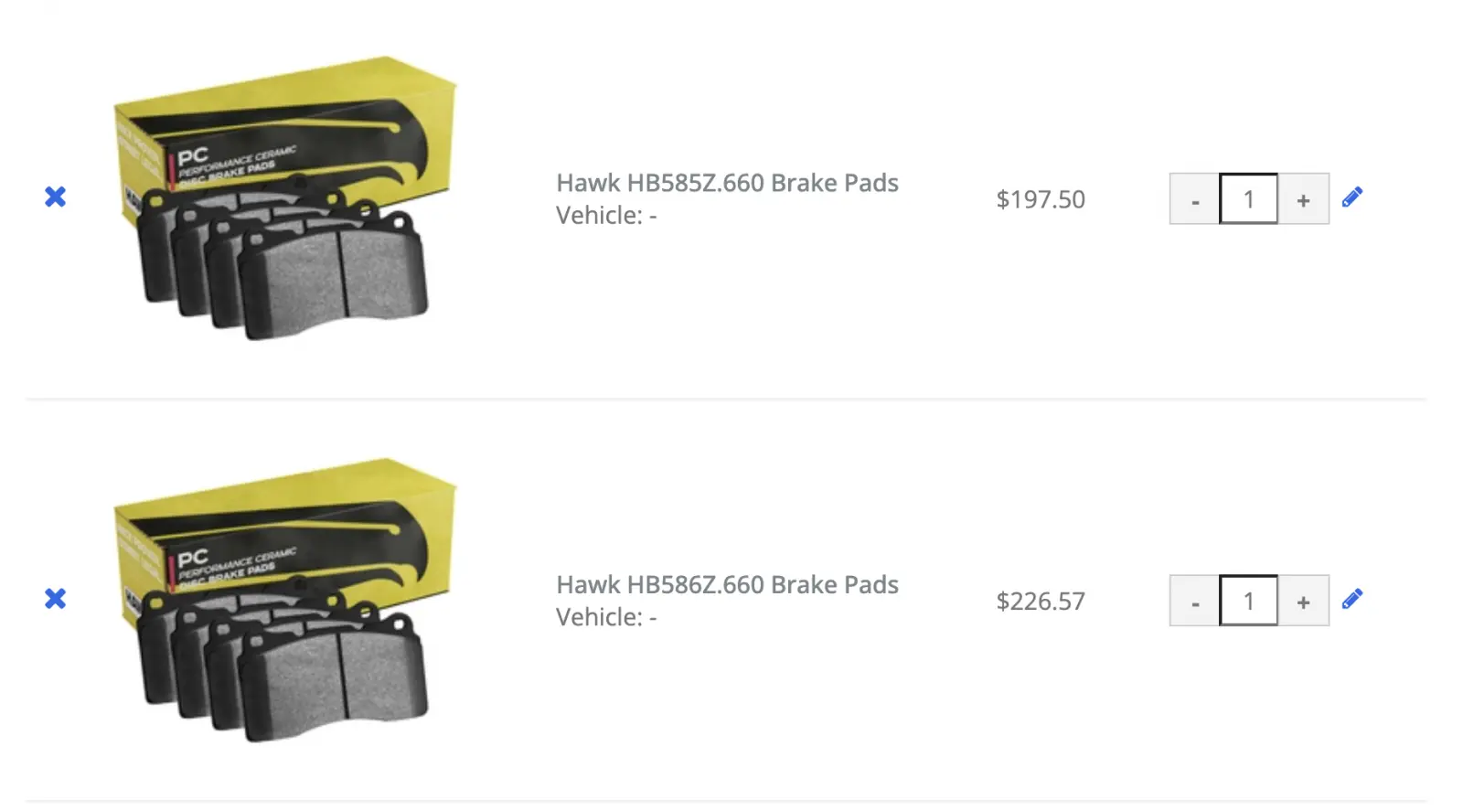

I've ALWAYS liked hawk brake pads. And the dust on the OEM Emira pads is awful. After A LOT of reading spec sheets, finding out AP Racing Caliper numbers and double checking the size specs, I found both front and rear Hawk Ceramic pad sizes. I ordered a set and will install later this week after they arrive. I'll report back to verify fitment. Also this link helped immensely with researching and contains some good info on brake rotor and pad options for the Emira, which uses the same brakes as the Evora GT. However it shows same pad size F/R which can work but the larger pad for the front should fit the AP Racing CP-6600 Caliper family that's used on the Evora and Emira.
https://www.brakes-shop.com/car/lot...2009-2021/evora-gt-3-5-supercharged-2017-2021
