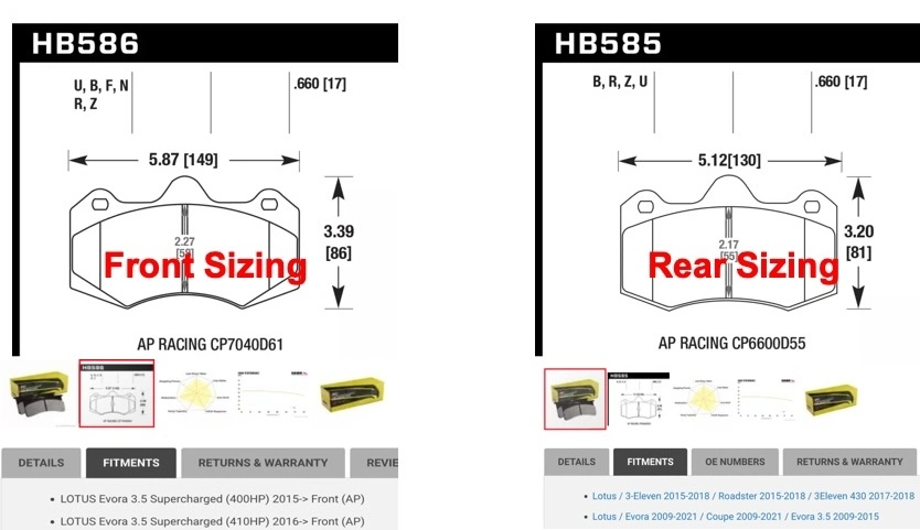

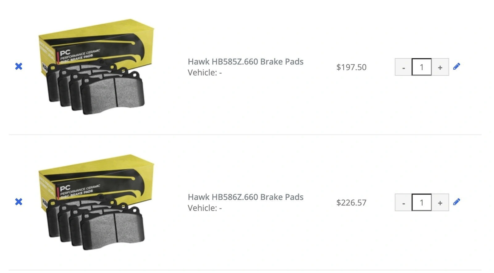

They F/R "can" fit the same pads with the fronts smaller. But the fronts can / should be able to accomodate a pad that's larger. 149 x 86 x 17mm front and 130 x 81 x 17mm Rear. This is what my research says...I've ordered a F/R set and will install to verify later this week.

Both front and rear are AP Racing 4 piston calipers but they are slightly different sizes. Fronts take a AP Racing CP7040 compatible pad and the Rears take a AP Racing 6600 compatible pad

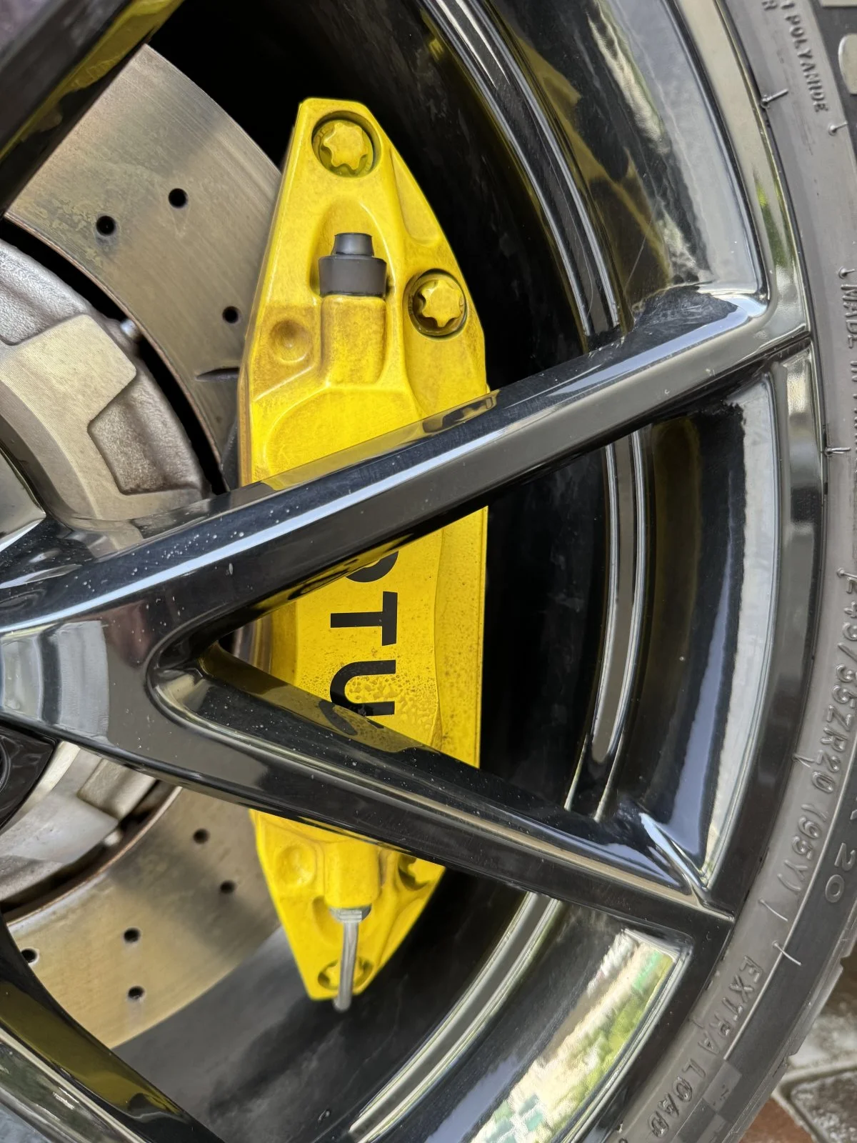

Talking about brake dust and calipers. I struggle to make and keep the callipers (yellow) clean :s, i wash my car myself and have pretty much all the tools available.. i use the (aggressive) wheel cleaner stray and use that also the my callipers… but no way the black stains are going.
Any help for this is much appreciated. ThanksView attachment 45029
I also have yellow calipers on my Emira and I found them impossible to clean with normal wash in spite of them being ceramic coated. I purchased Magic Finish Wheel Cleaner from Amazon ($11.99) and that did the job for me except for around the caliper bolts. Here are before and after pics.
