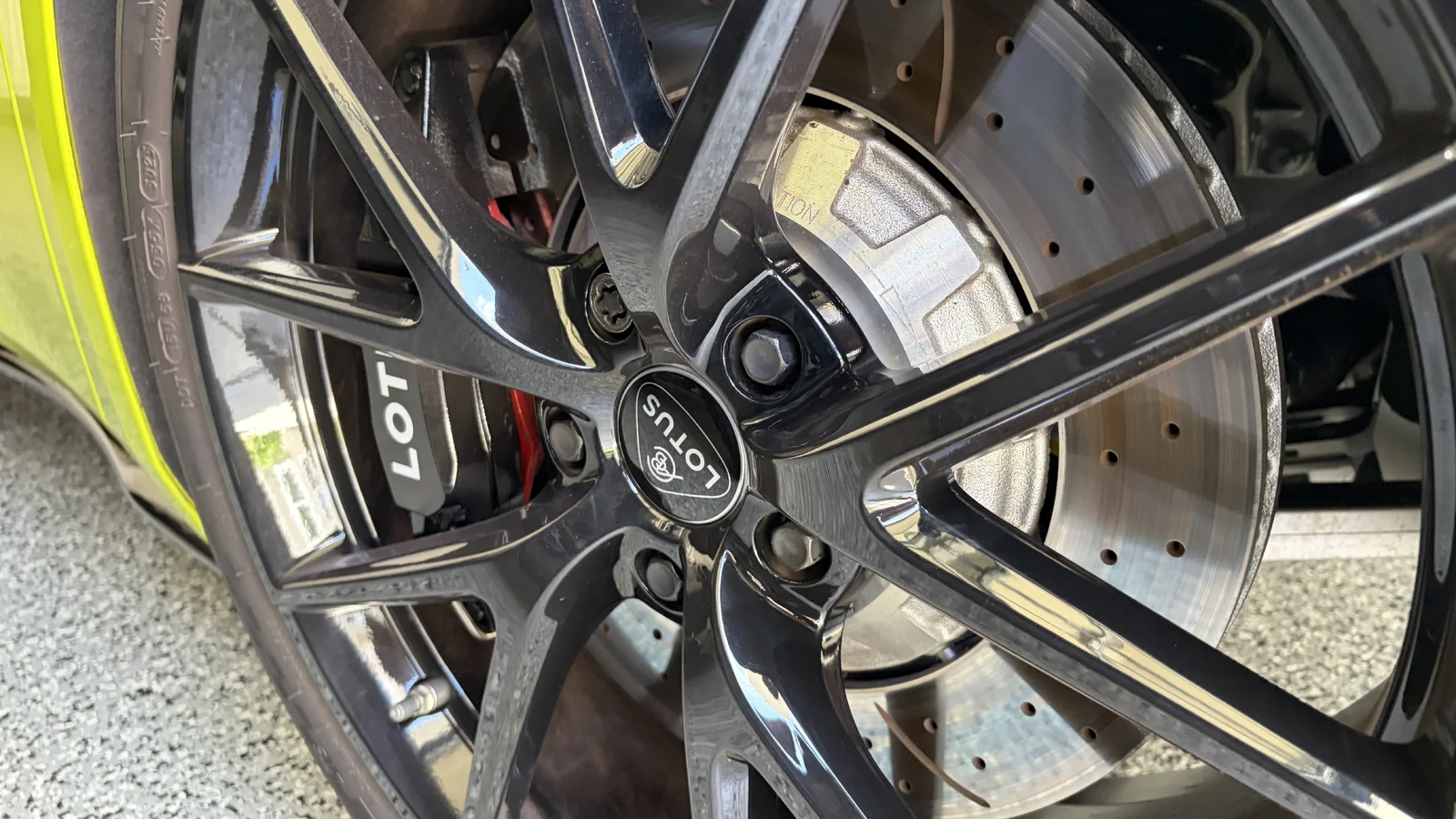

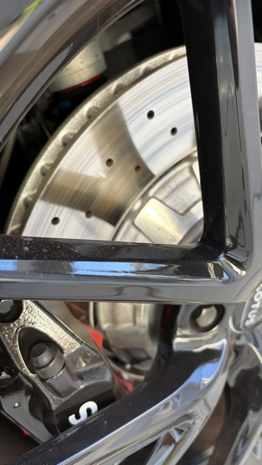

Here's what the wheels and the rotors looked like after a 75 mile drive. It was spirited at times, but not any really hard braking, but didn't expect this much dust an squeal. Mind you, I shined up the wheel barrels when I swapped the pads so they were clean before this drive...I'm hoping all that dust is that pink coating on the reds burnishing off. Even the rotors have some interesting colors.
Mine looked worse than yours. The dust will continue to minimize, but will never fully go away; the noise will go away.
Do these rotors looked glazed to the experts on here? I just want to omit any other issues that could be happening as the red stuff bed in, and maybe thats why mine squeal and others haven't...I might just be overthink it though guys.

So I have an update too. I also want to thank Kitkat, Tracked Emira and Greg at GRP for talking me through my rotor situation. When I sent them pics, they all said rotors looked fine and normal. So Yukoncole is right in that I should just be patient and they will bed in and squealing should go away. My biggest worry however was if my rotors were glazed...problem solved.
  • @Yukoncole kept saying I need more miles and things would be fine. Fair.
  • @kitkat mentioned that if I continue to have issues to swap back to OEM pads and with some normal use (not even bedding in) it would even the rotors out over a couple hundred miles to clear off any pad transfer. Again, rotors looked fine. So I was going to heed these instructions if squealing didn't go away.
  • @Tracked Emira mentioned that I may need more miles for bedding but if problem didn't go away to upgrade up one next level in pads from Ferodo, but they would slightly squeak and dust a little more because you have a more aggressive pad. Again, rotors looked fine.
  • @GRP said that he always beds them regardless, even though EBC says you don't need to. I had done a few 50-20 stops but clearly the squealing was there. He said it wouldn't hurt to try bedding them in even harder again. He gave me clear instructions to bed them while removing any pad transfer from the Red stuff.
    • So he told me to do 3x 50-5mph hard stops
    • Then 2-3x 80-5 hard stops -- like really hard, like ABS engaged hard, mashing on the pedal. Then drive for about 5-10 minutes and let them cool --with as few or no stops as possible.
So yesterday, I did just what Greg told me to do and if that didn't work, I was going to do what Kitkat told me to do (swap back to OEM pads to scrub the rotors again)...and if that didn't work, then do what Tracked Emira said, which was to get new pads...and if THAT didn't work, I was going to order new rotors and maybe just upgrade to Rotoras or Girodiscs at that point.
Well, what Greg told me to do worked perfectly...I mean I mashed the crap out of them and then drove around town for like 20 mins to cool them down and there was no squealing. Went to lunch so car was parked for about 20-25 mins...got back in and no more squeals all the way home. So it seems as of right now, that worked and they are bedded in. Time will tell. I will try to get out today and drive around and see if the squealing returns. If it does, I plan on doing what Yukoncole originally said and that is to keep driving and eventually all will be well.
I'm just sharing my experience and the help I received from others on here in hopes of helping others make their decisions and bed them per the instructions above. I'll keep y'all posted. If Hawks come back in stock, maybe I swap to those per Kitkat's recco, but my biggest concern was whether my rotors were screwed...

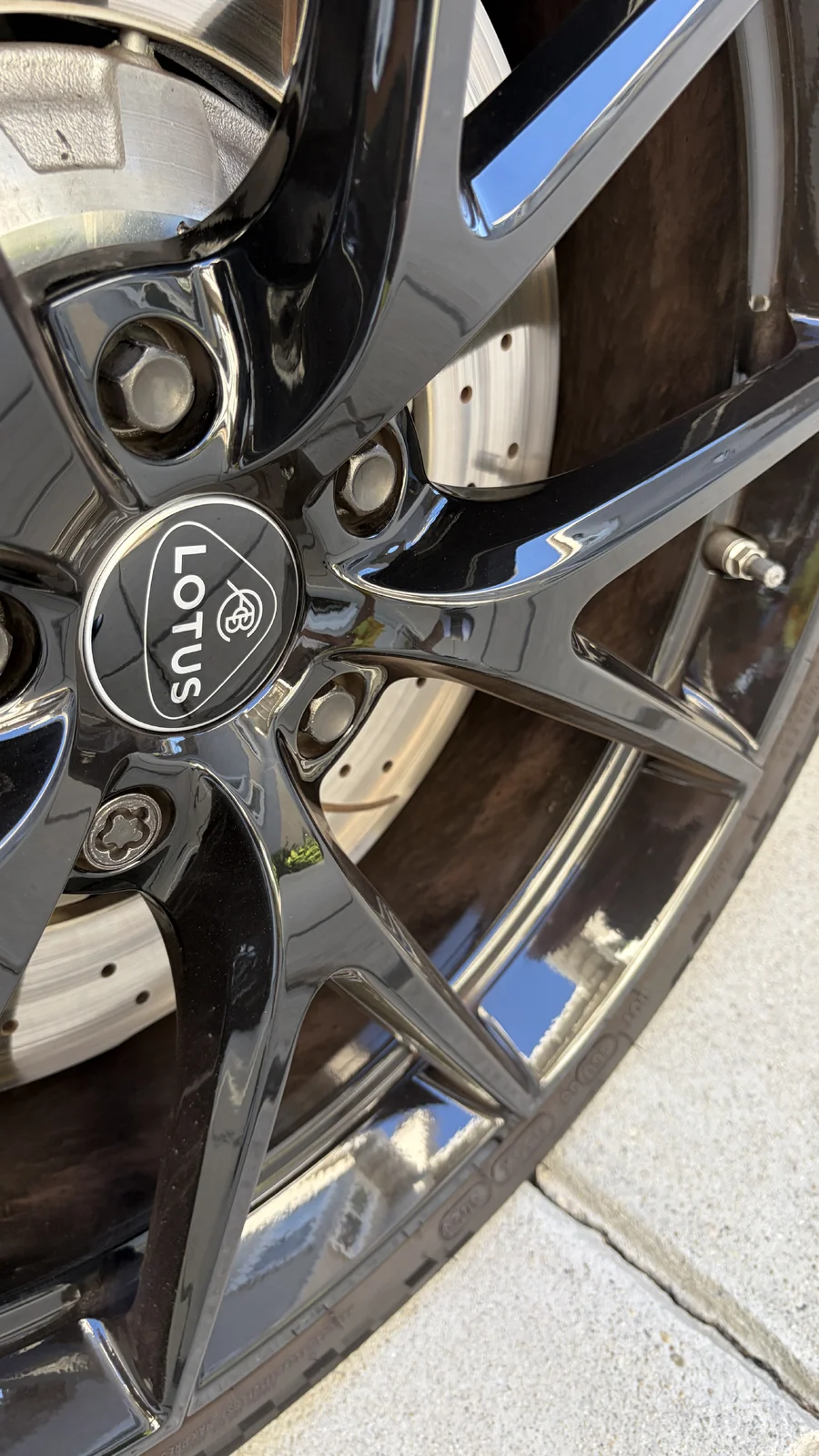

Another update...just went for another 6 mile drive to see if squeals returned. Happy to report, ZERO squeals and the brake dust was non-existent!
Greg's bedding process worked for the EBCs!
