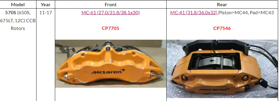

Hmm, I was under the impression the front Emira brake rotor was just 370mm, which is smaller than either the front or rear on the 570s.
370x34/350x32 with 4/4 pot calipers is for the iron version, whilst the ccb version is 394x36/380x34 with 6/4 pot calipers.
See this caliper rebuild matrix for a better understanding between ccb and iron setup:
Pending further verification, I suspect Emira has the same caliper & pad as 570S' Iron Version which can be quickly confirmed as soon as we can put out hands on the vehicle.
Don't know if anyone noticed the subtle difference in the brake pad applications.
The front iron pad is actually same (size) as the rear ccb pad.
This is due to ccb rotors are lighter in weight than iron so for the same brake work they will result higher braking temperature so the ccb rotors and pads should be larger in volume than iron rotors to deal with the same amount of heat.
For those who are considering ccb conversion upgrade, we would recommend upgrading a larger 6 pot caliper with larger pads in order to have a successful and satisfactory ccb setup.
