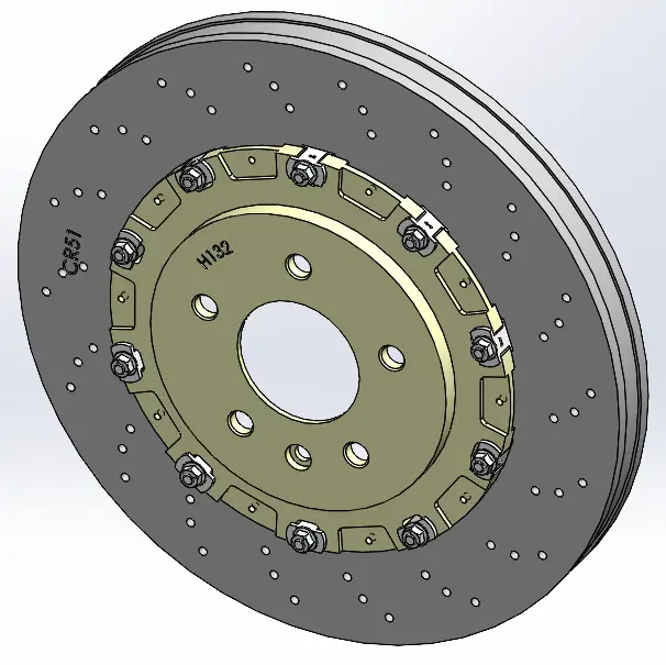

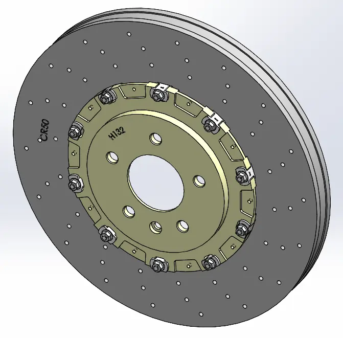

Carbon ceramic rotors design is up.
Front: 380x32mm
Rear: 350x32mm

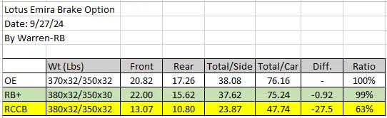

Wt comparison table including ccb.
Airen told me you folks are more adaptive to an alternative setup than other communities (eg. MB, Audi) where the stock replacement must be made "exactly" like OE.
So after more thoughts and tuned-in bench fitment tests (Airen can witness the setup), we decided to offer only RB+ rotor kit in which the front rotor diameter is increased to 380 (from 370), and the rear rotor thickness is reduced to 30mm (from 32) - Easier for you to choose and less components for us.
This proposed RB+ kit would be an upgrade setup to optimize your overall brake performance, more than just a replacement and to better justify your investment.

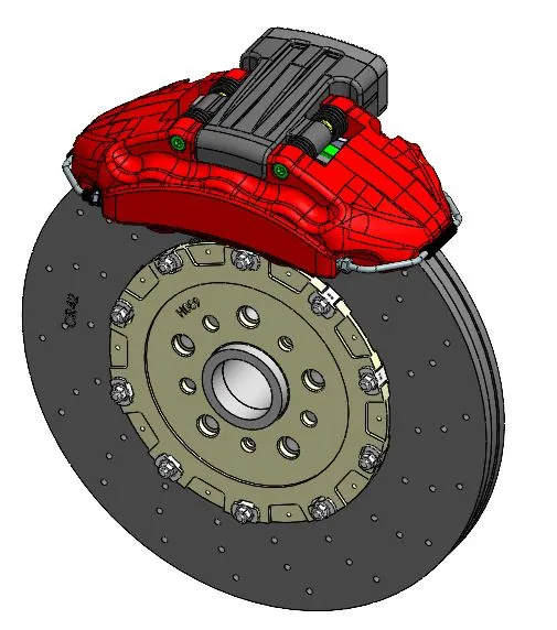

For the retrofit ccb rotor kit we offer ST600 compound brake pads for street/spirited driving which is what this rotor kit is made for.
For track racing we have just finished up a full track kit design which use our 6/4 pot track duty calipers, having the same rotor size as Porsche 991 GT3 pccb (410/390), and the same brake pads as for Corvette ZR1, Ferrari F458, Camaro Z28. This is our flagship kit we offer for GTR, GT350, GT500, Porsche, McLaren, Viper, Corvette, Camaro etc. over the years with a very satisfactory result.
For the same amount of brake work, ccb braking temperature will be higher due to it's lighter weight but it also can resist much higher temperature w/o warping and cracking like iron so as long as you use the proper brake pads, watch the braking temperature, no extra care or additional cooling is required.
For 18" wheels you can only run 350mm rotors - Like Porsche 996/997.1 but it's too small for tracking that resulted a lasting negative impression on ccb for tracking.
Our design/offer is based on what the stock 20" wheel can accommodate; either retaining stock caliper which is a 380/350, or a system kit with 410/390.
With a correct understanding & knowledge how to select the right setup and components you will be joining thousands of enthusiasts, no matter for street or tracks, to enjoy the benefits of ccb brake, especially for track racing not only a worry-free, confidence inspiring but also can save you tons of money and down time in replacement on iron brake.
Just a note - BBK rotor size are tentative pending to final wheel fitment test especially for the rear involving a parking brake which may possibly be 400mm (25mm increase is the minimum for bolt space) or stay at 350mm w/o oversizing.
Or an integrated ePB which we are building a rear bbk for the Cybertruck.
