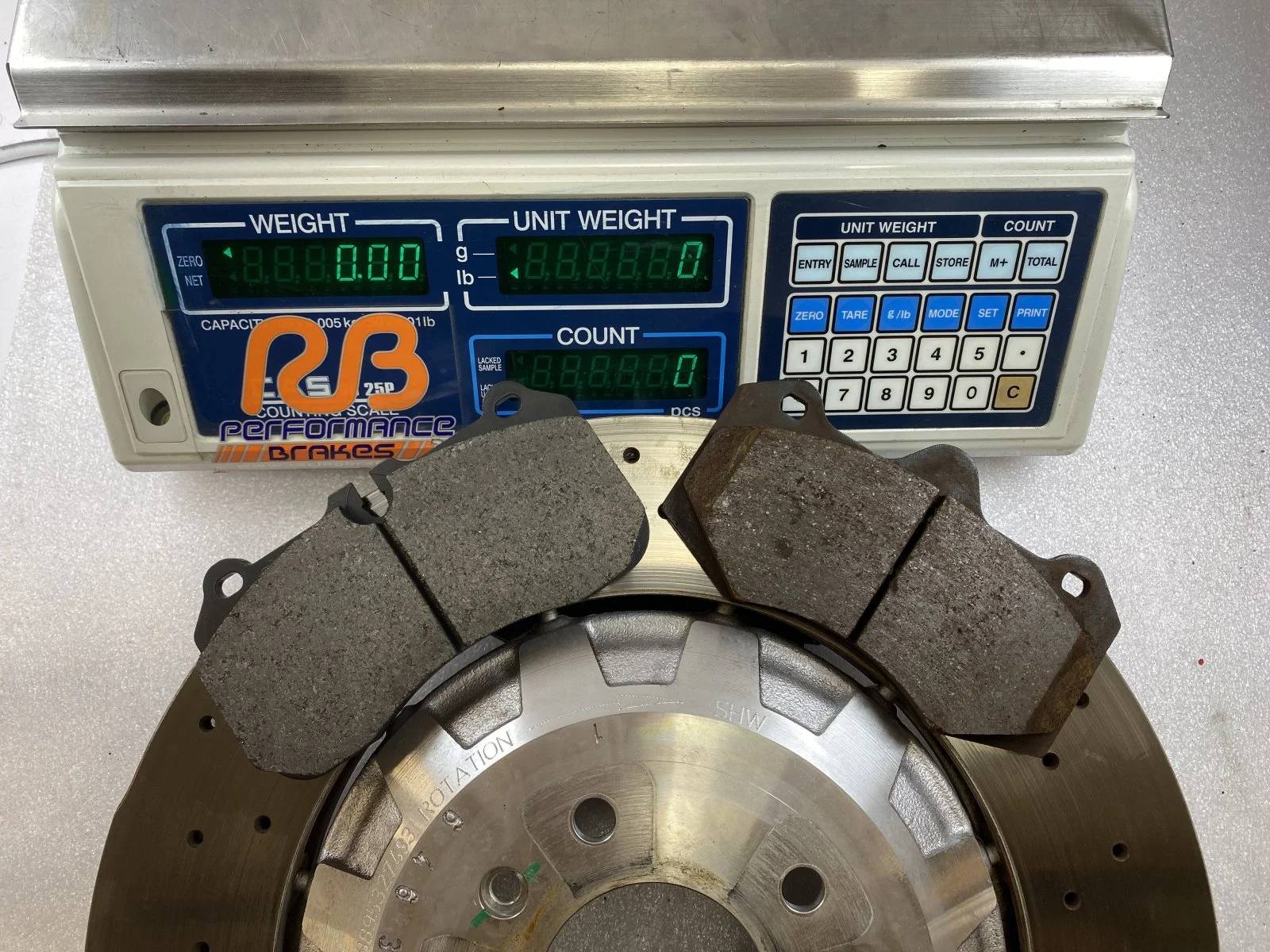

Just as a point of clarification, you're saying that your upgraded front pad in the different shape (as shown on the left of this photo) will fit the location of the original pad (pictured on the right) with the original caliper and rotors? So it's a factory compatible pad with increased pad area?
Excellent. Is the rear set similar in area increase?

Rear is a lining based on D1346 for Nissan/Infiniti Sport 08-13 front.
  • FMSI Lining # 8457
  • Width (Depth): 54.6mm
  • Thickness: 15.9mm (Made ro 16.8 per AP caliper specs).
  • Length: 122.7mm
