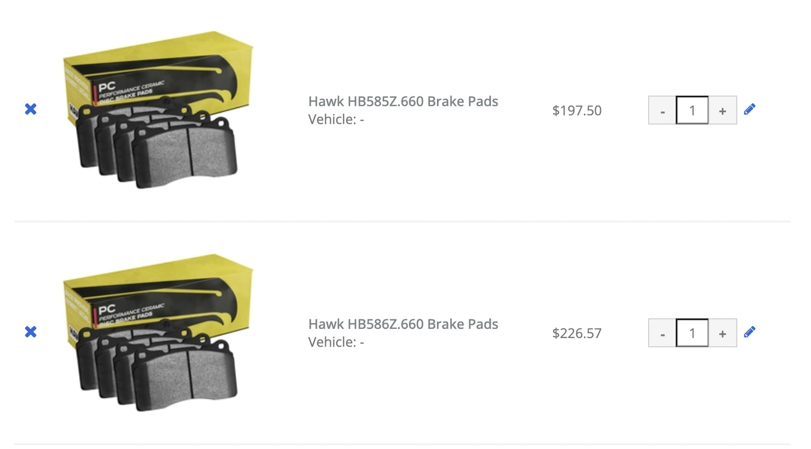

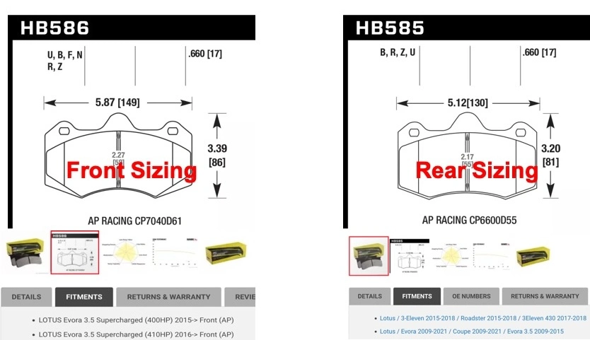

Hawk Ceramic Pads are super low dust. I can confirm the rears fit and I'm waiting on the fronts to install. But they are specific sizes for the AP Racing Calipers that the Emira has, so I'm confident the fronts will also fit but I'll report back. Here are the Hawk Part #'s. 585's in the rear 586's in the front
Hawk Ceramic Pads are super low dust. I can confirm the rears fit and I'm waiting on the fronts to install. But they are specific sizes for the AP Racing Calipers that the Emira has, so I'm confident the fronts will also fit but I'll report back. Here are the Hawk Part #'s. 585's in the rear 586's in the frontView attachment 59054

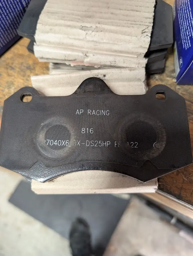

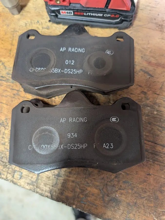

The Hawks are Identical to the OEM pad in all dimensions. In fact Hawk specifically states the pads are for AP Racing Caliper AP RACING CP7040D61 (Front) and AP RACING CP6600D55 (Rear).

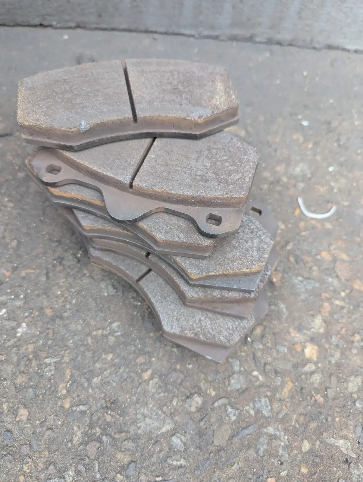

Swapped to RB XT970 pads and Motul RBF660 today. These are the stock pads after 4k kms and 1 trackday
RB pads are bit less dusty than stock pads (wheels are ceramic coated) but squeaks a lot under low speed braking when cold (street driving) despite having followed the recommended break-in process from RB. Will see how they perform on the track next month.

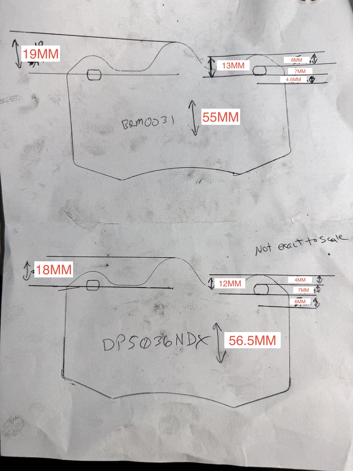

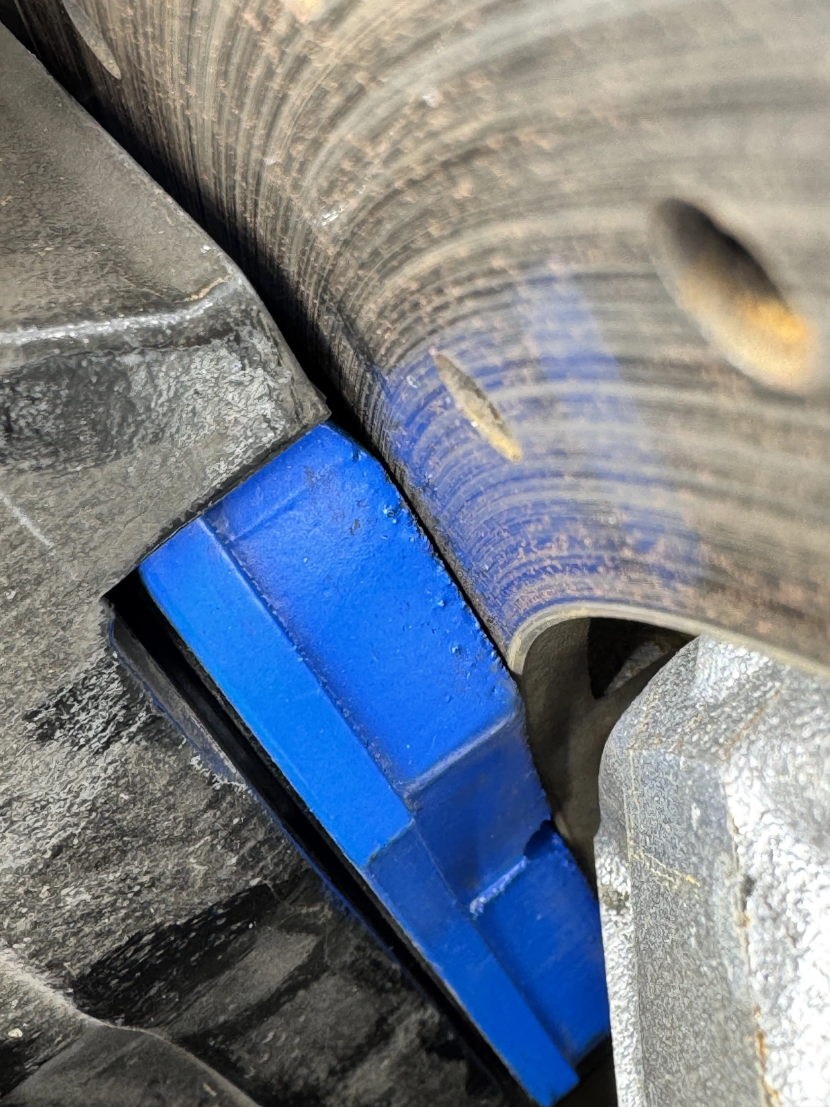

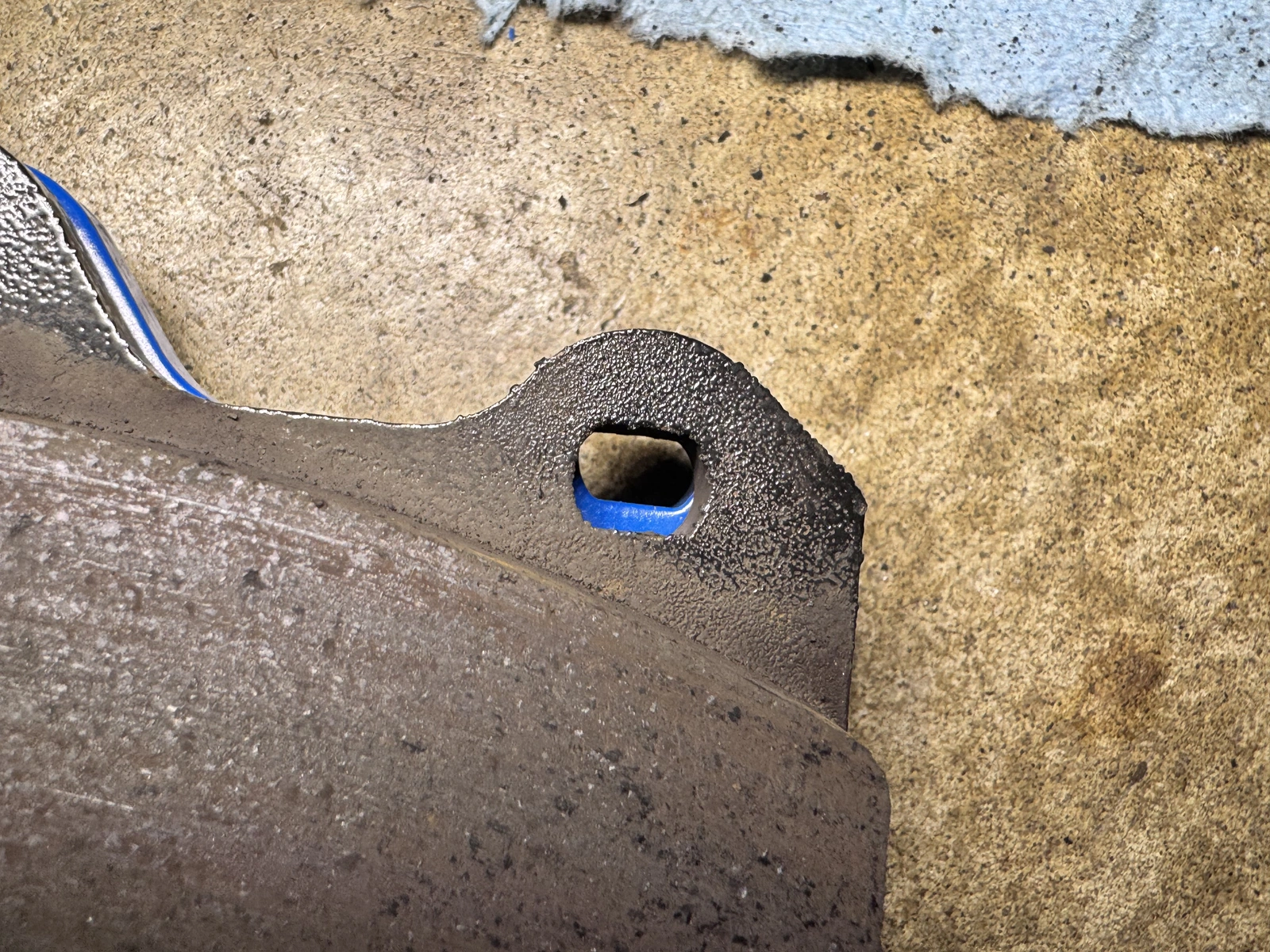

I started to install a set of EBC Blue pads (for light track use) and planned to order some EBC Reds for street. The front pads fit perfectly, but the rear pads don't fully sit on the brake rotor. After talking with EBC and taking measurements, they still believe it is the right pad, but I'm curious for others who have installed aftermarket rear pads, if their experiences are the same.
The inner diameter of the rotor is where pad that hangs off by around 1mm.
The reason for this is because the holes for the caliper pins are ~1-1.5mm offset compared with the OEM pads. The tension on the metal spring clip is also less than OEM partially due to this offset.
Lastly, the EBC pad has a slightly larger pad surface towards the outer diameter of the rotor. This actually accounts for the 1mm offset of the caliper pins and keeps the pad sitting mostly in the same space as the OEM pads did - at least on the outer edges of the rotor.
At the end of the day I think I'll still try to run these pads as I don't think they'll create a lip on the rotor, but how it might cut unevenly into the pad will be interesting to observe.

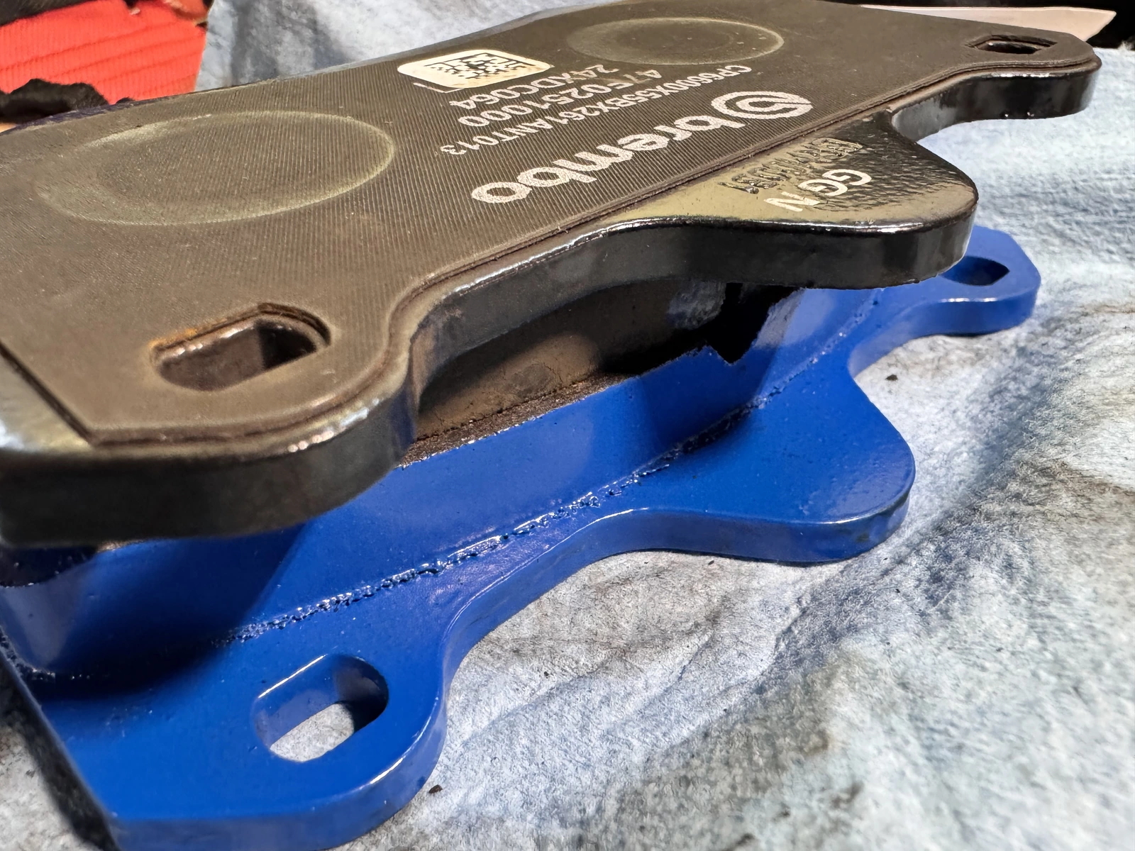

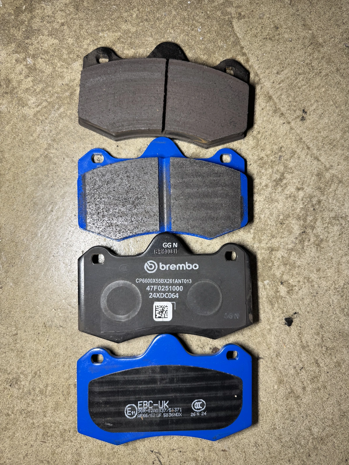

Here's measurements I took between the OEM Brembo pad (top) and the EBC Blue pad (bottom).
If there's insights anyone can offer about their experience and how their pads sit on their rear rotors, that'd be helpful to me. Cheers!

Thank you. A different Emira owner confirmed the EBC pad is sitting off the inner radius of the rotor face. Separately another Emira owner with EBC red pads showed that there is a lip forming on the inner radius portion of the pad (which is sitting off of the rotor face). Someone else mentioned to me that this was the case on the Evoras as well but the lip tends to break off over time and not be an actual issue. Having less tension on the metal clip and the pins is kind of my only unknown (and perhaps overly OCD) remaining concern.

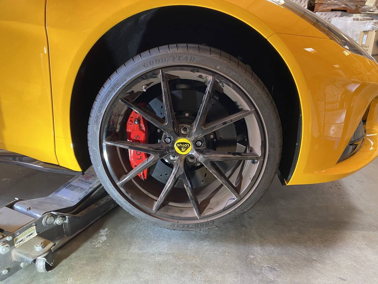

Received my set of PFC 15/08 compounds for the Emira and the backing plates are identical to the OEM pads, front and rear. Does not have the offset in the rear like EBC.

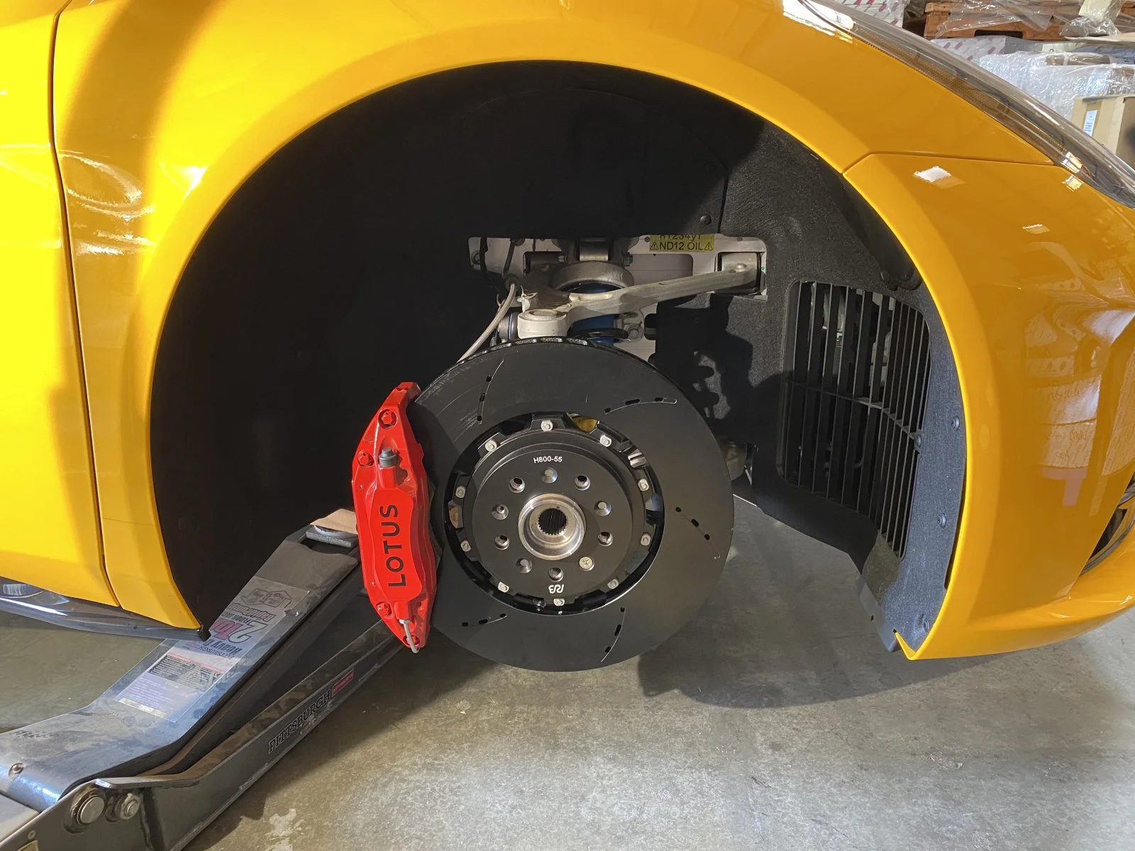

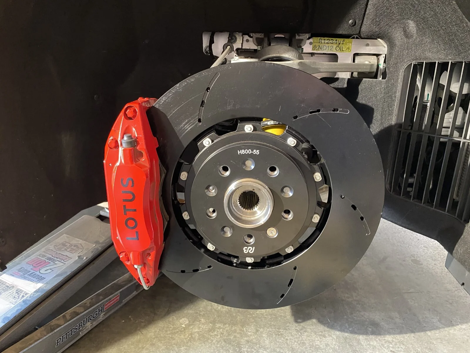

And here are a few pictures of the 380mm rotor and pads on the car.
That is only about 250 miles of brake dust from the OEM brakes. Insane.
Just wondering what your impressions are of the RB iron rotors? Any fitment/clearance issues due to the spacer? Debating between RB and Girodisc since they cost the same. RB has the advantage of having a large rotor (may improve performance) but Girodisc has a larger user base
