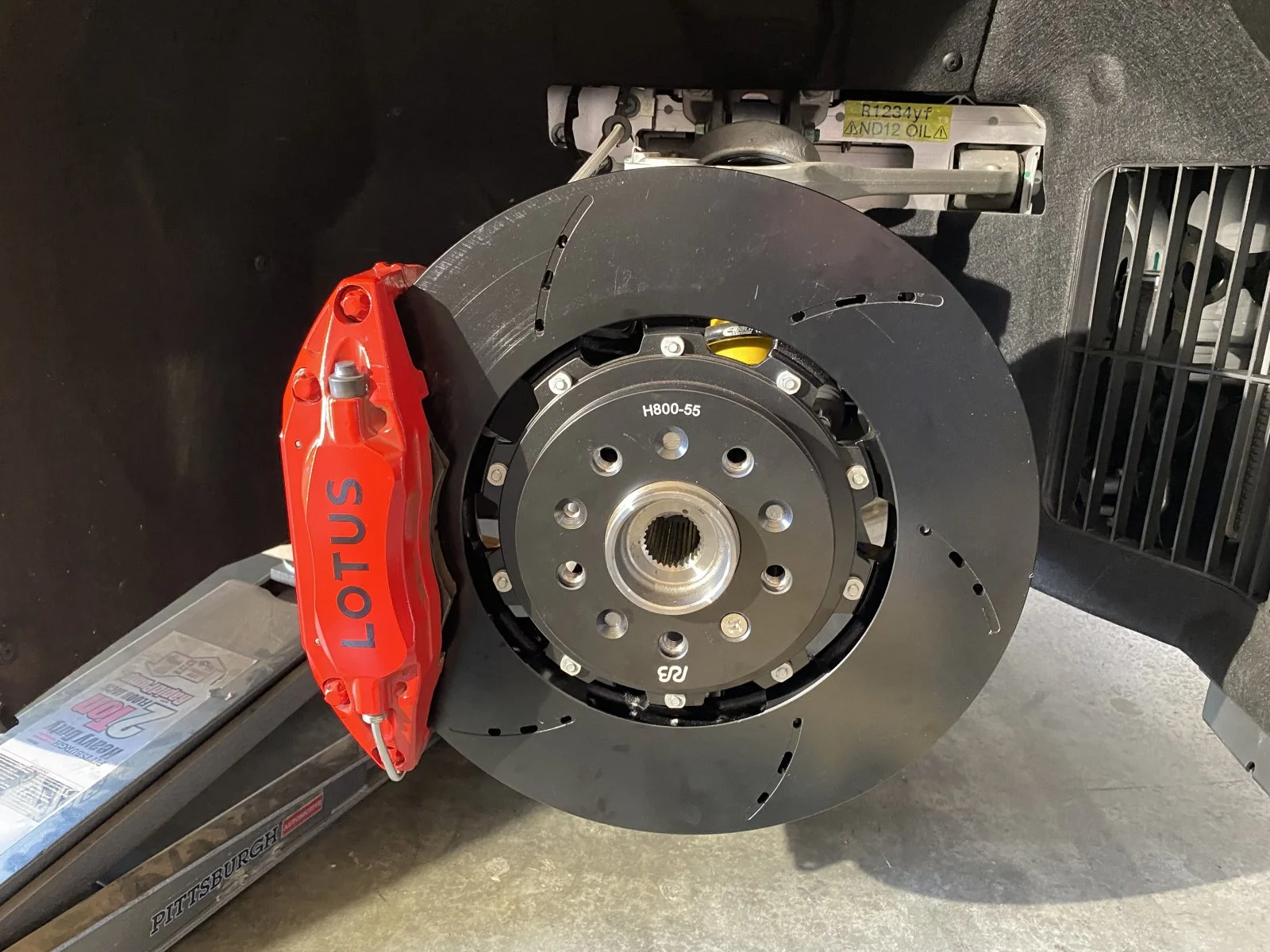

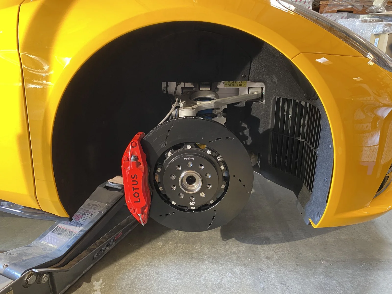

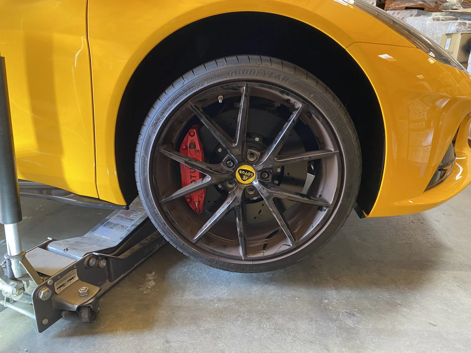

Yes in fact they are made for Aston Martin DB8/9/10 with same offset and lug hole pattern - 380x32mm, and upon our database search it pops up as the one we are offering for Emira front BBK - So the front 2pc big rotors are ready to ship!!

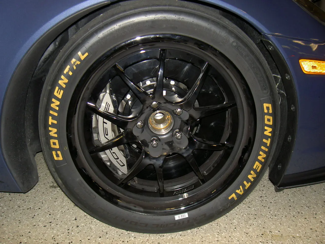

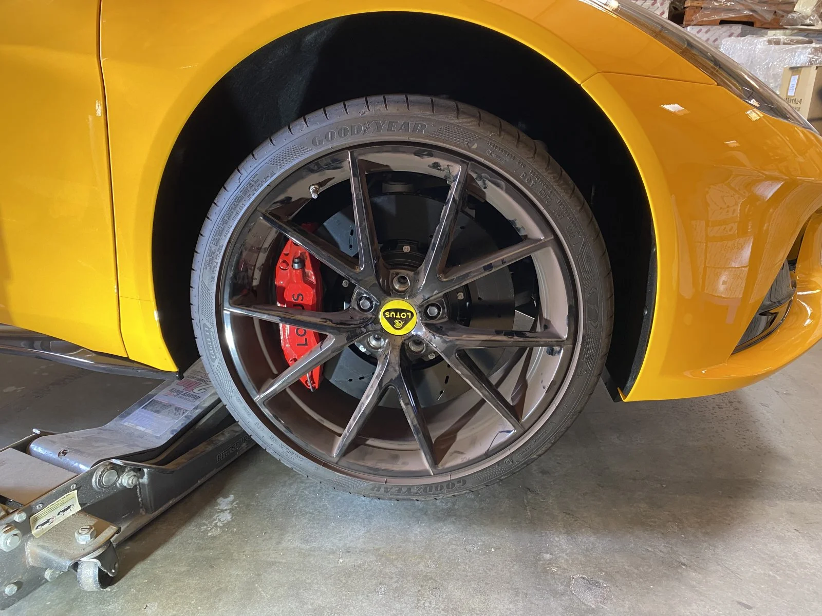

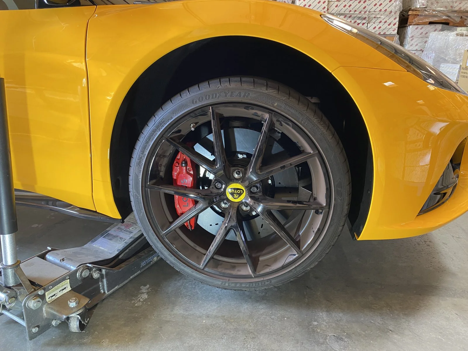

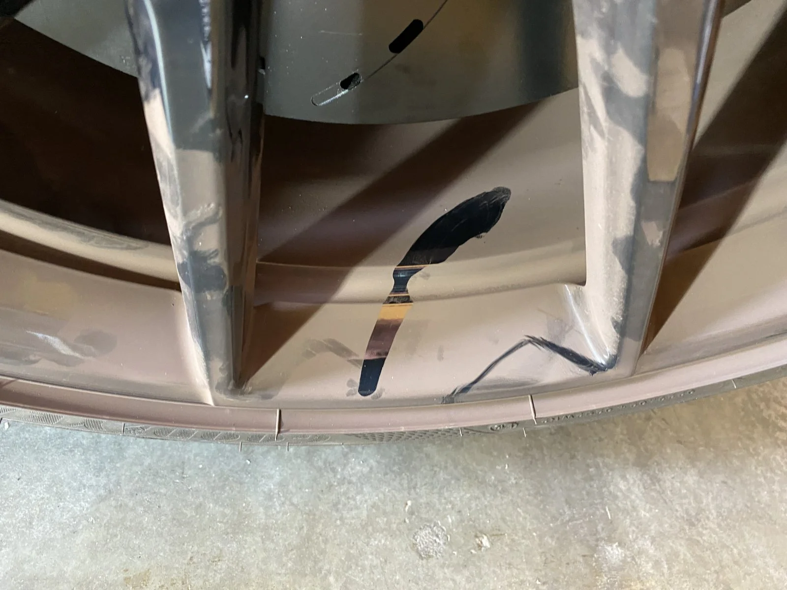

Rotors are coated EDP paint black, but after only a few stops the paint got burnt out, the rest of area remain protected from corrosion.
After installed:
After stops:
Airen has some pics to share with you on the brake pad size difference between RB and OE (AP) which are being expedited and shall be available in about 4 weeks.
That certainly changes the appearance of the wheel, doesn't it? I wonder how it would look if the hat was painted silver... it would definitely help to make the rotor stand out. Right now it all kind of disappears in there.
Interestingly enough, I was very happy with the all black appearance vs the factory look. The pads will wear the black coating off the rotors so there will still be contrast.

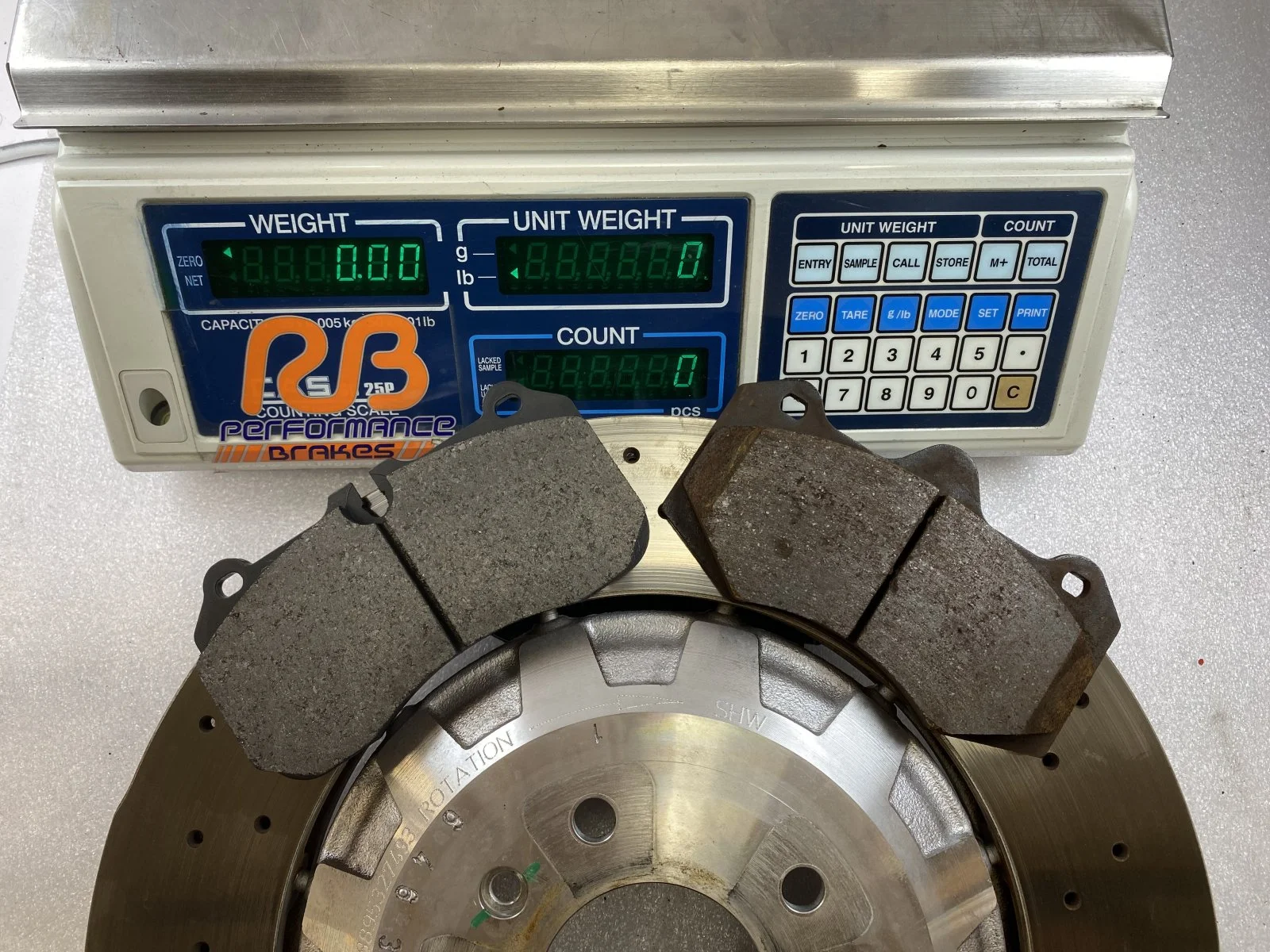

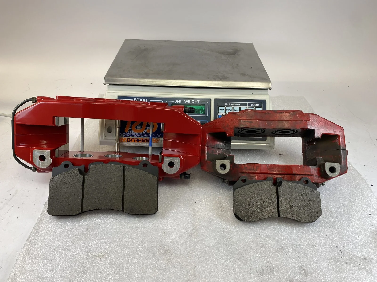

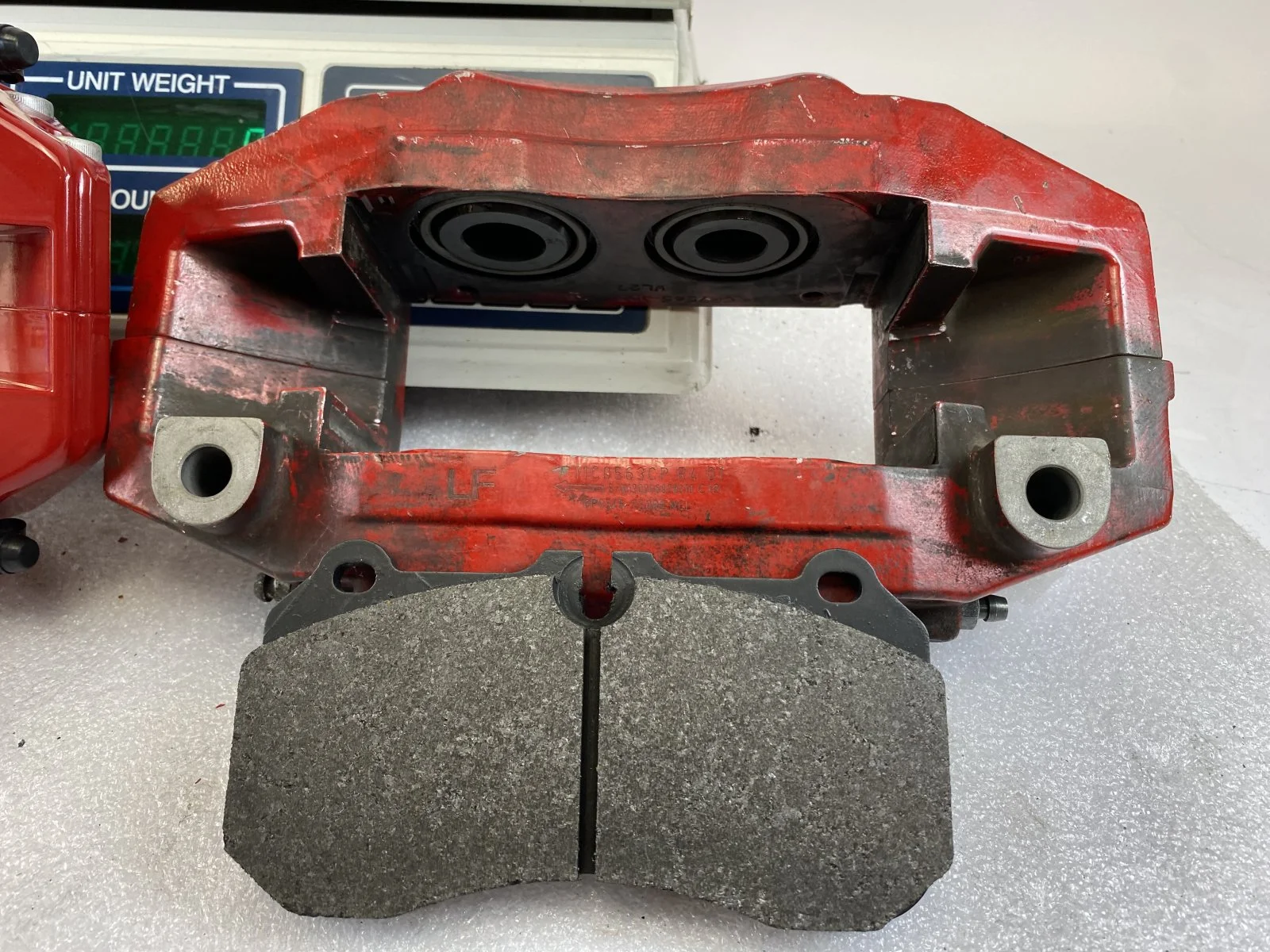

I’ve posted this before, this shows the difference in front pad size between OEM on the right and RacingBrake’s offering on the left. This is for the 380mm rotor.

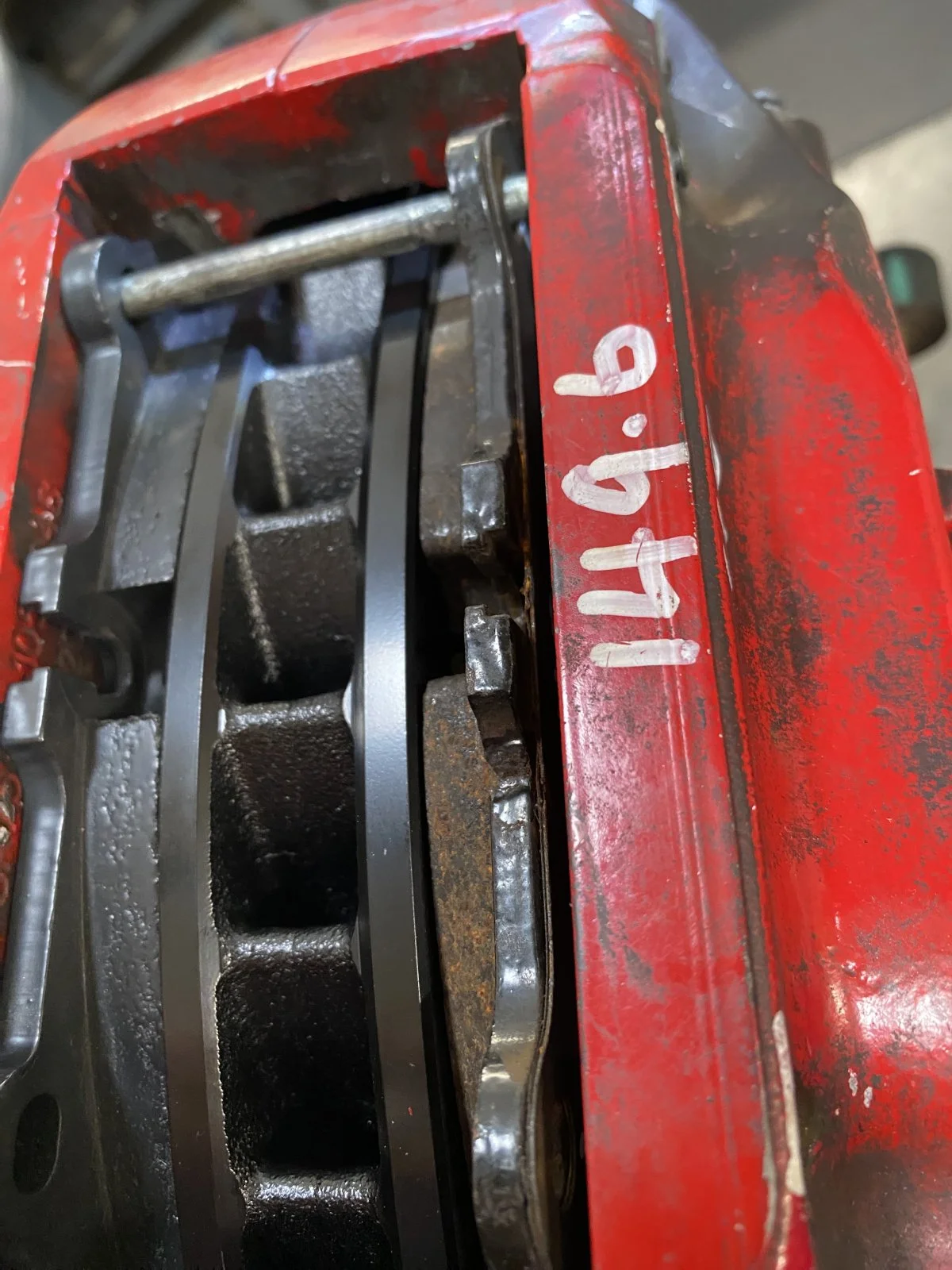

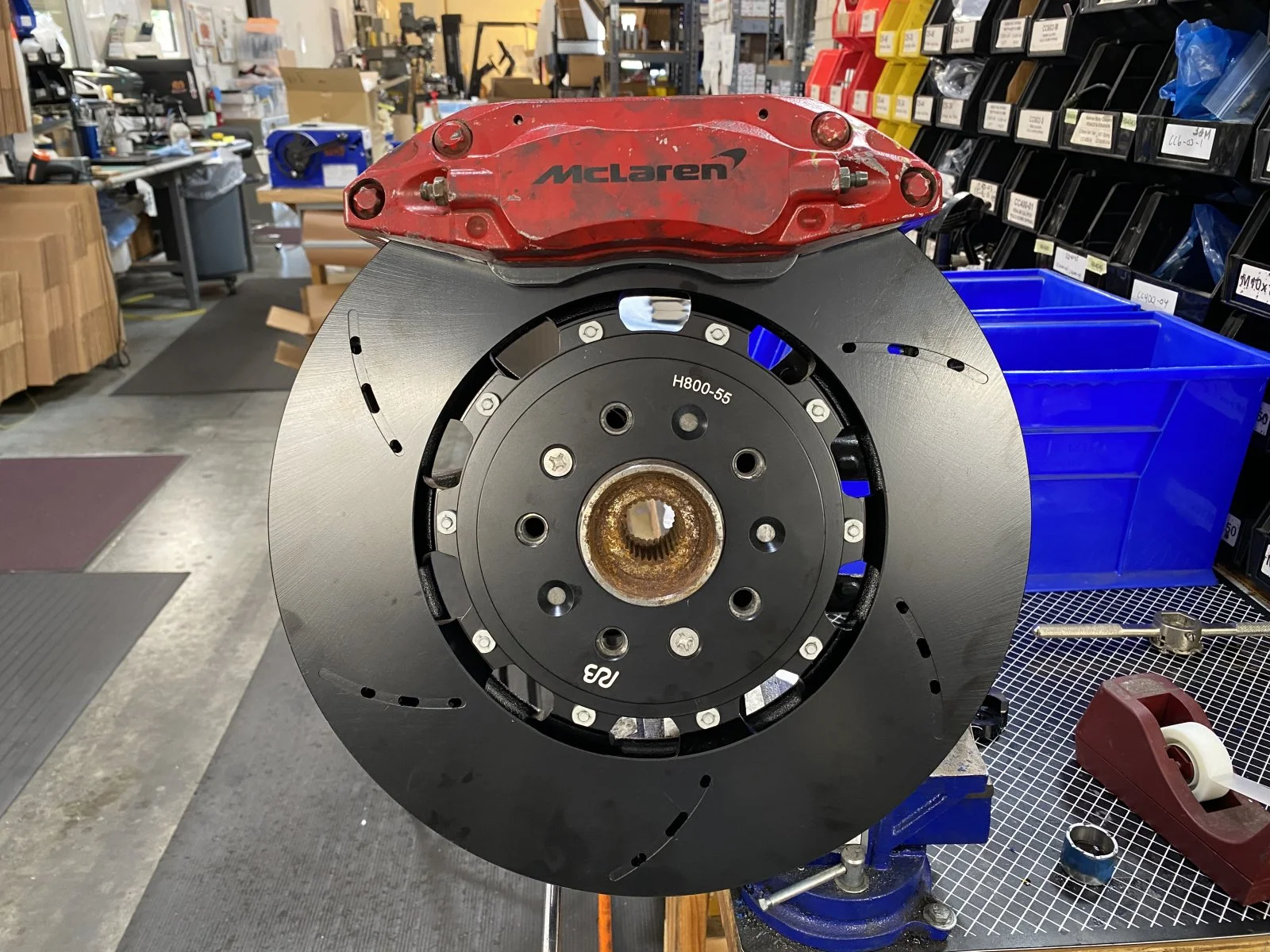

This is how the 380mm rotor and larger pads look assembled on the bench. Note the McLaren caliper used for mock up, it is identical to our caliper. Warren purchased a front knuckle/hub to be able to test multiple options easily.

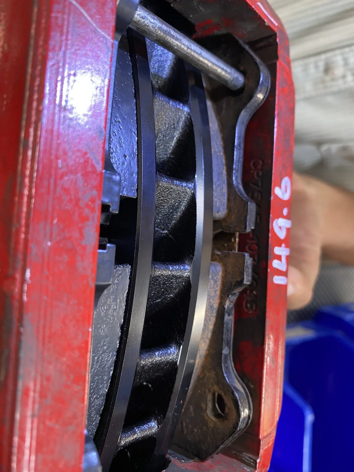

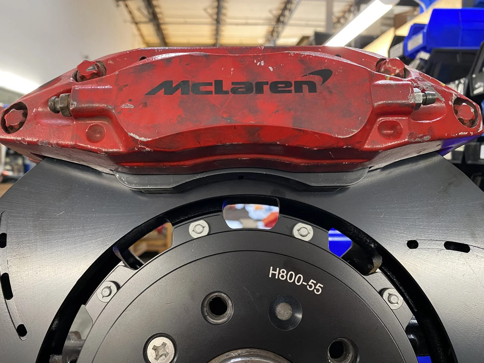

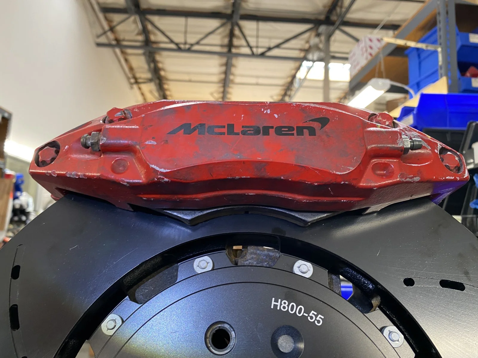

Note the pad fitment to the rotor compared to OEM
RacingBrake:
OEM:

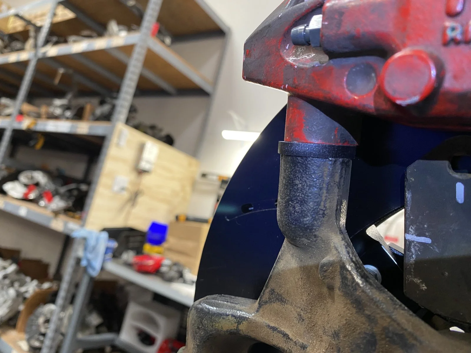

And here is a picture of the spacer required to fit the 380mm rotor.

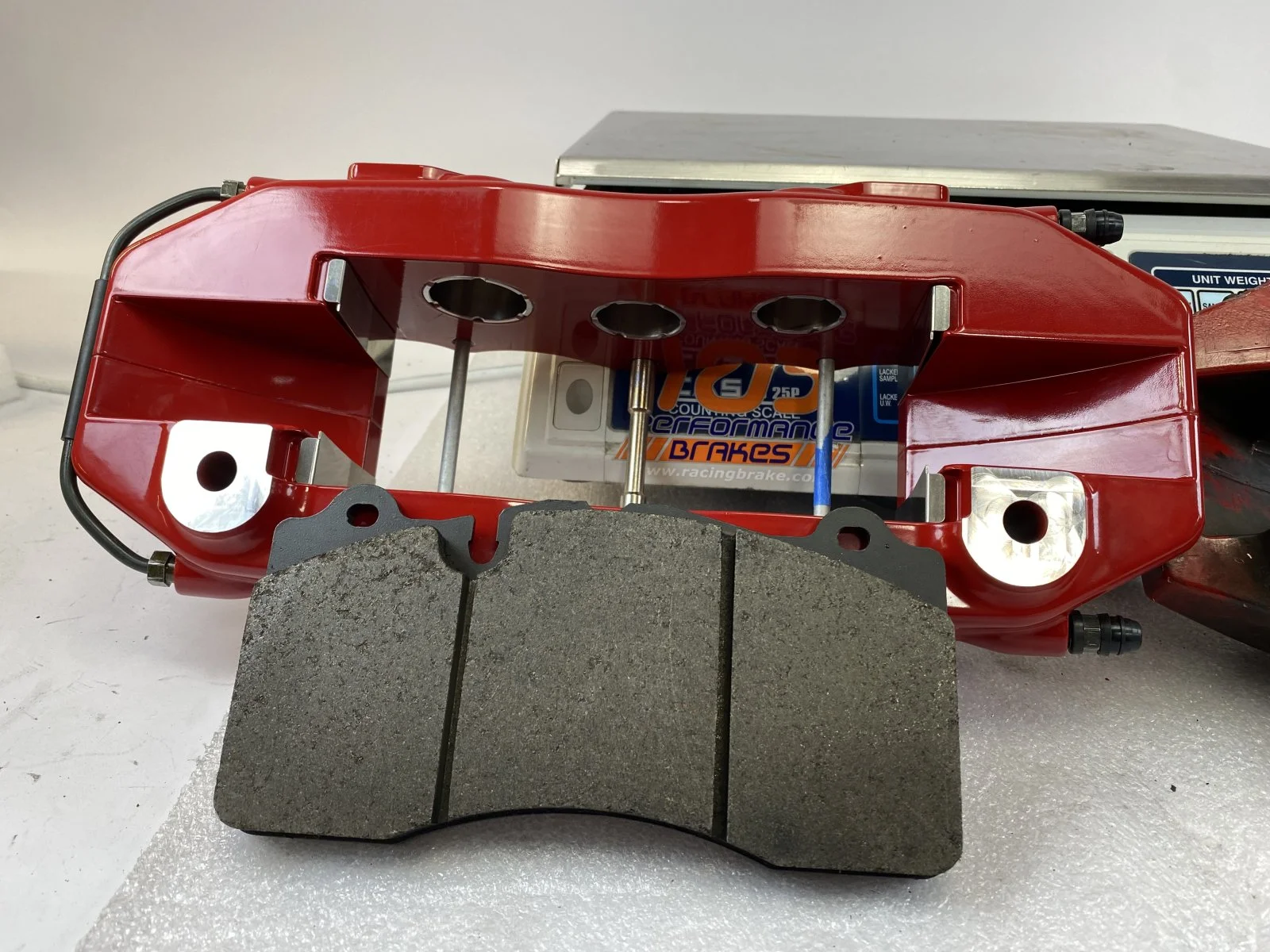

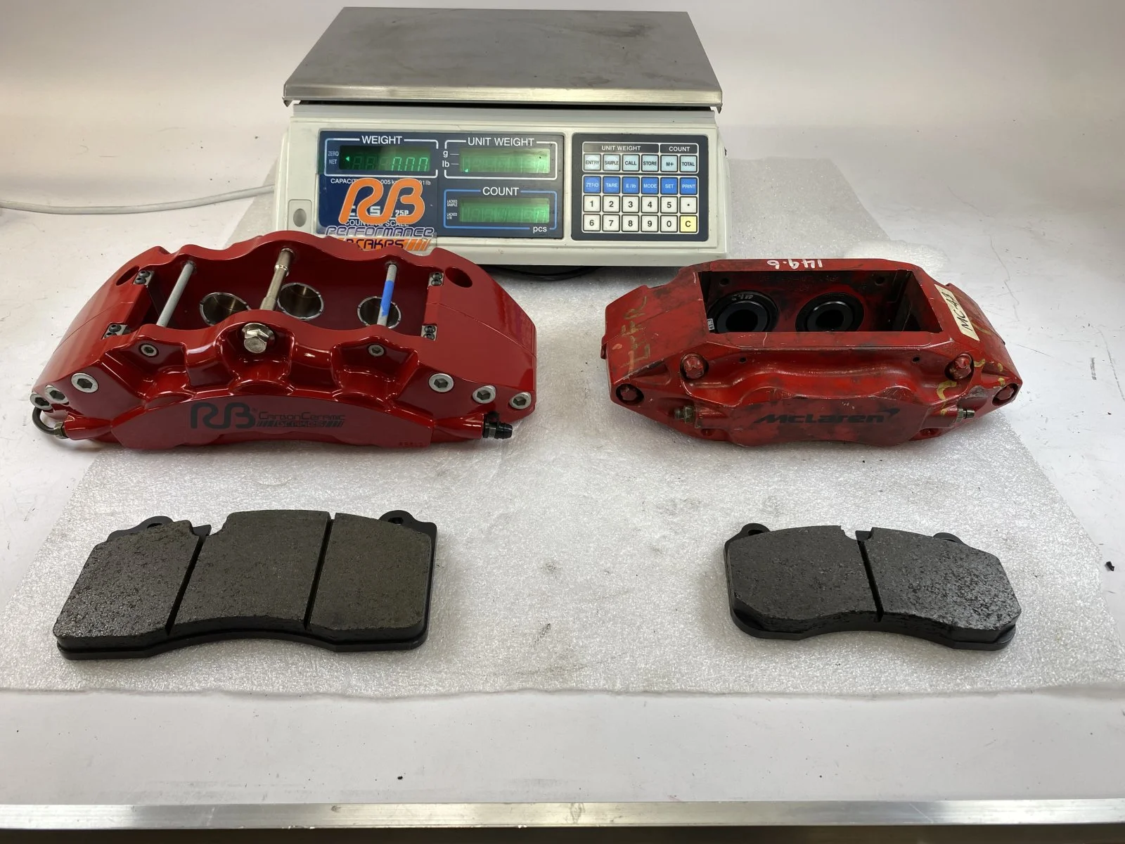

This is comparing the OEM front caliper and RacingBrake’s proposed larger pad for the 380mm rotor to RacingBrake’s 6 piston caliper and pad they will use for the 410mm carbon ceramic kit.
I’ll let the pictures speak for themselves:
This is the larger RacingBrake pad on top of the 6 pot pad.
