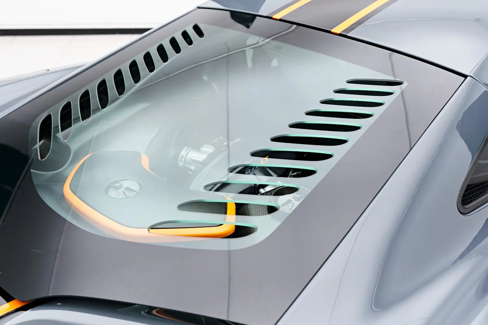

We have a vendor setup to make direct fit vented polycarbonate rear windows for the Emira (and Evora). Sort of an 675LT inspired type look like the picture below.
It would be a remove the glass, and install with urethane installation. If there is enough interest I will make it happen.

Im in for this, but the design of the vents should be flowing nicely with the side vents.. not like the picture above

Rain, dirt, debri, rocks, leaves, etc.

How long would something like this last before it hazes over from the sun? would you direct glue the poly similar to the glass or would there be a frame that the poly sits in for a tooled install?

It would have a "blackout" area like the oem glass does and would be adhered directly to the rear hatch like the glass.
The manufacturer uses a hard coating on the poly to keep it from scratching easily and protect from the elements. Adding extra protection like ceramic coating, car wax or maybe even a windshield skin would prolong its life even further though.
We have been selling hard coated poly windshields for Elise/Exige for years and never had a yellowing/hazing report but obviously things can vary widely depending on weather, being parked outside every day etc etc.
This could be pretty cool and better than a CF hatch. If designed properly I don’t see it collecting any rain at speed. Only standing still which just means don’t park it in the rain.

I'm also interested in replacing the rear window with a carbon or fibreglass vent. I'd like to continue the black pack look from the roof so that the vent looks like it was done from factory. Hopefully more of these options will be available shortly.
Interested, if the design is right and its finished in the same colour as the black pack (saves having to get it finished locally).
