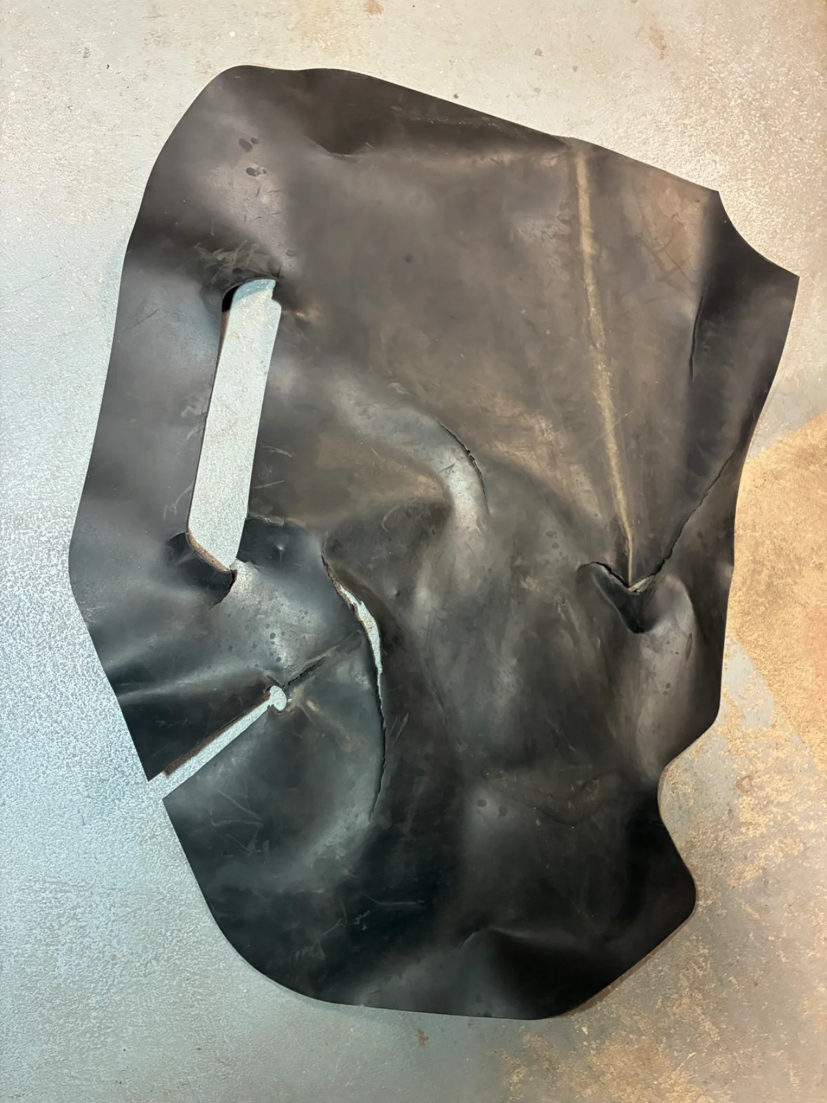

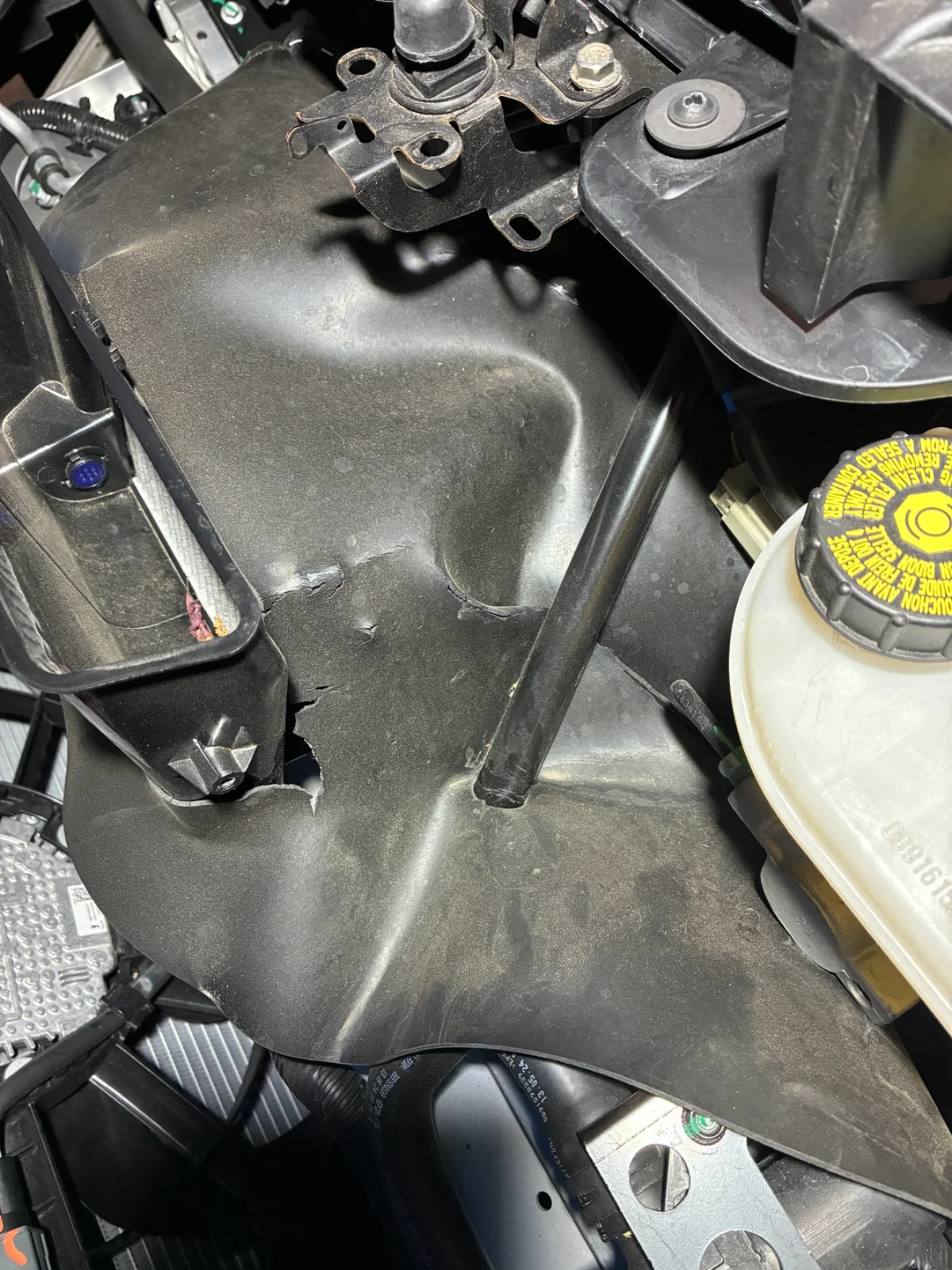

No, I understand that you were joking. I think my dealer is great, but I am actually concerned that if I take my car in to have them look at the HVAC, they may need to hook up to the OBD II port to monitor and will find the JB4 there. I took delivery of my car in December 2024 and started having the classic symptoms recently. I loved Blackthought_'s DIY membrane and wanted to emulate it, so I decided to take a look at my membrane and sure enough it was bunched up, creased, cracked, pooling and leaking. I got the membrane out and tried to gain access to the plug but ultimately decided to have the dealer honor their warranty. I buttoned everything back up without the failed membrane, which I hope they will not take issue with. Perhaps I should just unplug the JB4 and tuck it away out of sight. That won't erase any suspicious data logging history which may appear, though.

I could have put the old membrane back in , but I cut it where I had to free it from around the support bar to avoid undoing the bar and I didn't want them seeing that. I figured they could just assume my car never had the crappy membrane fix done. Yes, it's kinda sad that a new Lotus still has the build quality of an old Lotus.

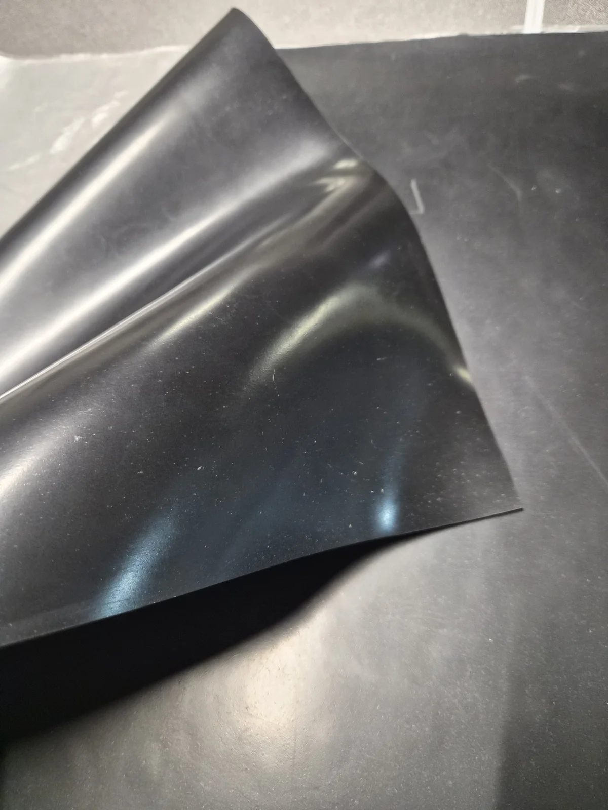

After looking at EPDM and Silicone I ended up ordering a 36"x36" piece of Nitrile rubber 1/16" thick from Discount Rubber Direct in Texas for under $60 (shipping & handling included).
Nitrile is far superior to both EPDM and Silicone.
1/16" has plenty of flex to it, is very strong and will easily outlast the Lotus material.
I'll attach a few pictures of the final cut later this week.

I checked the temp specs for Nitrile before purchasing and this is what I found:
Tensile Strength: 200 - 3,500 PSI
Elongation at Break: 350% - 650%
Abrasion & Tear Resistance: Good to Excellent
Operating Temperature Range: -40⁰F to 250⁰F
Maximum Continuous Static Use: 250⁰F
Coolant runs from 195-220⁰F (90-105⁰C)
So it should be up to the job more so than the Lotus stuff.
I'll keep an eye on it and report any issues.
...Coolant runs from 195-220⁰F (90-105⁰C)
And that's the temp inside the plumbing. Given this area is fully vented, I'm guessing the hottest temp. this material would see is maybe 150 degrees? And even that feels like a stretch, certainly at highway speed anyway.

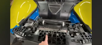

Then I found this... Am I looking at this right or is that some sort of permanent fix by lotus with a black plastic cover and access points with turn keys?!? FYI I've asked Savanna7 on YouTube who's video this is captured from...
