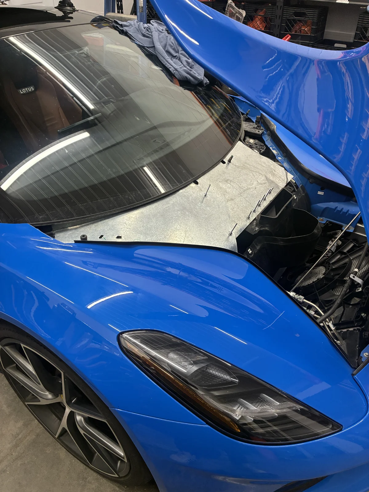

Hello mate, how are you getting on with your design?
I completed the other side on that picture, but I haven't had much free time so no new pictures. I was on the track two days ago and I don't have anything bad to report.
If you want to keep the plastic shrouds on both sides, you will need to bend the plate so it won't look very pretty. To be fair, the only important shield is the one in the middle for the air intake so I personally chose to ditch the other two.
  • The drainage tubes on that middle shroud would benefit from having elbows. Right now the fitment is very tight.
  • Having one single plate would be easier to fabricate, but I think it would make maintenance too complicated.
  • Still need to make a longer electrical connector for one of the nozzles. I'm not quite sure what their purpose is other than preventing the nozzles from freezing?
  • The hood is still very much secured despite removing the bracket in the center.
Thanks for the update. Your design definitely looks to be the best version. Keep it going!! 👍👍

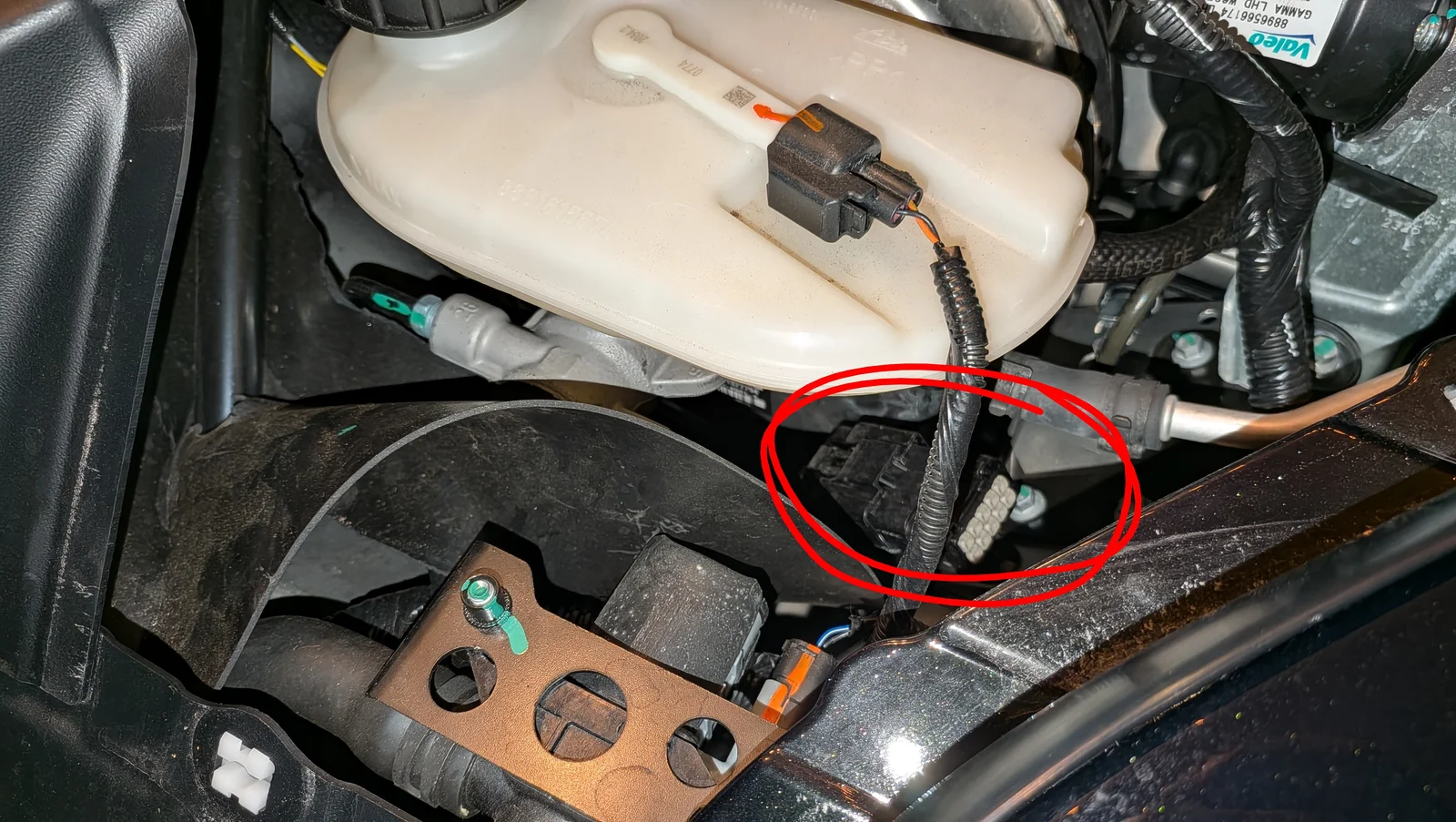

Can the membrane experts on this thread please let me know if mine might have been installed incorrectly at the factory? I was under the hood earlier today and it seems that the membrane was underneath a component that looks like it might be the fuse box (circled in red)? Thanks for any advice.
Circled is not fuse box which is on other side; open connector (on mine too); I covered with baggie/zip tied tight; other exposed connectors did same.......
membrane install...............?? doesn't look great to me, but not entirely visible..........
Your membrane looks ripped. It's probably cracked and is letting water though. Without seeing the whole thing I can't be sure though.
yes, this is not a fuse box, like stated before, the fuse box is on the other side.
But, it does appear that your membrane is ripped, where the yellow wires and green marker right below reservoir are located. Membrane should dive under that metal support beam and wrap over those yellow wires and under the reservoir.
