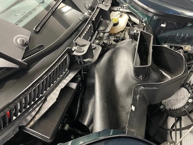

After reading through this thread, I'm still not 100% on which components are concern for water ingress and need shielding on a LHD model.

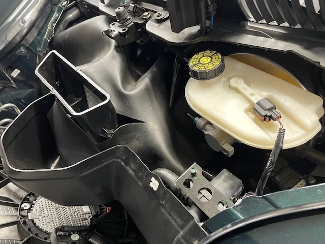

However, I popped my frunk to look at the water membrane that had been installed on my car by the dealer while with the previous owner.
If there's anything under the brake reservoir or if the passenger side fuse box and wiring needs to be protected, this isn't doing much. It also seems like the membrane would channel a good bit of the water towards the scuttle/firewall (unsure if that's by design). On a side note, the torx head screws securing the pollen filter cover were different sizes and lengths side/side which seems sloppy.
Are you worried about water pouring right onto that fan?
No. The picture posted of my car was taken before the covers were re-installed to show the membrane's extended coverage. You can't even see the membrane once the covers are back in place, and they also keep the membrane in place.
If water into the fan was a problem, then the OEM plastic covers would cause the same issue.

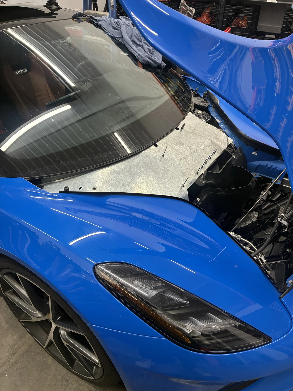

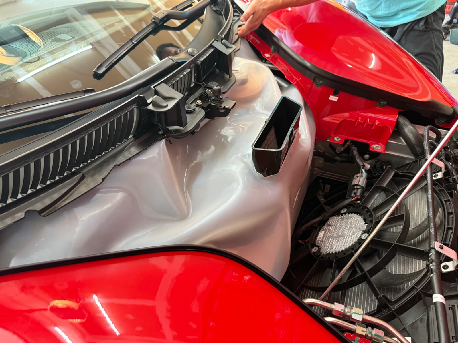

Mine is installed the same as in the video above, and the same as many in this thread have installed them. However, I used the expensive silicone material, which is more heat resistant and not prone to cracking like rubber.

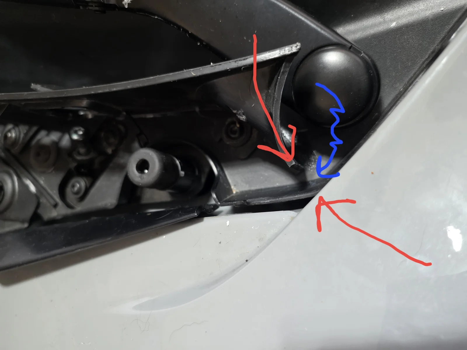

So sealing cowl edge with silicone should offer a little more water ingress protection!
The extreme outside edges of the cowl grille does have a gap where water could overflow into but even if that happens, there are no critical parts under that area.
Thanks for testing it! I am glad that idea works!! Not a replacement to a decent membrane, but surely helps!
