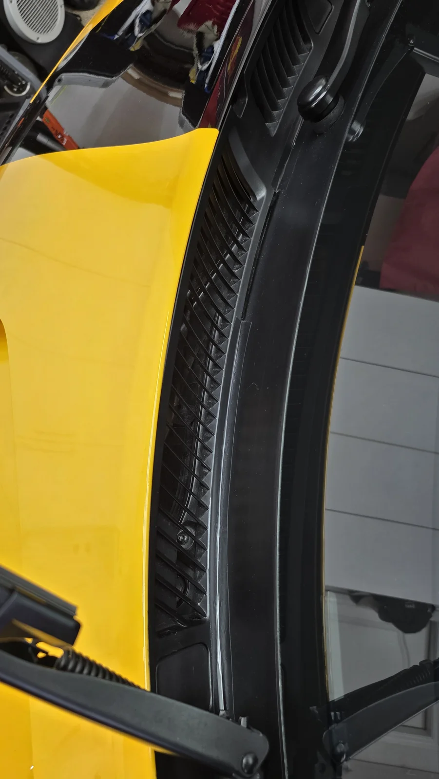

An extended silcone-rubber membrane was installed on my 2026 at 600 miles. It was installed over the OEM membrane, and unlike the OEM membrane, covers the area of the fuse box and HVAC relay.

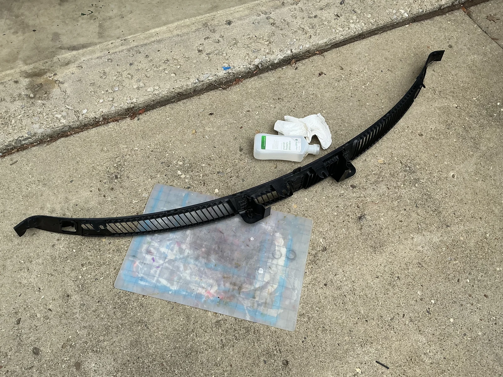

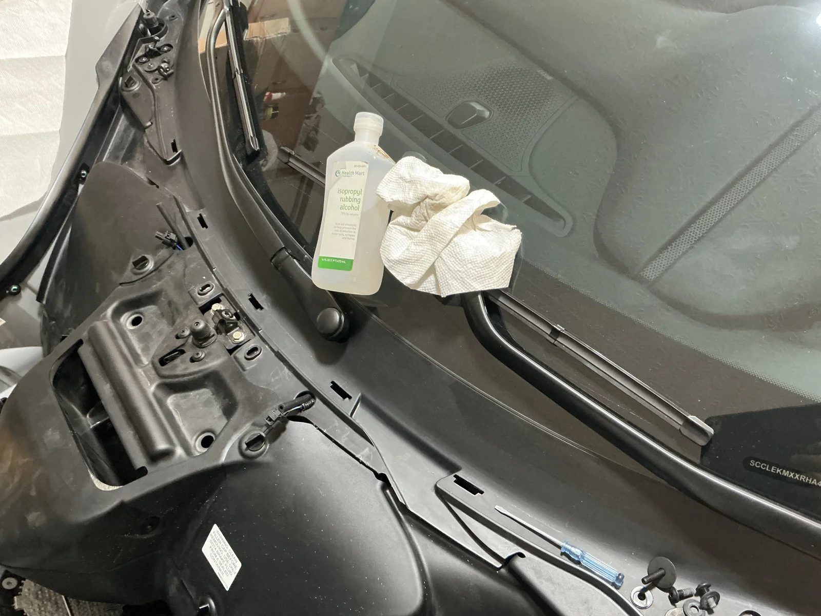

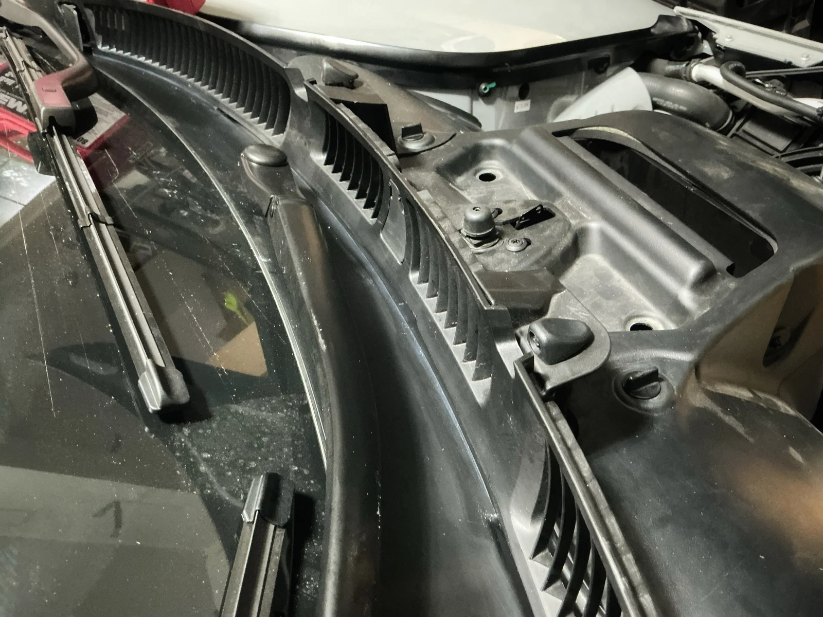

I recut my membrane from a raw piece of EPDM this weekend. I started from the vent cutout and worked from there. This revised one goes from side to side fully, over the fuse box completely on all sides and above the level of the cowl slots.
I also put a bead of silicone adhesive sealant under the edge of the grille and along the windshield side edge of the grille so that no water will drain in the slots. Only hopefully directed to the water drainage channels.
Wiped down grille bottom edge and cowl with alcohol before laying beads of silicone. I will do water test sometime this week, car is still immobilized waiting for tuned ECU to return back to me.
