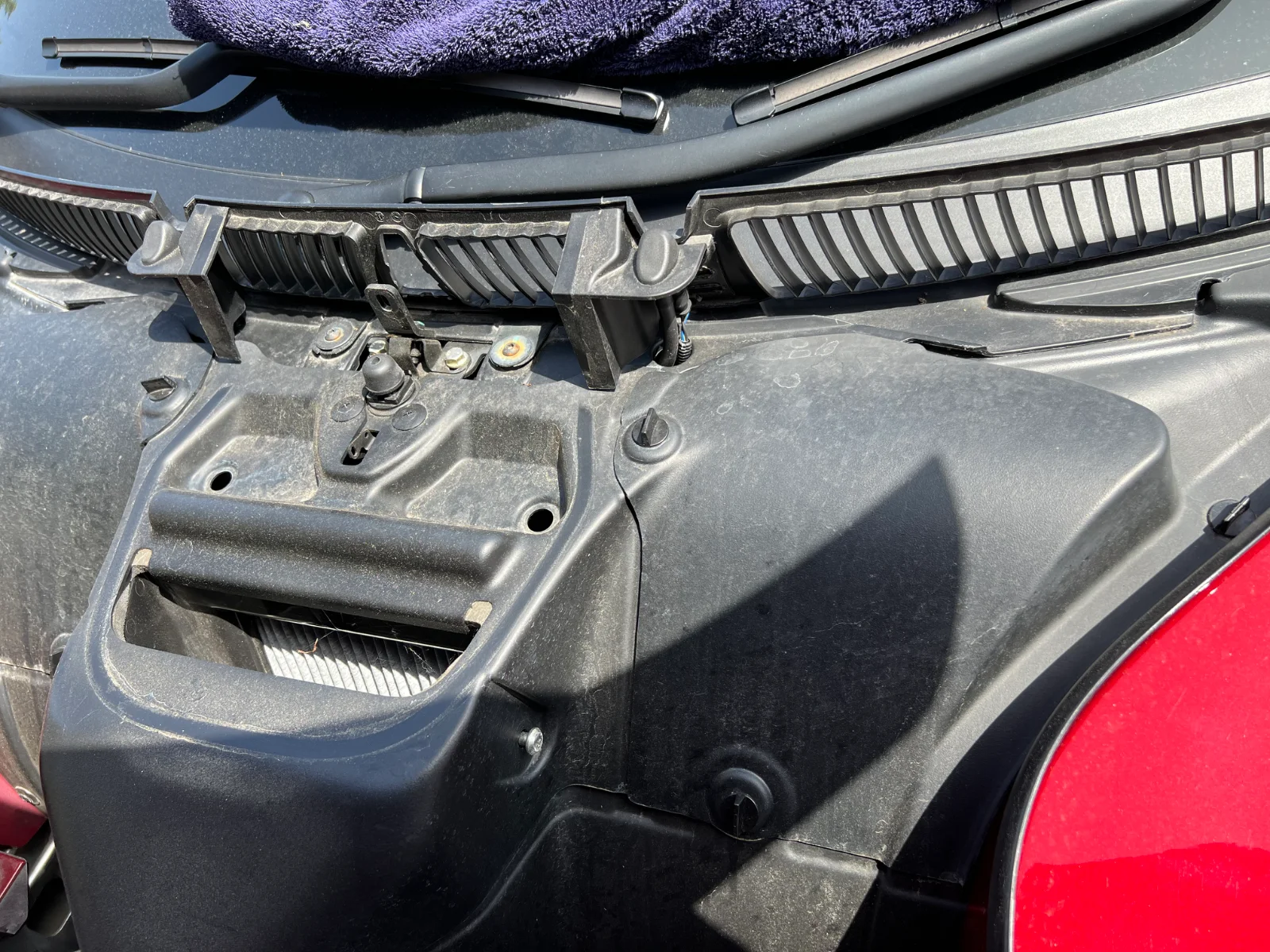

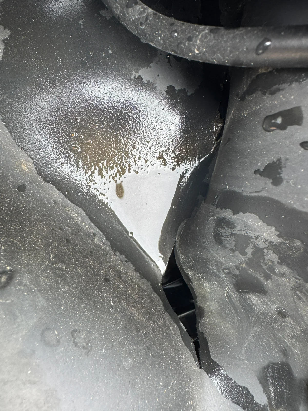

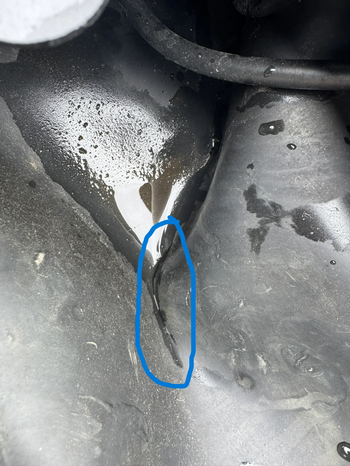

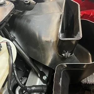

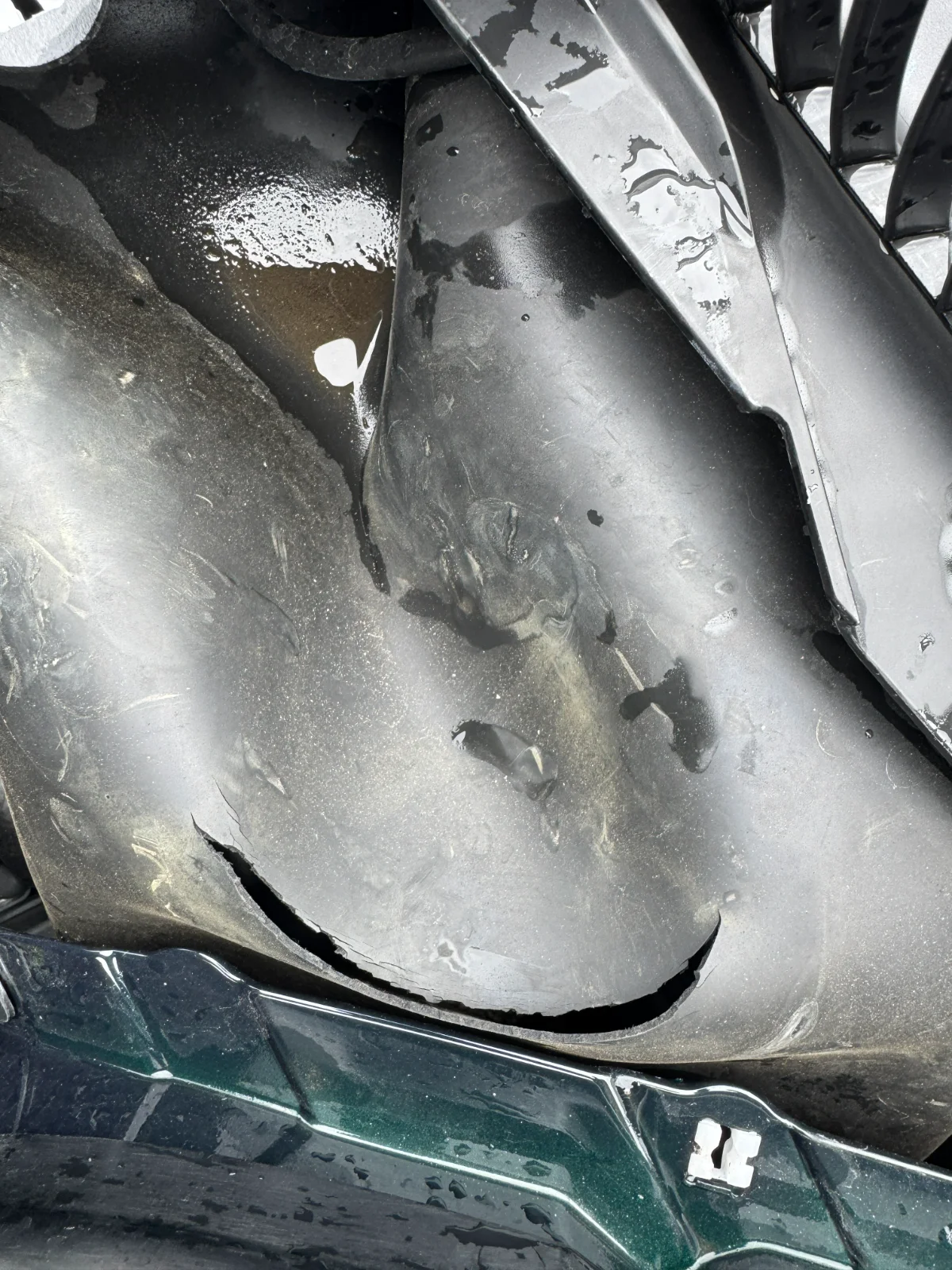

Checked mine today after washing the car and also found cracks. I believe this was factory installed.
Looking at it it seems unclear where/how exactly water is meant to drain away once it lands on the shroud. I guess in my case its going through the crack.
Will speak to dealer.

Anyone figured out what Lotus used to have them fail like that?

Not sure why Lotus material is so prone to cracking; hope EPDM fairs better

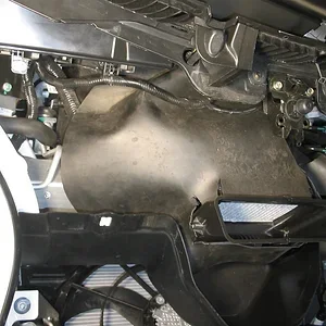

I’ve just checked mine, There is cracking appearing in some places but not yet in the crucial places, it was probably put there about 2 years ago when they changed my wiring loom, fuse box and HVAC unit, ...
Thanks for the post with your photos. Your shroud seems to be the first one that resembles what is in my 2025, that is, there's a rounded bib in front of the cabin intake. Photos of removed shrouds have instead a straight edge.
But there's a huge discrepancy in the installation of these two shrouds. You have a RHD car, and the shroud is installed to cover the fuse box on the passenger side. But I have a LHD car and the shroud is oriented in the same manner (i.e. the "short" curved side is on the right-side of the car). So the shroud on my car does not cover the fuse box, but instead is tucked under the brake master cylinder.
So was this shroud on my 2025 LHD installed "backwards" (as if it was a RHD)? Did this happen at the factory, or somewhere else after manufacture?
Perhaps everyone (especially LHD owners) should be checking under the bonnet and these covers.

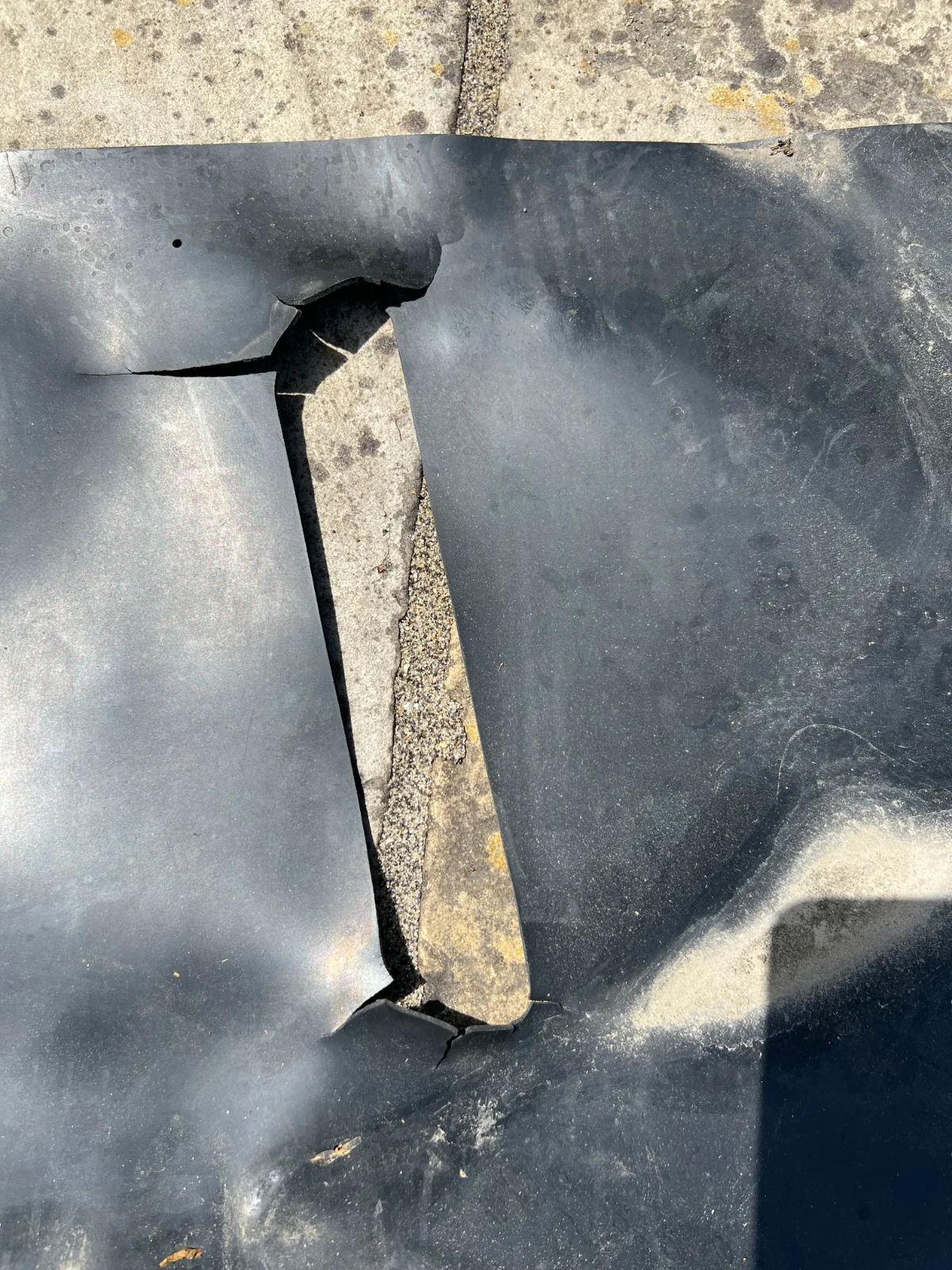

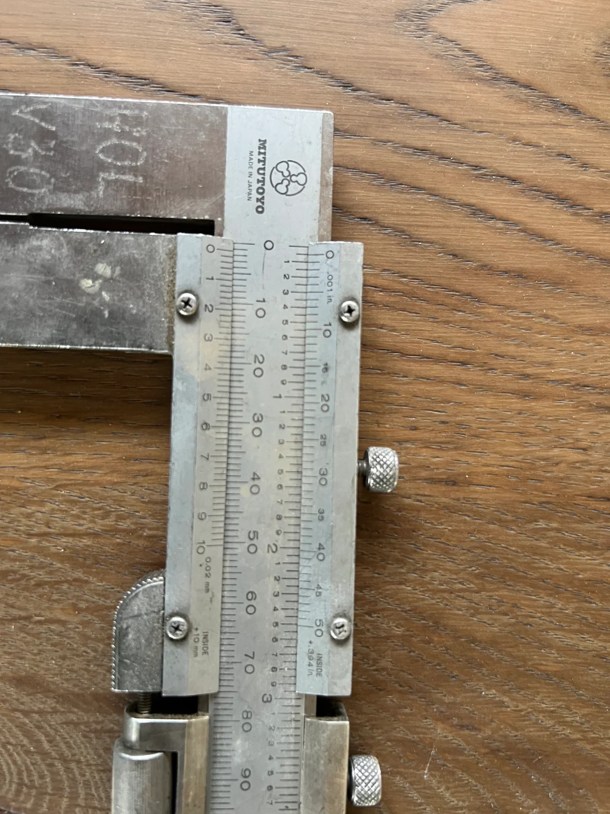

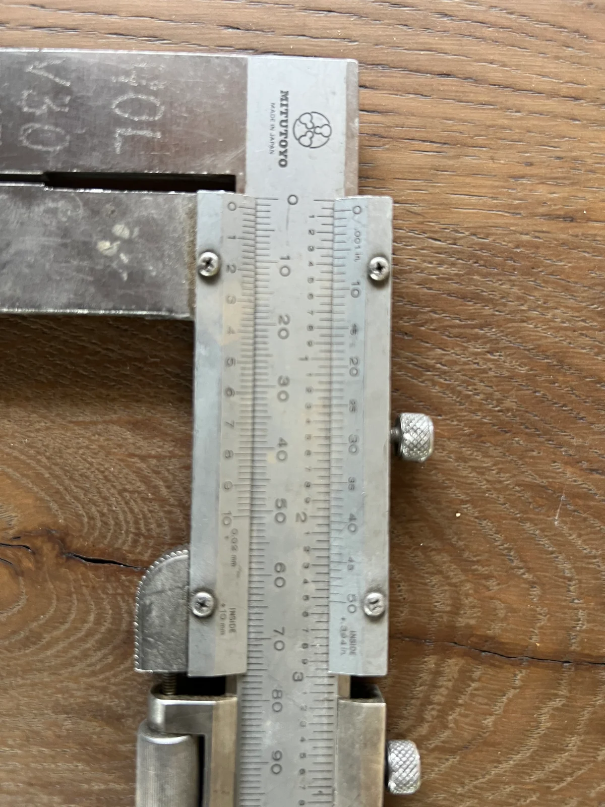

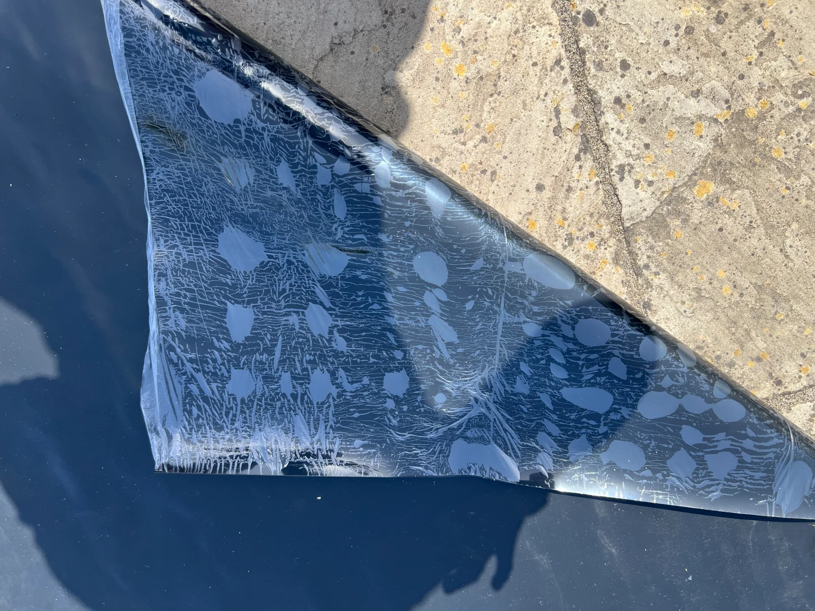

So…..I had a bit of spare time today, so replaced my Lotus incontinence sheet.
The Lotus rubber is around 1.3mm thick:
My silicone sheet was a little thicker at around 1.4mm thick.

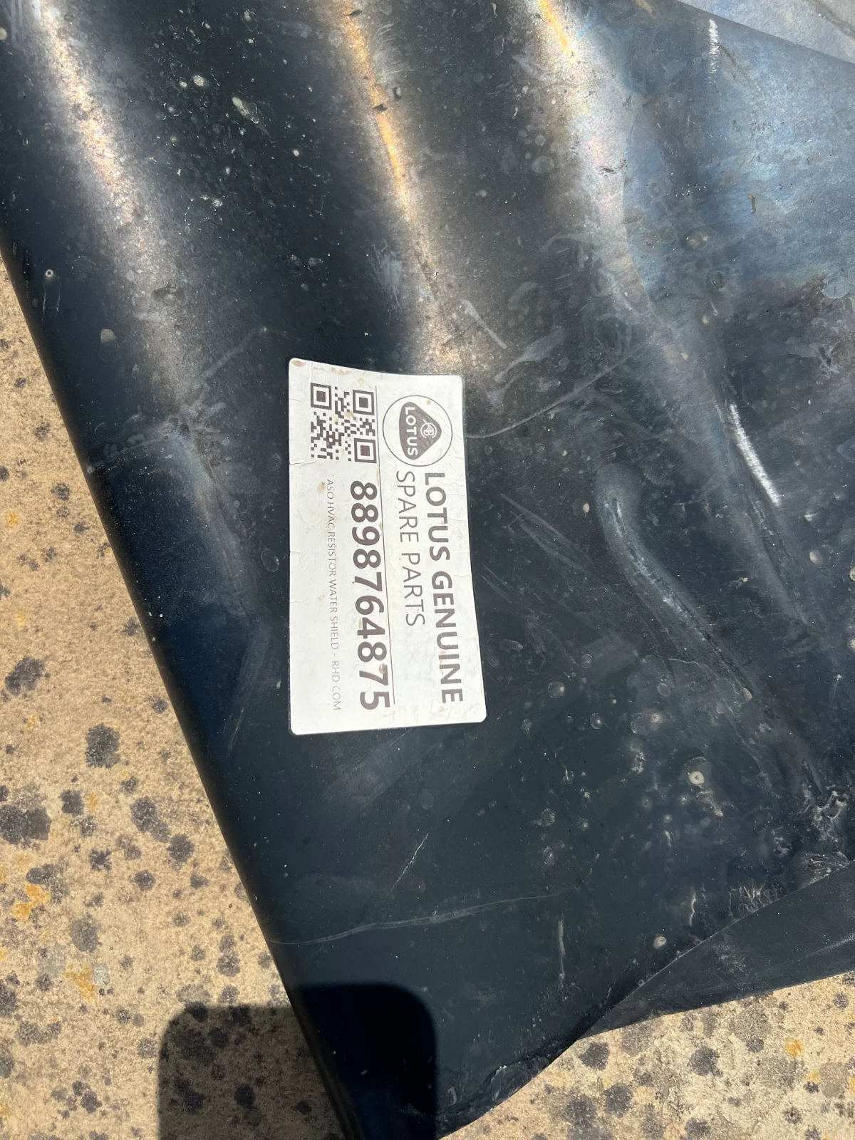

The Lotus part number is this:

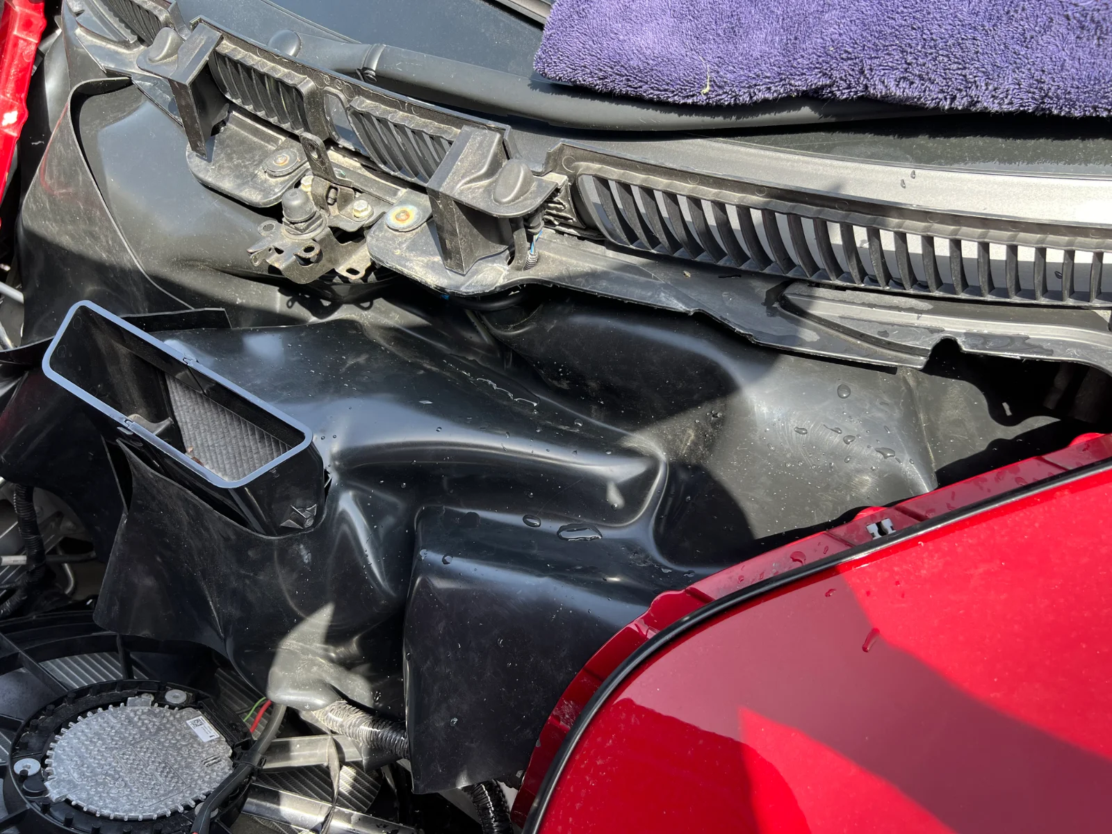

I removed all of the plastic shrouding on both sides and in the middle:

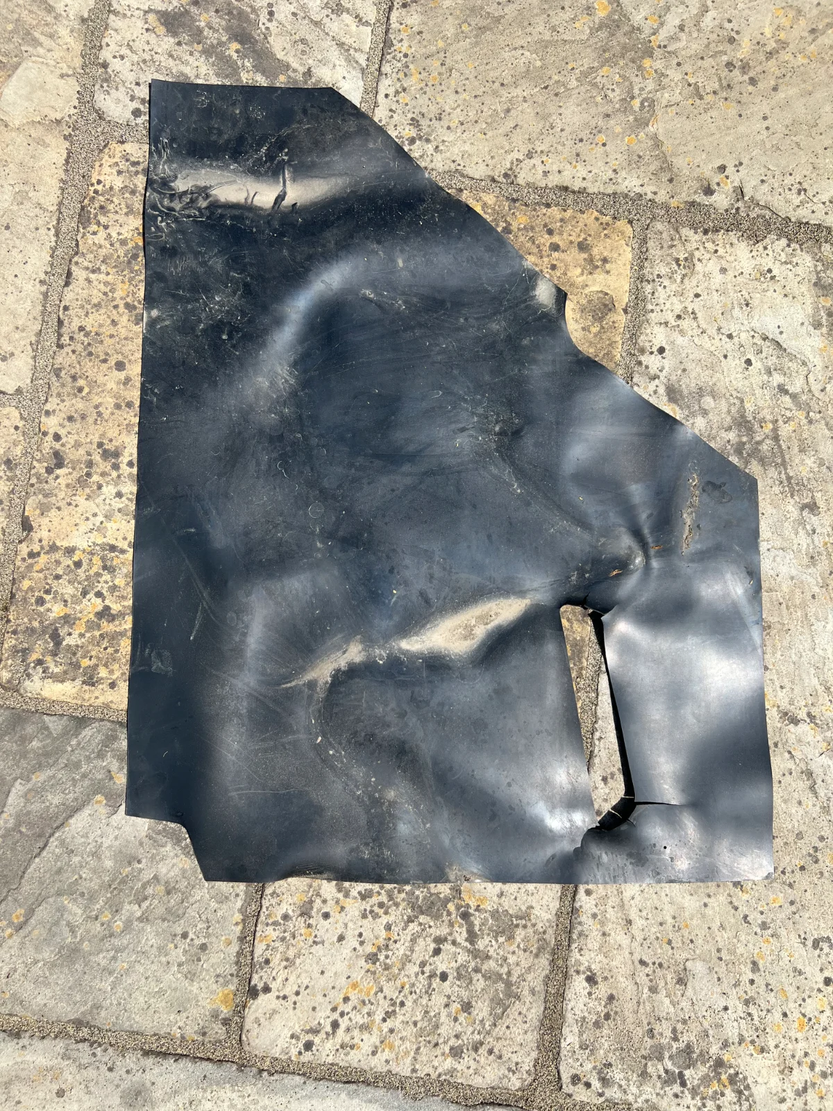

This is how the Lotus rubber was installed:

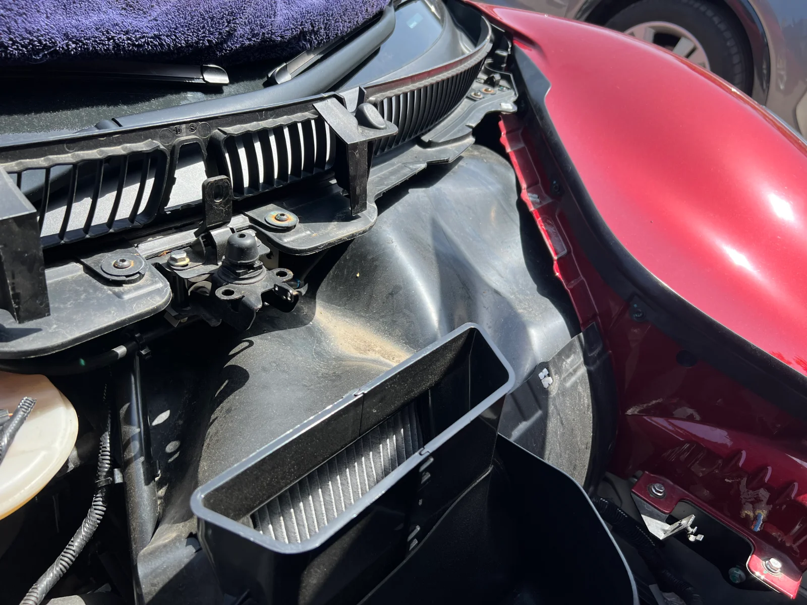

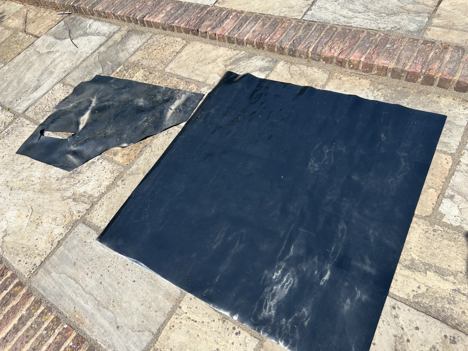

This is the Lotus sheet laid flat:
Mine was ‘suffering’ around the cut out for the cabin filter area:
This is the Lotus rubber laid next to my eBay silicone sheet:
The silicone sheet comes with some protective plastic backing which I removed:
I purposely made mine bigger than the Lotus sheet, so that it would extend further down the front, but more importantly further over to the drivers side (RHD car) to cover some of the electrical connections on that side:
I ended up adding an additional piece on the drivers side. Although obviously there’s a gap under the two pieces, if water goes underneath, it will still be directed away from any electrical components.
It’s pretty much impossible to get the sheet smooth, so it will always pool some water in the low points of the silicone sheet. However, when it overflows it will run away from any electrical components and crucially the fuse box and HeVAC resistor.
Overall it’s a pretty simple job, but a bit of a faff. It’s still a bodge job as is the Lotus ‘fix’, the difference now is that, iv’e covered/protected everything and hopefully the silicone should last indefinitely, rather than the 1-2 years of the Lotus rubber.
