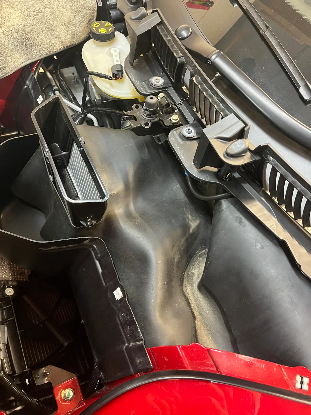

Check your rubber membranes! Given all chat on here I just checked mine installed maybe 24 months ago and was holed in two places so basically not doing its job. See pics. Car was just serviced including brake fluid change but obviously isn’t something they check at service…. They should!
I’ve replaced it with EPDM so will see how that holds up after 12 months
Luckily car garaged and has hardly seen any rain since original installation so all looked ok underneath.

The membrane lasts about 2 years.
It feels like a bodge fix by Lotus just to get you through the warranty period..
Will be any car where the membrane has been installed so thinks that’s most of them as I am not aware of a more permanent fix for recent builds (but may be wrong)
And if you don't have the membrane fitted - then you need to get it fitted else you will have problems with the A/C and heater eventually.

Just looking at some of the images, the other thi g i have noticed is how different some of the rubber membranes are. Mine only went over half the widthof teh car where the resistor pack is wheras some seem to go full width of the scuttle panel.
Is there a right or wrong shape/size?
I assume there is a right shape as the warranty fix is a standard Lotus part - at least it seems to have a part number on it - see here --> https://www.emiraforum.com/threads/car-shut-down-but-engine-still-on.7636/post-200422. All the photos I've seen of them look the same as mine and this is about 80cm and goes some way under the plastic covers at each side of the scuttle.

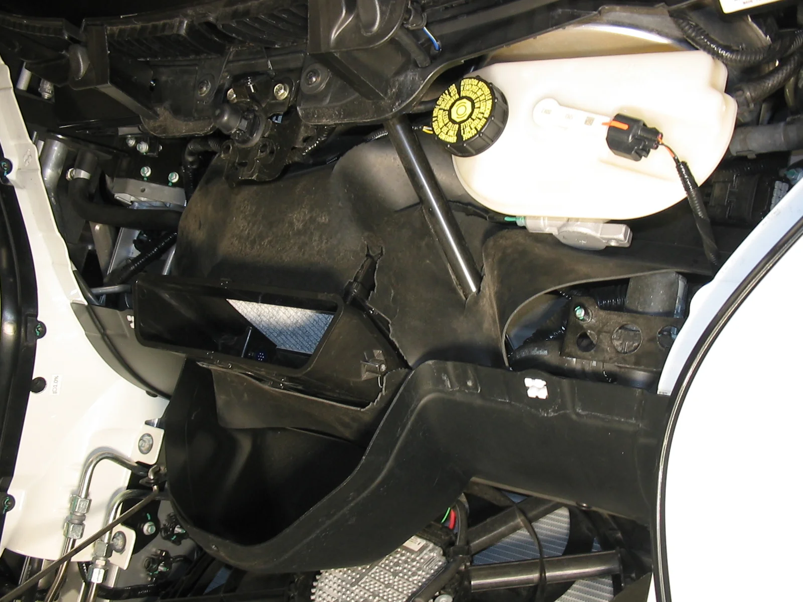

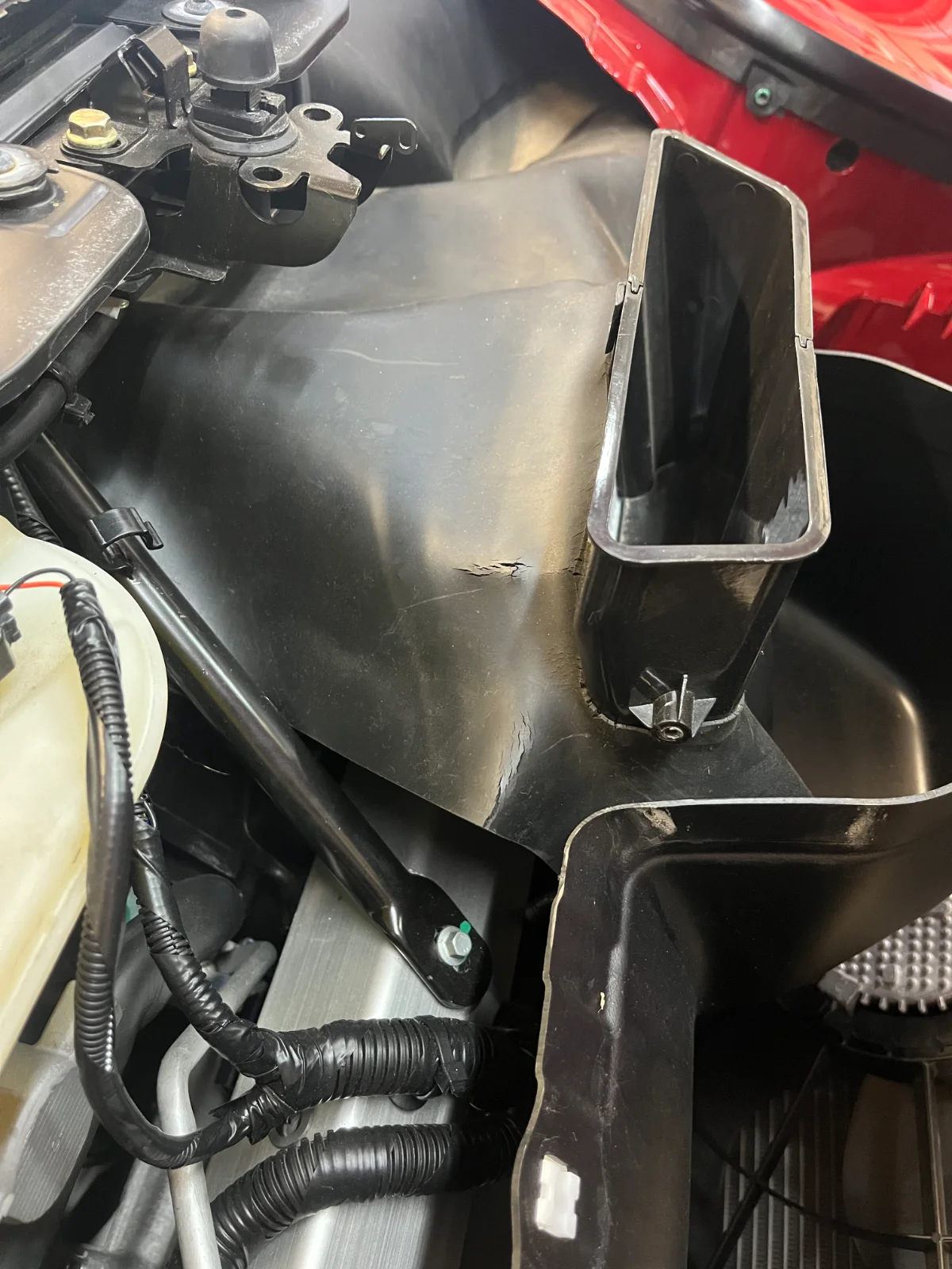

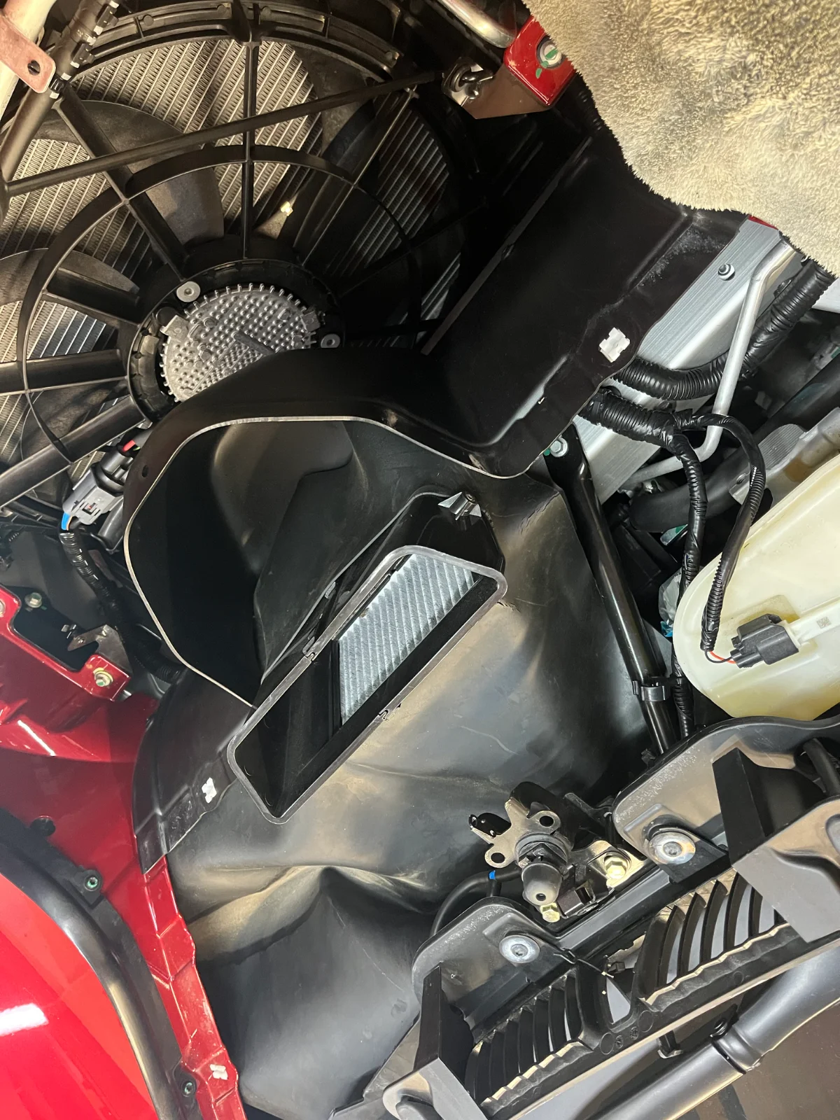

Here are photos of my 2025:
Note that the shroud/bib does not at all cover the fuse box on the passenger (LHD) side. There are tears all over as if it was carelessly installed and/or it's stressed. There's even tears on the edges! Seems to be a rather brittle material that's only 12 months old (car was built May 2025 according to door tag).
Definitely different shapes. Even the one on the other thread with part number on it looks like parts of it have been altered by hand maybe during installation. I will take a few pics of my old one with some dimensions but this is making me think i might make a bigger versiin that covers as much of the scuttle as possible.

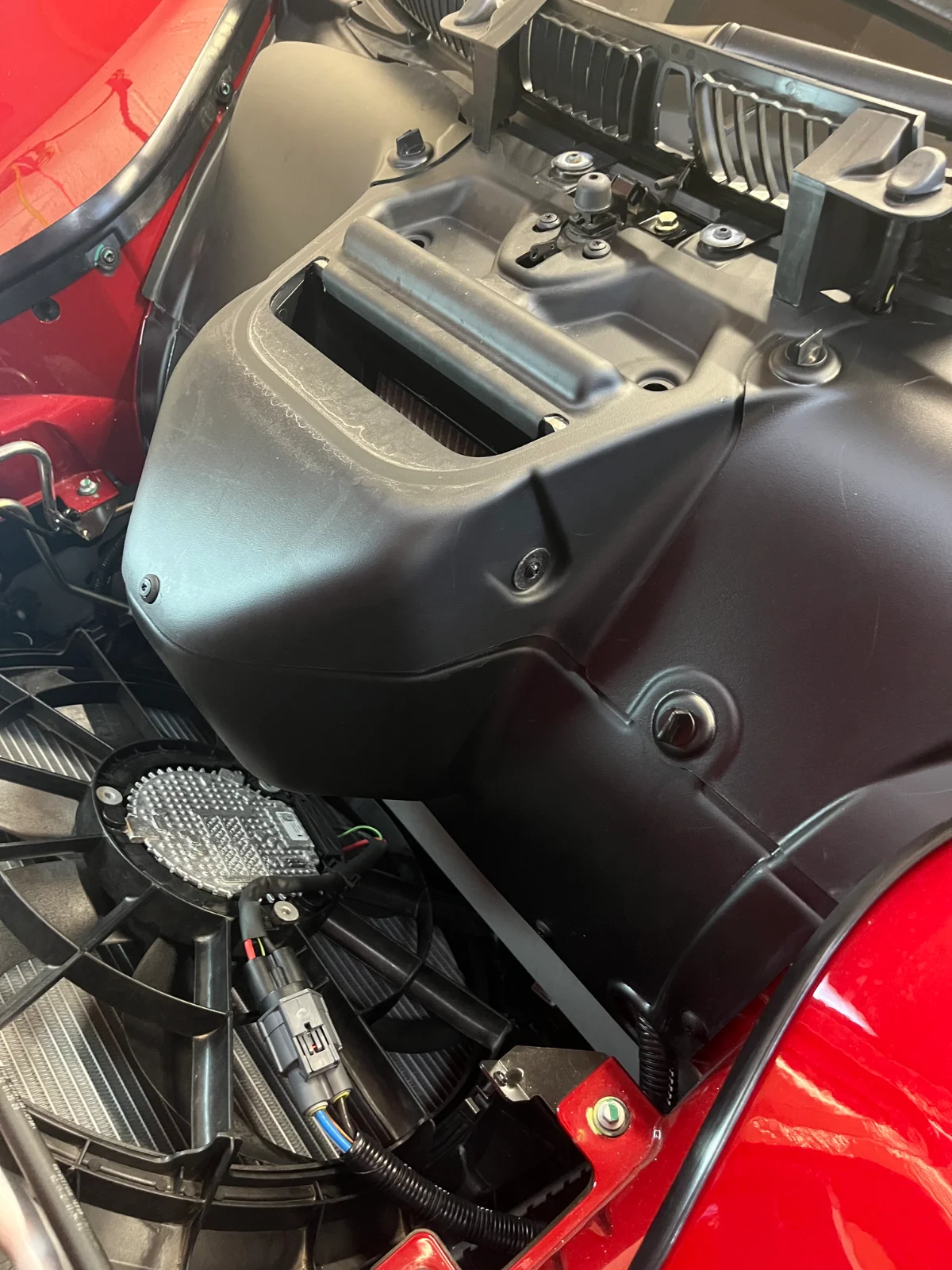

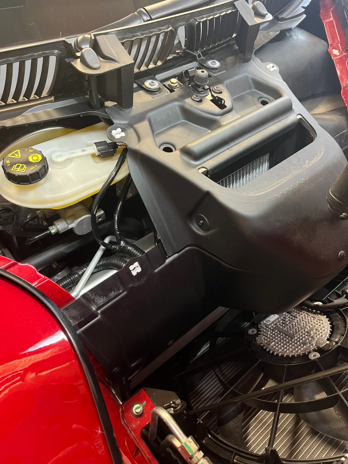

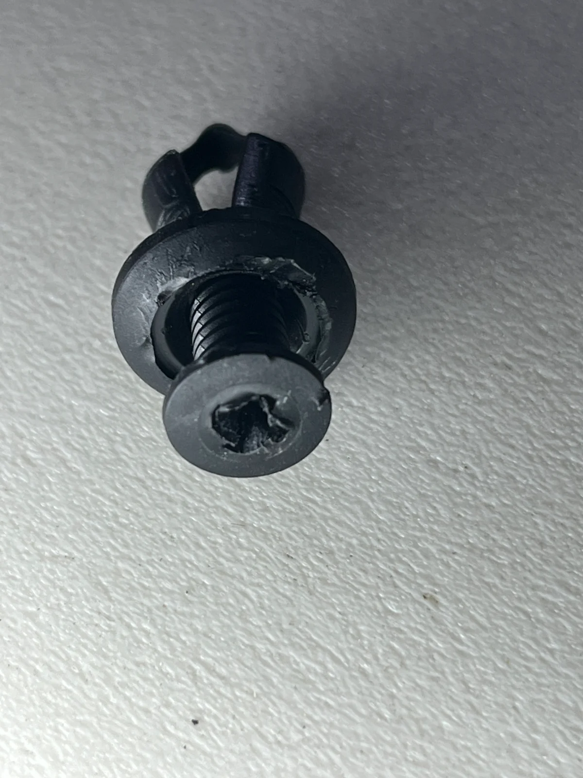

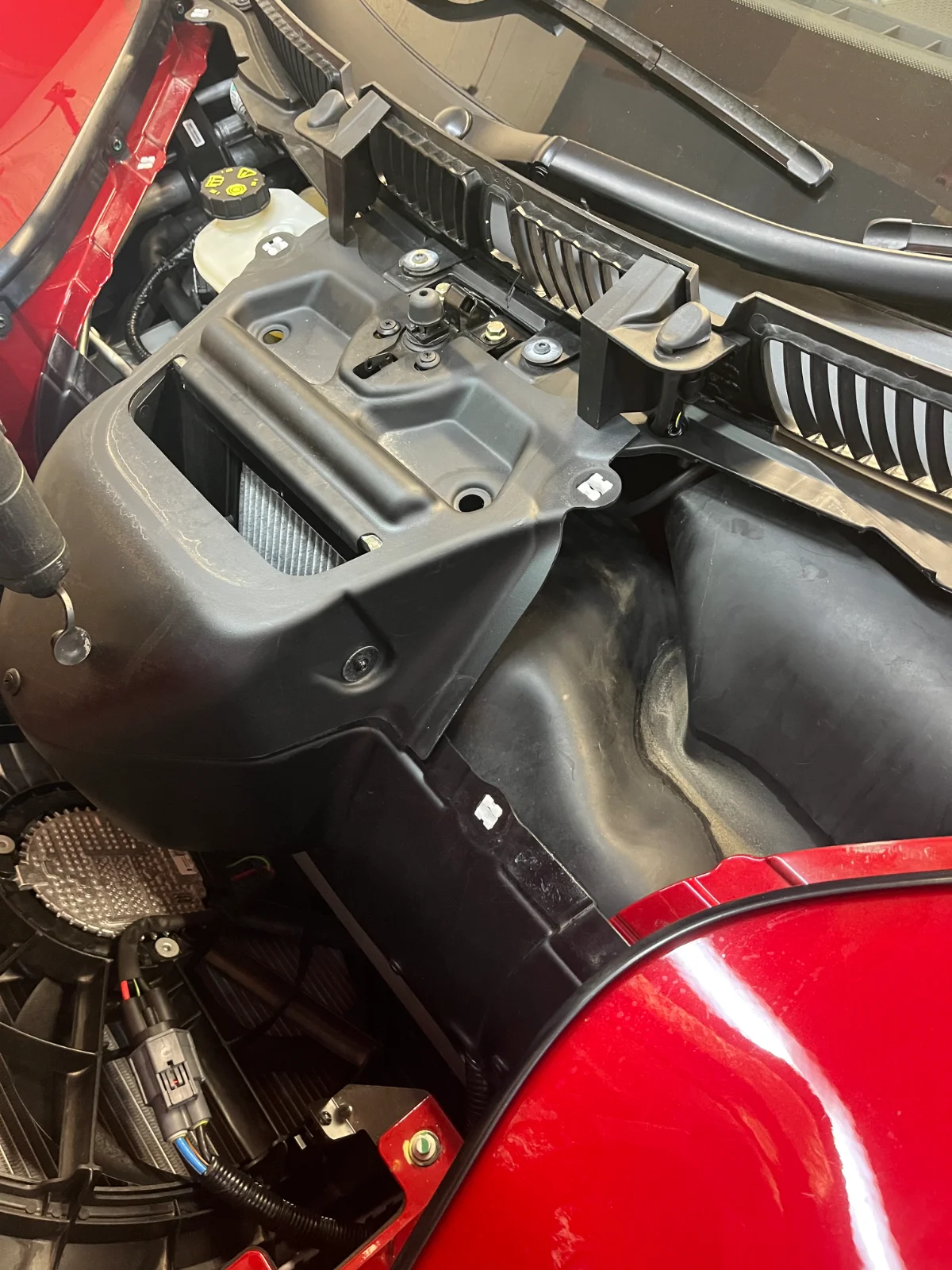

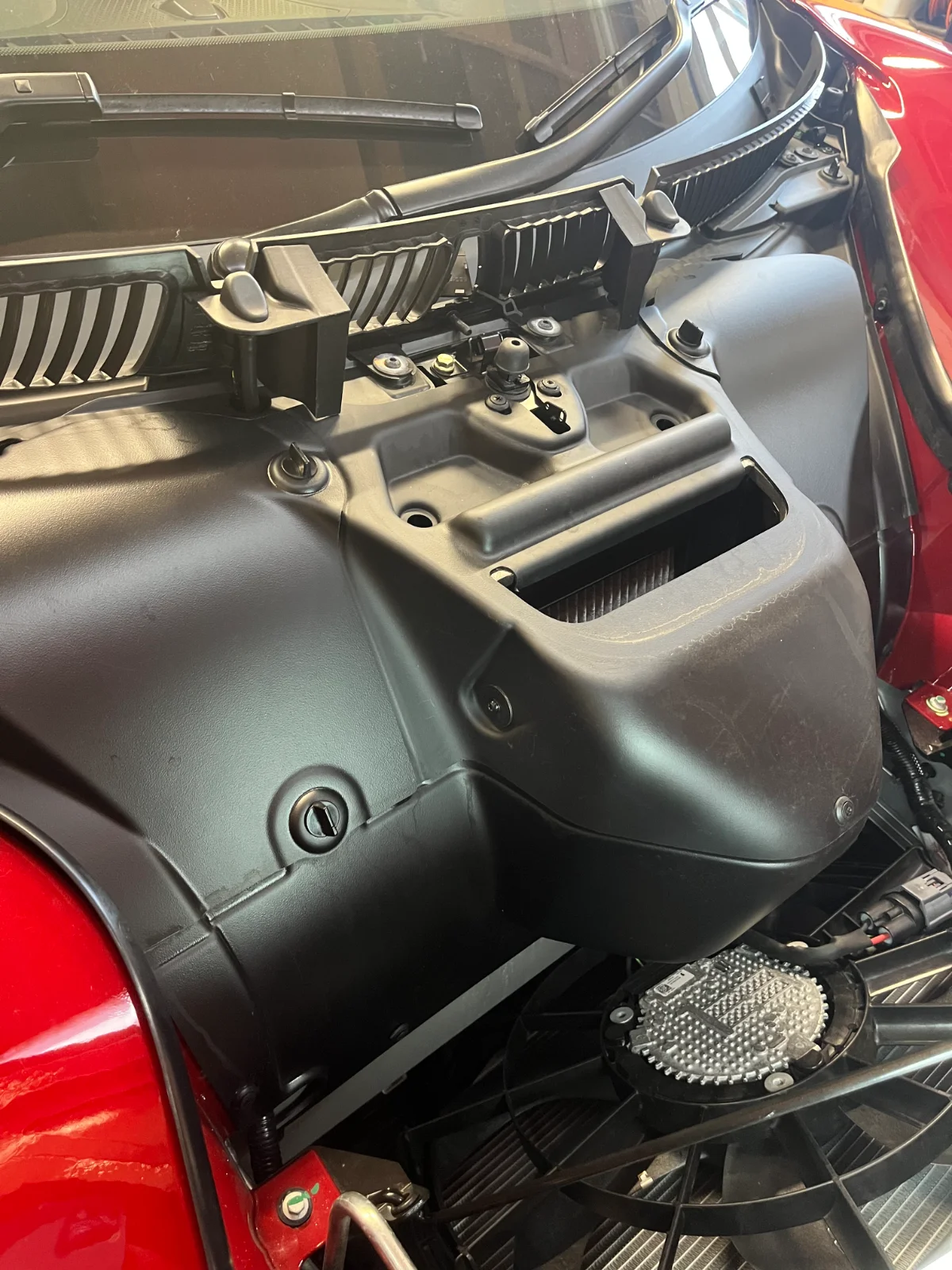

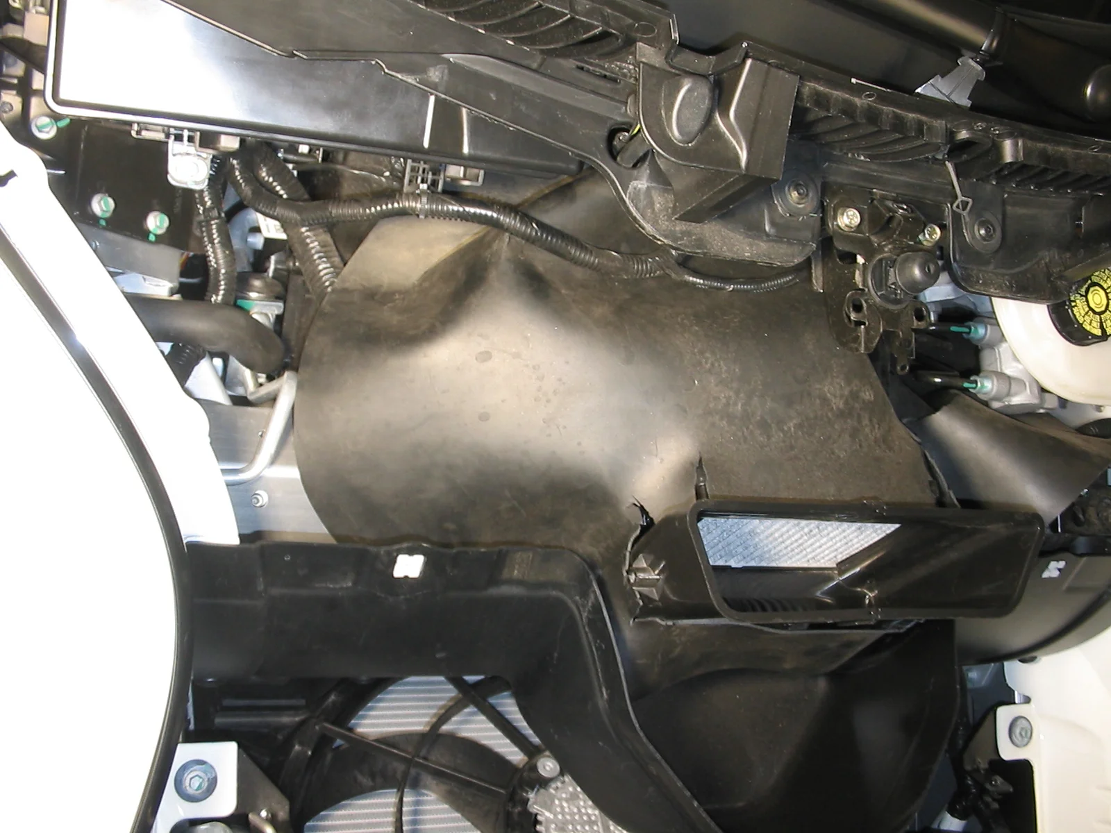

I’ve just checked mine, There is cracking appearing in some places but not yet in the crucial places, it was probably put there about 2 years ago when they changed my wiring loom, fuse box and HVAC unit, I will speak to the dealer and see what they say before I go any further. On removing the hard plastic front casing there are 3 plastic retainer fasteners and the screw heads were chewed up (not by me) luckily I had a bag of assorted ones to replace these, Anyway ongoing I will be talking to the dealership Friday.

I’ve just checked mine, Their is cracking appearing in some places but not yet in the crucial places, it was probably put there about 2 years ago when they changed my wiring loom, fuse box and HVAC unit, I will speak to the dealer and see what they say before I go any further. On removing the hard plastic front casing there are 3 plastic retainer fasteners and the screw heads were chewed up (not by me) luckily I had a bag of assorted ones to replace these, Anyway ongoing I will be talking to the dealership Friday.

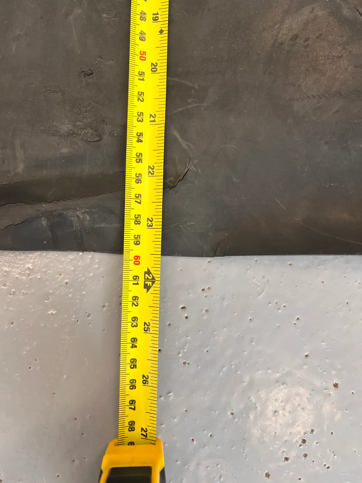

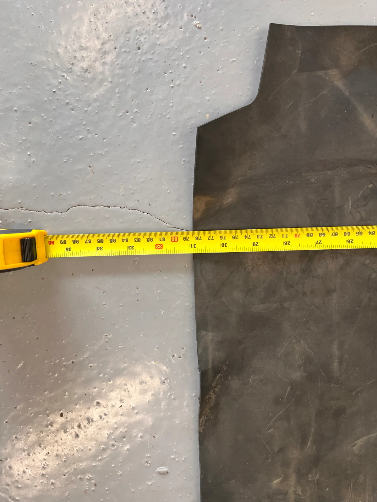

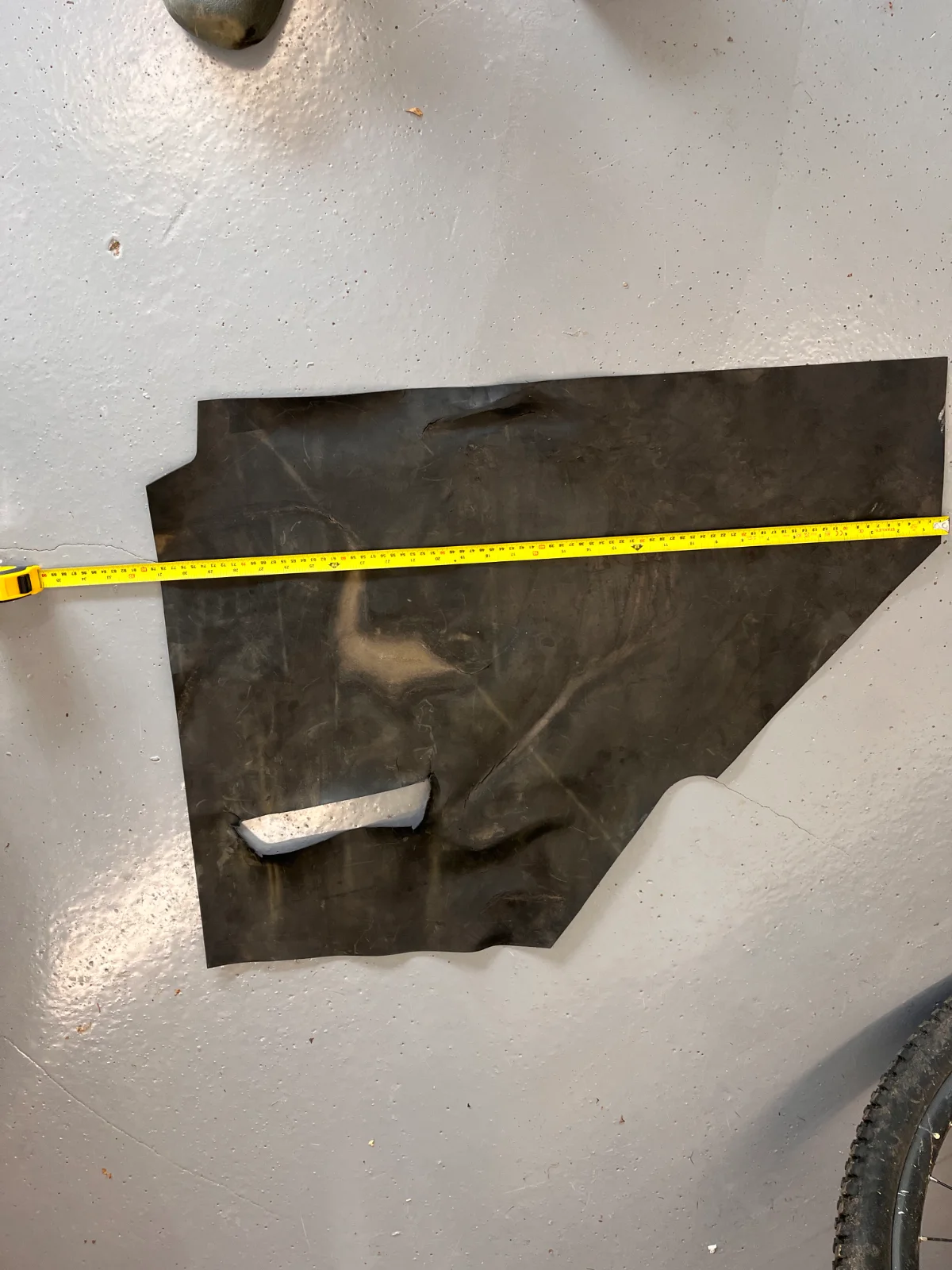

I have just taken my old one out. See pictures with measurements; definitely looks smaller than the one with part number on it?
Looks right - the normal ones are around 80cm by 60cm.

I like how your shroud forms a nice little lake. Why would they install it like that? At the very least install it so it’s smooth, no high points, no valleys you know so water can slide off of it.
