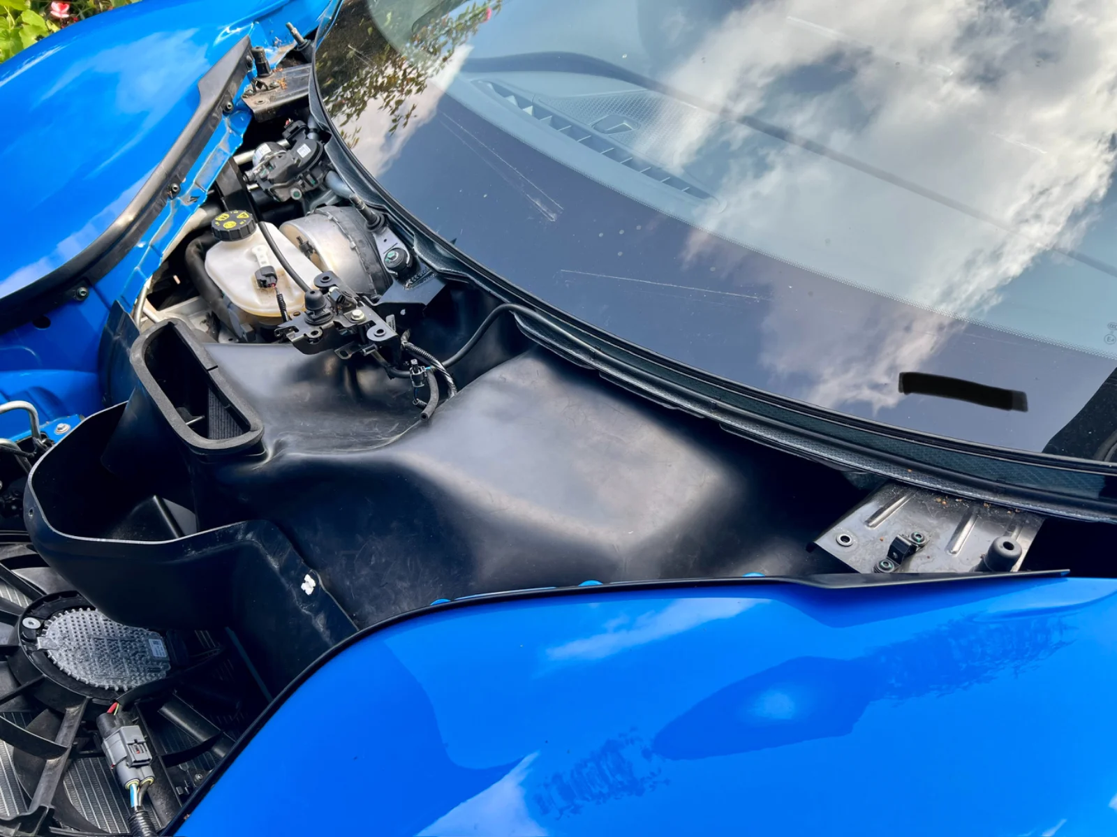

Turns out I don't actually have a "Lotus"-supplied membrane in my car. My mechanic rolled his own solution, because when we ran into the water ingress issues the Lotus membrane wasn't a thing yet. In my case, all the important parts and cables were wrapped individually in plastic. To do that you have to take the front apart. No way to reach otherwise.
I still cut a membrane and left the existing solution as-is. I used EPDM. Material is great but I'm not really happy with how it turned out. It's not a great fit and is basically just thrown in there. I managed to secure it somewhat using the latch assembly in the middle, but dealing with the "puddle" spots isn't easy.
The best cut I came up with ignores the Lotus style and instead runs full width, side to side. For now I've tucked the sheet under the fenders. A better approach would be to fasten it with the plastic clips from the housing along the fenders and somehow secure it further up under the bottom windshield plastic, but I didn't have time to work that out.
Since the membrane turned out way bigger than I expected, it won't fit our laser cutter. I reached out to a few companies nearby that might be able to do it, but interest is understandably low. Right now guesstimated I'd have to ask something like €80–100 per piece, which is probably too much. I could cut them by hand, but that's more work than I anticipated, and I wouldn't want to ship something that isn't perfect. So I'd say you're still better off doing this yourself. I can reconsider if demand is high.

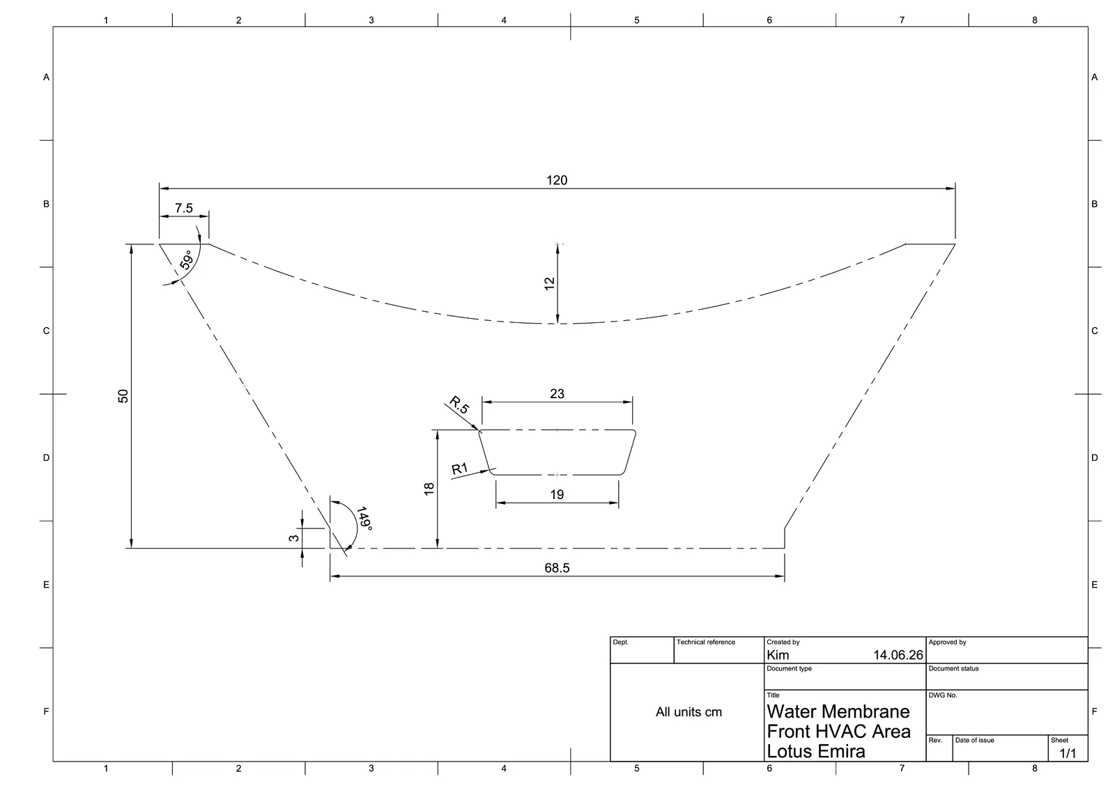

I did, however, already do the technical drawing, which I'll attach. A few (untested) changes I'd make:
  • Increase the width to 125 cm
  • 10 cm on both sides at the top, before the curve starts, due to the longer width
  • Offset the hole 2–3 cm inward
That gives you more material to bring up the walls and thus a tighter fit around the hole.
Hi,
First off that looks like the best well thought out version thus far. I for one would be more than happy to pay for one from you - imperfect or not!! 👍
Will you be posting an updated technical diagram? Very useful information!

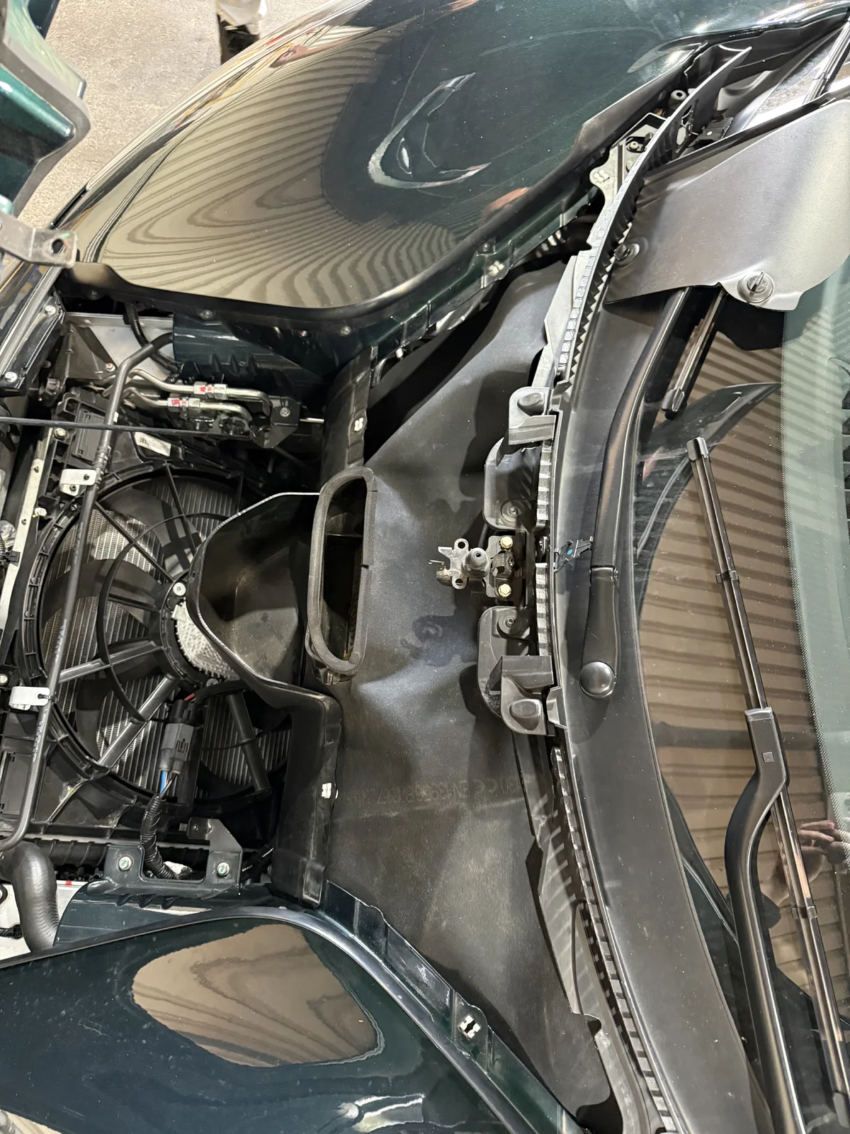

The membrane is a much better fit if the windscreen gutter piece is removed.
Comes off easily. Remove the wipers, the washer jets and some bolts and it unclips from the bottom of the screen.
Then there’s much more space to manoeuvre the sheet into a good position.
Just to add to this thread. My Lotus membrane lasted about 2 years before it cracked, failed and needed replaced.
The Lotus solution is only a temporary fix.
Holy water membrane Batman!! I think you've solved the riddle!!! 😱 How's the pooling? I take it there isn't much due to how you've fitted it? 👍👍
That's what I thought! Anyway to fasten it under the top, or still just a tuck?

Go figure. Mine had the first shroud installed by my Lotus dealer around the same time, in mid 2024, and I also happen to live in Florida (Miami more specifically), so our weather patterns shouldn't differ by much. My Emira is also garaged yet the rubber was degraded and cracked to the point that recently I decided to install my DYI version. I made one of what I hope to be a much better quality neoprene material and coincidentally along similar lines and dimensions shown in @Kimmax's post above # 123.
