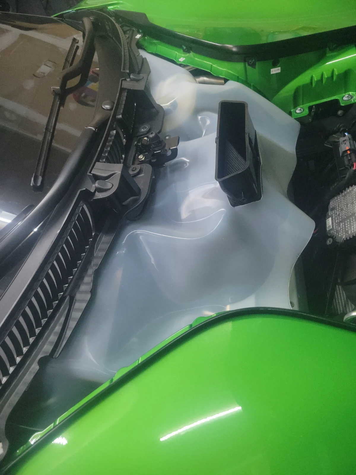

I just installed 1/16" silicone from home depot. On the advice from my lotus dealer tech. I left the OEM in place and put the new one on top. He said if anything ever goes bad they can't blame the the mod for the failure.
After really looking at the OEM one. They actually have it set up ok. The only thing is the fuse box and wiring loom below is exposed.
I don't know how lazy lotus is that they only have 2 loose latches on the fuse box that can wiggle open and no weather seal in the channel ......there is a channel for a rubber seal for crying out loud .
I may go in and trim away some silicone from the heating and coolant lines.
Btw. Silicone stretches alot. Cut the hole for the air filter under sized. Mine is way too loose.
After really looking at the OEM one. They actually have it set up ok. The only thing is the fuse box and wiring lume below is exposed.

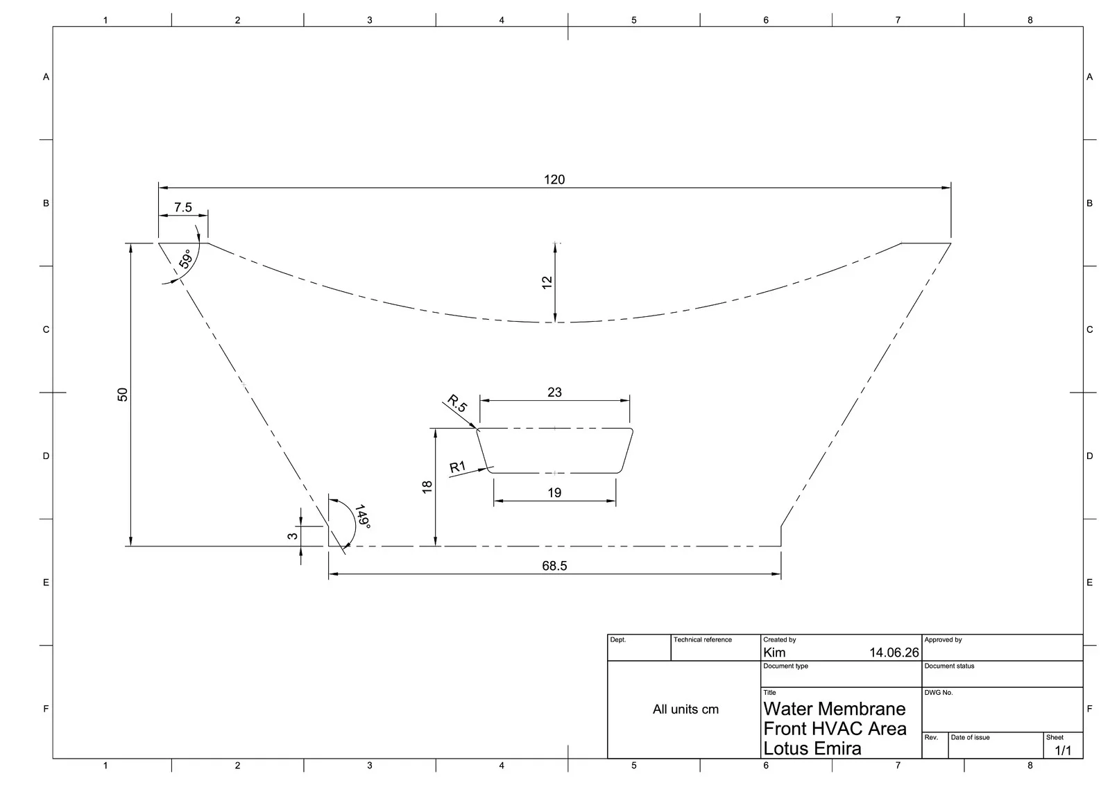

Hi Kim,
Can you confirm the angles are correct, I make it 61 and 151 ?
Thanks
Neil
Hi Kim,
Thanks
Neil
They are not 100% correct as I did some rounding up from millimeter precision. In my case I didn’t even measure them before cutting but draw the top and lower part and then just connected the sides.
In reality it doesn’t really matter much as the sheet extends below the fenders anyway so it only needs to be a rough fit :)
I’ll redo and improve the drawing "to scale" again before production of the sheets to be sold. Will publish the drawing again. But I don’t think you need to wait for that, as-is should be good enough

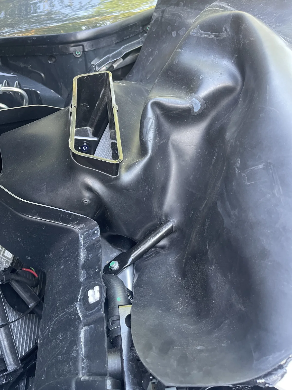

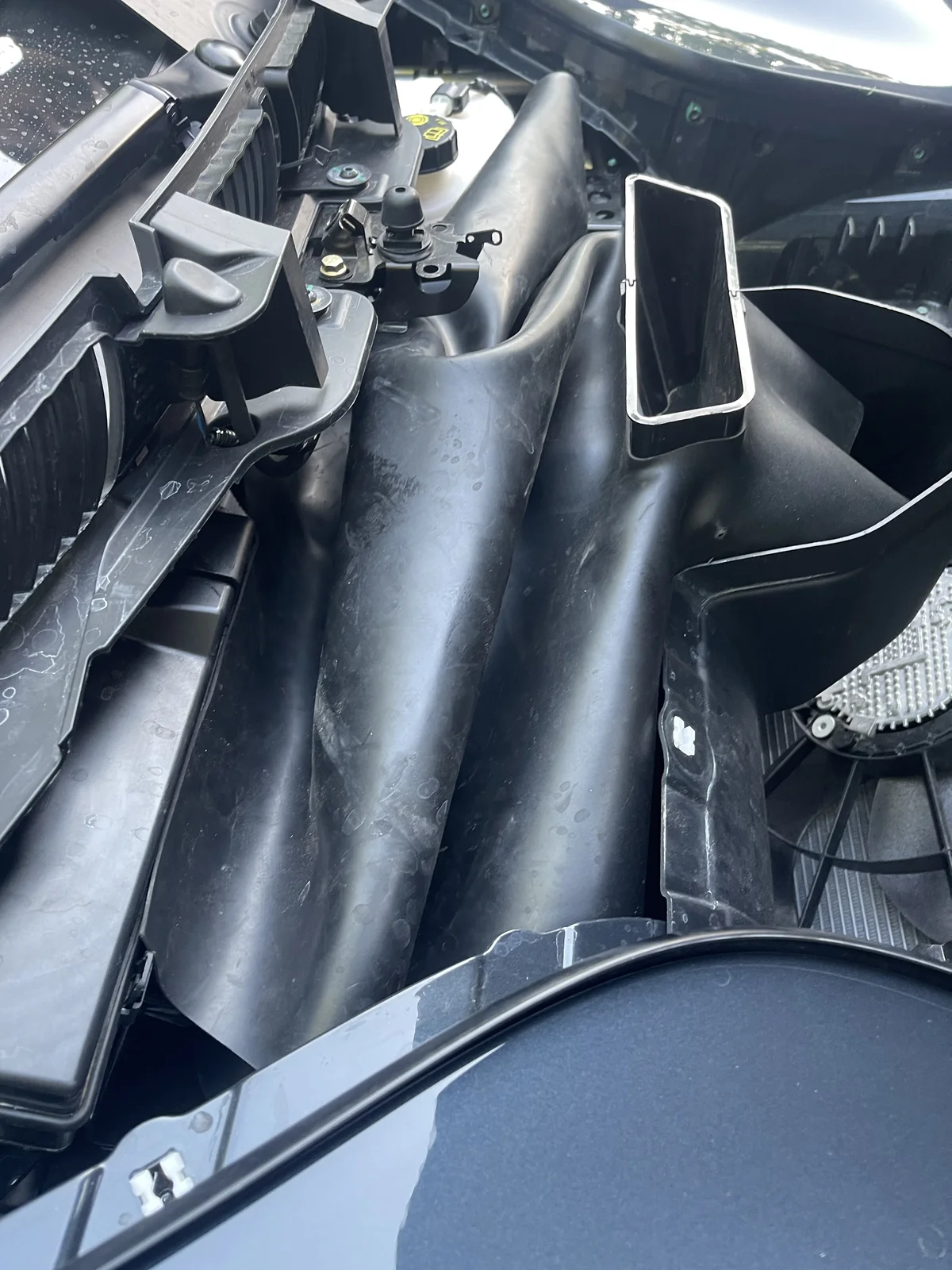

I just opened the hood to check out the Membrane…is that normal? I will most definetly fabricate my own as i dont really trust
the current Solution 😁
Not really (but in a good way). Yours looks to be almost full width, which is unlike the typical dealer/factory membranes that are asymmetrical and tend to focus on just one side. What you have could be a suitable template to replace the inferior OEM membranes most of us have.
Please provide details of your car. Looks like it's a LHD since the brake master cylinder is on the left. Are you the original owner? Is it a '26 model? Is there a part number for this membrane?
Why don't you "trust" what you already have? It seems to have good coverage for both sides and a snug fit on the duct. How would you improve upon this? I think I would be satisfied if such a membrane was in my Emira instead of the dubious piece that it originally had.
I just opened the hood to check out the Membrane…is that normal? I will most definetly fabricate my own as i dont really trustView attachment 83770 the current Solution 😁View attachment 83771
You have good reason not to trust the way that your shroud was installed. One of the two principal components it is supposed to cover and protect from water intrusion is the Fusebox, (on left side of your 1st picture). It was left uncovered and exposed which defeats the purpose of the shroud.
