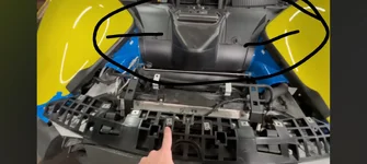

I've tried to mark up where I think it is... Like I say I've not got the car yet but it looks like there's no membrane there...

That certainly looks a more permanent solid plastic fix, if I am looking at that pic correctly
The membrane is underneath the plastic covers
Ah, ok gotcha. I just hadn't seen any pics with the black plastic covers on before, as all the ones on here seem to be without them on and just show the crappy rubber membrane.
So, next question - please forgive my ignorance. Why doesn't the rubber go on top of the black plastic cover? That way it would follow the contours and water would run off naturally instead of pooling on the rubber underneath the cover if that makes sense...?!?

Gotta ask lotus that question. The rubber shroud is clearly a bandaid fix they decided was good enough, who knows if they'll ever implement a real solution.

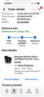

So following the really useful info here, I bought some neoprene rubber and decided to make my own, I have taken a few photos showing what I found, the membrane we bought and how we installed it, I have left the Lotus one in place and will flag it at the first service.

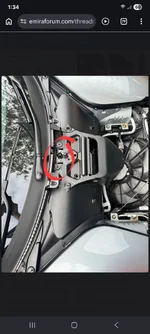

I wonder instead of this membrane can we seal the plastic covers better? Since the membrane is over the top of the electronics, lotus believes the water intrusion is coming from the top. I wonder if it’s possible to make those plastic covers better sealed using maybe door weather stripping from a home improvement store
Interesting idea. But I think if you have a pressure washer or major rain storm, water will also flow over the center windshield trim right into the gaps where the center bracket that holds the hood down.

This sounds good to me. I'd rather waterproof it on the OUTSIDE than let the water in only to be (hopefully) defeated by the membrane. I wonder if the whole plastic covers could be clad in the rubber sheet... 🤔 Potentially it could be fixed to the plastic covers with silicone sealant? If the sheet needs removing for access to the service bay, then a hobby knife along the silicone seal would remove it quickly and hopefully leave the sheet in tact? Just spit balling, so it's not all going to be gold!! 🤣🤣🤣

I wonder if rubber sheeting could be placed over the bracket somehow? Maybe with slits cut into it to allow for the bonnet (hood) latch to slip through? We need a scientific mind on this!!! 🤣🤣🤣
Mine is a V6 manual although I suspect the location of the key water-vulnerable parts, which are the HVAC resistor at the bottom and Fuse box at the top, are basically the same in the i4. Judging from your pics, the design of my DIY shroud version (also from neoprene) came out very similar to yours with perhaps the exception that I went deeper in the bottom section reaching basically to the end of the lower plastic covers. This because I wanted to ensure that I covered entirely the HVAC resistor pack part which sits almost vertically below the plastic pollen filter encasing. Time will tell if the neoprene material will hold up any better than the oem one, but something tells me it can’t be any worse. I second your recommendation that everyone check their oem shrouds, particularly when reaching the 2 yr timeframe. The consequences of water infiltration are not insignificant.
