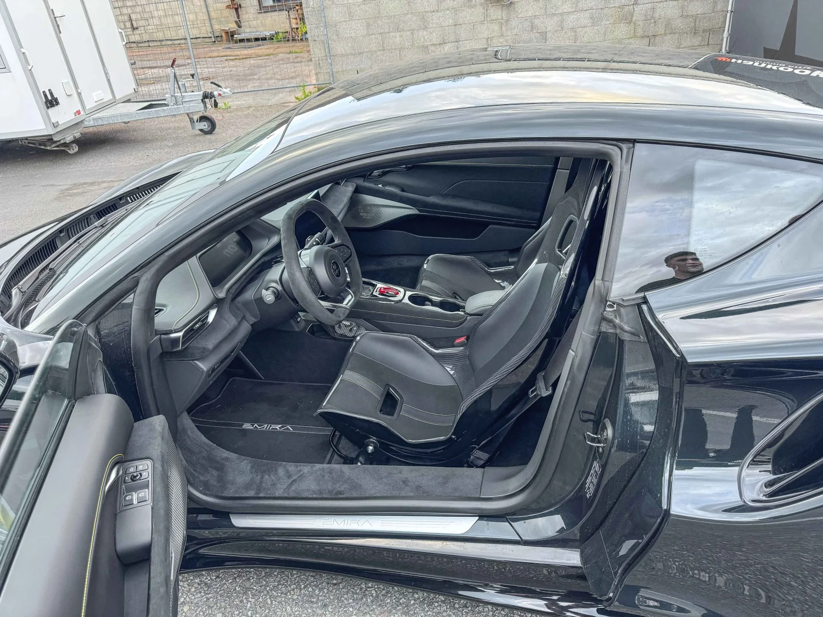

My seat is not high. I can drop the head and shoulder height over 4 inches from the standard position. The one in the picture is set for me at 5ft 10. I'm still much lower than standard with the seat like this.
This is Komotec's car with the same seat in.

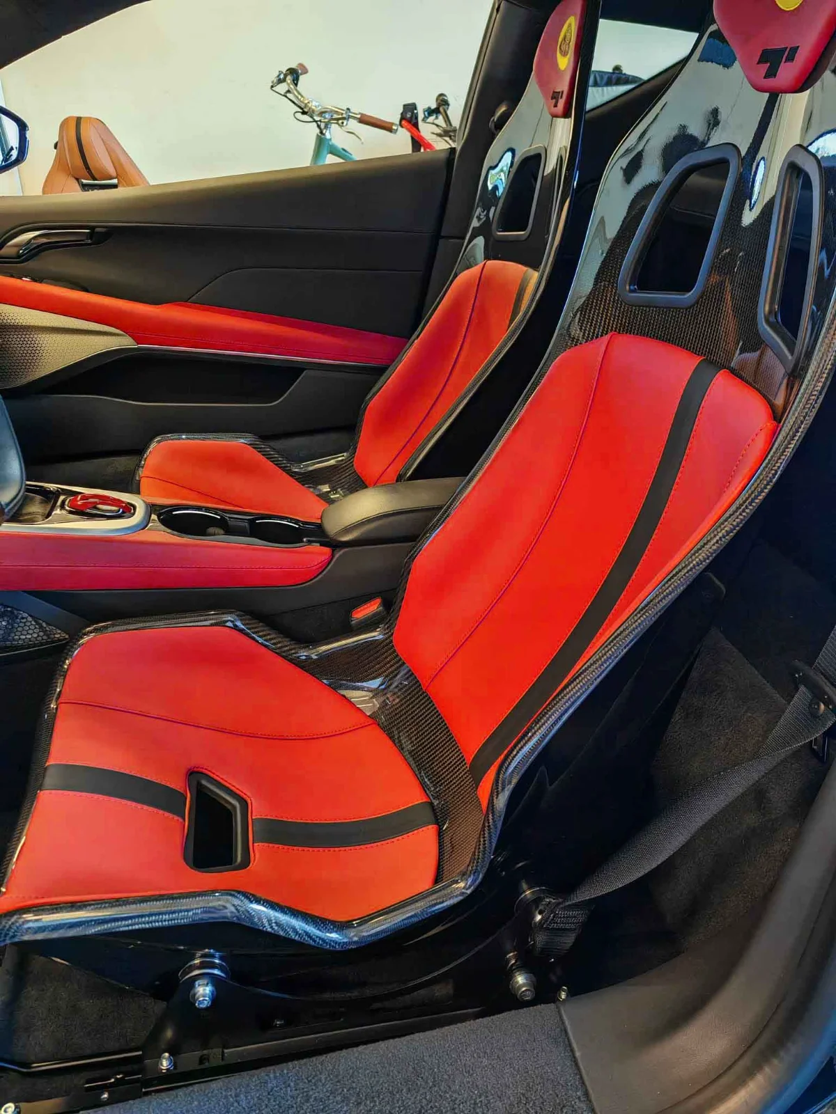

We can do a matt version. It is a lacquered finish applied after manufacture. We do it for Caterham sometimes on their carbon.

I don't have a picture of them done in the red. We can do it though. I guess it would look like this.

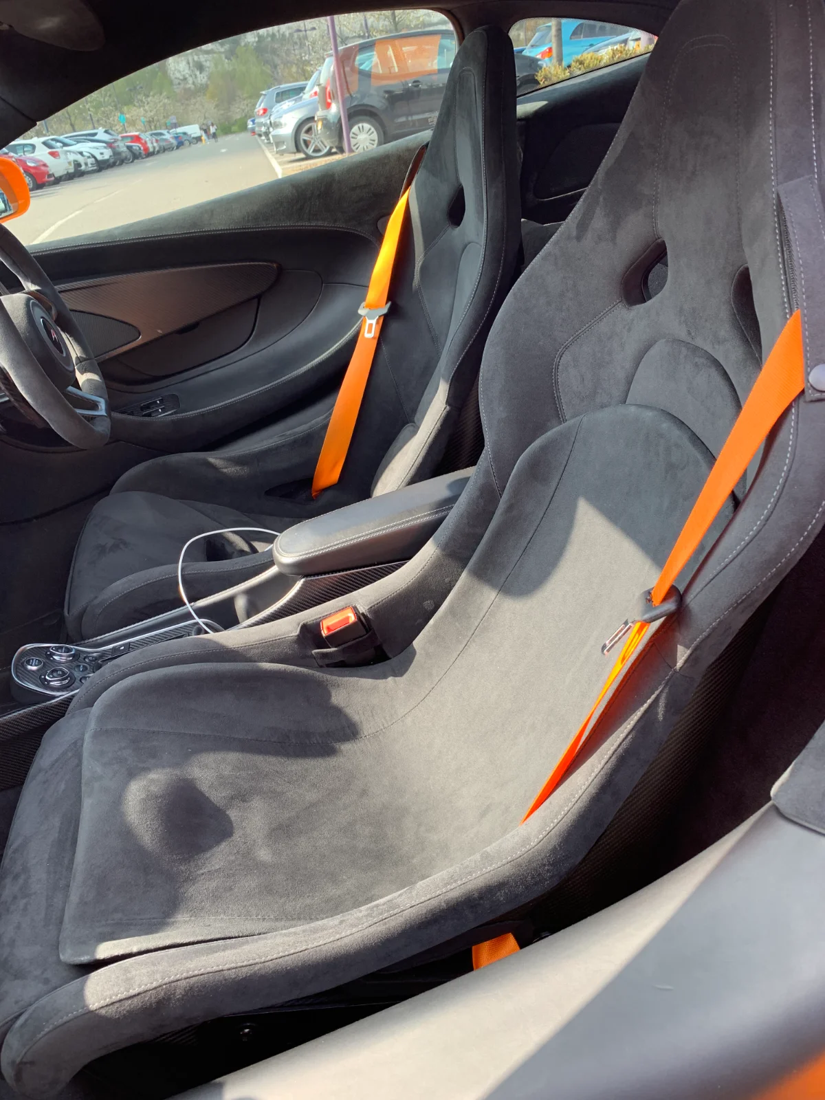

We did exactly that for someone with a McLaren. We sat a modified cut down B6 composite inner skin on the seat and it stopped the small lady from sinking too far into the seat. It didn't even need padding, Just the shape made it lift her and make it more comfortable.

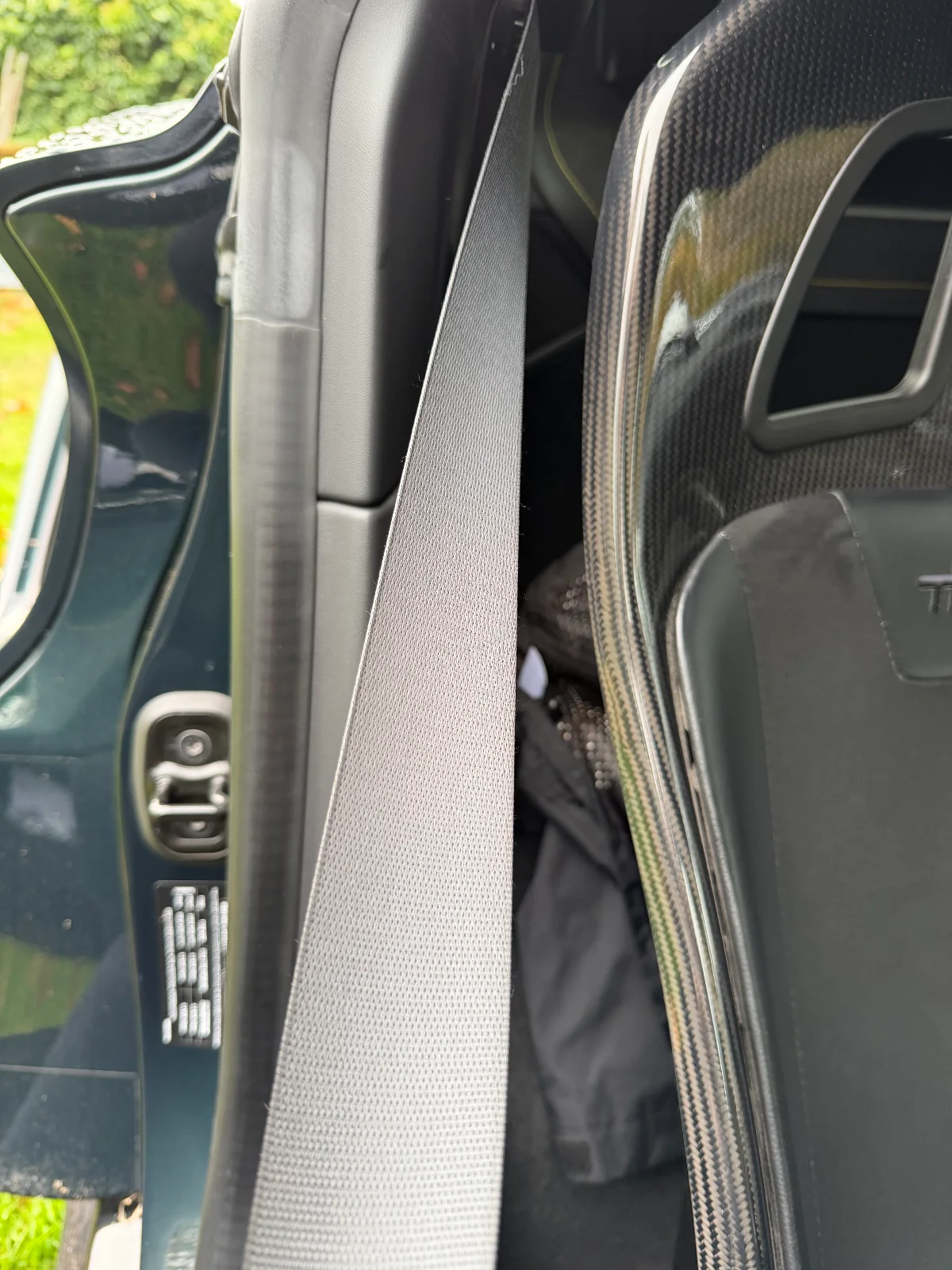

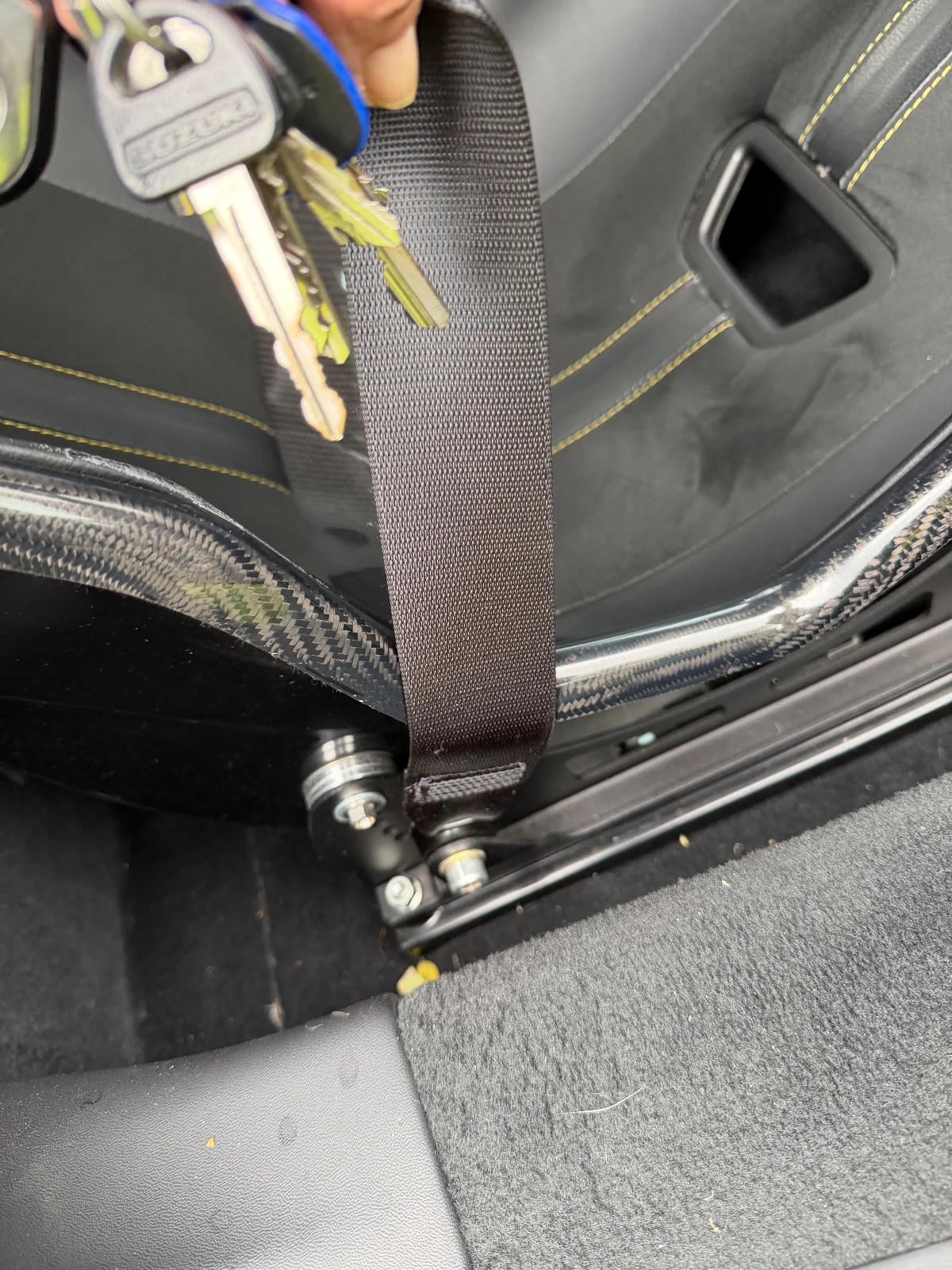

Do you mean you are worried about the OEM seat belt rubbing on the hard shell? My car has done 18,000 miles and there is no sign of rubbing at all. The edge where the belt sits is smooth and unlike in the OEM seats you do not wobble from side to side so they will not wear when they don’t move. Also you sit lower so the belt doesn’t drag over the edge of the seat.
