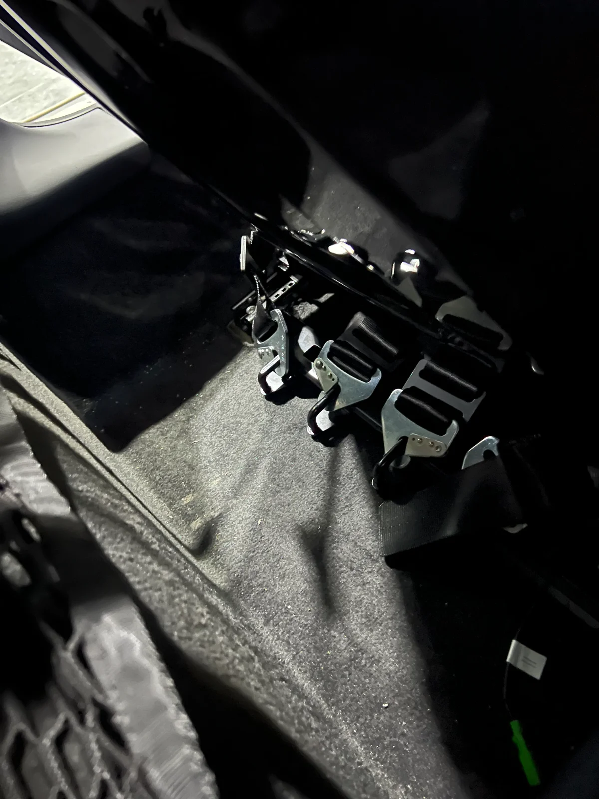

These are some fittings for harness mounting, that came with the harness bar i purchased. Hopefully these will work with the Tillet. They are Emira specific but intended for a Recaro seat rail/fittings i believe.

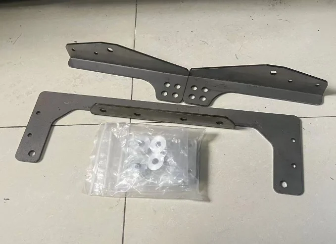

We test fit our 5/6 belt mounting setup on Friday, making a couple adjustments and it should be ready to be ordered later this week.
Direct bolt in for the Tillett mounts and it will be part of/on the slider assembly so if you move your seat you dont have to worry about adjusting the 5/6 belts which is a pain.

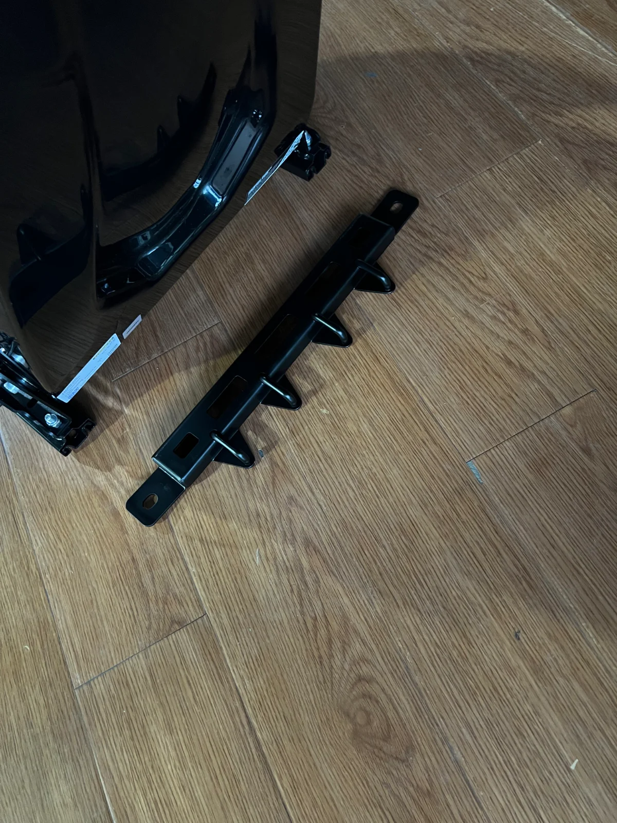

We have those 5/6 sub strap mounts available on the website now.
A batch of them is being welded up today and off to powder coating on Monday.

Is it just the 1 bolt per side for this?
Correct, it ties in and uses the existing bolt locations on each side bracket along with the bolts that thread into the seat. It locks in via the bracket on the bottom so it cant rotate. We did it this way so that it "slides" with the seat when its moved so you dont have to adjust the 5/6 belt, it also ties the side brackets in together and adds overall strength and rigidity.

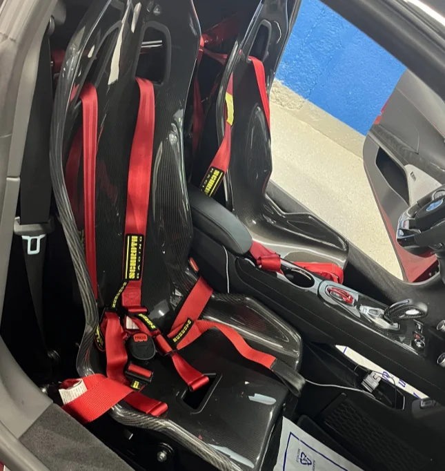

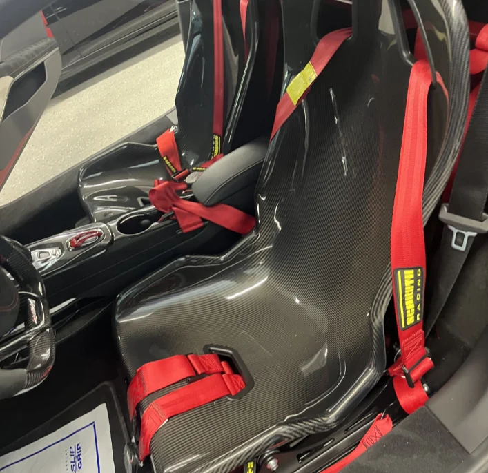

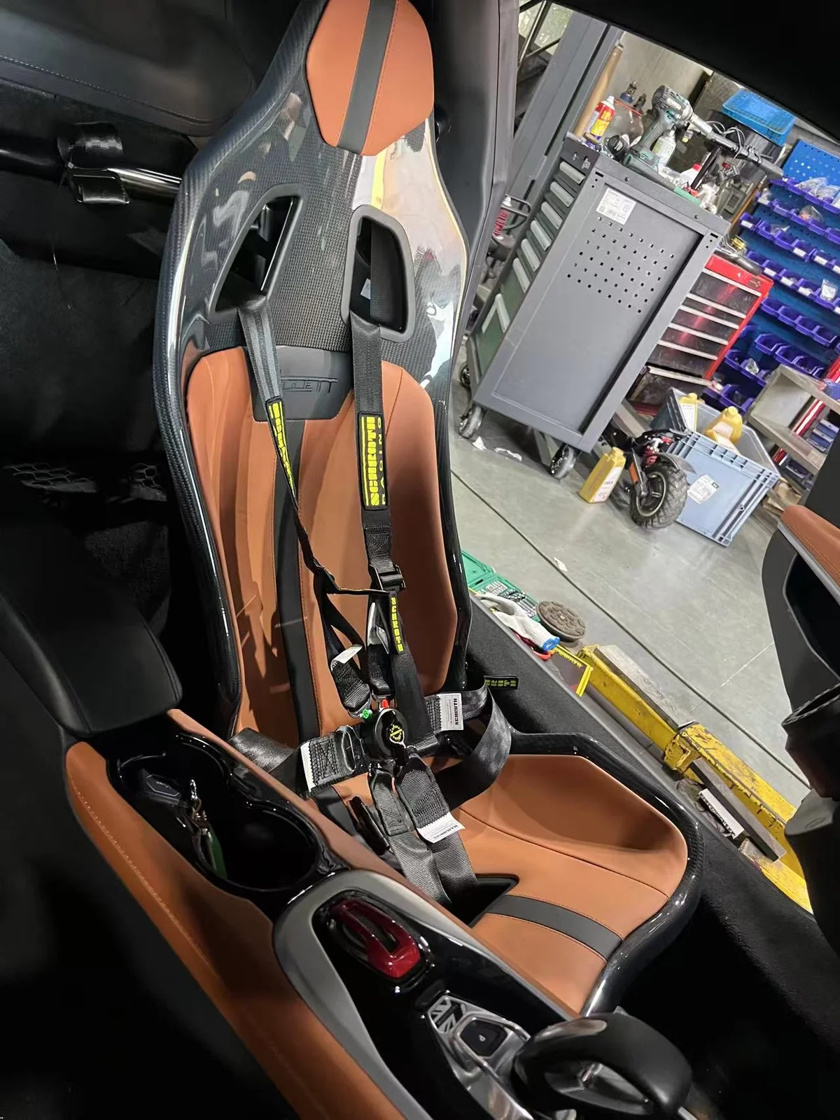

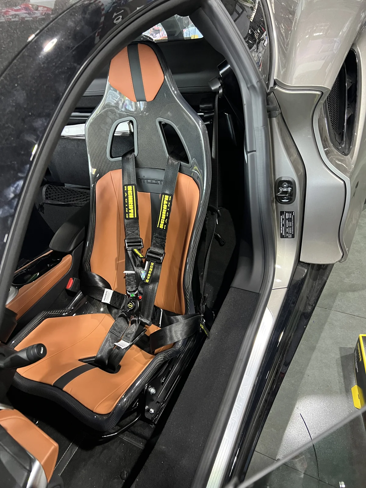

Just fitted 1 of my new Tillett seats, along with a 6 point harness. Bolt in harness aren’t too common here, but made snap in harness’s fit just fine IMO.
Are these as safe as a harness bar? (in terms of submarining). Where do the bottom straps mount to?
i have a harness bar, only the lap and crotch belts are fitted to the hooks on the floor (crotch to the 2 inner hooks, lap belts to the outer hooks). I looked at the FIA harness regulations and the angles look fine for all the belts (US regs differ on the crotch belt angles). All things considered, i think this works and it mounts everything to the body, rather than the seat. The floor mounted hooks are a common product intended for the GR86, that happens to match up to the Emira bolt spacing.
