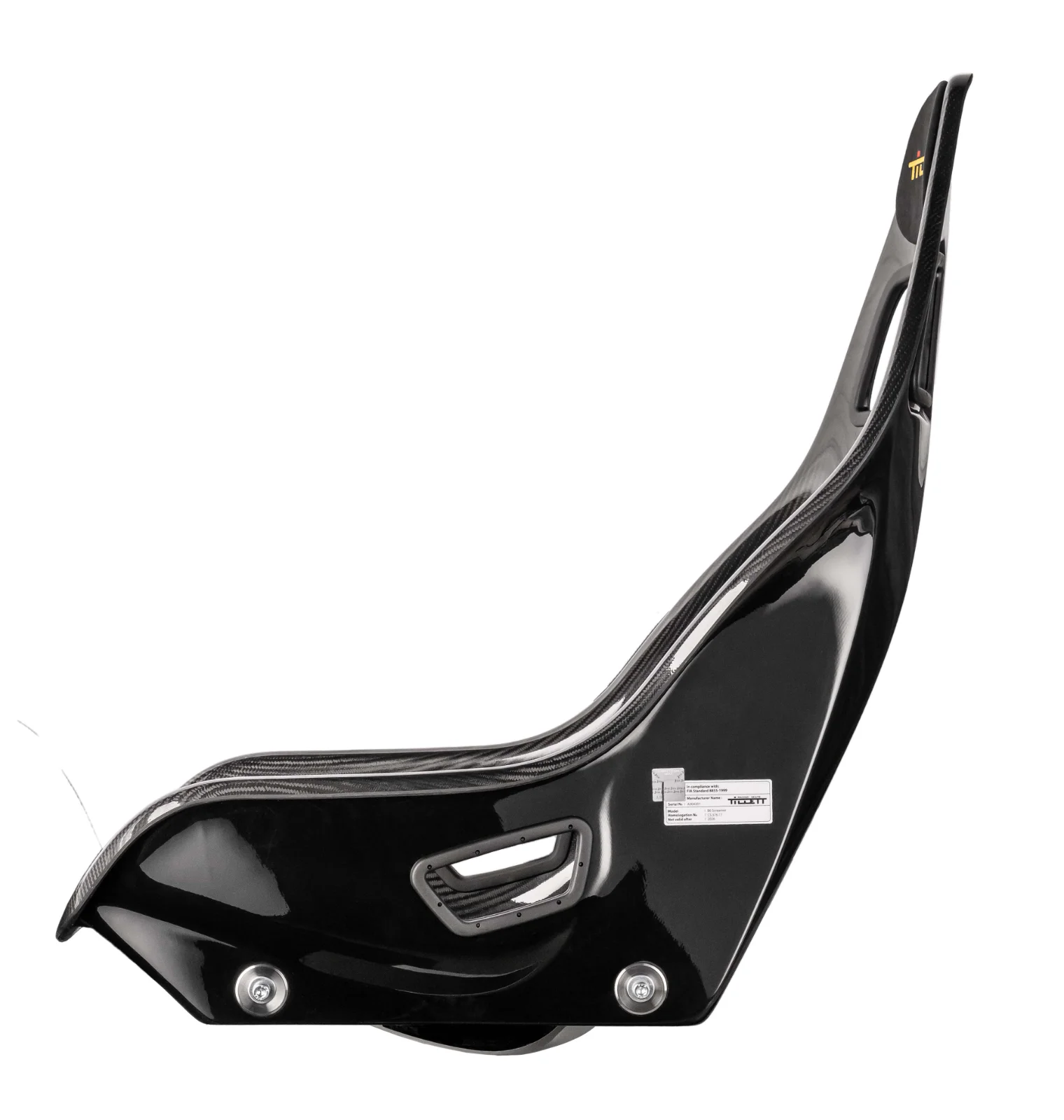

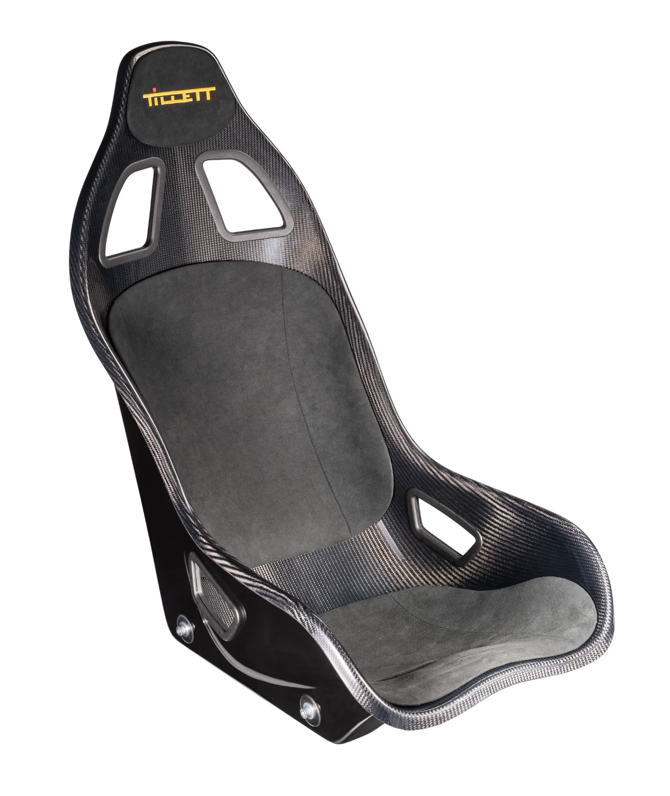

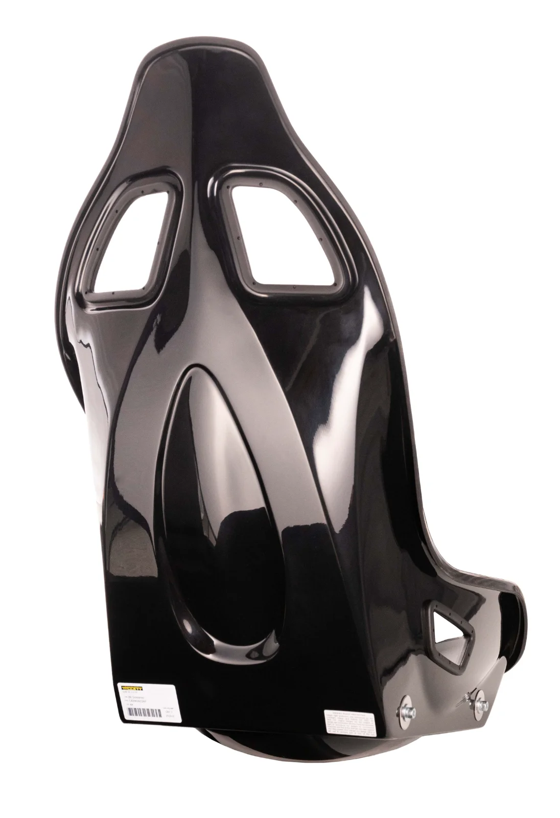

Ah! well if they came from the Exige it is unlikely they are the B10 XL seats. It could have been a B5, B8-43, or a B6-43 XL.
You are certainly able to use the standard size of our B6 or B10 seats, which would nip you in the top if you were in one of the above. By the sound of your requirements a B6-44 Screamer would be better suited to track work. Make sure the steering is close enough too. The driving position with our seats benefit from a bit more distance between the pedals and the steering.
