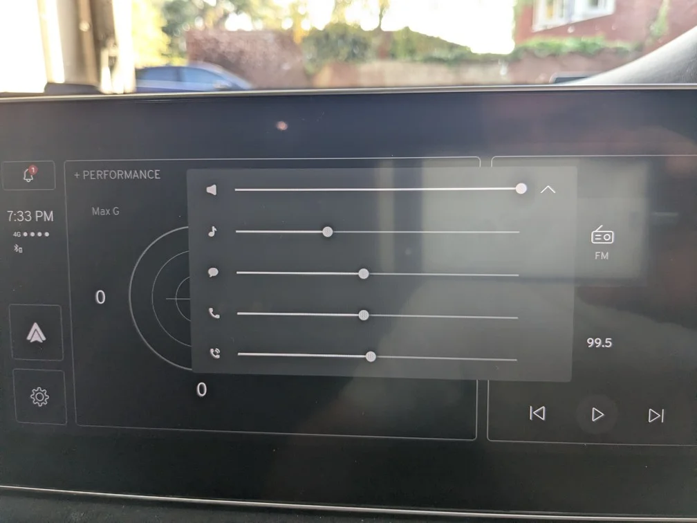

I didn't check this fully, but my one reset to 50% a few times, then I set the master volume using the 'drop down' volume control on the display when you change volume, rather than the global settings. The top slider in the drop down is master volume. I've not tried changing it again now it's not dropping to 50%.

Interesting. I haven't noticed so where is this drop down menu you speak of?
The one which appears when you change the volume, if you press the down arrow on it's right hand side whilst it's on screen you get all 5 volume controls.
Wow. Learn something new everyday. Thanks for this! I'll try it out and see what it does.
Wow, indeed. I tried this, and it works. Master volume is now also set at 100%, and remained there at least once when you do it this way.
Great news, thanks for posting this, a really big help
