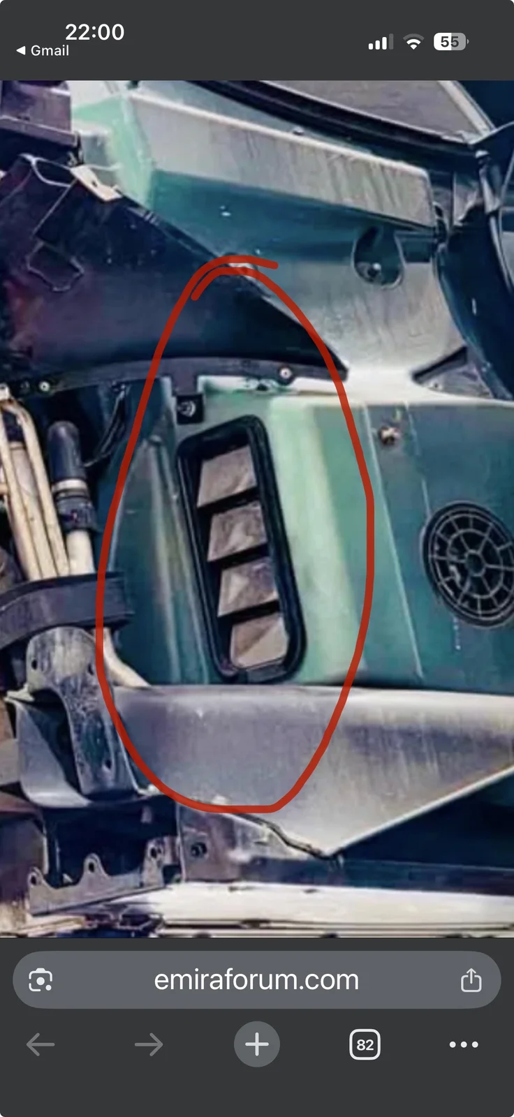

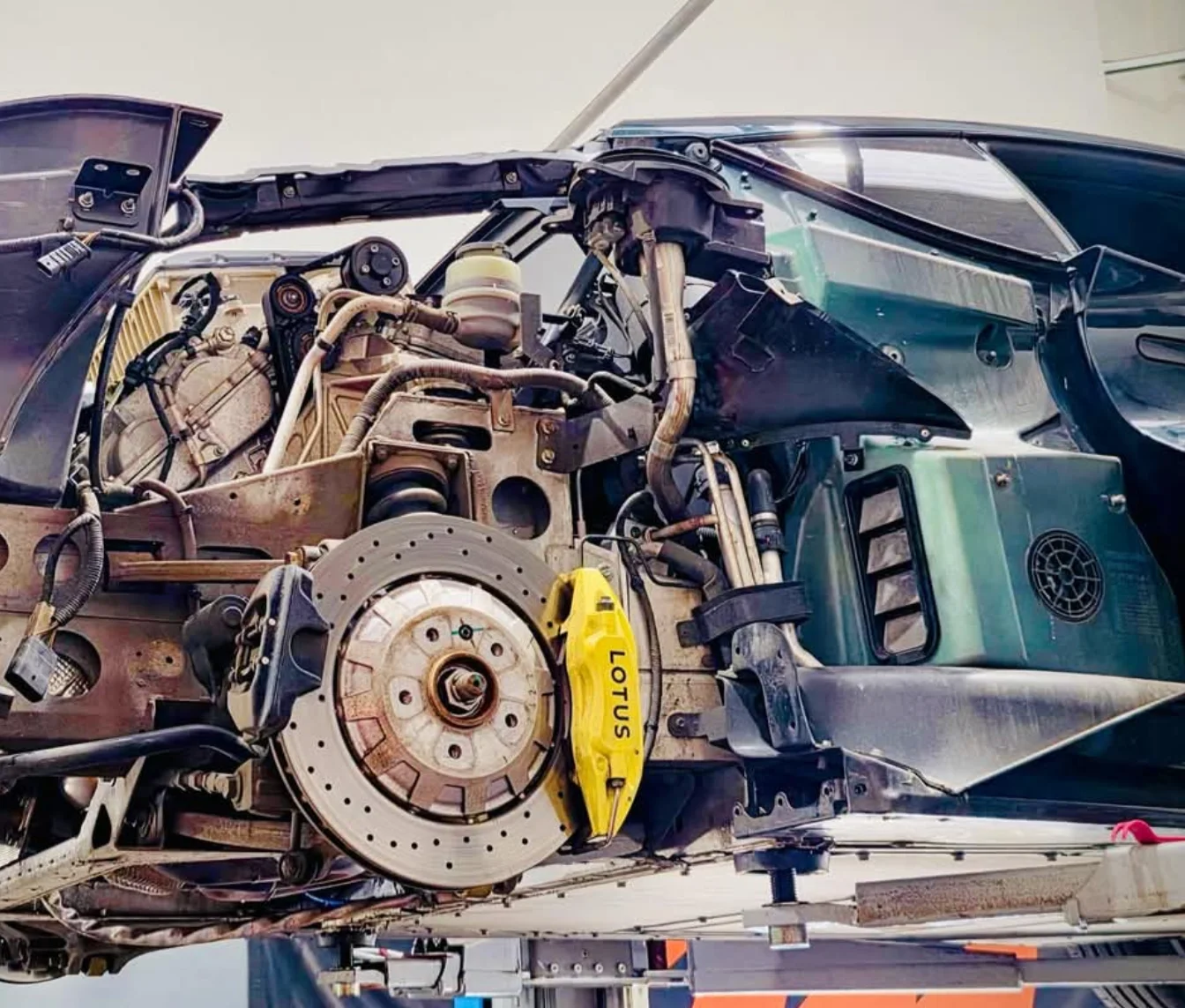

I drove about 500 miles today and had the stereo playing at about 50% volume listening to all kinds of music. I had such a smile on my face with the windows down doing 80 mph on the interstate with clean and proper bass. What an amazing difference! It really made the trip so much better that I could listen with the windows up or down and still have decent sound quality. Hard to believe that it left the factory with those stupid rubber flaps right next to the subwoofer.

OK, I just performed this surgery, and I can confirm that it works. Subwoofer no longer sounds like its blown while driving with the windows open. That said, be aware that you will get slightly more road noise in your car. Also, the subwoofer itself isnt exactly amazing, so this makes it waaaaaay better, but by no means does it sound like a high end system.

Ok, so i've just performed the surgery too. OMG, it is amazing to have a proper sound system in the car. WHAT A DIFFERENCE!
Took me two hours.
Was able to do it from the inside of the car.
Reach in and prise the clips with your fingers and it pops inward to the wheel arch.
While holding on to it of course (though I think if it did fall in, wouldn't be far and you'd just grab it).
Tilt it to get it out.
Rip off the dumb flaps and perform the foam surgery.
I used scissors, foam, super glue and a needle / thread.
Not that I think it needs it, i used some thread to give it some extra support (it is after all the air release for when you shut the the doors).
Tested door shutting when i put it back in - seems solid.
Tested the audio on a drive with the windows cracked at various levels - what a difference.
Just a shame Lotus doesn't have a fix for this. I'd hope some dealers might do it, if they see this thread.
