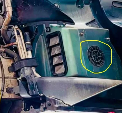

The circular vent to the right is for the Sub, it's a Free-Air Subwoofer
Just a thought.... but if the 'Foam mod' used to fill the flap vent was not able to pass air quickly enough when the door is slammed, it may put stress/pressure on the actual sub diaphragm, being a free-Air design ? That cabin pressure increase has to try and escape somewhere 😟
That's a fair point. So far so good i'd say. I guess the solve there is make sure the foam is not too dense / poke some holes in it.
I mentioned this in another post that the foam has to be breathable.

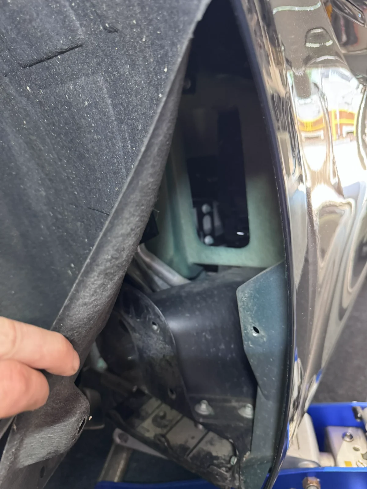

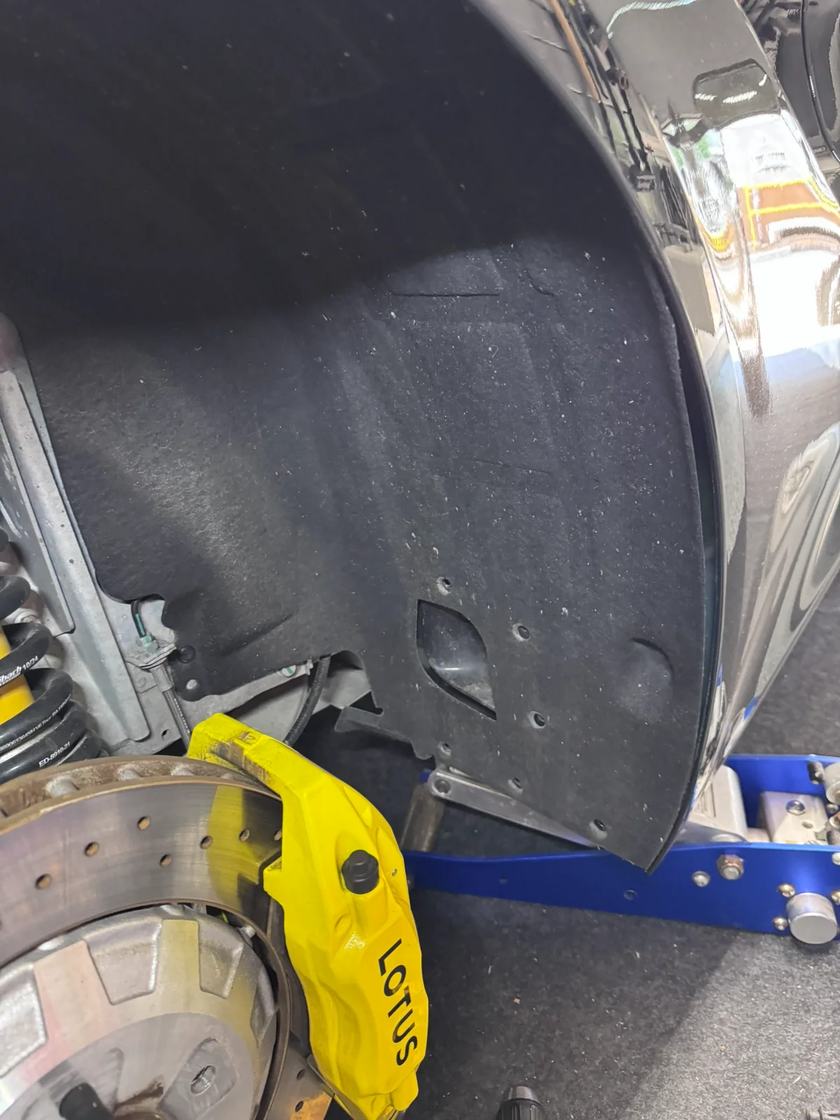

First of all, thank you to the person who figured this out, was driving me nuts listening to that blown sub sound, like it was clipping.
I do want to comment however that going through in the interior would not be my recommendation, it's MUCH easier to just go in through the fender liner. Getting it out is easy and will give you a false sense of hope of being done in 10min. Getting it back in is a nightmare. There's a 75% chance you distort/break the cheap plastic trying to get back in, no matter what I did, any of the various hooks/tools I attempted (I have a lot) I just couldn't get it to clip back in securely on the far side.
After an hr I said screw it, put it in the air, removed the wheel and partial fender liner in 10min and had perfect access. If I did it again, I'd just go straight through the exterior for a few reasons.
  1. The fender liner clips Lotus use are actually quite good. Usually these things break and have to be replaced, these ones came out and went back in no problem.
  2. You don't have to remove the full fender liner, just enough to bend it back
  3. You don't even need to remove the housing this way, preventing any chance of breaking the seal/damaging the clips. You still can, but you have such easy access you could technically replace the flaps with foam with it in place if you chose to.
  4. If you do remove it, putting it back in is 10,000x easier. Also if you happen to break a clip or it won't re-seal, you have access to the backside, you could glue/hot glue/gorilla tape the edges if necessary.
  5. You don't have to cortortion into a tiny space in the interior
