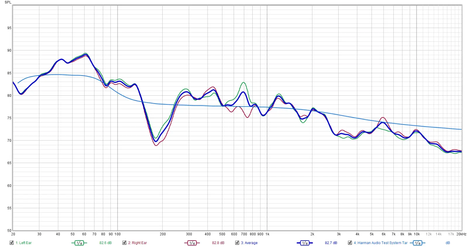

On to the measurements. Let me state clearly that I am not an expert at measuring car audio environments. I don't know all of the potential pitfalls that could happen, and I certainly don't have the right equipment for this. I am guessing that the proper measurement rig would consist of a dummy with calibrated binaural microphones. Plus, multiple measurements would need to be taken at different seat positions and the average calculated from all measurements.
What I did was sitting in the driver seat at my driving position and holding my UMIK-1 microphone to about my left ear, and rotating/moving my head around within the normal range of head movement and rotation while driving to perform a moving-mic measurement. I then repeated this with my right ear. I then averaged the two measurements and applied 1/6 octave smoothing and below is what I got:
The green trace is left ear, and red trace is right ear, they are remarkably similar. The thick blue curve is the average of the two. The thin blue line is the target "house curve" that is typically the one used by home audio people. You generally want to have a sound system response that is "close" to this curve as it represents that *most* average people regard as a good sounding system. One warning about moving mic measurements is that the treble response is typically lower than fixed point measurements due to the averaging effect of off-axis movements. So the system is actually a bit brighter than what the measurements show.
Bass output rolls off after about 40Hz, and the bass response peak is at about 60Hz. Factoring in the 12dB/Octave cabin gain of car environments, this subwoofer is simply giving up below 40Hz. Ideally, you want the bass response to be just about a flat line down to about 25Hz or so.
The dip at 200Hz may correlate with the "a bit shy" comment I had. Although instead of a mild overall dip, this is a narrower dip of a more significant magnitude - about a -8dB dip if we reference the target Harman curve. Psychoacoustics theory indicates that humans hear relative loudness in "bands" of frequencies rather than fixed frequencies.
The midrange response from about 300-2kHz is nice and even.
There is a slight dip between 3-5kHz, but it's really not that severe. Female vocals may be lacking some of their natural sibilance, and some instruments may sound slightly muted, but it's not bad - I didn't hear these issues.
Relatively speaking, there is a peak at 6kHz and 10kHz, with generally elevated response in between. This may be the slight brightness that I heard? The human ear is more sensitive to peaks versus valleys in sound. Our ears are trained to notice additional information versus information that's missing.
Overall, the response curve looks decent in that it follows a general downward slope from bass towards treble. This system has obviously been tuned by someone who knows what they are doing. You don't get this type of a frequency response slope by just slapping drivers together and connecting them to an amplifier. Other than the valley at 200Hz, there are no serious issues. I'm interested in finding out if the 200Hz null is a production error: the subwoofer may be wired out of phase. I'm going to do some wire swapping when I have the time to see if the null is resolved once the subwoofer phase is reversed. Of course, it could also just be that 200Hz is the frequency that this car's cabin develops some nasty nulls near the listener's head position. If so, there is nothing that can help alleviate this, unfortunately.

Update: Posted measurements in the 2nd post of the thread: Link
My biggest issue is how much the bass changes with the windows down -- not sure this is able to be rectified due to the open-air design. I'm wondering if a more traditional sub can be fitted and possibly sound better.

Well done on the measurements! I also have a Umik-1, I'll have to pull it out and do some experimentation myself.
The 200hz dip may explain the complaints that some have with bass lacking on certain music. If it is a null issue, you'd think they would have solved that in the DSP on the amp by doing some phase shifting in that frequency range.
Yea, fingers crossed that they just wired the sub in reverse phase. I measured the same null in both driver and passenger seat.
In that range it could also be the midbass drivers behind the seats. If the door speakers and sub are in phase but the midbass units are reversed it could do some really weird stuff.
  • #17
True, there are some different possibilities here.

The measurement I took are with everything flat. By ear, I preferred a -2 on the treble. Bass and midrange at 0.

Excellent effort, and perfectly acceptable considering the environment you're testing. That dramatic drop at 150-250 hz is very unusual. I can't imagine they saw that when setting up the system and just decided to ignore it.
