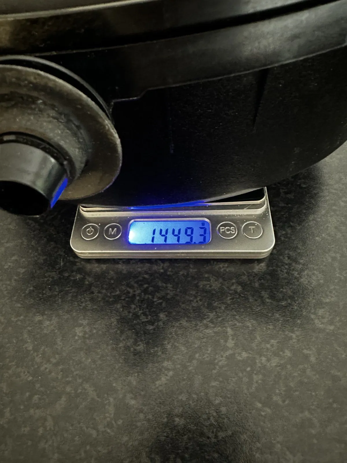

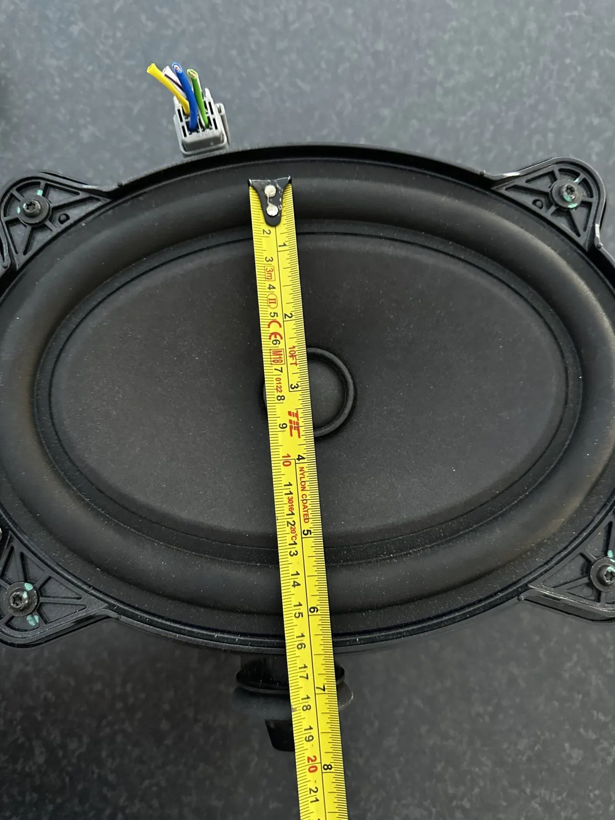

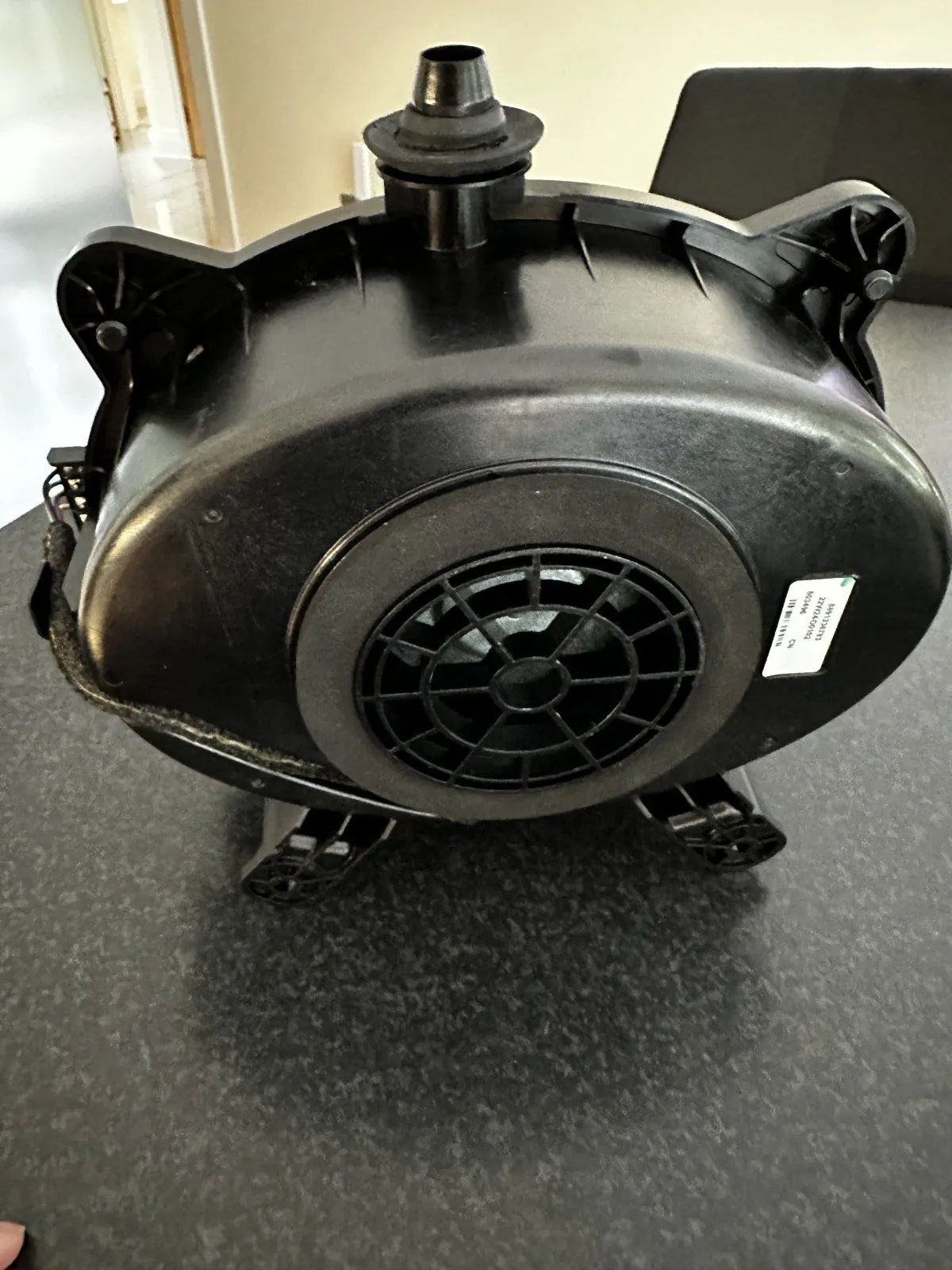

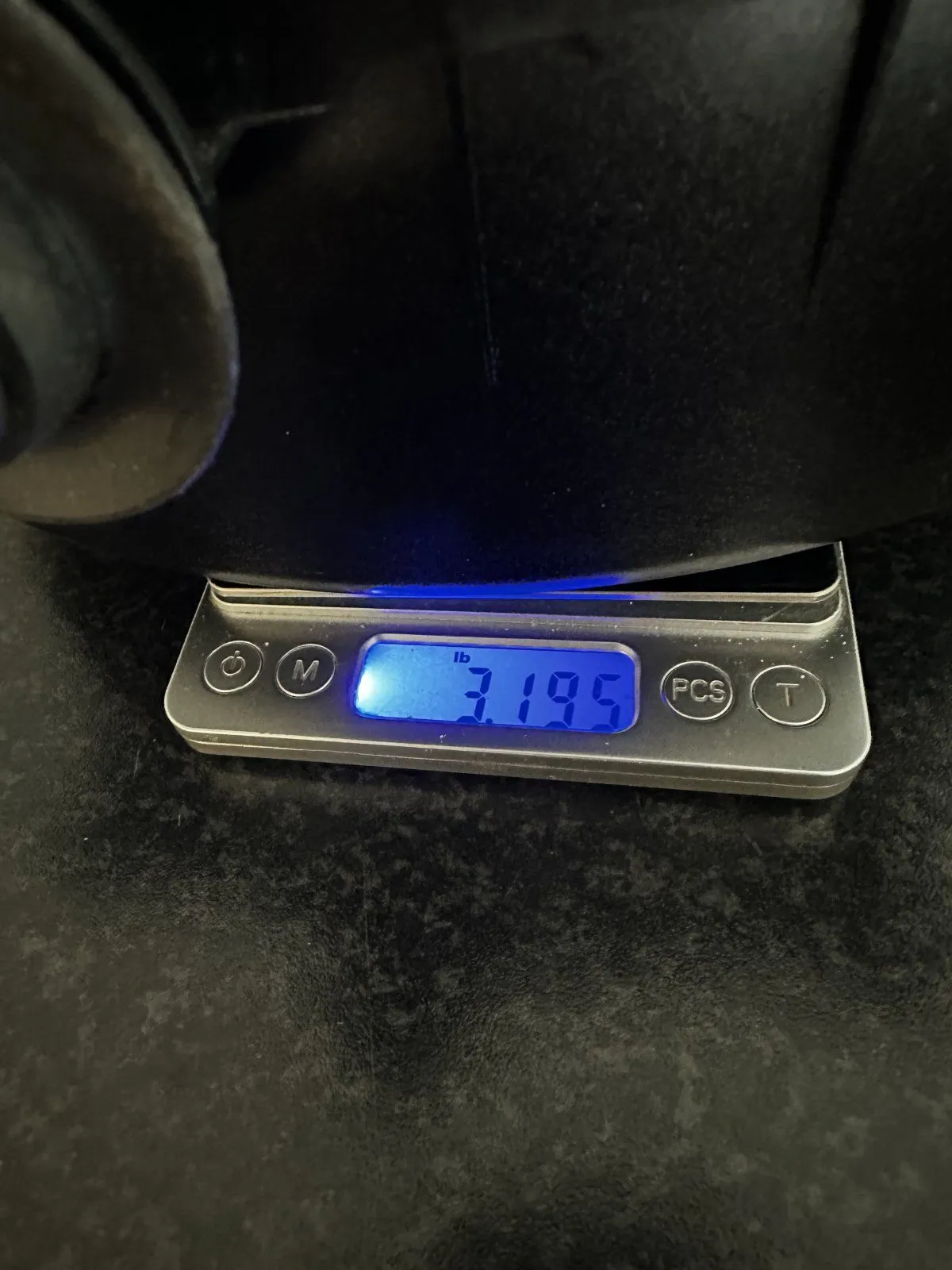

I was reading this thread and thought I would shed some light on the OEM subwoofer we all have installed.
Sorry to be the bearer of bad news....I'll try my best to be polite / PC:-
Take a look at the pictures attached. This is my sub that had to be removed due to all the same reasons you are all describing - sorry, but I found the KEF audio poor & not up to standard....it certainly does not match the looks of the car.
The sub measurements basically make it a 6X9 speaker which only produces bass. It weighs in at just 1.45kg or 3.2lbs....
For comparison, one of the 6.5" speakers I have now installed to my doors weighs the same.
I've personally not come across Its "free-to-air" design before, nor would I recommend one - this is why the sound / bass changes when you have a window open or closed.
If you hear a "thud" when you open the door in the mornings - its this sub doing that. I've not heard this sound after its removal.

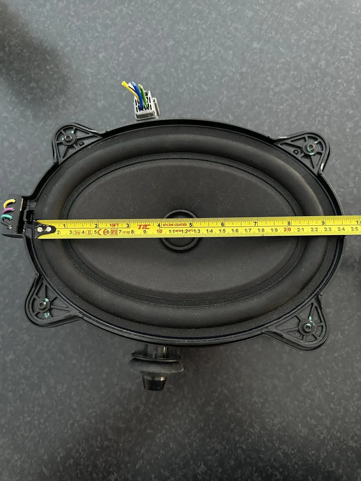

Lastly, when I removed my sub it had water inside due to the free-to-air design. Pic 5 shows the drain hole which faces down when the sub is installed in the car - have you ever known a sub / speaker to require a drain hole?? :unsure:
You had WATER in your sub?? Yikes.
