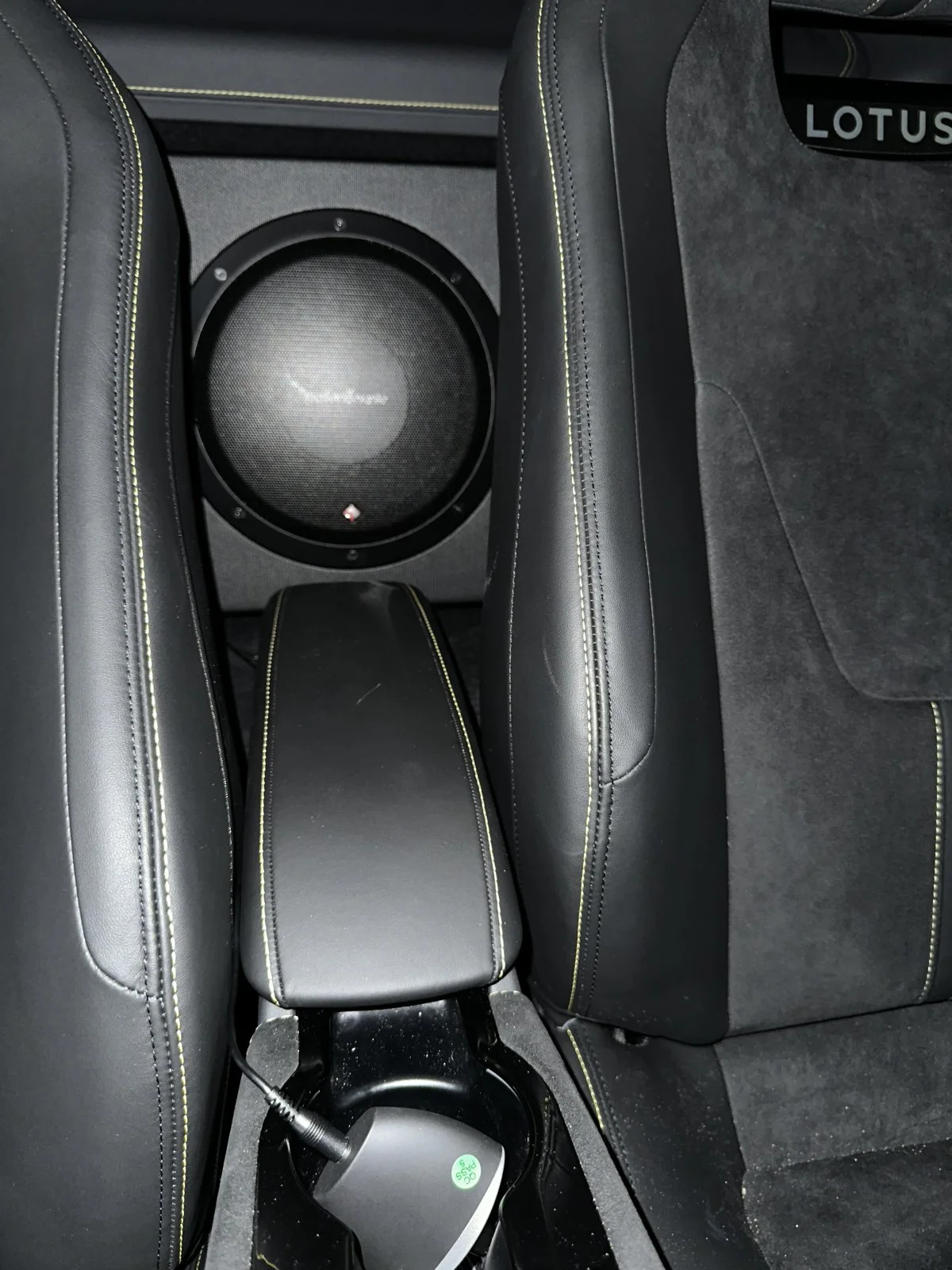

Has anybody considered adding a self powered subwoofer? I’m ok with the speakers, and I think adding a Kicker Hideaway 10” behind my seat should make things sound better.
Nice! What are the specs on your setup? Did you wire into your battery, ground, and tap into the rear speakers?
Giving credit to @KJWEmira , he has a few pictures floating around the forum that shows the panels removed
Once the panels are removed you can run a power wire to the battery in the back, and we tapped into the existing subwoofer wiring to grab audio signal.
I went with P300-10 from Rockford Fosgate, the amp has hi level signal inputs and also turns on and off (no remote wire needed), I'm sure the Kicker has similar feature
