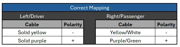

This is the final answer. I meant to post here to update but forgot.

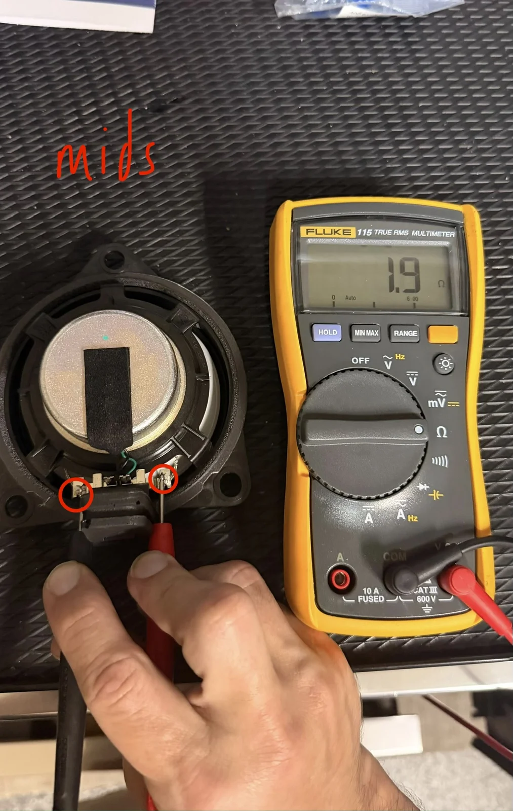

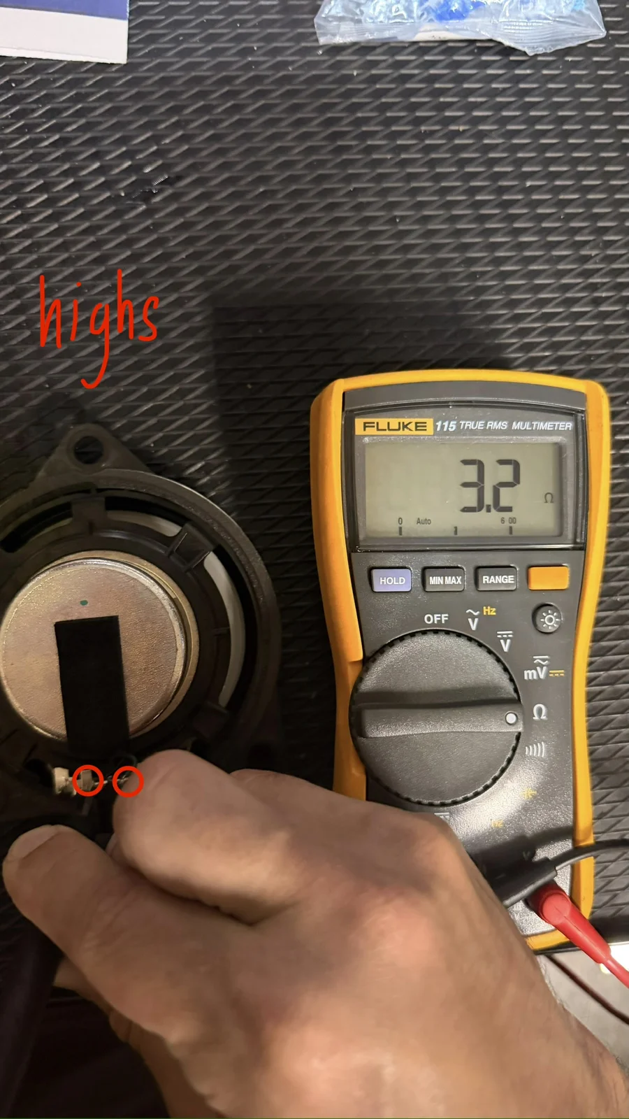

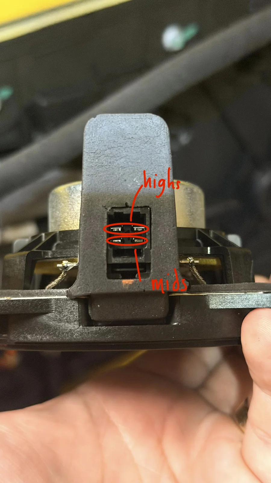

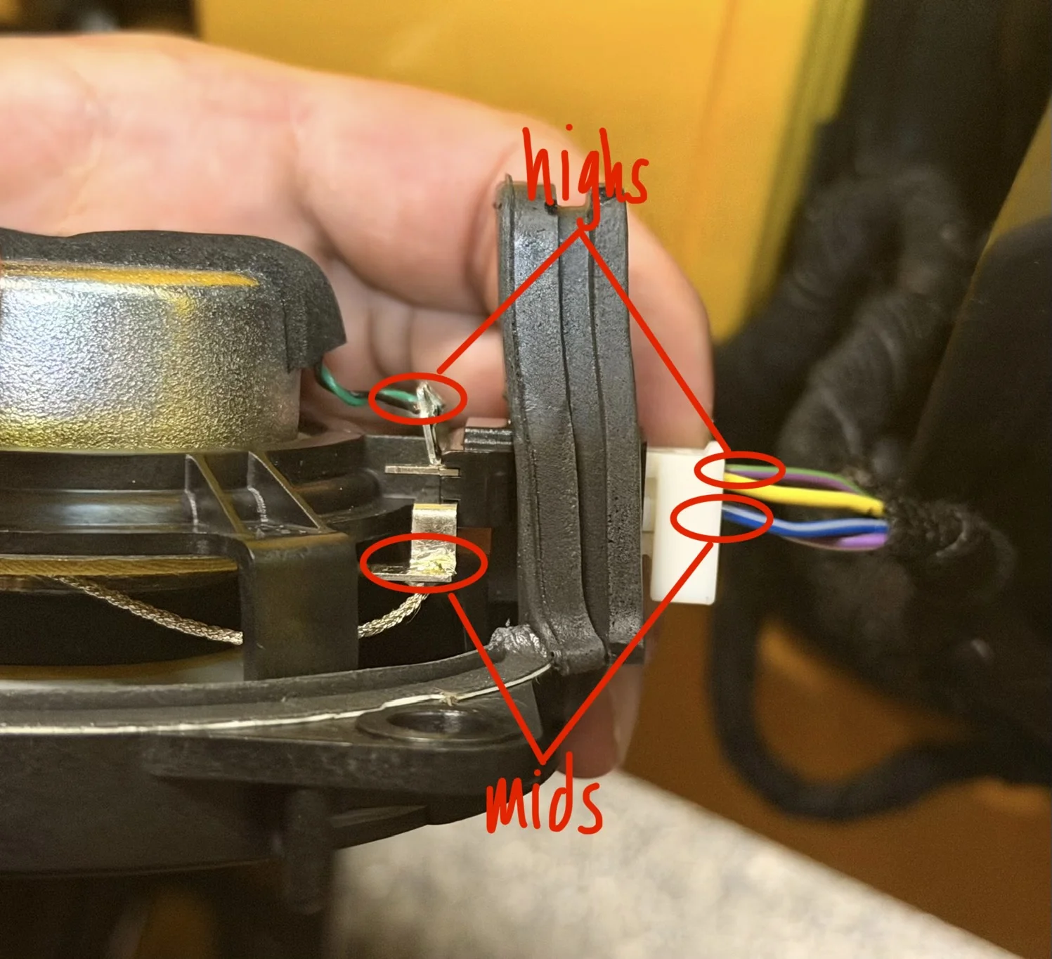

I tested continuity with a multimeter on all the wires from the speaker connector at the door to inside the cabin and confirmed which set of connectors/cables belong to the twitter/highs and which to the mids. Also confirmed polarity and tested impedance.
One thing to notice is on the right/passenger side the cable is solid yellow at the speaker but it changes to yellow/white once it passes into the cabin.
And here’s a video testing polarity of the speaker with a power supply, the mids cone BARELY moves but if you look carefully at the edges you can see it moving up when power is applied.
Thanks for the comparison silent cilantro and trying to reconcile the different postings. I know my wire coloring is accurate, however I can't swear by the polarity. All I know is my tweeters work AOK as set-up. I tested each speaker, before finalizing the wiring connections and doing clean-up. Perhaps if there's an "electrician" or someone ++ good with automobile speakers, they can confirm that the polarity, if consistent, will work either way(?). I say this, since I expect the different polarity used by others likely worked too. I'll wait with interest, to see your other responses.
