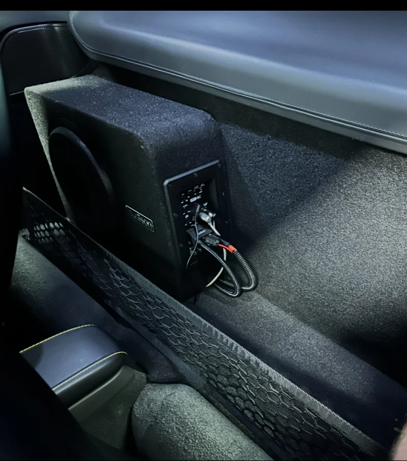

The Audison Sub is excellent. Not an over kill - It fits perfectly on the shelf and the finish of the box matches the Emiras trim. (see attached pic)
The unit has a built-in amp and multiple gain adjustments on the side allowing you to dial it into your personal taste

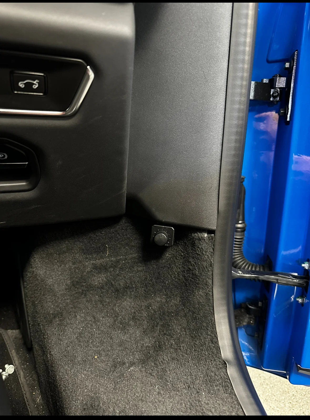

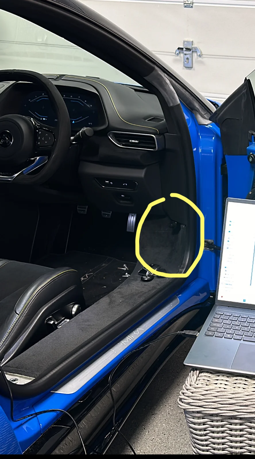

Another bonus is the sub comes with an adjustable gain controller which you can mount anywhere next to your driving position, again, allowing you to turn up or down how much bass you prefer during different music types. (see attached pics of where ours is mounted)
For us it was definitely worth the money.

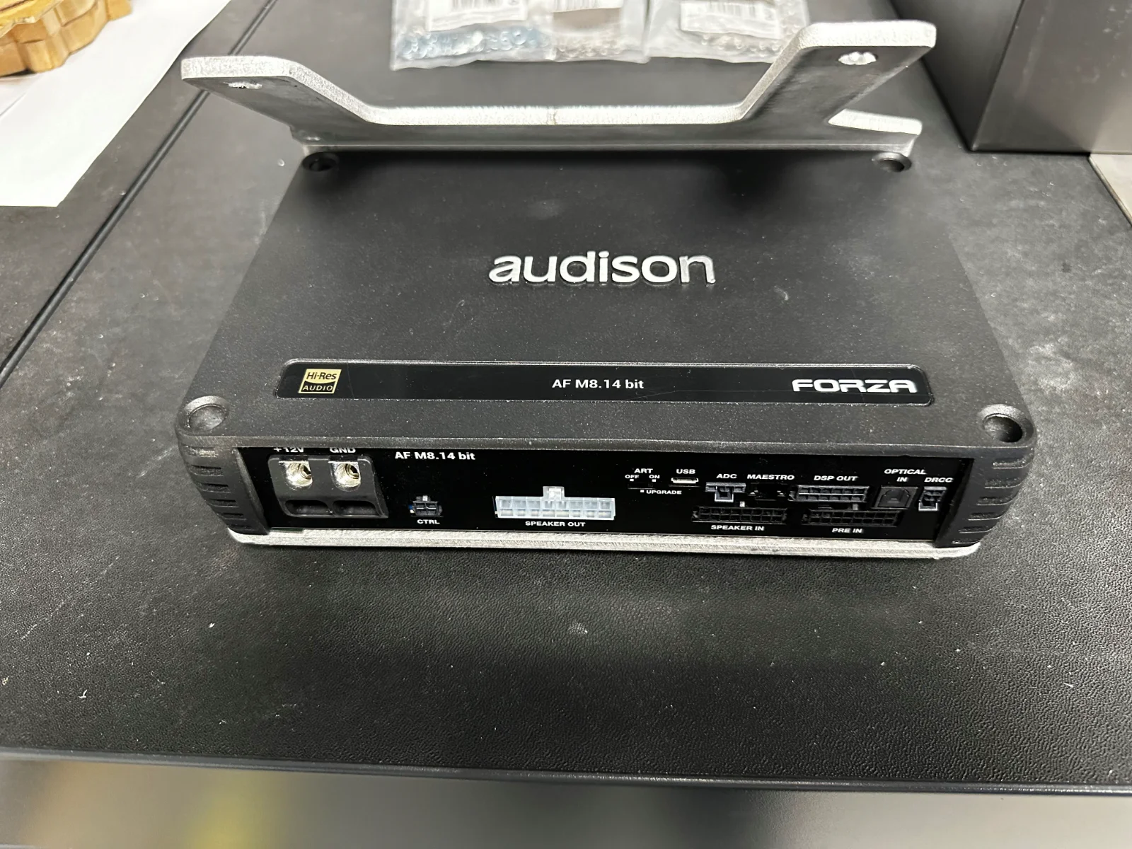

What I can't comment on 100% is the fact ours has been ran through an Audison Amp with DSP.
Although multiple people have installed different subs directly from the cars OEM Amp, we have not personally heard one, but any sub upgrade is better than what is installed from the factory.

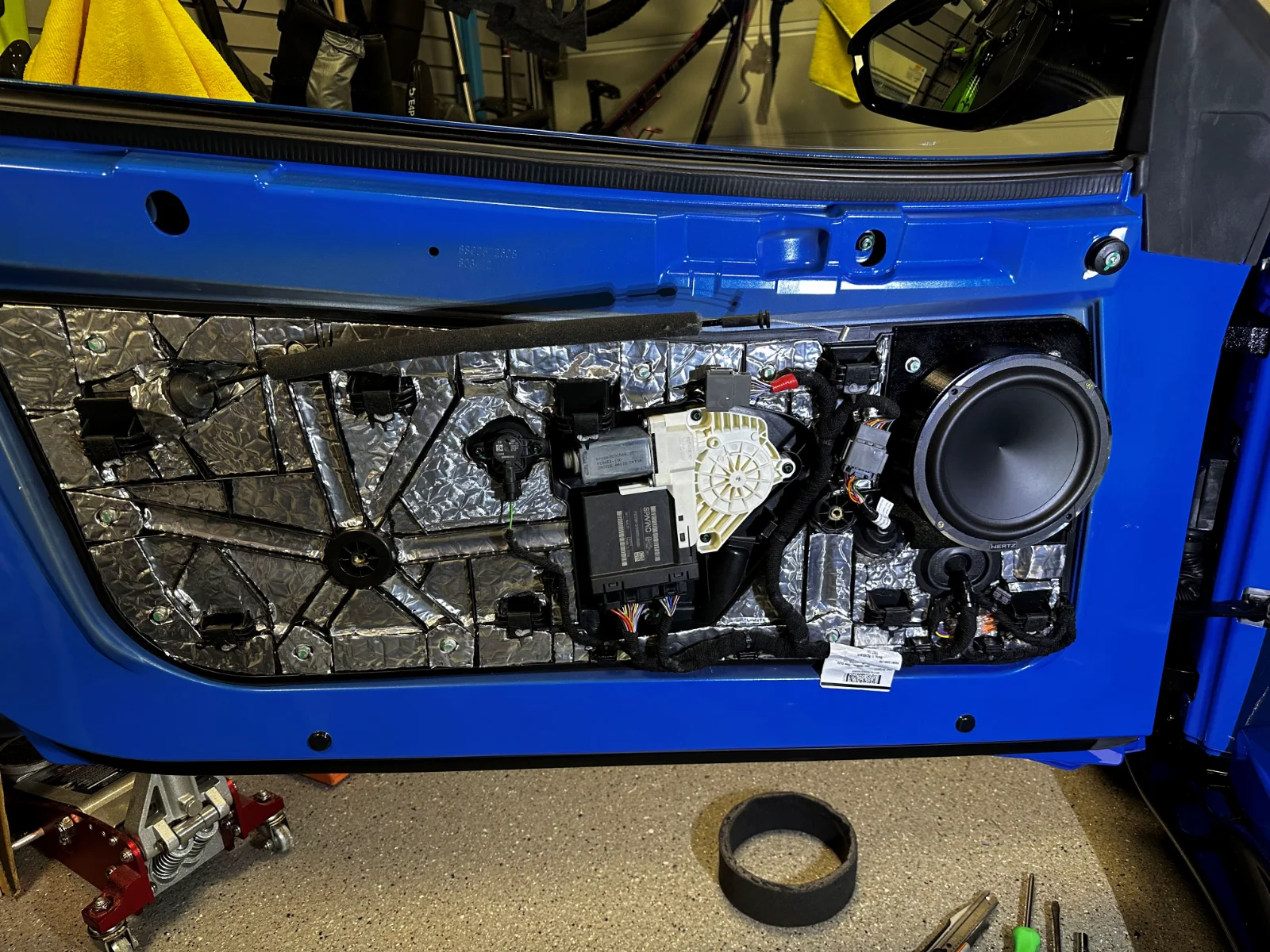

Please remember we have also installed sound deadening throughout the whole of the rear compartment, and both doors. Surprisingly no rattles to report after.

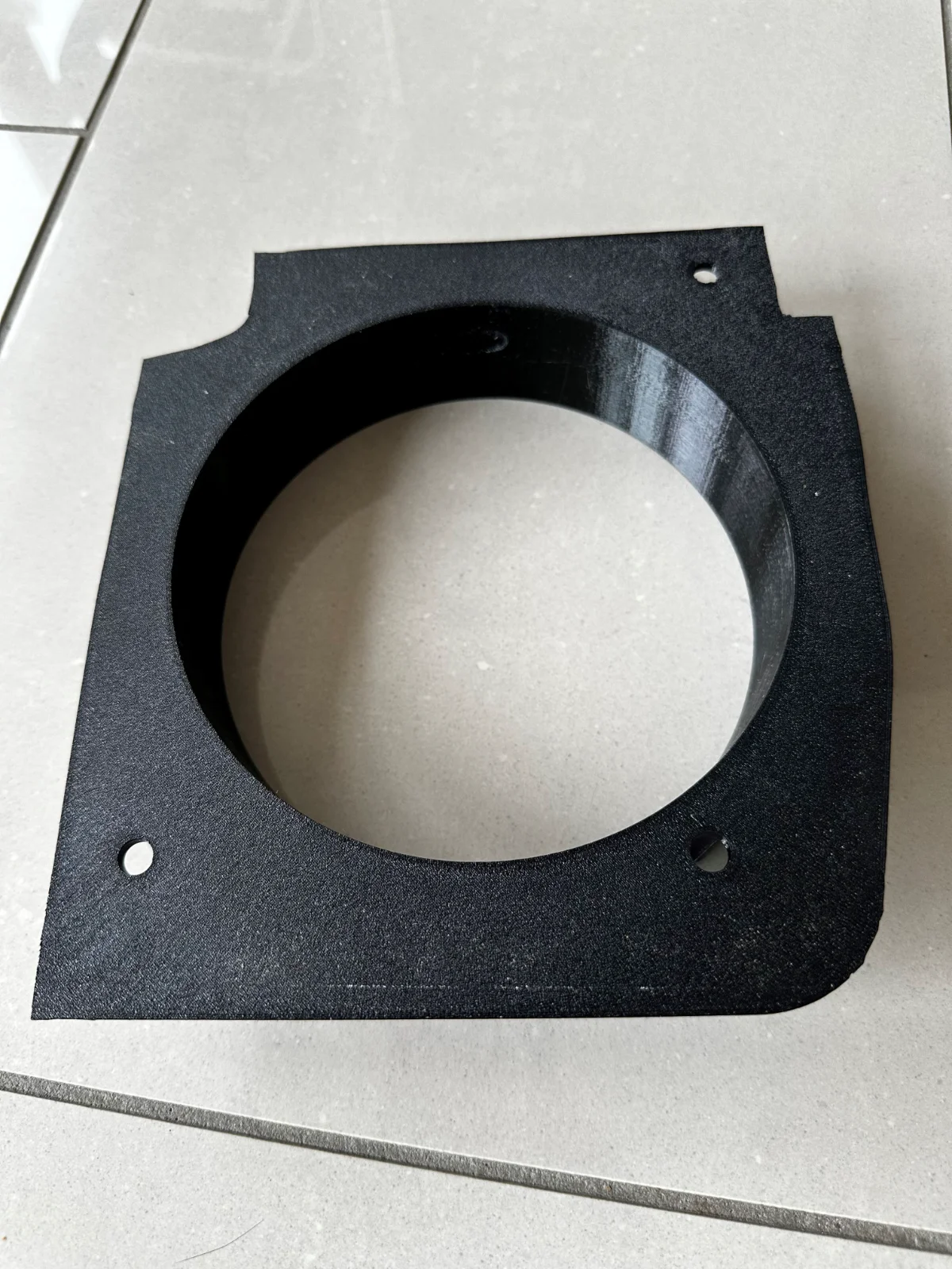

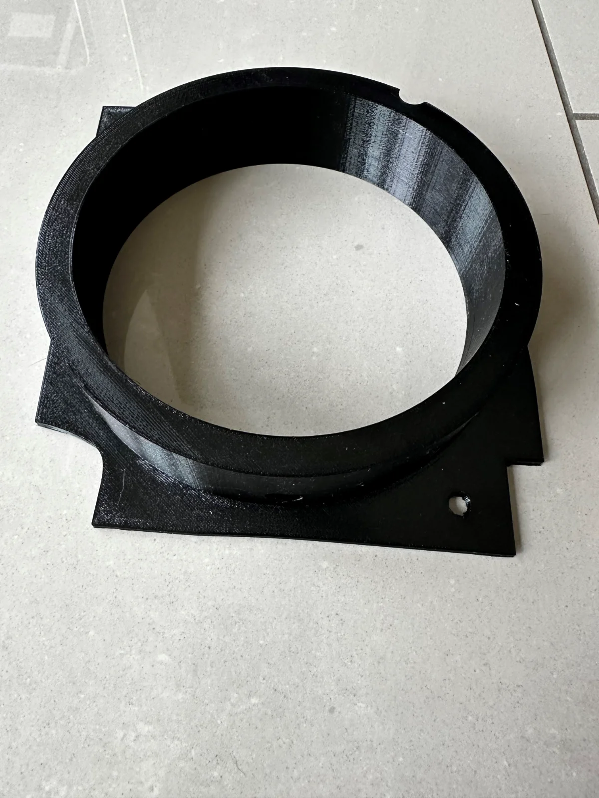

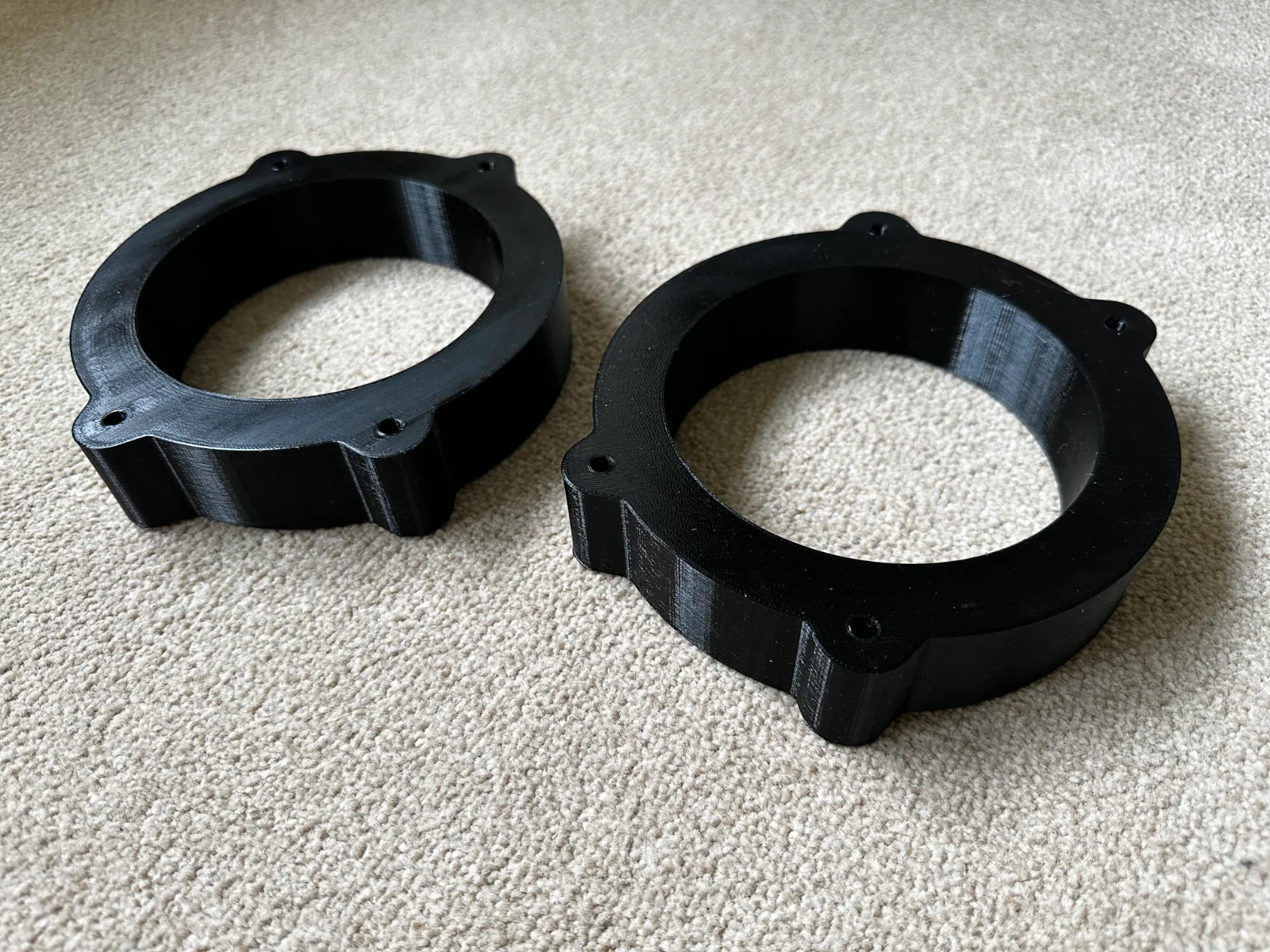

Hi Mikee,
Not a problem.
We have designed & manufactured front and rear speaker mounts, along with an amp mount, for those looking to upgrade their Emira Audio themselves.
These items can be purchased individually or as a complete kit, which includes a wiring colour code document, saving hrs of identifying & tracing wires.
Feel free to ask any questions or send us a direct message should this be of interest.
We are UK based.
