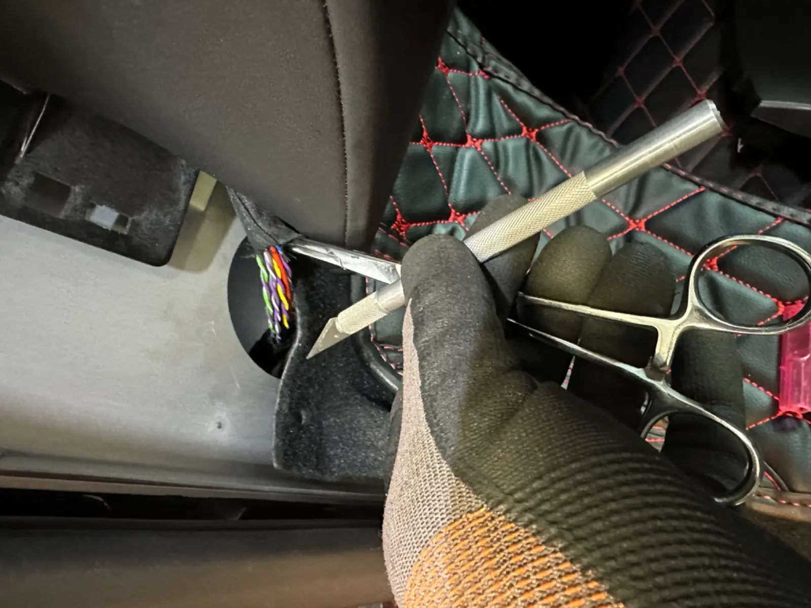

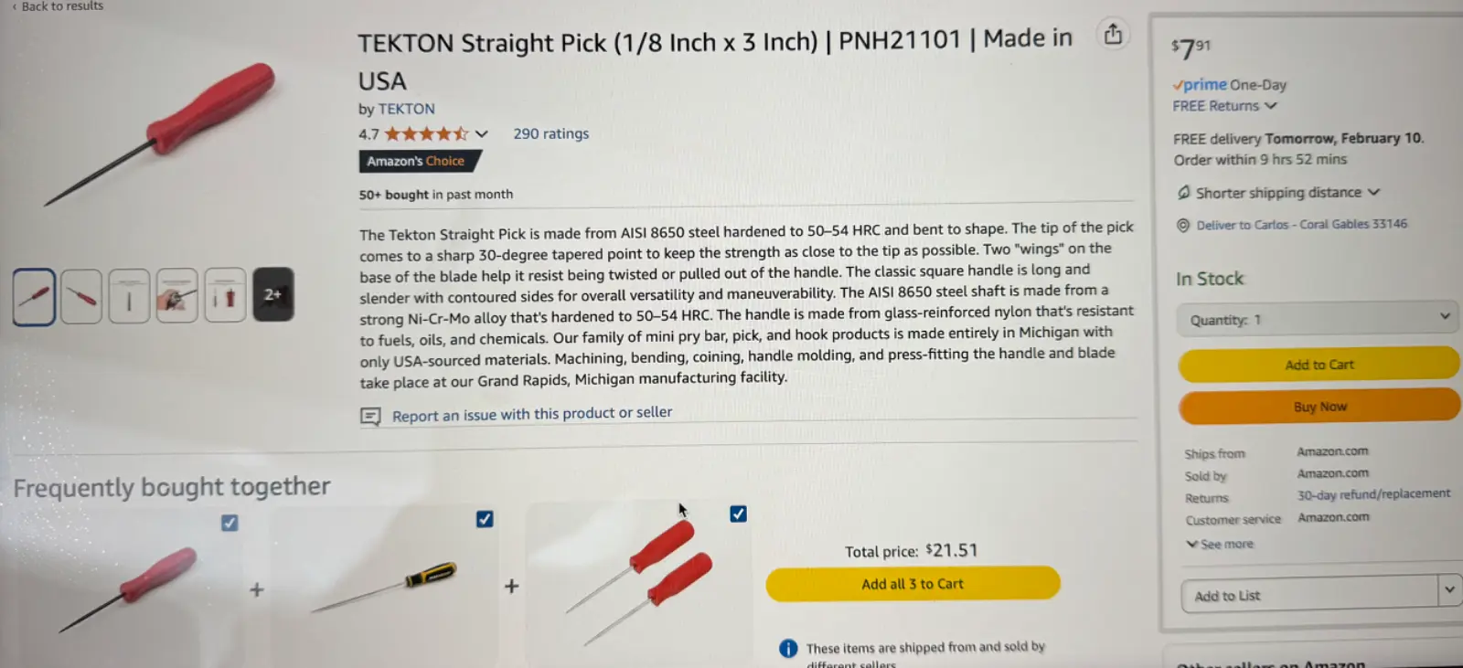

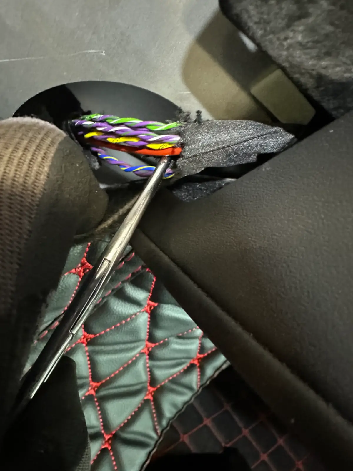

Here are some useful materials and tools that I used which you can consider getting (all available on Amazon) should you not already have them.
I used this to poke a guiding marker hole on the small plastic tabs of the tweeter housing in the A-pilar trim. Since it's a small tab it will help center the drill bit when making the hole for the zip ties.
This I used for the delicate surgical cutting of the speaker wire cloth wrap.
This is to wrap the wiring once you tapped into the wires.

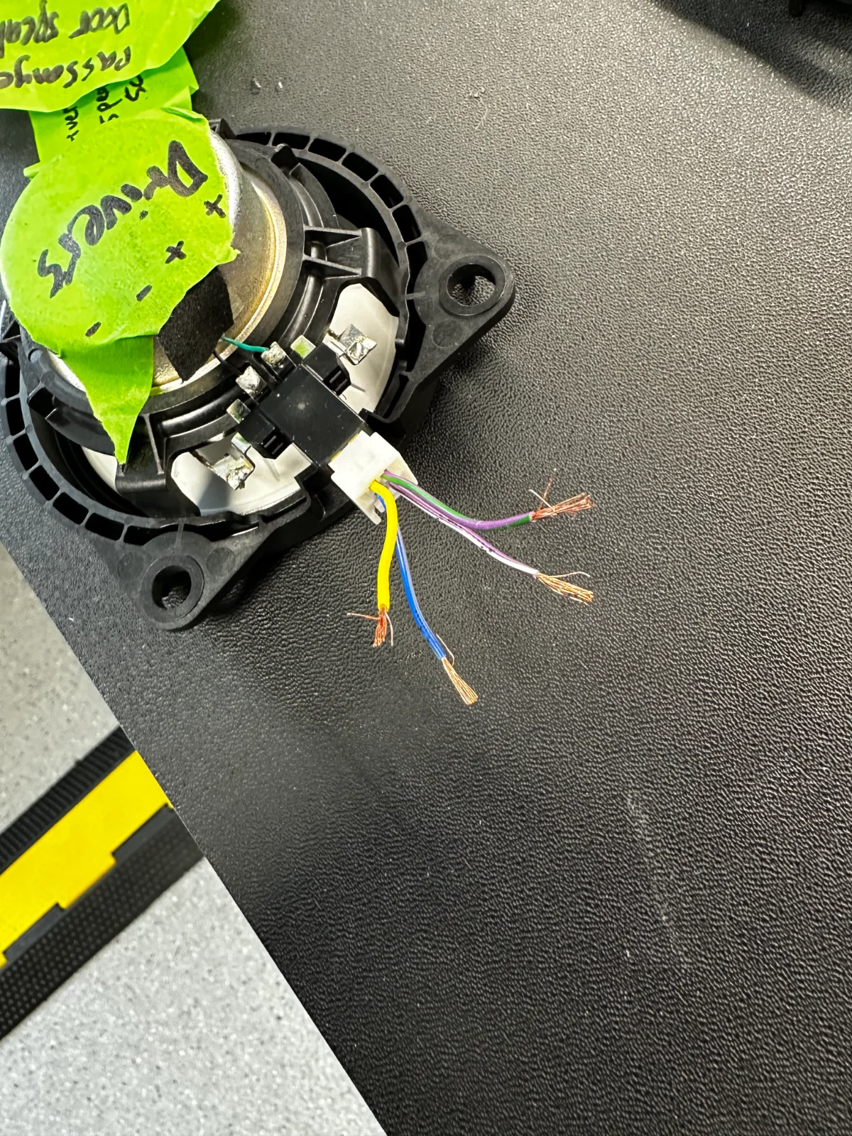

Would anyone happen to have the wiring colors for the tweeter signals +/-?
I see referenced:
Drivers side - signal wires are Blue/white stripe and purple, unsure of polarity.
Passenger side - signal wires are yellow/white stripe and purple/green stripe, unsure of polarity.
I see referenced:
Solid Blue -> negative
Purple/White Stripe -> positive
Sold Yellow -> negative
Purple/Green Stripe -> positive

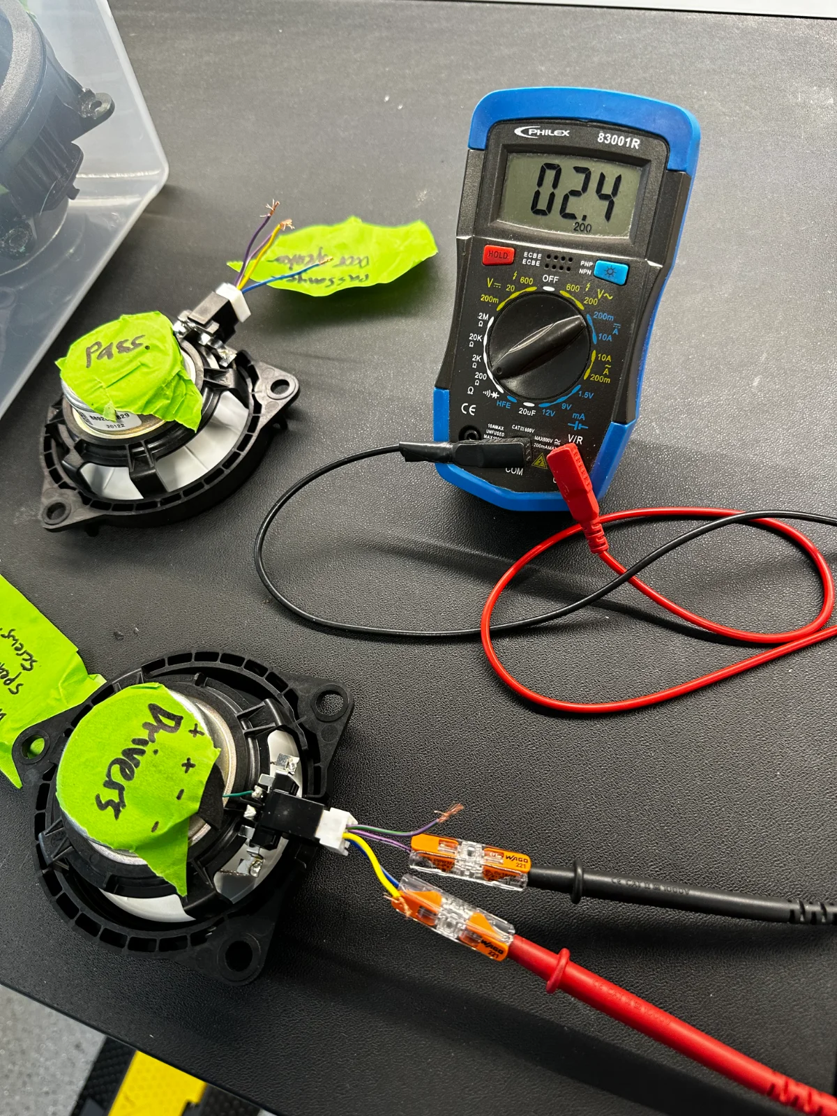

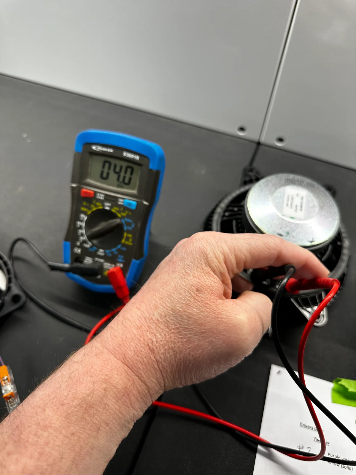

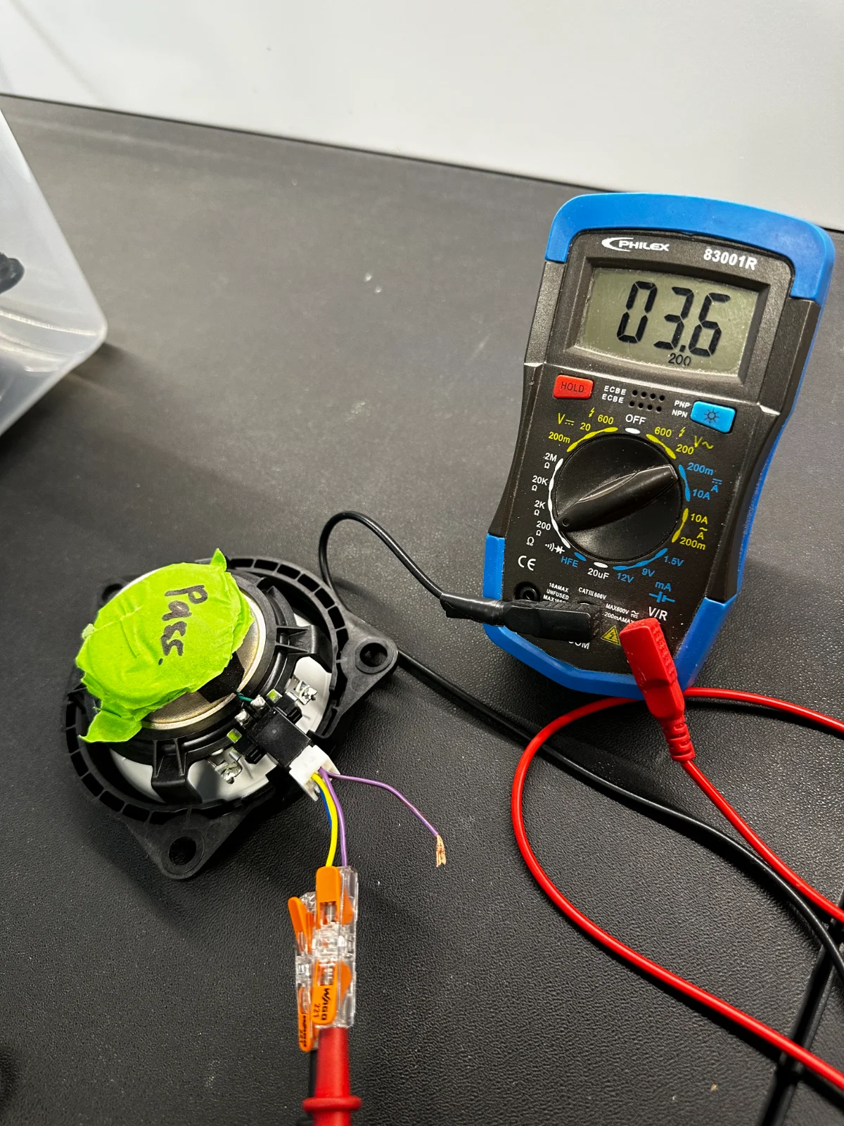

Anyone know what ohm rating the front door speakers are running at? I read the mid driver is powered separately from the tweeter but havent found the ohm rating on either/both, thanks! (I did try search as well nothing came up)

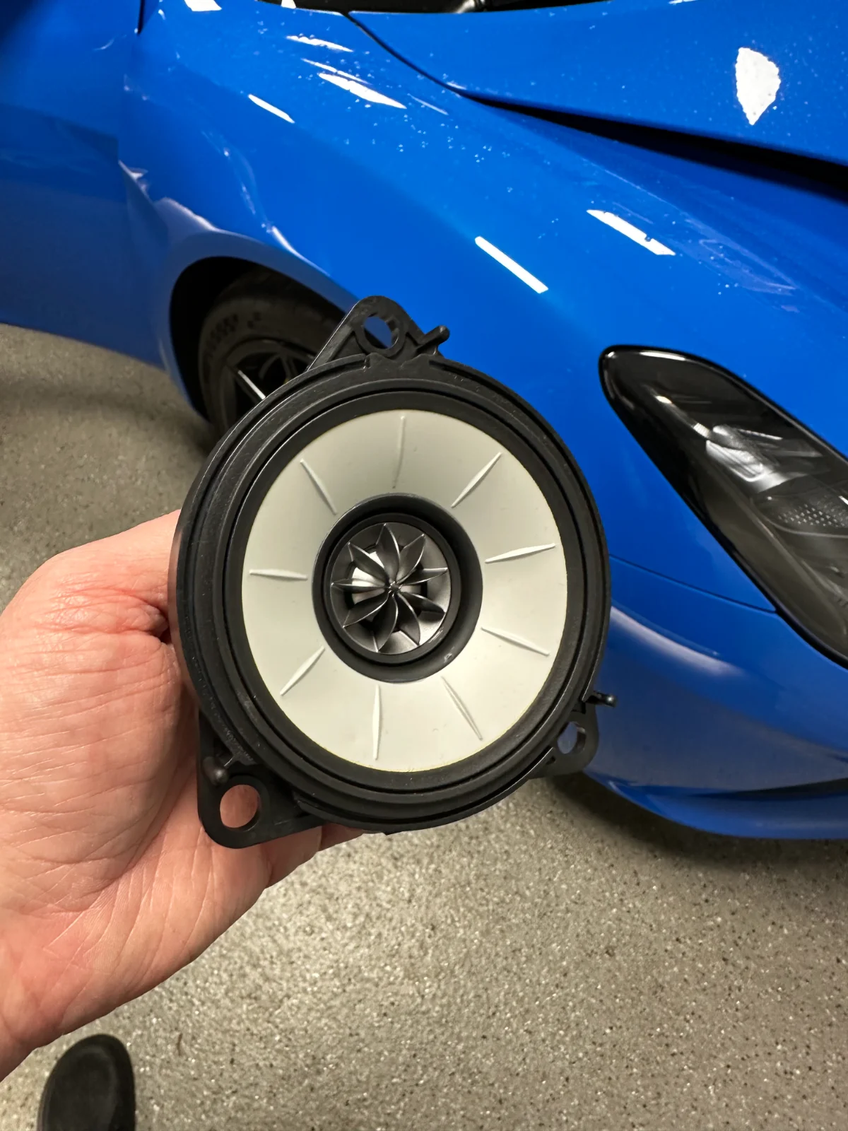

Hi Kaz,
Luckily I had all these pictures from a previous request - please see the attached.
Hopefully this is the info you're seeking
Please note: -
IMG_0678 - Main Speaker (Drivers Door)
IMG_0679 - Main Speaker (Passenger Door)
IMG_0681 is a REAR Speaker.
IMG_0682 - Tweeter (Passenger Door)

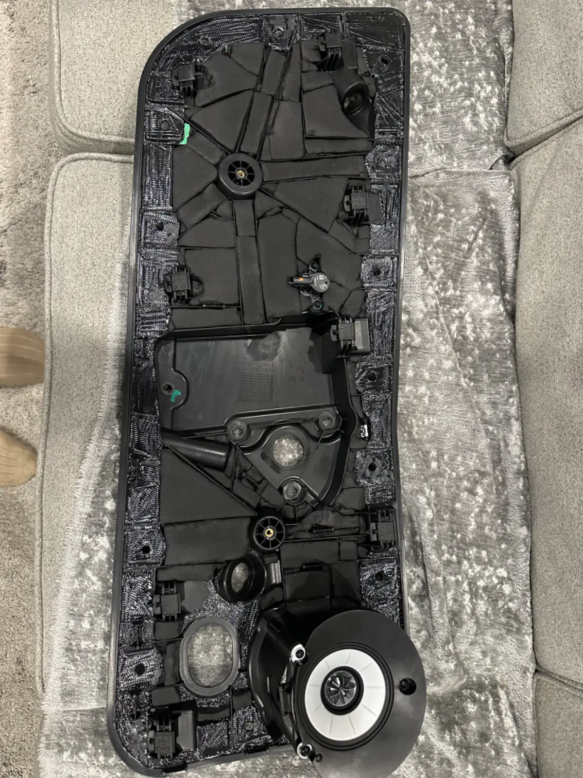

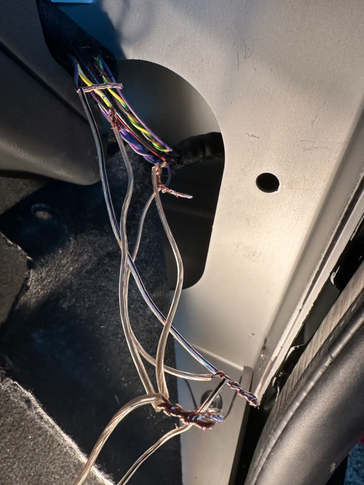

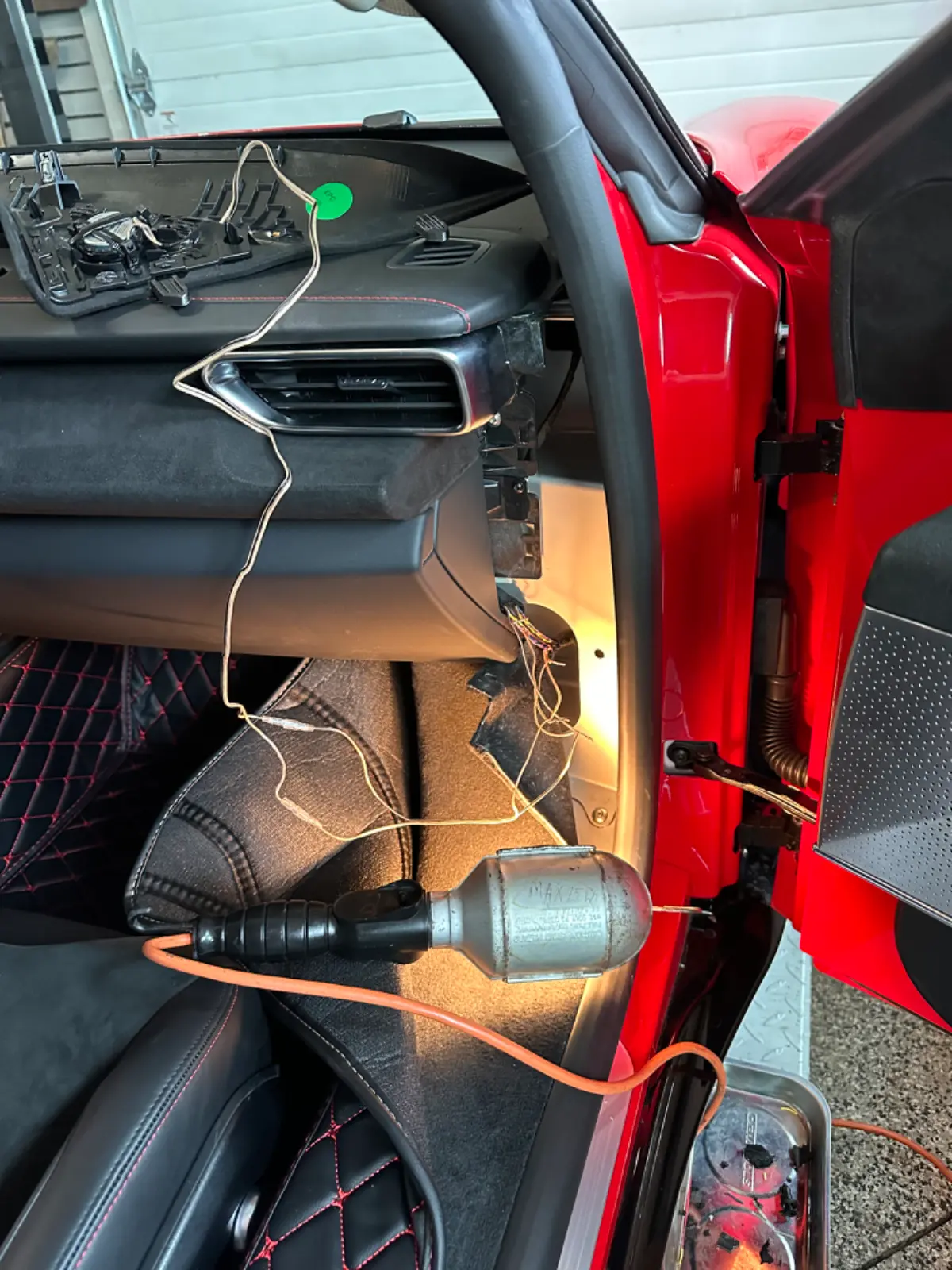

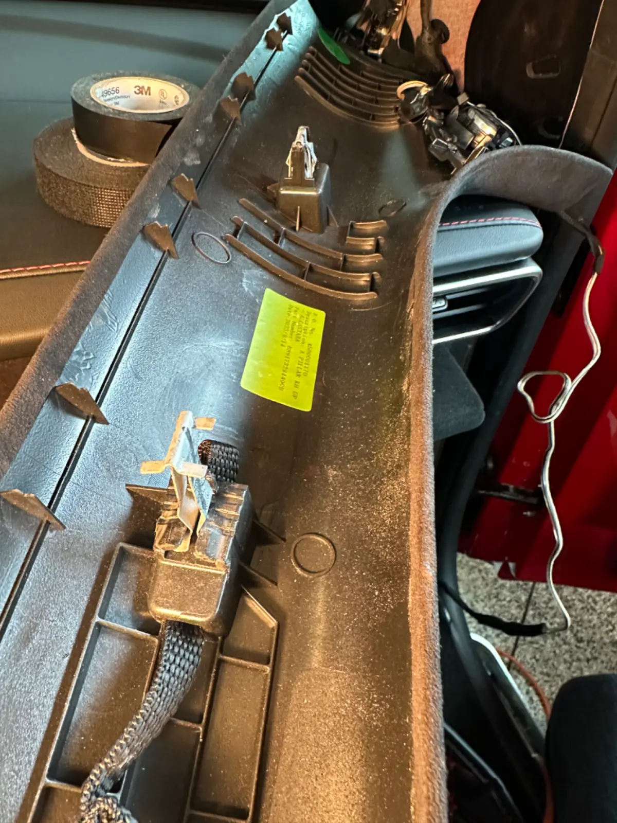

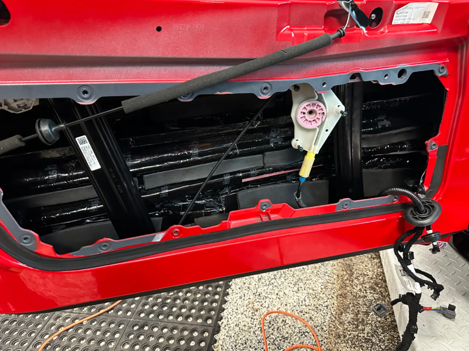

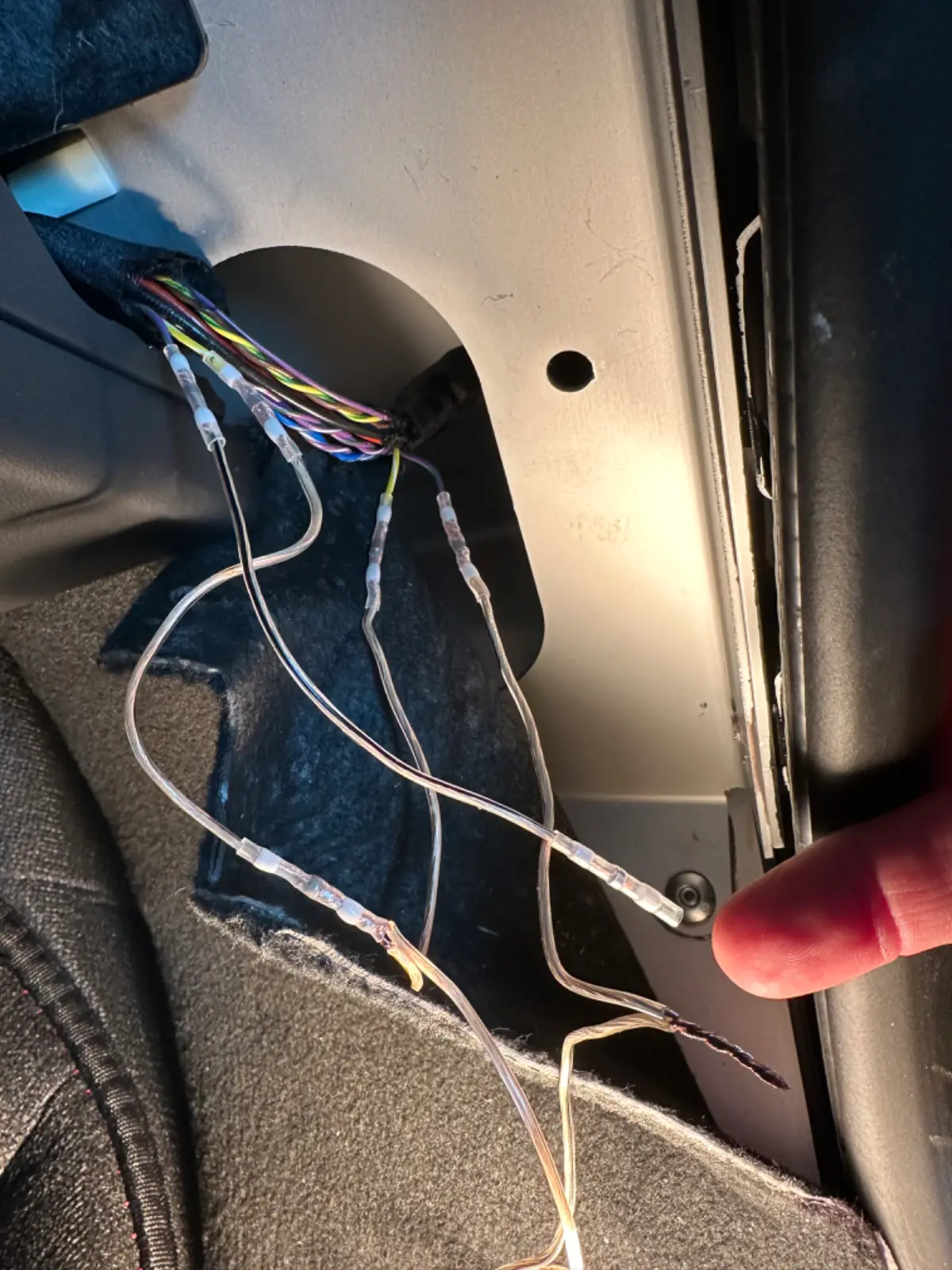

I’m just finishing my driver side door: insulation and Alpine tweeter. First time I’ve ever done these mods. I owe it all to others who started and contributed to this thread (THANKS!!). I’ll post a few comments, in case it helps others who take on these tasks.
For those of you with a service manual, the obvious reference pages to take apart the door are 15-10 and 15-11. The not so obvious pages are 11-12 and 11-13. Those latter pages explain the trick of pushing the rubber grommets (followed by all disconnected wiring) into the inner door. They also mention disengaging 2 clips, whereas there were a lot more clips: the wiring had to be detached from all.
First off, be prepared to devote ++ time. The sound deadening install is a very tedious/detailed job, so you need patience and an understanding spouse, with tools spread out in the garage and (for me) door pieces in the house, to work on while watching TV. I used a combo of “rubber-backed”/foil/adhesive material (Hushmat brand) and foam/adhesive material (generic brand from Amazon). Here’s 2 photos: one showing the inside of the driver door, and the other the cabin-facing inner door card, as finished. There's many different methods you can use to install the insulation, looking at the photos posted by others and the various YouTube videos. I expect they all achieve the same result. What I did, made a noticeable difference to quiet the door sound resonance.

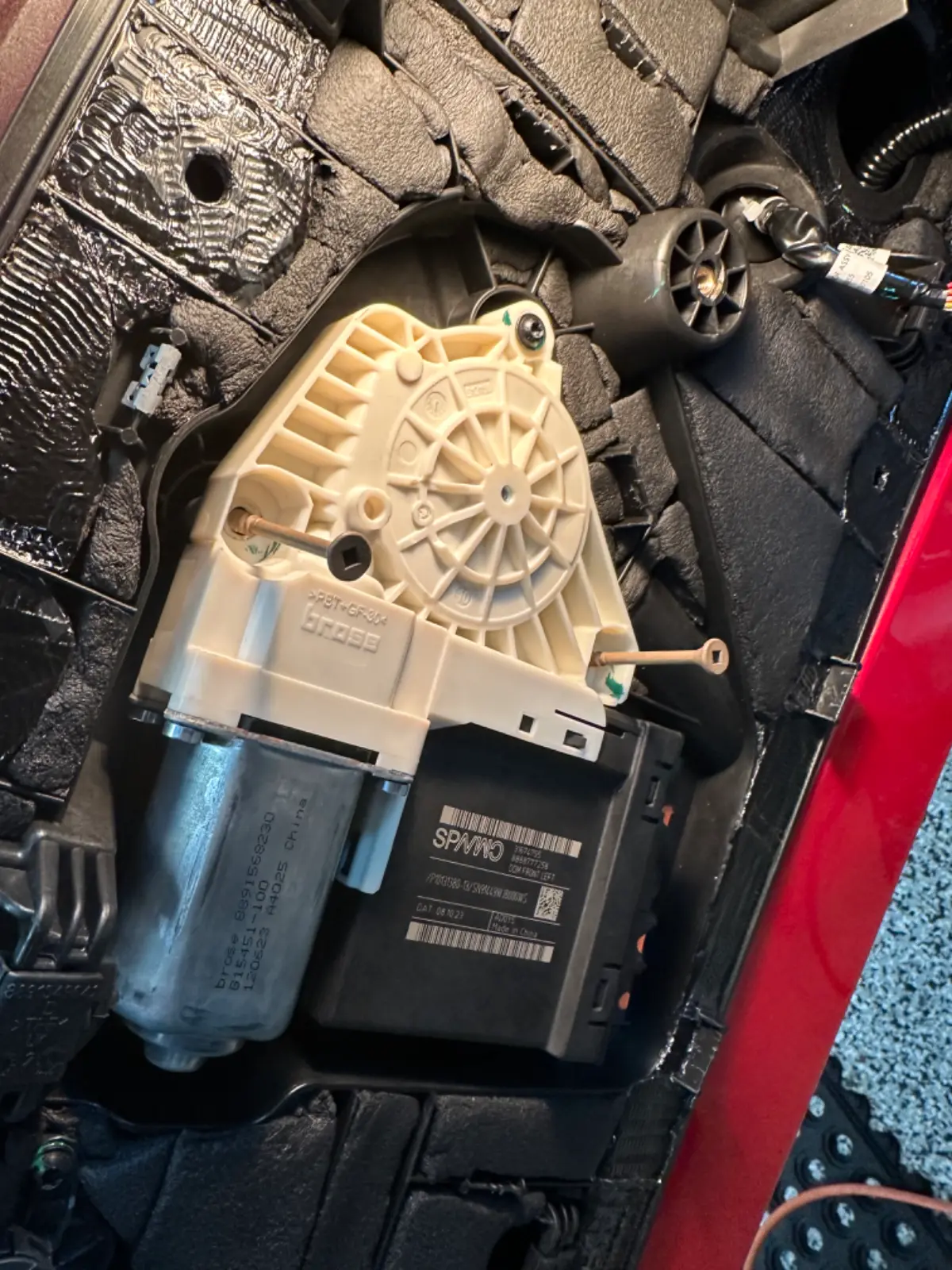

Reassembling the door, it was a !#\! pain in the butt, to reinstall the 3-screw window motor. I finally made it work, using 3.5” deck screws, to reach further in and snag each of the 3 white plastic inner ends (that the black screws go into), to pull the inner half of the door window assembly close enough, to carefully substitute one at a time, each black mounting screw. You know it’s worked when the inner assembly and outer motor, click into place. See photo showing 2 brown 3.5” deck screws in place, plus the one black screw installed. Using a long blade screwdriver in the gap to better wriggle the inner door motor assembly into position (not shown in any photo), also helped.

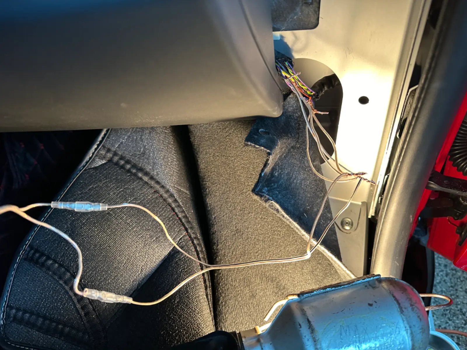

The tweeter connection wiring was a challenge, due to the restricted work space, once the protected wiring sheath, was slowly/carefully cut through to expose the wiring. Below is a photo showing the razer-edged cutting tool I used and the “medical clamp” which came in handy to pull away pieces of the cut protective wiring sheath and grab the wires. I had purchased connectors used by others but ultimately used small blue-size wireguards (some call them marrettes; not shown in any photo) to join the old with new wires. Choose whatever works best for you, although some may correctly point out the wireguards/marrettes aren’t waterproof. I wrapped the new connections with regular vinyl electrical tape, followed by cloth electrical tape over everything to avoid any rattles from vibrating wiring hitting any of the harder interior surfaces.
WARNING: if following my directions (here and my post #71 below) for wiring colors/polarity, I may have it wrong, even though my set-up seems to work. See the November 10 posting #101 of Silent Cilantro, where he measured the wiring signal and came up with different wiring colors/polarity.
For the driver-side door (left-hand steering) I spliced into the (solid) purple wire and the blue/white wire, ID’d by others. They were found intertwined together, as shown in the attached photo. For new info, the purple wire is the negative one, that you attach to the negative black-lined Alpine tweeter speaker wire. That leaves the blue/white having positive polarity. I may post other tips and photos as the job progresses. I plan to ID the polarity of the passenger side speaker wiring (yellow/white vs purple/green), once I figure it out. Hope this helps.
First off, be prepared to devote ++ time. The sound deadening install is a very tedious/detailed job. I used a combo of “rubber-backed”/foil/adhesive material (Hushmat brand) and foam/adhesive material (generic brand from Amazon). Here’s 2 photos: one showing the inside of the driver door, and the other the cabin-facing inner door card, as finished.
Reassembling the door, it was a !#\! pain in the butt, to reinstall the 3-screw window motor. I finally made it work, using 3.5” deck screws, to reach further in and snag each of the 3 white plastic inner ends (that the black screws go into), to pull the inner half of the door window assembly close enough, to carefully substitute one at a time, each black mounting screw. You know it’s worked when the inner assembly and outer motor, click into place. See photo showing 2 brown 3.5” deck screws in place, plus the one black screw installed. Using a long blade screwdriver in the gap to better wriggle the inner door motor assembly into position, also helped.
The tweeter connection wiring was a challenge, due to the restricted work space, once the protected wiring sheath, was slowly/carefully cut through to expose the wiring. Below is a photo showing the razer-edged cutting tool I used and the “medical clamp” which came in handy to pull away pieces of the cut protective wiring sheath and grab the wires. I had purchased connectors used by others but ultimately used small blue-size wireguards to join the old with new wires. Choose whatever works best for you, although some may correctly point out the wireguards aren’t waterproof.
For the driver-side door (left-hand steering) I spliced into the (solid) purple wire and the blue/white wire, ID’d by others. They were found intertwined together, as shown in the attached photo. For new info, the purple wire is the negative one, that you attach to the negative black-lined Alpine tweeter speaker wire. I may post other tips and photos as the job progresses. Hope this helps.

Just to be clear - is this supposed to be Yellow/White -> negative? Found conflicts in my notes, while compiling an instruction document built from various posts, and have built up a bit of nerves before cutting any wires.
Combining your wiring notation (and pictures) with @Chriscpm notations in post #30 would my following notes be correct?
Right speaker
Main - blue and purple/white
Tweeter - yellow/white (negative) and purple/green (positive)
--- (yellow/white based on @crestima picture, not solid yellow)
Left speaker
Main - purple/brown and blue/yellow
Tweeter - blue/white (negative) and purple/dark purple (positive)
--- (purple/dark purple based on @crestima driver side picture)
Additionally, @Chriscpm indicated he tapped the main signal wires vs. the tweeter wires - can that be confirmed, as well as the colors and polarity on the main signal wires?

You need to be careful when using this thread to install new Alpine tweeters. First off, any reference to "left/right" in the thread, is from the perspective of a left-hand drive vehicle, so left is the "driver side" and right is the "passenger side". As well, this thread refers to the "upgraded" KEF audio system, found standard in the "First Edition Emira". Two Forum members both used speaker wiring that originates from the interior door speaker, which has both a midrange and a tweeter in it. I understand that Chriscpm refers to the midrange as the "main speaker", separately from its tweeter portion. That said, each Forum member hooked up the wiring differently:
1. Chriscpm (the OP or person who started this thread) method: he hooked up the new tweeters, to both the door midrange/aka "main speaker" (2 wires: colored blue and purple/white, for the right side, and purple/brown and blue/yellow, for the left side) and the door tweeter speaker (2 wires: colored yellow and purple/green for the right side, and blue and purple for the left side). So he taps into 4 wires on each side (8 in total) and doesn't mention polarity: see his past post #30 on this thread.
2. Crestima method: he hooked up the new tweeters, to only the door tweeter wiring, or at least that's all he mentioned. So 2 wires being yellow/white stripe and purple/green stripe, for the right side, and purple and blue/white stripe, for the left side. He taps into only 2 wires on each side (4 in total). He doesn't mention the polarity of all those wires. Check out his past posts #50 and #51, on this thread.
Anyone doing this tweeter addition, will have to decide which method they follow. I chose the Crestima method and when doing so, figured out the polarity, for the same wiring Crestima tapped into:
-right/passenger side:
---OEM yellow/white stripe = POSITIVE
---OEM purple/green stripe = NEGATIVE
-left/driver side:
---OEM blue/white stripe = POSITIVE
---OEM purple = NEGATIVE
Since I didn't use Chriscpm's method, I can't comment on the polarity of the other 4 wires, he tapped into (sorry).
At least this is my interpretation of this thread and I invite Chriscpm and Crestima, to correct me, if wrong. Both my new Alpine tweeters seem to be working AOK, after having tapped into 4 wires (not 8, like Chriscpm).

Hi Folks,
I used the color codes mentioned above by @netsinah having researched how Lotus generally codes their speaker wiring.
Particularly as it pertains to tweeter wiring, the polarity is not really that important, unless you reverse the polarity on one of the tweeters, but not the other. In that case it may result in some sound distortion/loss of quality.
