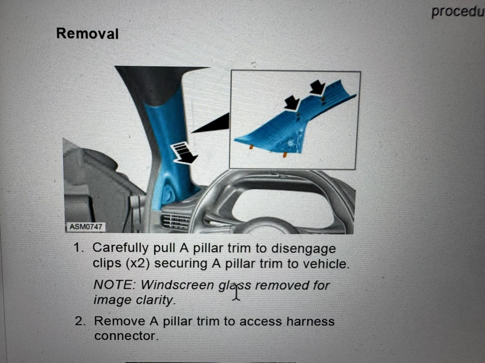

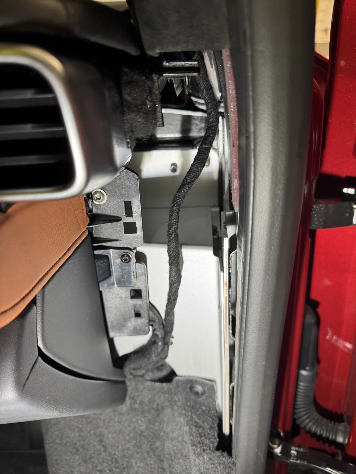

I heard about this. Does the whole pillar just pry off?

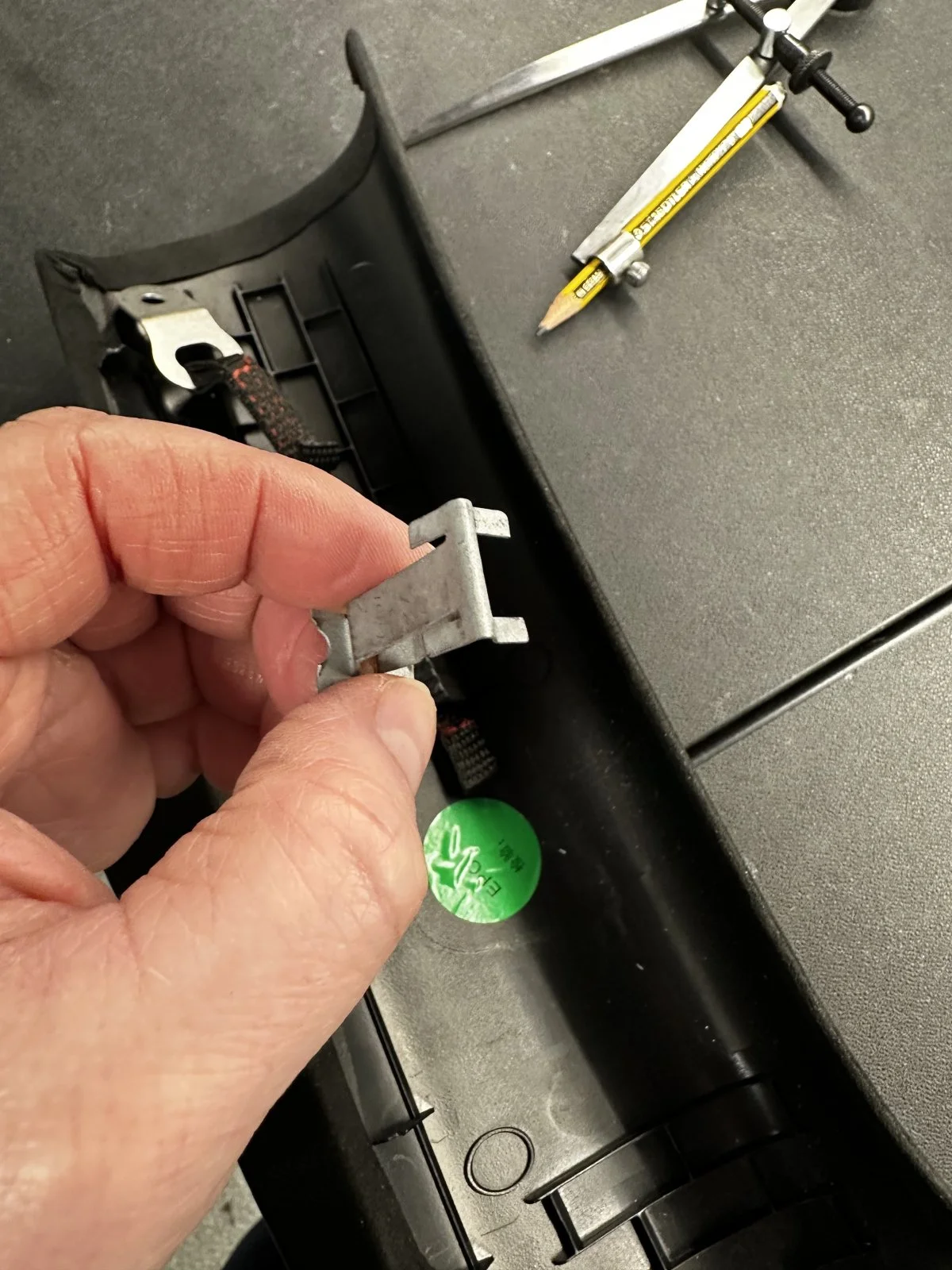

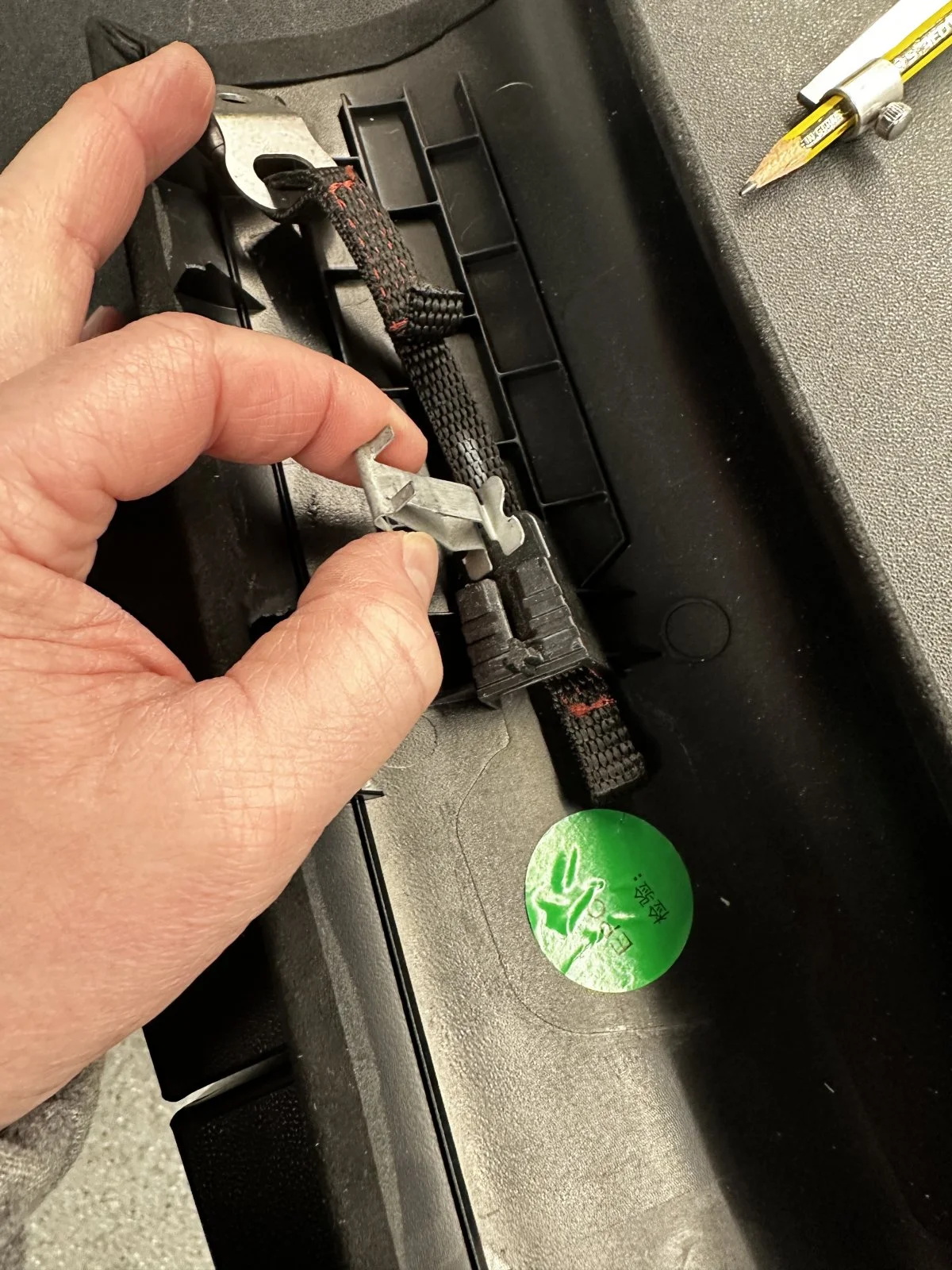

Yes, it will pry off - but be cautious due to the airbag.
Use a plastic trim tool and insert at the top of the A-Pillar trim, and in the center. The trim will only pry off a little way (approx 3 cm) because a large metal retaining clip will prevent it from coming off any further (see attached pics).
Use a set of needle nose pilers from the top to squeeze this metal clip together to remove it (if you just pull, you'll deform it..).
Finally, I believe all cars have had the A-Pillar tether upgrade by now (see pic 0184)- This is a strap securing the trim to the car which prevents it from flying off in the event of airbag deployment. All you need to do is remove the 8mm bolt from the cars' A-Pillar.
Don't worry should this strap not be present, Lotus will install this for free as part of a service bulletin.
(If you zoom in, you'll see the speaker grill metal tabs folded over in Pic 0180 which I referred to in my previous message).

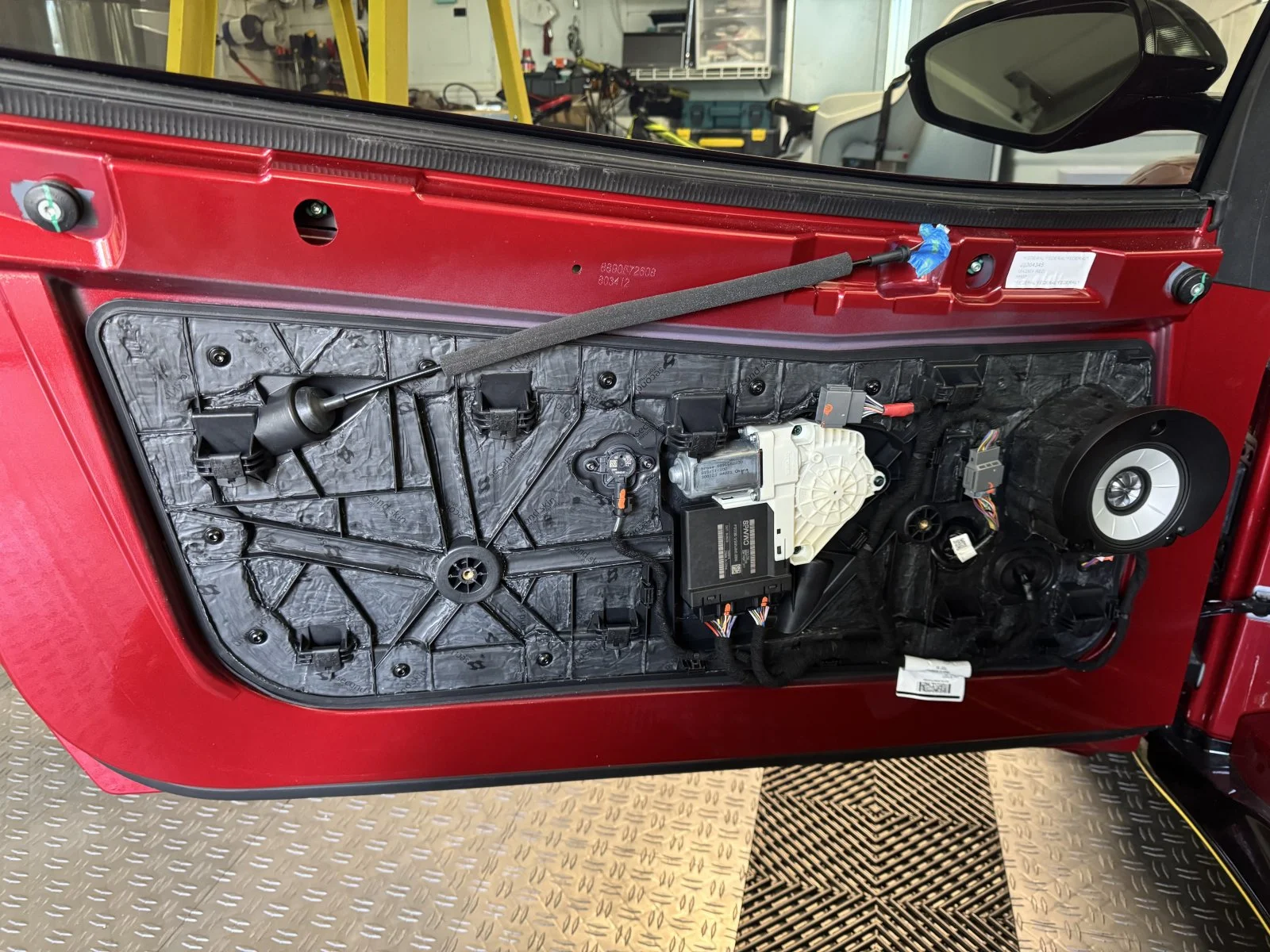

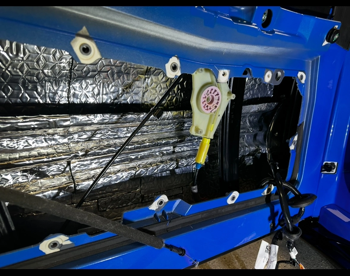

Hi There,

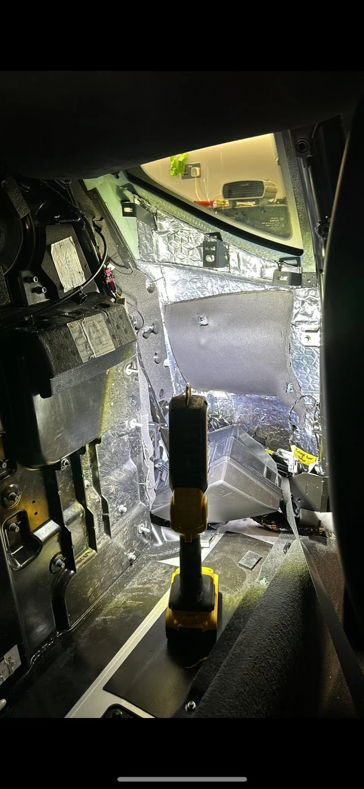

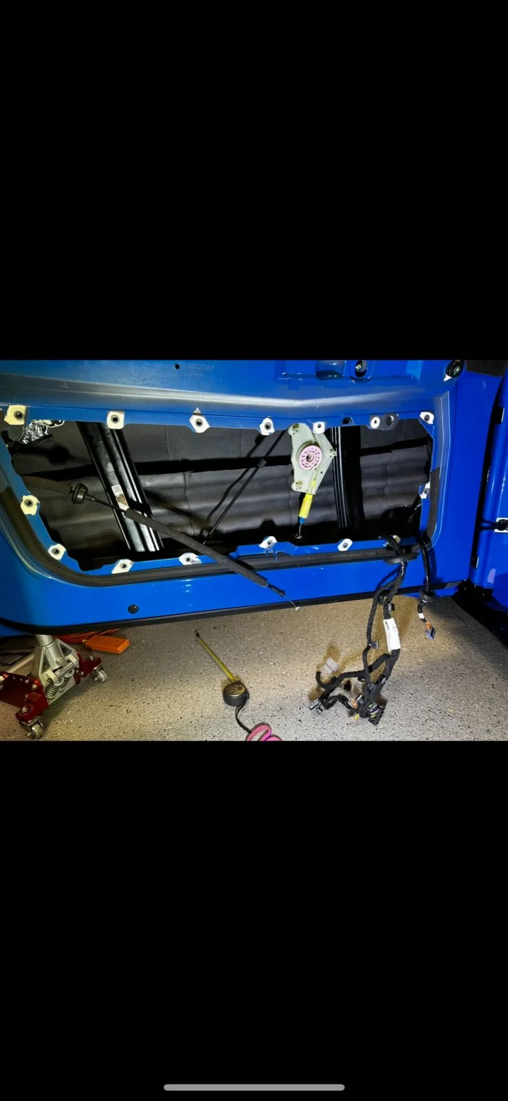

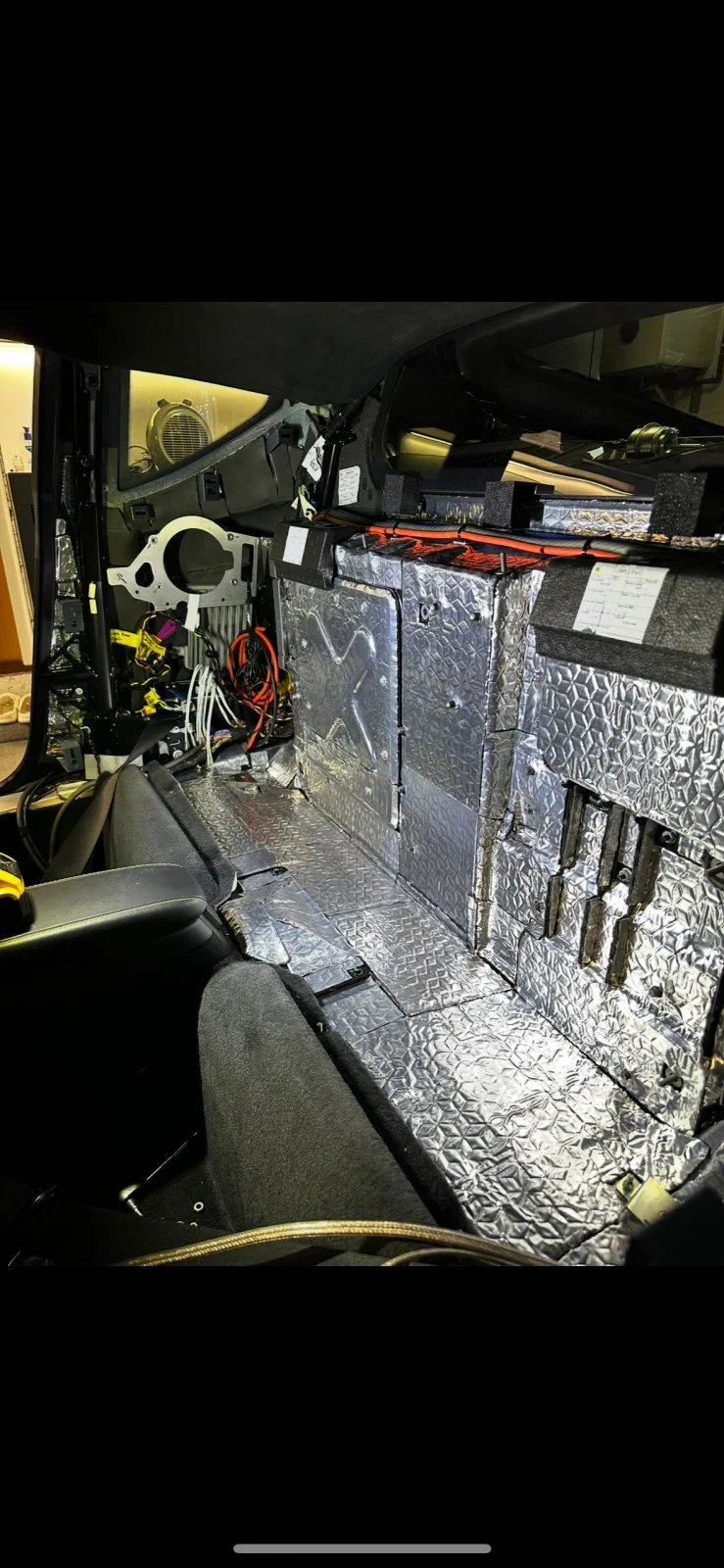

I used "Skinz" sound deadening, then stuck acoustic foam over the top.
Skinz has an adhesive backing that requires heating up to stick. It comes in easy to handle & cut square pieces. I used 1 & 1/2 boxes - each box cost 100 GBP.
Yes, this will add some weight, around 10-12kgs, if you did both doors and the whole of the rear compartment.
But it's worth it - no more stone flicking up noise, you can have a conversation with the passenger, can take phone calls, music sound is far improved etc - although I've fully upgraded the audio.
Installing sound deadening took the longest amount of time to execute, around 7 days (not solid days)....But I did the plastic door cards too as you'll see from the pictures attached.

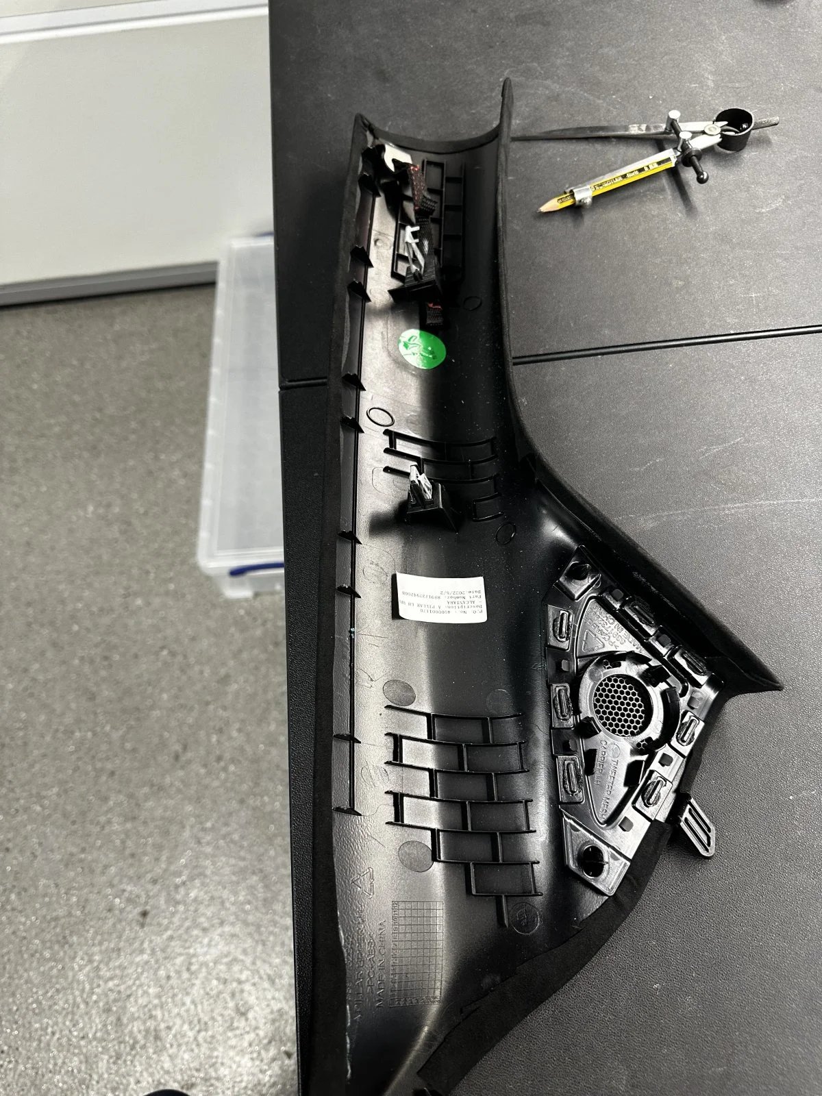

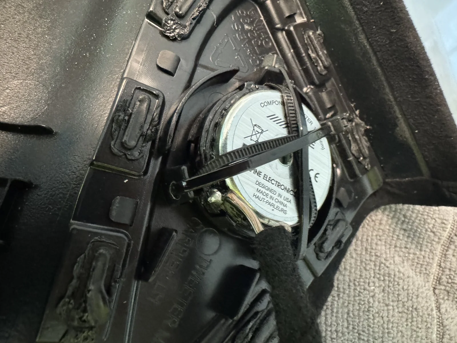

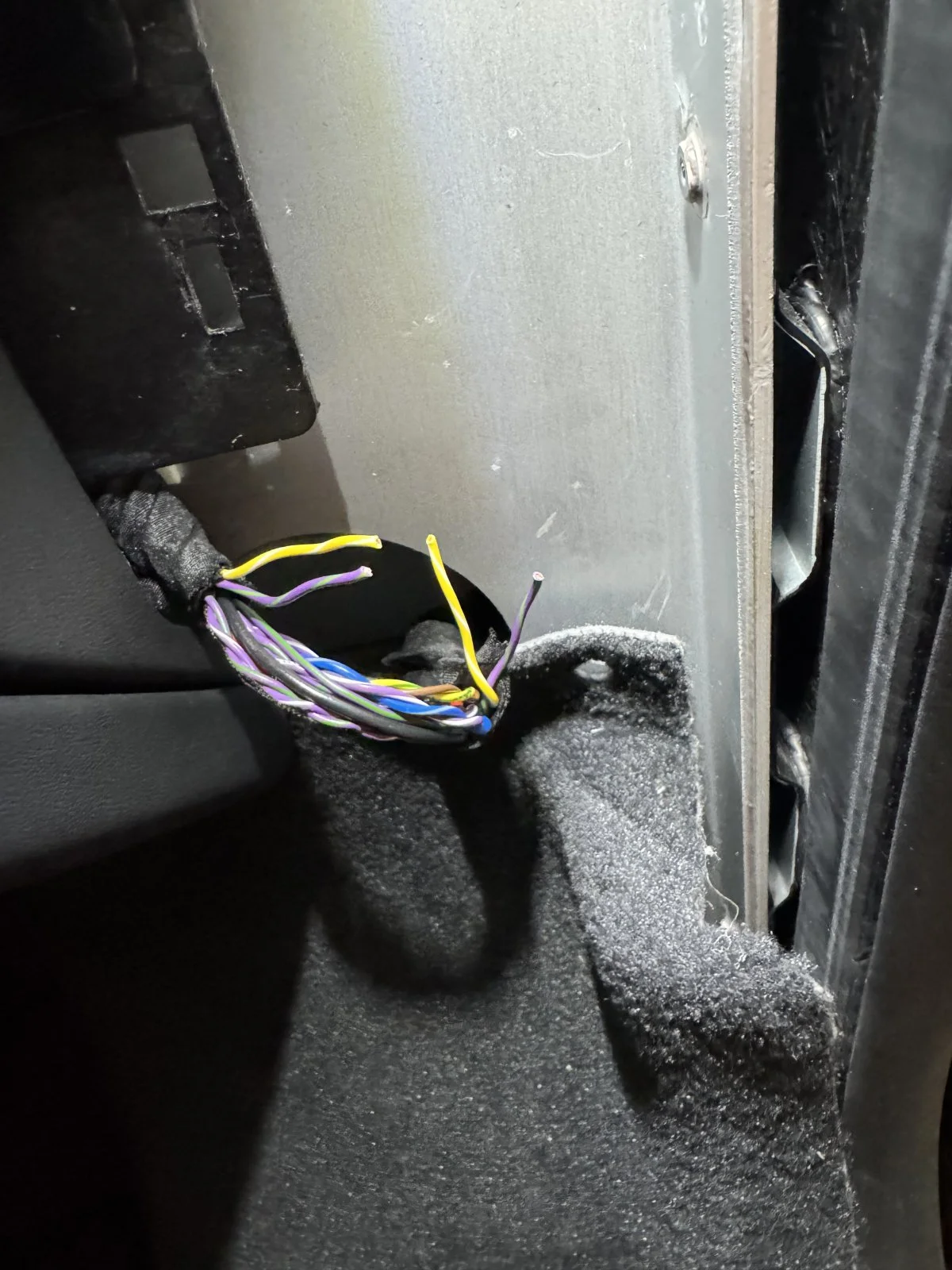

I finished installing my A-pilar tweeters yesterday and the sound improvement is definitely noticeable and worthy of the mod. A big thanks to @Chriscpm for kicking off this initiative and for the input of others, namely @Nova and @KJWEmira .
I purchased the same tweeters as @Chriscpm, they fit perfectly in the A-pilar housing. The extra additional step that I recommend for anyone installing the A-pilar tweeters, is to also place sound deadening material in the internal parts of the doors and the black trim panel pursuant to @KJWEmira's previously posted pictures. IMO, this not only further improves the sound output of door-mounted speakers, but also noticeably reduces road/tire noise from penetrating the cabin. There are lots of good sound deadening material offered out there, I tend to like 1mm Second Skin due to ease of installation good adhesion and lightweight characteristics. Not a very difficult job, but to do an effective job, it requires lot's of time and patience.
Btw, as you follow KJW's A-pilar trim removal instructions for which he provided useful pictures above, keep in mind that for the second stage pull , after you've pinched the top metal tab, will require a good amount of pull force to get them out. A very convenient tool that I used helped a lot to pinch squeeze the metal tab was this surgical clamp (pictured here) as it's longer than needle nose pliers and locks closed allowing you to use your two hands to pull on the A-plilar trim.
If you happen to bend/deform the small winglets on the upper metal tab (as I did to one of them) they can easily be pried back to their original form with a needle nose plier.

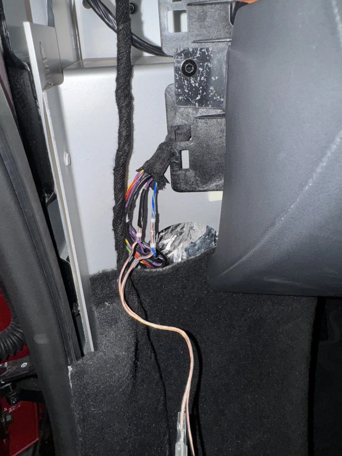

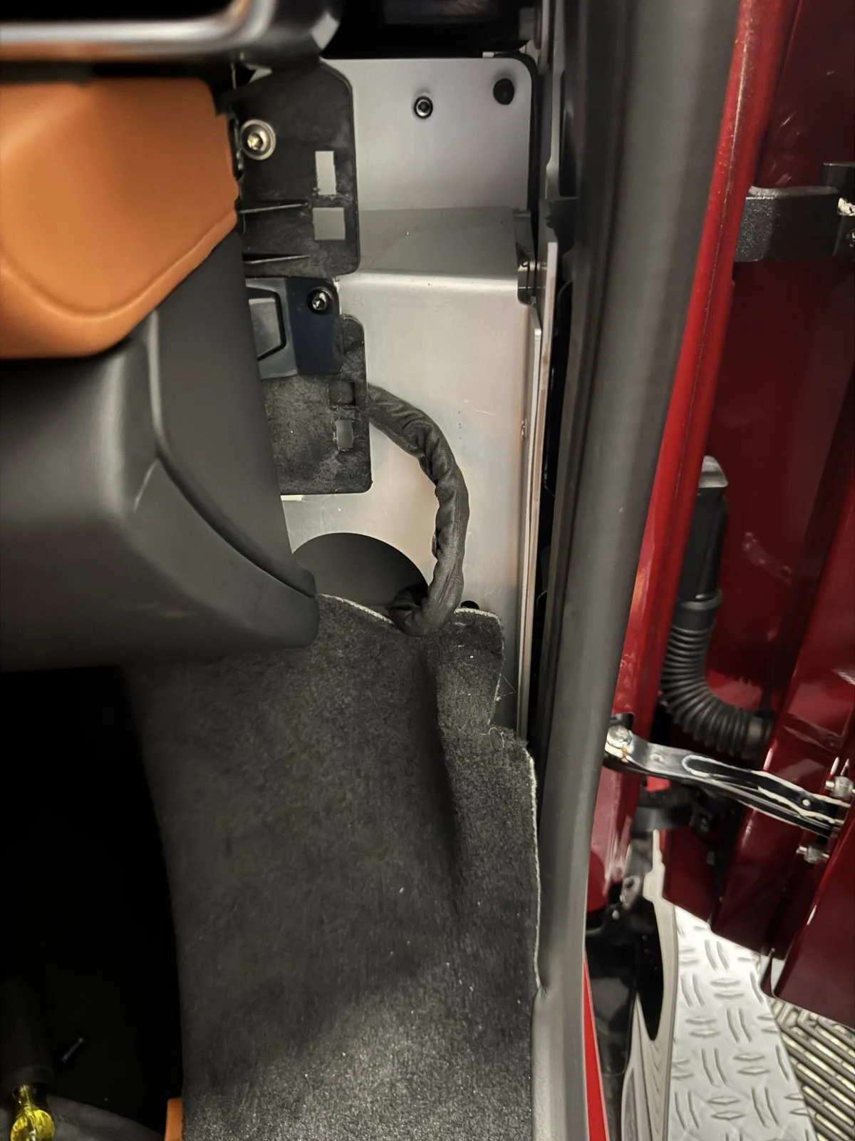

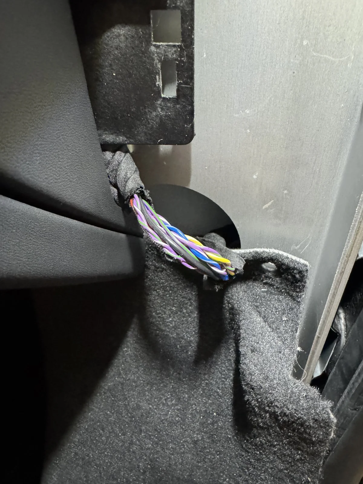

Here are some additional pictures to those already provided by @Chriscpm which you may find helpful.

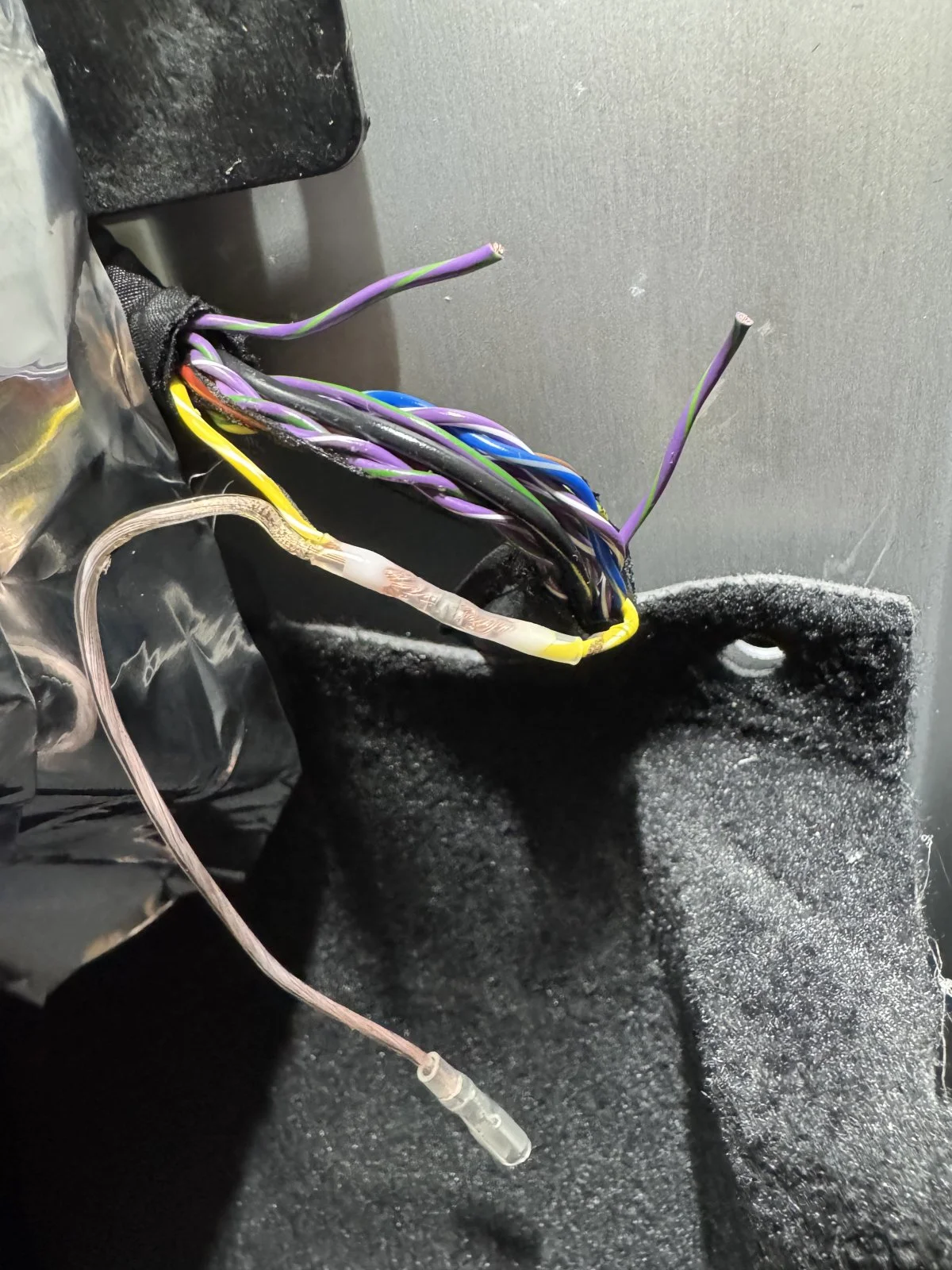

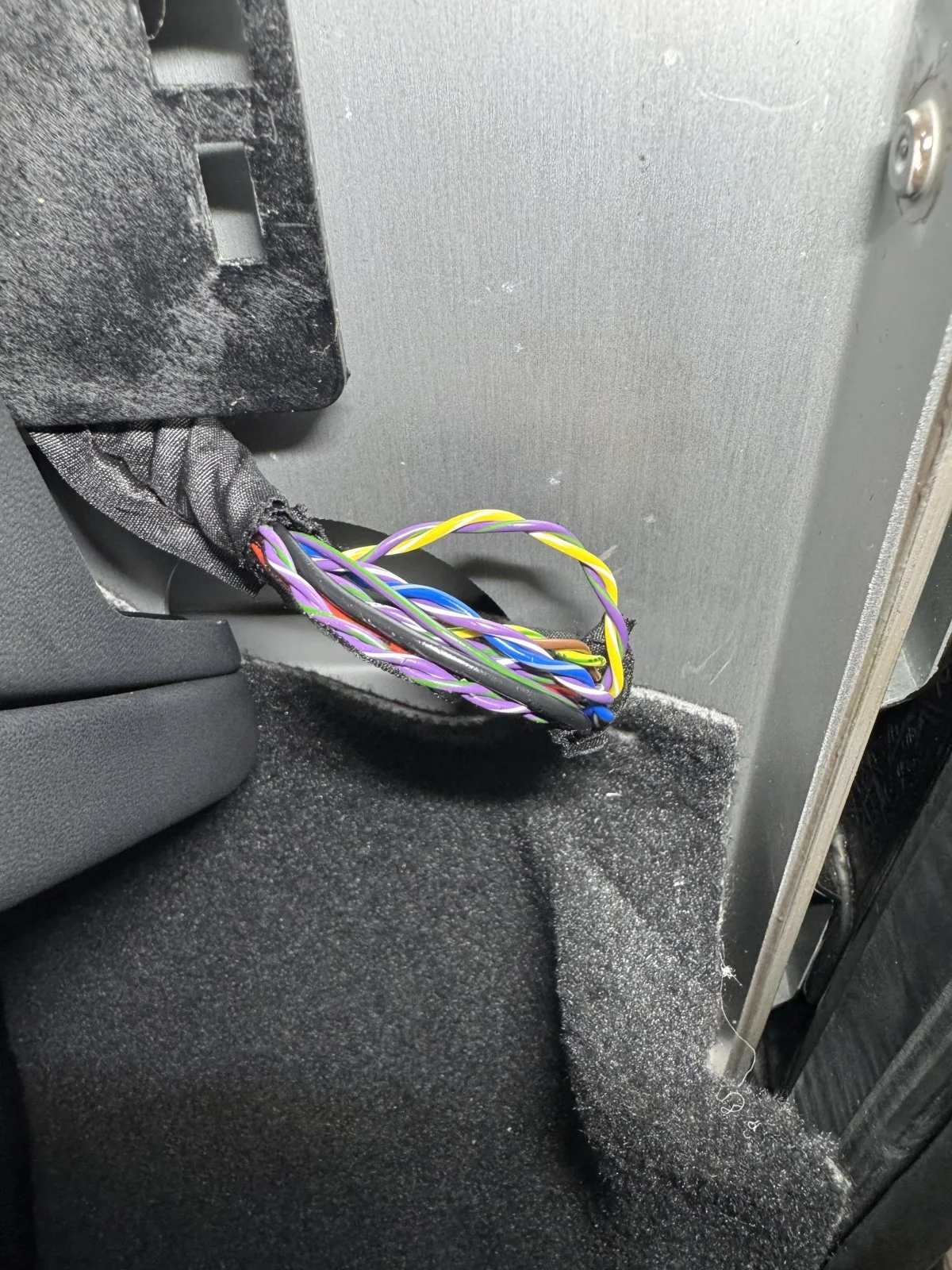

(passenger side) Take your time and be extra careful in opening and cutting through the wire cloth tape to ensure you don'y accidentally cut unwanted wires. These bunched up wrapped wires are very thin. The yellow/white stripe and purple/green stripe tweeter wires are easily identified as they are braided together.
PART 2

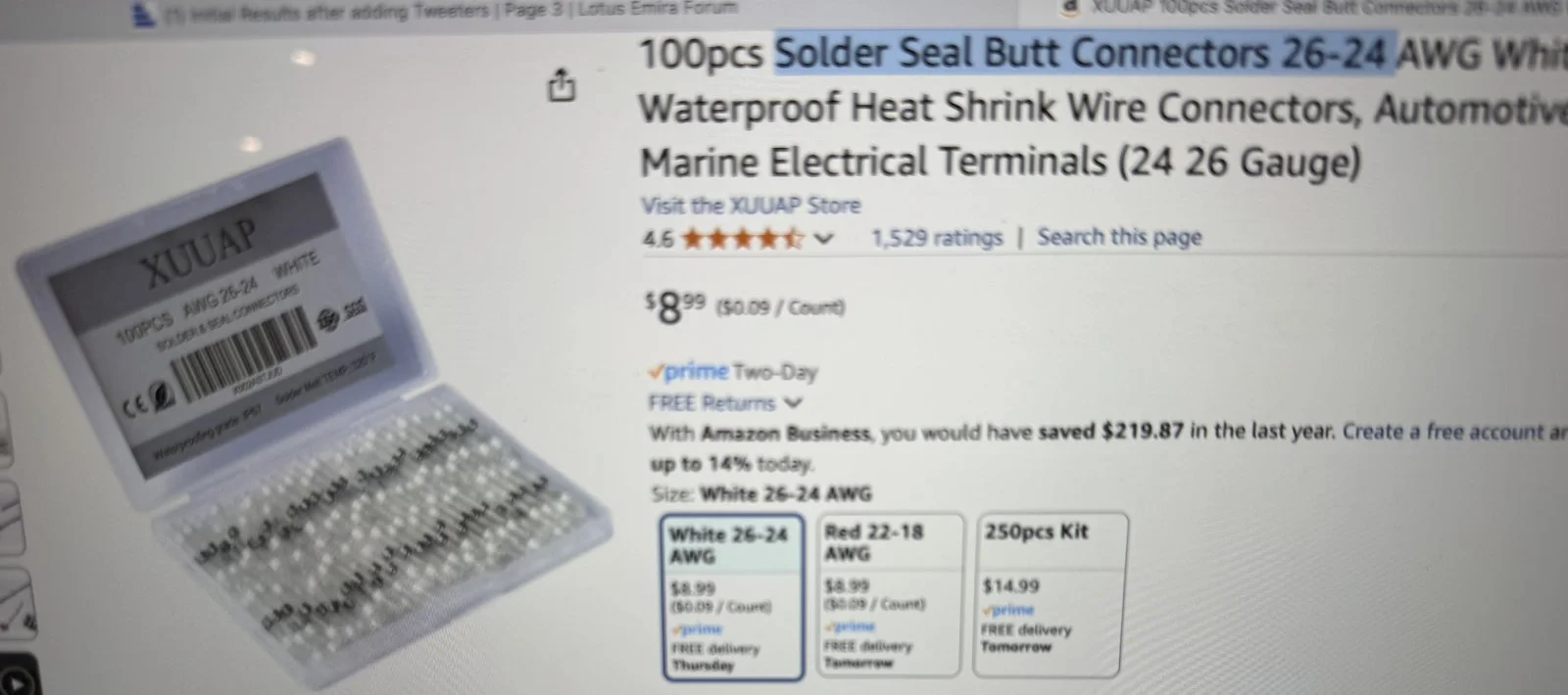

I used solder seal connectors and about 10" of the crossover filters' end wires that came with the Alpine kit and since I didn't use the filters like @Chriscpm, these end wires were very handy since they already come with the end tab connectors to the tweeter wires.
(Drivers side) The Blue/white stripe and purple wires are also braided together.
I drilled a small hole in each of the 4 corner plastic tabs with a 1/8" drill bit to pass through the zip small ties to secure the tweeters firmly in the bracket. and then used the foam that came with the Alpine kit to protect the rear of the tweeters (not pictured). Second picture above- I connected and wrapped up all the tweeter wires with cloth tape to protect and seal them.

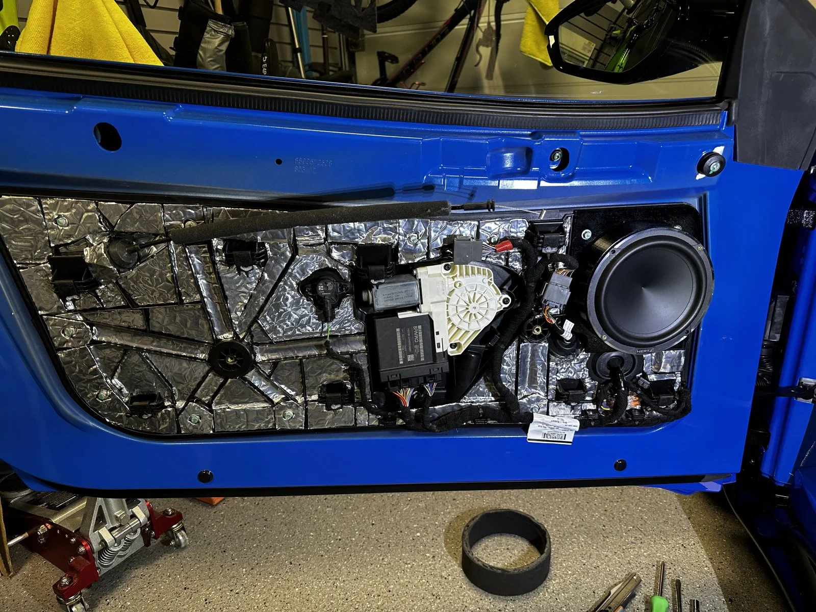

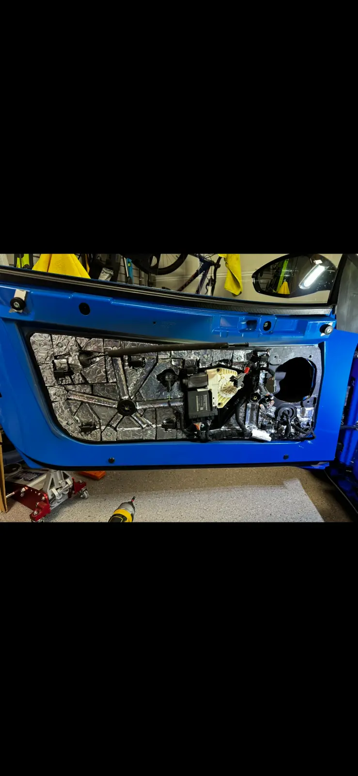

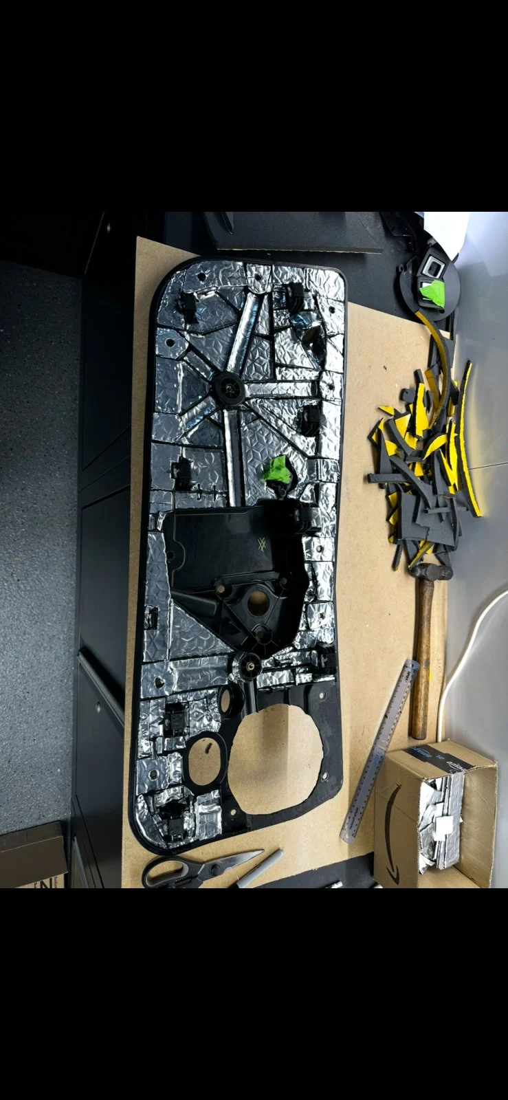

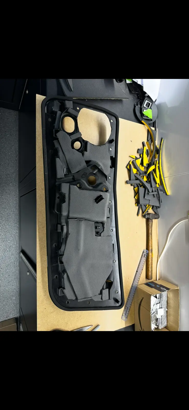

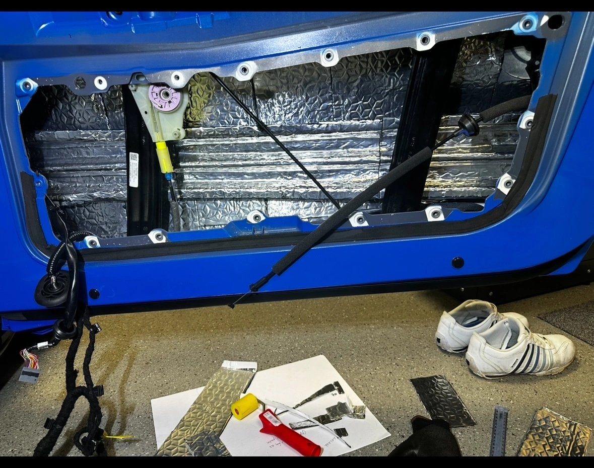

I used 1mm Second Skin Sound Deadning material placed firstly in the inside of the doors (not pictured) and then on the black door trim panel (pictured). The result was very similar to @KJWEmira's Seneca Blue previously posted pictures.
Hopefully, you'll find these pictures/guidance steps, along with those already posted by @Chriscpm and @KJWEmira to be useful should you also decide to also perform this mod. Happy to help with any clarification if needed.

I’m curious about the wires you tapped into. I believe Chris tapped into the midrange wires - did you tap into those or did you tap into the tweeter wires?
Super useful thanks for taking these photos and putting the work in on the write up. I’m definitely going to figure out this mod.
Good question, and I should have mentioned it. I did test one Alpine tweeter on the passenger side by tapping first into the midrange wires and then into the tweeter ones. For the test, I used T Tap connectors to avoid cutting, having to reconnect and minimize wire cover damage. And the result? Frankly, my ears could not discern a difference in either output power or sound quality between the two, so ultimately, I opted to tap into the OEM tweeter wires.

I used 4 1/2 sheets on each door. I ordered a pack of 20 sq feet (10 sheets) on Amazon and had a little over 1 sheet left over. As I've tackled other projects for which I needed to remove certain parts like wheels, wheel/well trimming, 3rd Cat, muffler etc., I've gradually been placing sound deadening in key panel sections of the car, but I haven't needed to remove the seats or any of the panels behind them yet. As for my experience so far, the sound deadening added to the doors is what has resulted in the most noticeable road noise insulation. Hope this helps.
Thanks, Crestima, and @KJWEmira
I am getting ready to begin the insulation of the door project. I've ordered the Second Skin that you used.
I have the instructions for the door panel removal, but I'm just wondering if it is pretty easy to do. Any issues with breaking the clips that hold the panel on, or tricks to removing the door handle actuators? Also, it appears there are about a billion screws that need to be removed, is that correct?
I see you have both installed the sound deadener to the interior of the exterior of the door and to the exterior plastic the door panel is attached to. What was the strategy in applying the sound deadener to each area, did you start in a certain location in each space? It looks like on the plastic panel it's really just a patchwork of small pieces that were cut, is that accurate?
Any other tips you may have on installing the sound deadener would be greatly appreciated.
