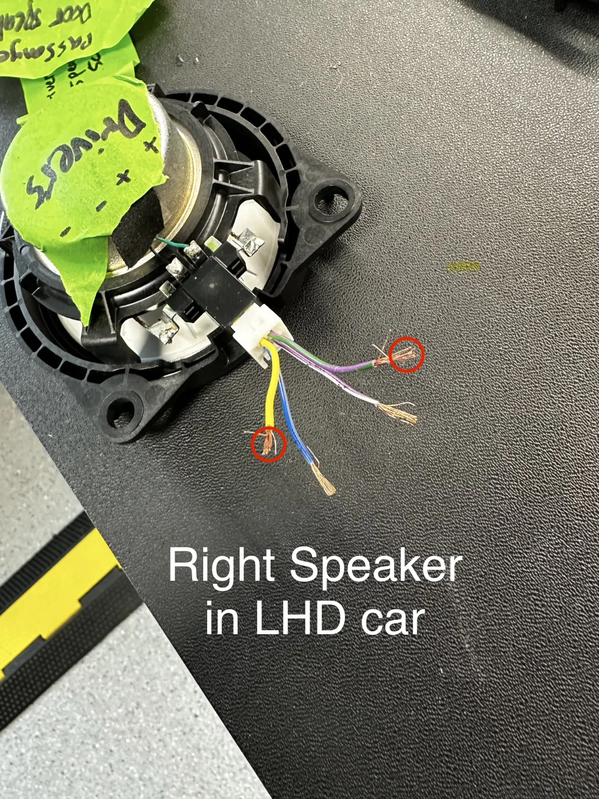

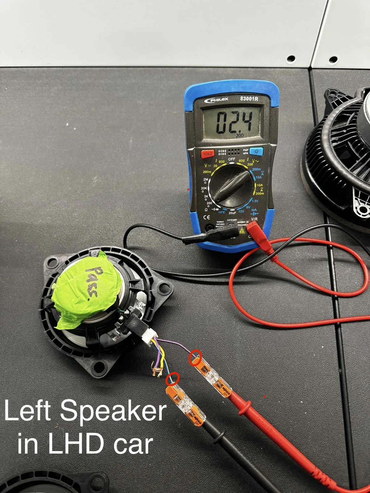

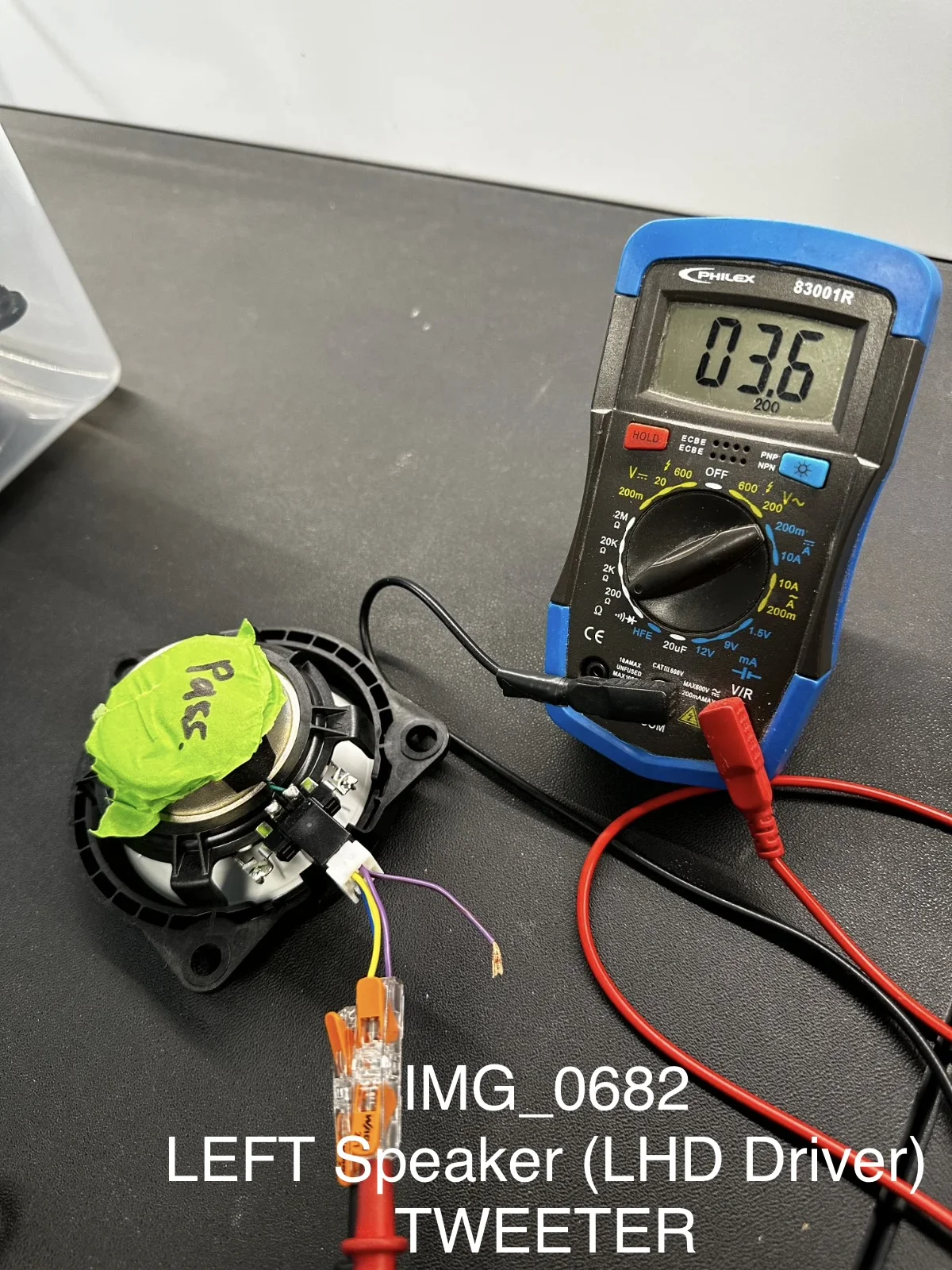

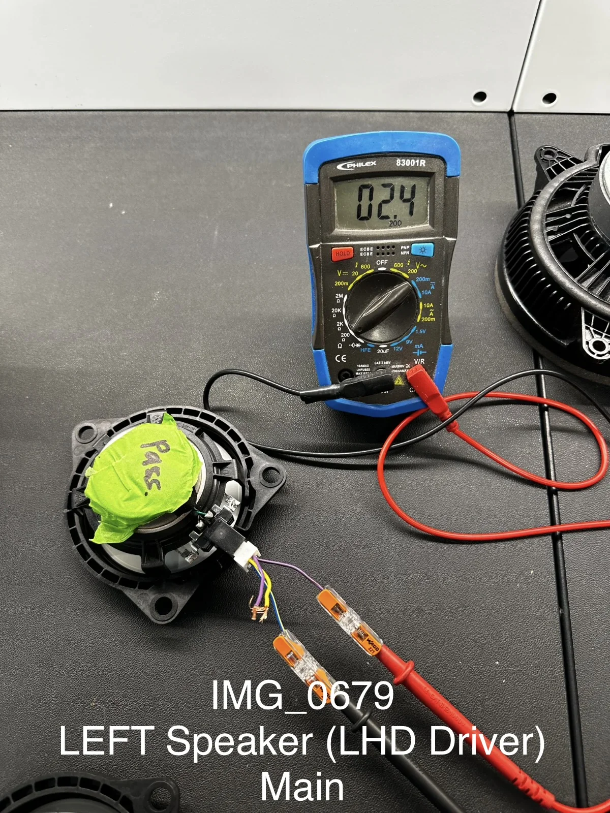

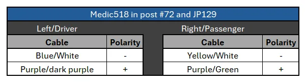

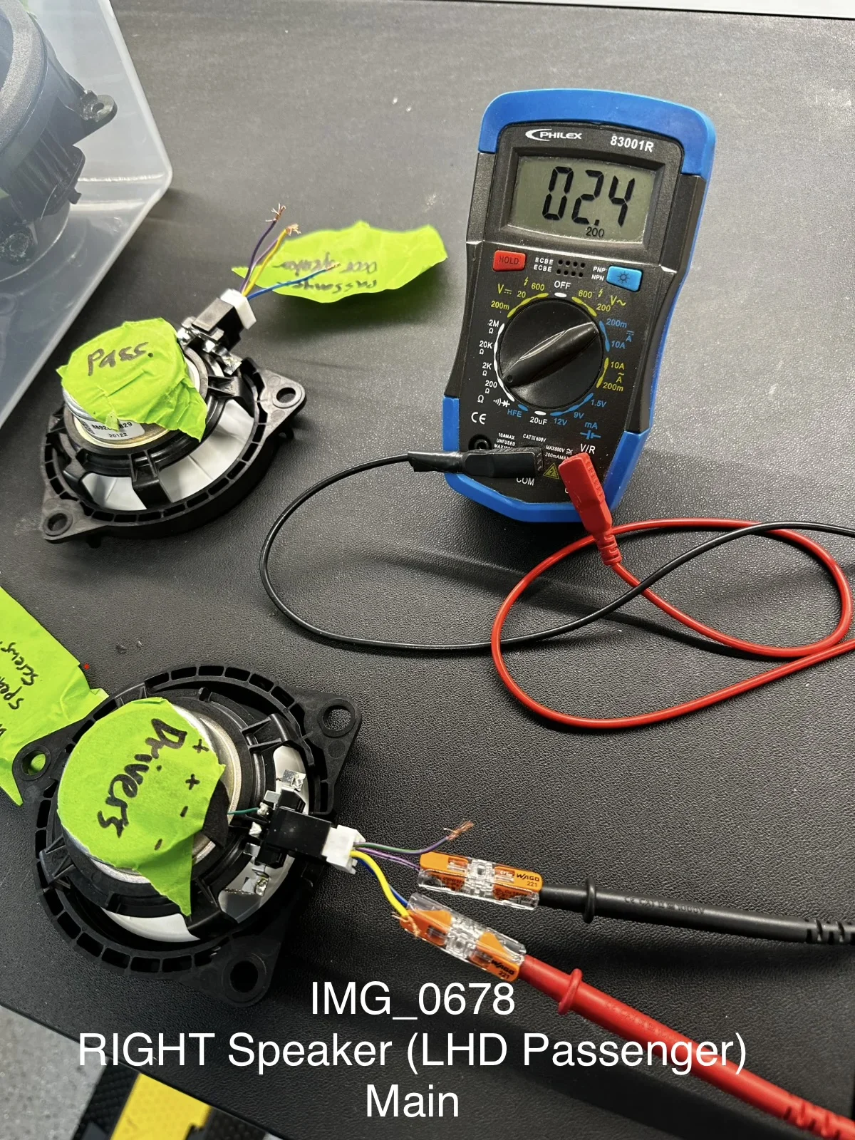

Purchased a set of Hertz c26 tweeters off eBay to upgrade my KEF audio. I read everyone’s comments on properly wiring them into the system. I closely studied the photos of the drivers and the comments of others. I realize the photos in an earlier comment are from a British viewer, but the wiring for the combination midrange/tweeter is the same worldwide. It is clear from the photos, that on the midrange, there are 4 wires, and that the bottom two wires are the tweeter wires. Furthermore the right bottom wire is the positive connection. After looking carefully at this and the comments, the proper colored wires to tap for tweeter additions are as follows:
Driver Side:
+ Purple/Black
- Blue/White
Passenger Side:
+ Purple/White
- Blue/White
