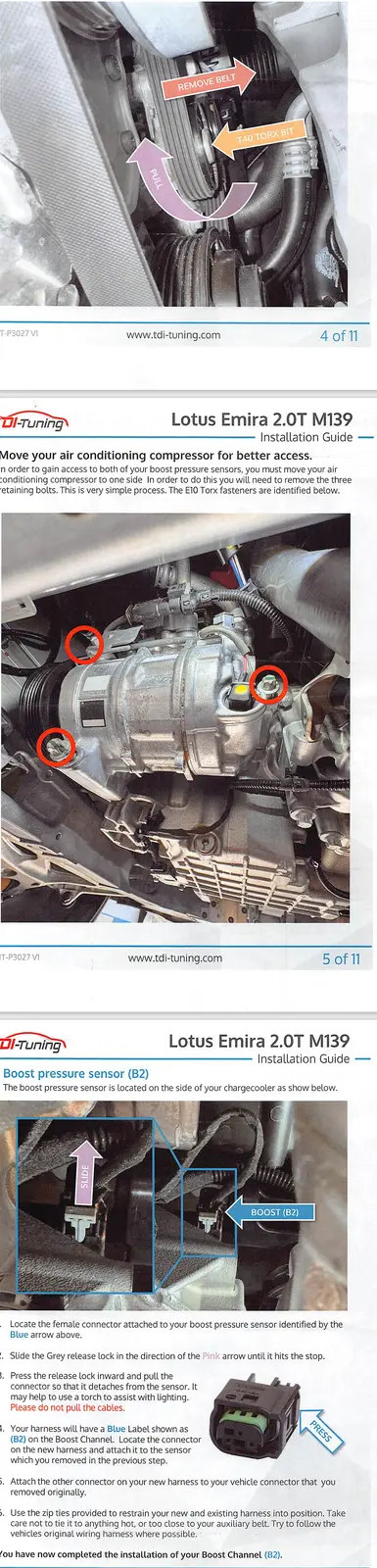

We have verified proof that map 2 works without the OBD connection in place by a couple users,
I think Burger would prefer everyone to have this connection in place to log data and send to them so they have a large sample size from people across the country/world with various fuel types, elevation, temps etc etc to optimize the maps even further.
I know its a pain to run the cable to make that connection but it is sort of for the greater good if you are going to run the higher level map and then you can 100% verify your car is running optimal.
How does it look for filling back orders? I'm now at 15 days and waiting.
rather than running crazy long wires just to get the CAN data, just tap into the 2 CAN wires right off the ECU would likely be 10x easier. Just a thought.
Exactly, someone should pull back the loom take a picture of the wire colors and find a good place in the harness to splice in -
Better yet the JB4 guys should weigh in on the best place to splice in - maybe even provide water proof splice connectors in the kit or OEM plug adapters with quick connection ends for bare wires.
I think you are missing the fact that Lotus doesn't have a published wiring diagram. Not in any of the paid manuals or nothing.
You could spend time a reverse engineer it, but it's not going to be pretty or easy.

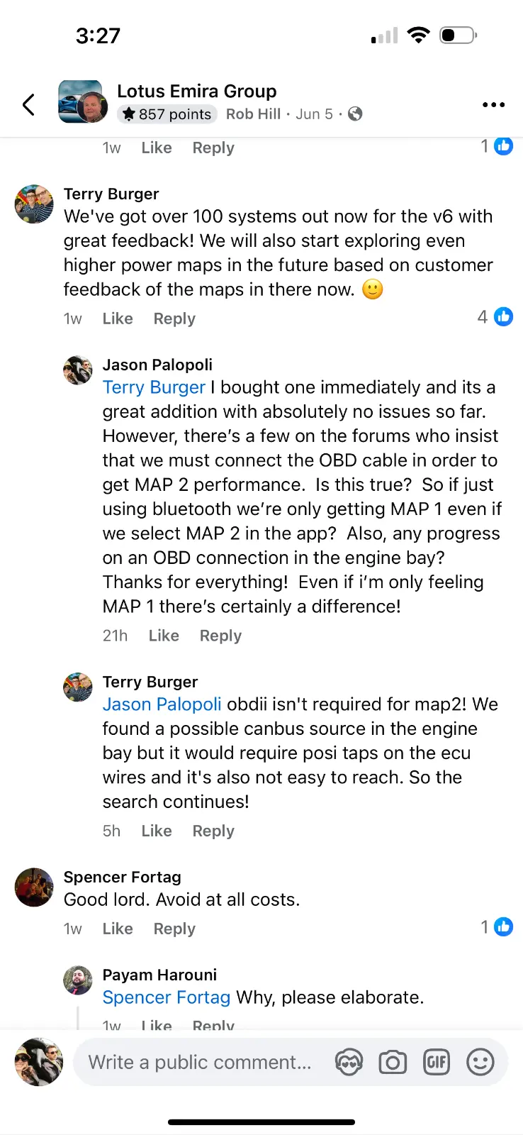

Hey everyone…first time poster but been using this forum for a while for info. I’ve owned my v6 manual emira since 4/2024 and thanks to GRP I’ve made a bunch of upgrades (thanks greg!). Anyway, I reached out to Terry Burger over FB to find out if the OBD connection is really required for MAP 2 and apparently it is not. This is my experience as well since I definitely feel a difference between MAP 1 and 2. I have no intention of using the OBD cable only bc I’ll have to remove it every time it goes to the dealer (which has been a lot recently…for cosmetic things nothing mechanical).

I know we have conflicting reports but it makes sense that the OBD connection is required only for recording data or pursuing a custom tune for “your” car. Otherwise the JB4 is preprogrammed based off the donor car. Doesn’t seem logical to need the OBD for map2 but not map1. I’m in the don’t need it camp 😎
Just asked again today for a clarification. Need or not need.. and today JB4 told me that it is not needed for the map2.

Hey guys, just to clear up some general confusion:
1) Without OBDII the JB4 can only read in the sensors it's attached to. In this case the MAP sensor for boost and the MAF sensor for airmass and inlet temperature. Using only those parameters the JB4 can provide pretty solid tuning and map1, map2, and map3 can be run like this. And this allows you to install or remove the JB4 in minutes!
2) Adding the OBDII cable gives the JB4 a lot of additional data including engine speed, pedal input, throttle, timing advance, fuel trims, AFR, engine temperatures, and more. When available the JB4 takes all this CANbus data and incorporates it into the tuning which produces a smoother and better tuning output. Think of it in terms of resolution, high def vs low def. You can still watch the football game in low def but it's not quite as crisp. Without the OBDII certain elements have to be modeled/estimated instead of being read directly.
We understand the OBDII is a total PITA on the platform and we're still looking for alternative connection points. For most of you I suspect the normal "low def" (no OBDII) tuning is so much better than the factory tuning to start with you won't miss the extra OBDII data. And for the hard core among us then you can route it.

Map2 can be run on 91 but I would not do it without the OBDII cable attached, and then send in a log so we can review the timing/AFR for you to ensure it's safe. Also keep in mind when octane is below grade even though you can run map2, it might be the case that map1 is actually putting down more power.
