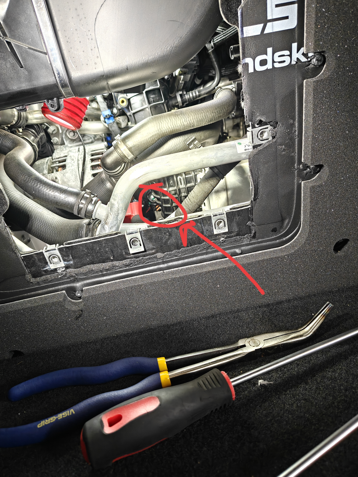

Anywho, i couldnt find the cabin-engine rubber grommet behind the panel behind the driver’s seat where the fusebox is located. And i wouldve had to fish the OBD wire up from that grommet to the mounted piggyback anyway.
I studied the Service Manual today and am thinking about removing the accessory belt and unbolting the alternator out of the way to get at that MAP harness. Shouldnt be too difficult. Need to rebuild up the motivation after this past weekend’s defeat. 😞 Lol

Im now a self-professed pro at removing the backseat panels with extreme efficiency. 😜 ( getting better and better with panel reinstallation lol)

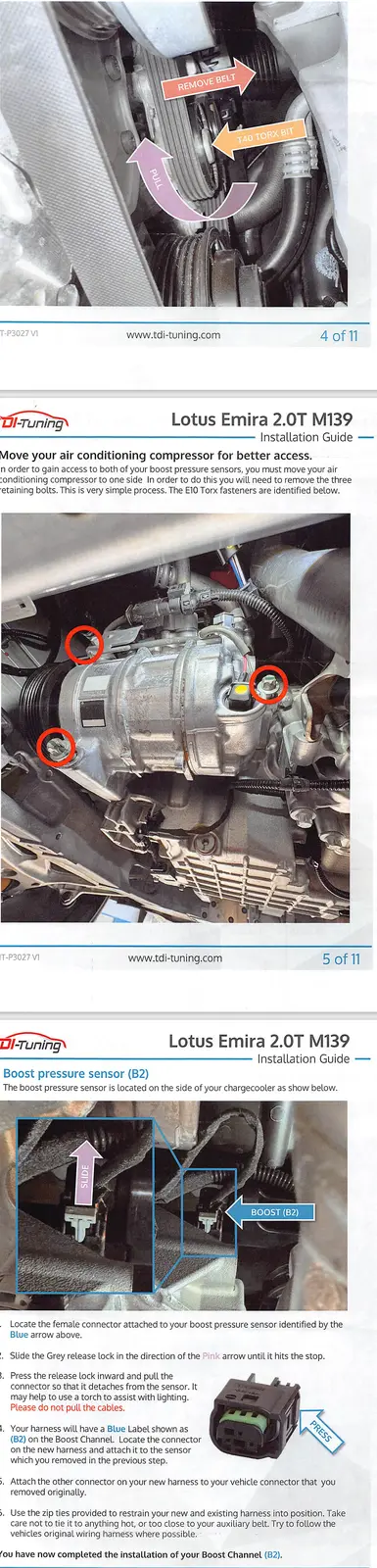

This is what I did as per TDI instructions. I had a small breaker bar to help push the pully out of the way. I couldn't do it with the wrench alone. I detached the compressor, removed the belt and pry the pully over. Reached in and grabbed the sensor plug. It's tight but just breathe and take your time lol
I have the TDI as well, i didnt think to read the instructions to see if installation instructions were different. Yes, moving the AC compressor from below (vs. the alternator from backseat rear panel access window) would be easier and should give adequate space. This is exciting! Thanks for the info… :p
