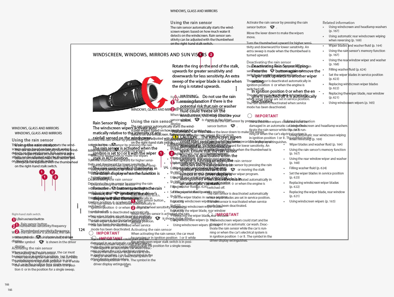

I noticed there's hidden text on page 124 of the user's manual, unmasked and...
I suspect this is an artifact of the PDF packaging process for release, and possibly an artifact from an earlier version of the file. You can co-package a raw text (Postscript + images) version and a "flat" page-image version of a file together as a single PDF, and that's what it looks like you might be observing here.
I don't see anything jump out at me that's significantly different... looks like maybe there were in-situ cross-references to other sections of the manual at some point that were removed? If so, I understand why... PDF doesn't have automatic reflow of links when edited, so anytime you add or change anything, every single one of those cross-references would need to be updated throughout the text. The right way to govern this sort of thing is by authoring and maintaining the document using a structured document language like LaTeX.
Let us know if you can extract anything that deviates significantly from the text in the existing Handbook.
Holy crap, it's just page 124 that's a complete mess. It looks like someone just completely murdered this thing with a series of accidental copy/paste or layout reflow errors in Adobe InDesign.
I exported pg 124 on its own and have been analyzing it with PDFexplorer. It's chock full of broken/empty InDesign bounding boxes and layout positions that don't correspond to any content. It looks like maybe someone tried to copy/paste part of a Volvo manual in here (Volvo in-house fonts are used) and just absolutely destroyed the thing. The tree in the raw view has literally thousands of objects in it, most of them broken.
Sort of hilarious. But at least it's just this one page. The rest of the manual (seems) to be ok as far as I can tell, though I haven't analyzed every page. But it partially explains why this thing is over 30MB in size when it could probably be 3MB or less in a fully optimized form.
[edit] I've attached the raw text dump from the internals of just page 124 of the Handbook. It's clearly a mashup of a bunch of other files, and references page numbers that are way outside the bounds of this document. It also references rear wiper control and all sorts of stuff. Good fun.

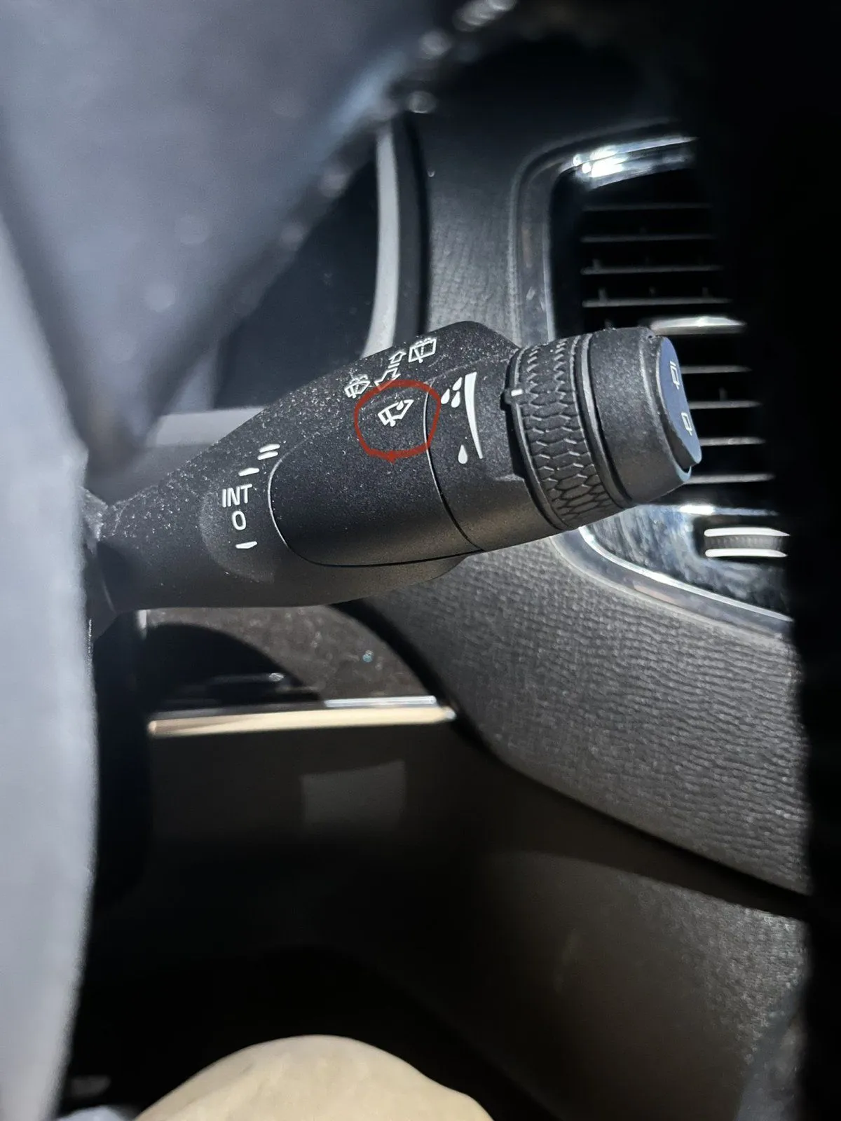

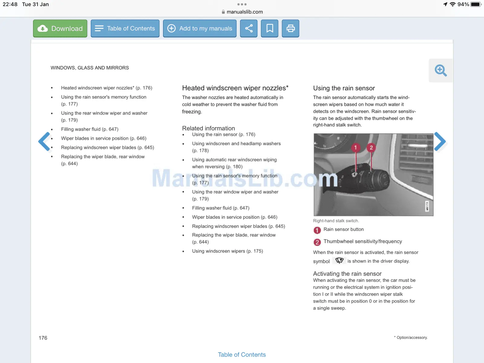

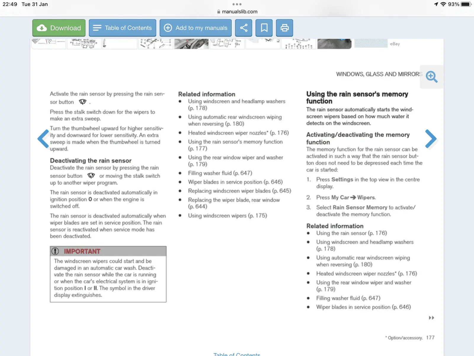

@Porter - that’s an interesting thought about the page being copied from a Volvo manual. I have included a photo of the wiper stalk from my wife’s 2019 Volvo XC90. Notice that it says “INT” instead of “AUT” on the speed selector. There also fewer raindrops on the Emira stalk compared with the Volvo which seems ironic coming from an English automaker.
The only way to turn on automatic wiper sensing in this vehicle is to press the windshield icon (circled in red in photo) when the speed selector is in the “0” position. It doesn’t look like a button that can be pressed- to this day, my wife has trouble finding it :)
Obviously, this is a shared part with Volvo/Geely but somehow it seems to have been installed/wired differently.
It sounds like some Emira owners have already tried this method without success but has any Emira owner noted any effect when pressing the windshield icon?
The XC90 manual looks strangely familiar, especially when you look at the unlocked information above. Note the volvo has a software switch under settings that allows you to start in Rain Sensing mode rather than having to switch into it each time.
I have checked again just now. That is not a button and has no response when pushing it forward (it does move slightly forward, with a spring back which suggests it might have been designed for a purpose in this or other vehicles. The same as the opposite stalk for the full beam flash).
It isn't a touch control or anything else. It is solid plastic. Nothing appears on the display when it is pressed, swiped, pulled etc.

This stalk is exactly the same as my Volvo XC60 - to start the the wiper in rain sensing mode - you press the housing - there is a switch inside. Press with you thumb.

Can any Emira owner test and confirm? Does "squeezing" the stalk to press the housing at the icon location engage any wiper function for you? And if so, is there any corresponding icon on the dash display?
(I'm assuming No to both questions, I just wanted to double-check since we have more info now, and confirmation of different function on a comparable stalk from Volvo/Geely)
There is no pressing / squeezing whatsoever. I was stuck in traffic for an hour today and played with the wipers and stalk. Once you go auto, you never go back. Tried the wildest combinations.
If I see someone suggesting to squeeze it one more time I'm headed to the garage and will take a video 😂
Auto mode "works", there wouldn't be a function that extra button could provide.

There is no button on mine but the stalk definitely does “click” forwards. Non-latching.
In the same way as the main/dip light stalk on the other side.
The picture in the handbook suggests to me that that’s how it’s supposed to work.
