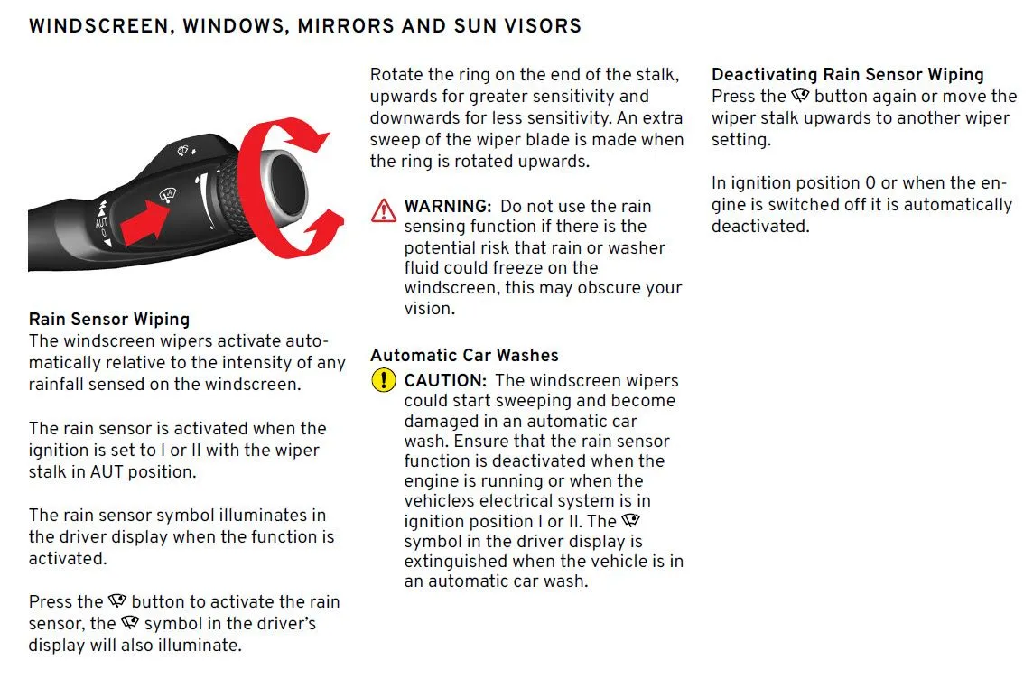

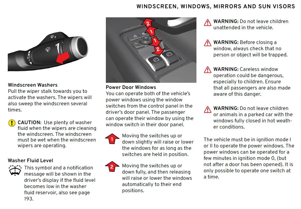

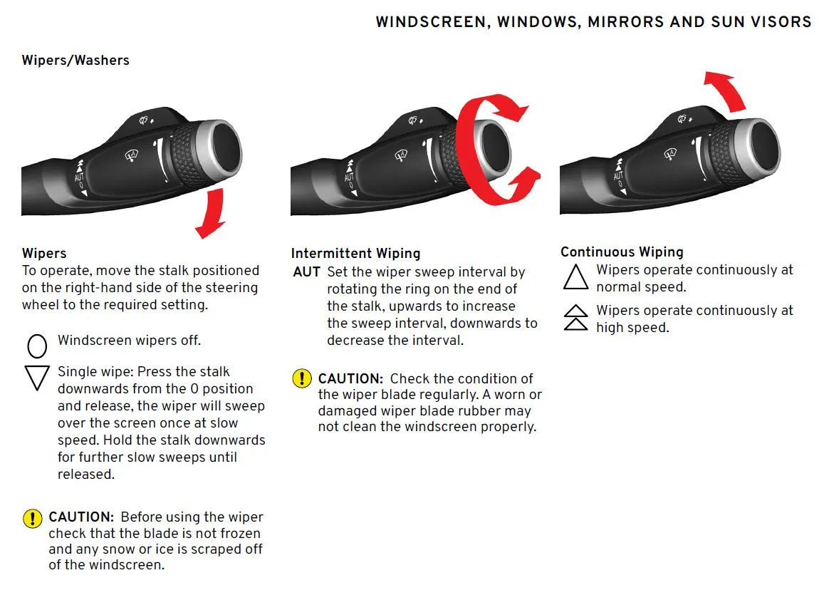

The lump on top of the stalk is not a button. There is no button on the end of the stalk. Pulling the stalk towards you activates the washers. Pushing where the arrow indicates (in the image above the Rain Sensor Wiping heading) moves the stalk back, although it feels like you are trying to force it wrong way.
I split out the 3 relevant pages of the User Guide PDF and have attached them here.
I interpreted this diagram as
  • Stalk up/down has 4 positions and a momentary switch, listed bottom to top:
    • ▼ - Single Wipe (spring loaded return)
    • 0 - Off
    • AUT - Auto Intermittent
    • ▲ - On
    • ▲▲ - On (High)
  • Rotate stalk end ring to adjust Rain Sensor sensitivity, including AUT / intermittent.
  • Push stalk away for manual Rain Sensor operation/override (toggles state & light on dash)
  • Rain sensor mode engages automatically on vehicle ON or restart when in AUT mode. Rain sensor mode should not engage automatically if stalk is in 0 position.
  • Pull stalk toward driver for windscreen wash spray.
Does anyone else agree with these? Or read something different into the above?

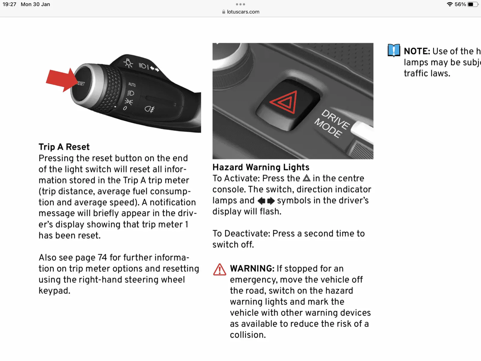

The manual shows a button on the other stalk used for resetting things. I assumed the wiper stalk was the same. @Mh59 do you have one that looks like that on your light stalk?
No, it’s definitely not a button on the end. I tried to push it when posting those images earlier.
It’s just a solid end cap.

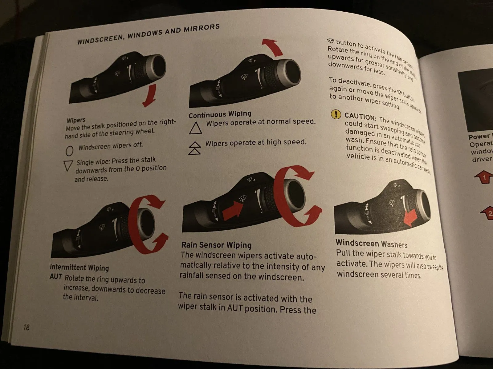

Have you tried putting your fingers behind the stalk, and your thumb on the wiper symbol in front, then squeezing to see if it clicks inward towards your fingers?
I edited my post above for clarity, and attached all 3 relevant pages of the User Manual.
I’ve just checked my manuals (quick start guide and owners manual) which look a little different to the earlier images. There is no mention of the dashboard icon and nor do I recall seeing one.
The imagery which shows all of the dash icons doesn’t mention an auto washer light either. Odd.

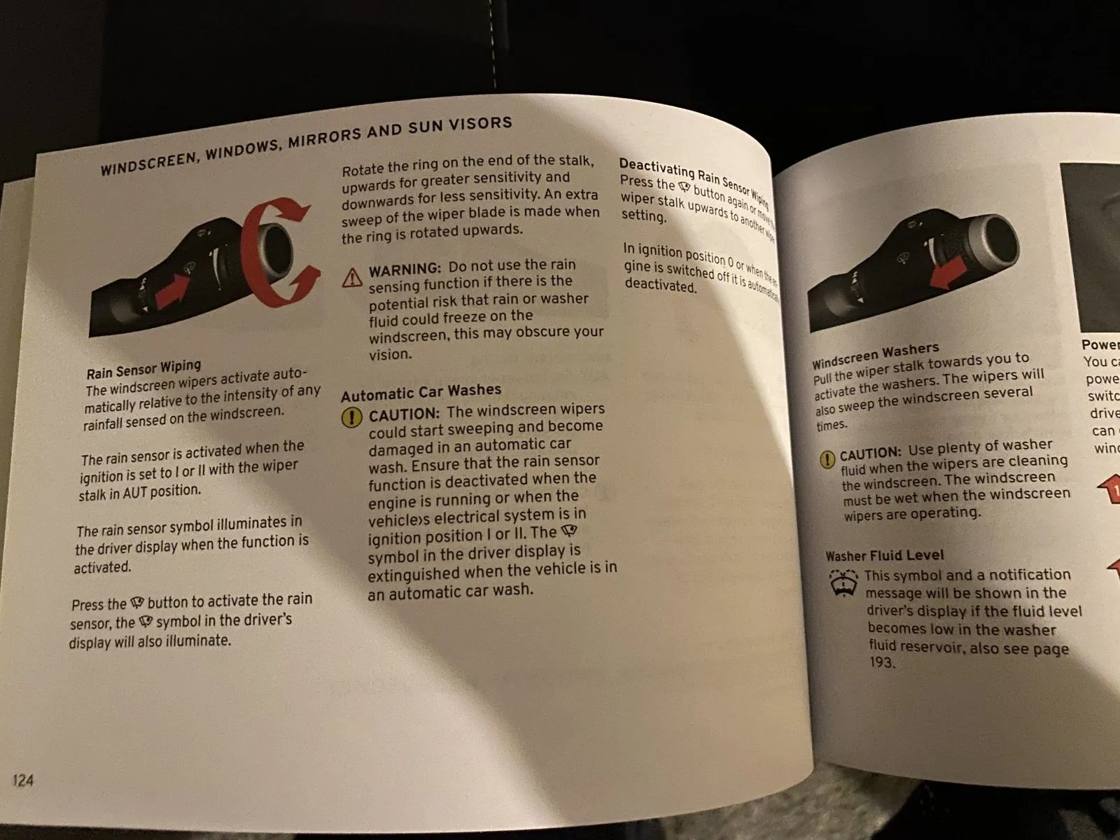

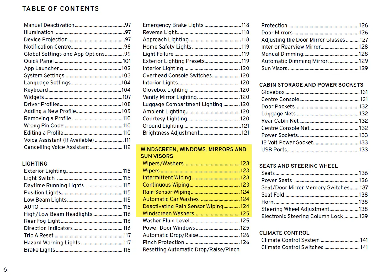

Page 124 of your Owner's Handbook doesn't look like what we posted above? Not the Quick Start Guide, it's the bigger manual.
It's also downloadable from here, the current version is noted as v2.1 : https://www.lotuscars.com/en-GB/emira-handbook

You are right, there is more detailed info on p124 of the main guidebook. My images were from the quick start guide.
Why it differs from the quick start guide is odd, given the very basic nature of the functions.
