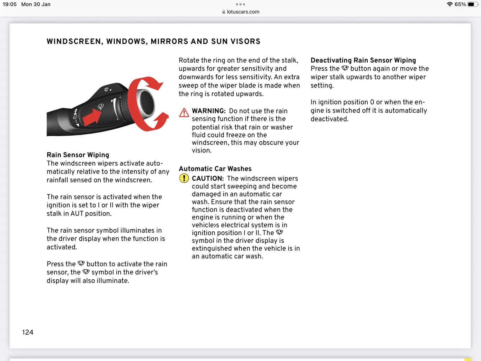

Having looked at the manual (p124), the implementation is slightly confusing. The stalk is labeled 0 AUT 1 2 (the last two with arrows). It looks like AUT puts it into intermittent (INT) mode, sweep frequency controlled by the ring around the end of the stalk. It only becomes Automatic (rain sensing) if you push the button on the end of the stalk in which case a light comes on the dashboard to tell you it’s in that mode, and the ring now controls sensitivity of the rain sensor. While some owners clearly have a problem here, there is scope for confusion in use. I guess it’s like this anticipating a model that doesn’t have rain sensing wipers.
If I see any potentially confusing icons or words, the first thing I'd do is look at the owner's manual. Is that clearer?
Well you can download it yourself and take a look. It’s page 124 as I said above.

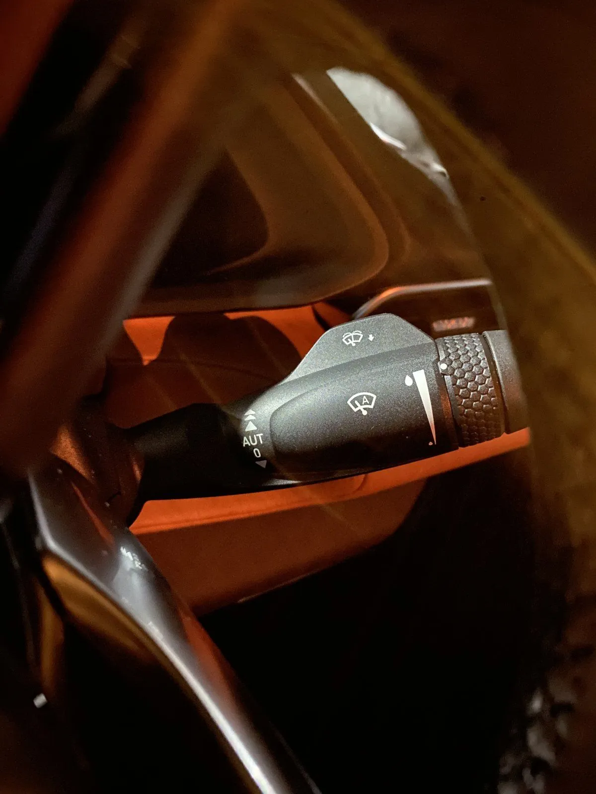

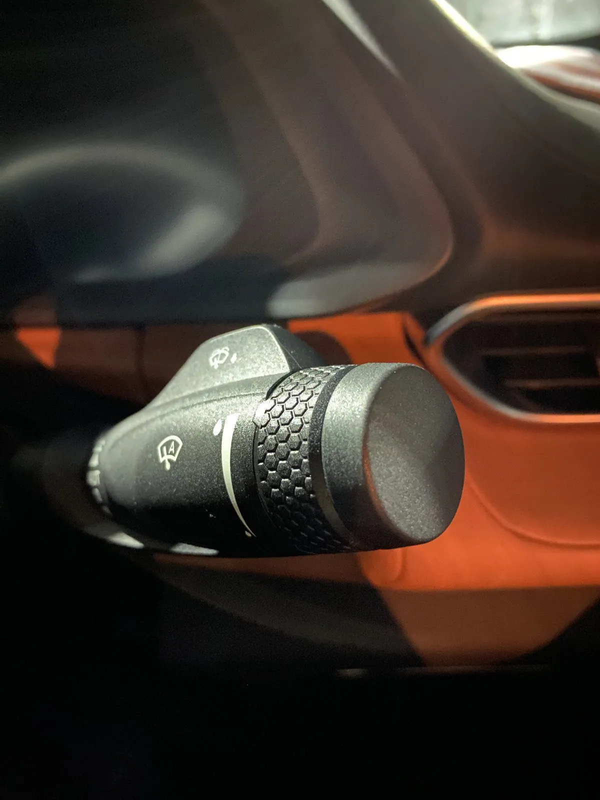

I haven’t read the manual for the wipers but can confirm there is no button on the end of the stalk for the wipers.
Mine is a UK vehicle.
Now that is interesting. See screenshot below from the manual I downloaded when I just googled Lotus Emira Manual. It is dated Aug 22 so maybe something has changed in the implementation. Do you have a rain sensor symbol on the dash!
You push it back, or at least that is how I interpreted it.
That said I don't ever remember seeing a rain symbol on the dash.

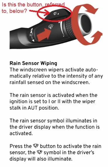

It is a bit unclear. It seems as if leaving the stalk down means manual mode is active unless you either move the stalk up or press the ambiguous "button" on the stalk. Does the stalk have to be in the up position when you press the "button"?
I am speculating a bit as that was how the system in my wife’s MINI worked. There was a button on the end of the stalk which you pushed to switch it from intermittent to rain sensing and back. It looked just like the one in the picture. And a light came on on the dash to tell you.

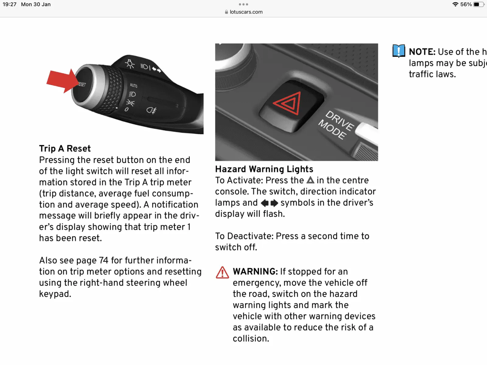

The manual shows a button on the other stalk used for resetting things. I assumed the wiper stalk was the same. @Mh59 do you have one that looks like that on your light stalk?
