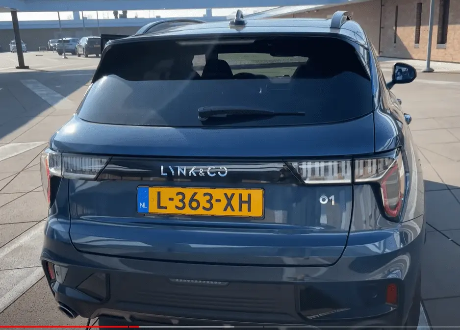

The stalk end control on that vehicle is for the rear wiper, I believe.

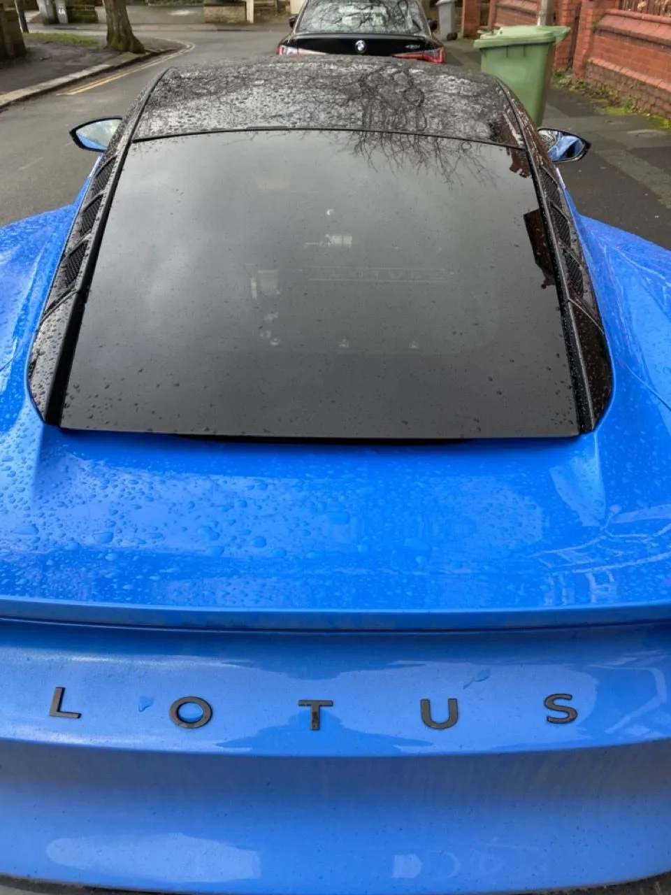

There is no rear wiper. Not on UK vehicles anyway.
I would be surprised it overseas vehicles have one too as the place a wiper would normally be has a void under the glass so there is no place to mount it. It would have to be mounted from the top which wouldn't do drag any favours.
The vehicle in the video is a Lynk & Co 01 and it absolutely does have a rear wiper.

I was talking strictly in the sense of the Lotus Emira parked outside my house and what appears limited functionality of the wipers, as others have also reported.

  • @Pugwash pointed out the wiper stalk end button controls shown in that video, and wondered if those buttons were the relevant controls that seem to be "missing" on the Emira compared to the Owner's Handbook guidance.
  • I responded to Pugwash explaining that the wiper end stalk button controls shown in the video were for the rear wiper, a feature that is specific to that vehicle, a Lynk & Co 01. My post was simply intended to clarify the L&C 01 endcap button function so that we could return to an investigation of the controls that do exist on the Emira.
