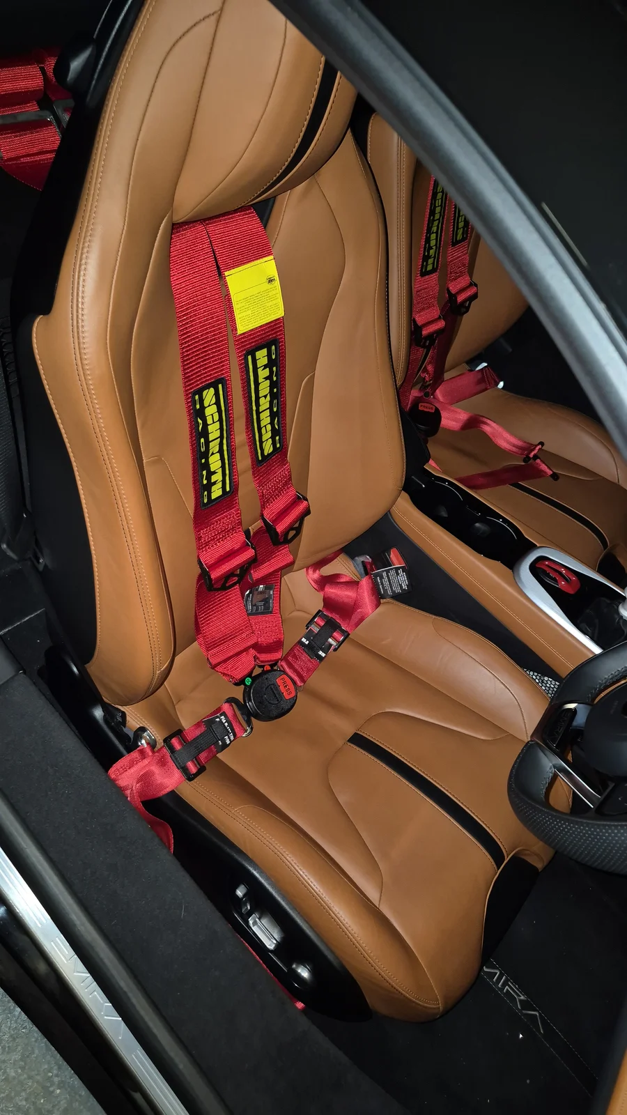

What is everyone using for harnesses? I typically prefer 5 or 6 points, but I'm not keen on drilling holes in this chassis. I saw the 4 points that are apparently FIA legal on GRP's site. Is that the general consensus for the optimal harness?
4 Point Schroth ASM is what I have used for the last 15 years. If you don't want to daily in an uncomfortable race seat, the ASM is the way to go. Just make sure to adjust it and tighten it so the lap belt is as low as possible to keep the force off your organs in case of a crash, but to also keep the shoulder belts tight so you don't break your neck. And while I have the floor, years ago Ron at Discovery Parts and I were waiting to get into Barber on a Friday night and he told me that if you have a face shield on your helmet and air bags, not to leave the shield up because if the air bag deploys and it hits the shield, it can result in serious neck damage.

GRP Harness Bar and schroth FSE 4pt

Greg will have to let us know what needs to be done and what parts are needed because I will want a 6 point harness for sure.
