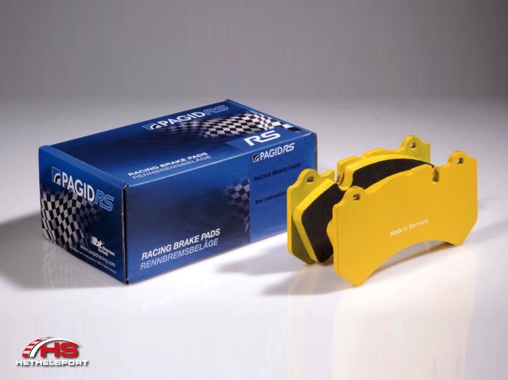

I have experience with 3 pads so far:
  • Stock (Ferodo DS2500): Decent stopping power, but they wear super fast, are super dusty, and most importantly for me they're squishy. The pad itself seems compressible or something because pedal throw length is really long.
  • EBC Blue: They don't fit the rear correct (overhang the rotor, build a lip that crumbles off). They warble when they get up to temperature. This is not a pad smearing or similar issue. I know other people that reported the same issue on Emira when using EBC blue. Stopping power was fine, they're cheap, but that warble really annoyed me.
  • Pagid RSL29: I didn't pick these out. I had a track day I forgot I registered for coming, and refused to go again with EBC blue. Someone local had these (thanks @kitkat) and I swapped them in right before the trackday. These have been great (maybe friction coefficient a bit too high for the Goodyears). Pedal is much firmer (they're less compressible). And the braking stays smooth through temperature. Only downside I've observed is squealing, but my car is purely canyon/track, so that's not a big problem for me.

I've been loving the Pagid RSL 29 on track, Greg has them on his site.
Pick one set of "RSL29 S2 Front / Emira Front" and one set of "RSL29 Evora S1 Front / S2 Rear / Emira Rear".
Separately I've been also trying on street a set of Project Mu HC+, great pedal feel, stands up to canyon usage, tiny squeal when I haven't given it the business in a while and unfortunately loads of dust.
