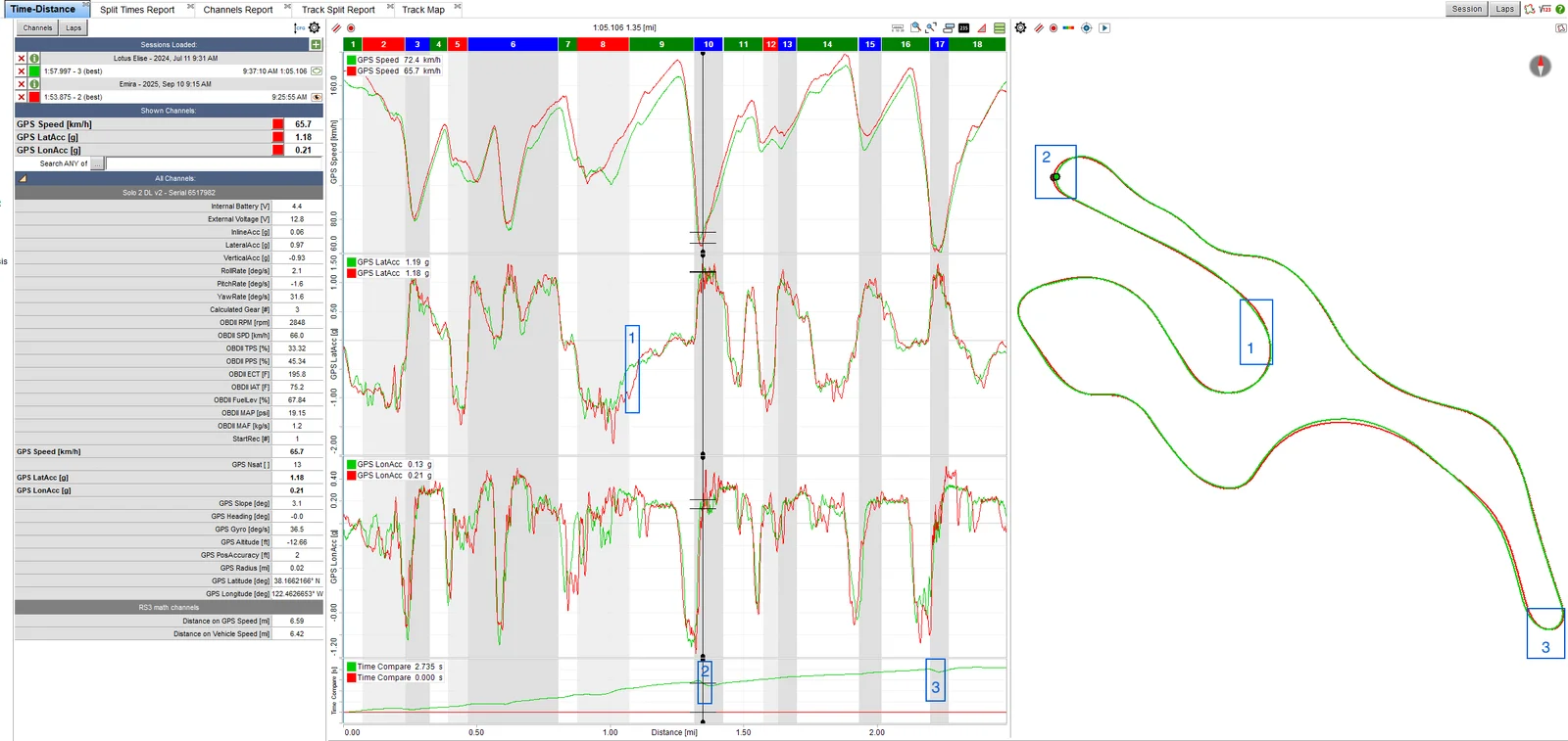

Here's the kind of cool stuff RaceStudio can do. I now have laps from Sonoma in my Elise SC and my Emira. This is a comparison of my best Elise lap (1:57.997) and my best Emira lap (1:53.875).
The top graph is distance over time, so basically speed. The middle graph is lateral acceleration, the bottom one is longitudinal acceleration. The Emira covers distance faster pretty much everywhere on track compared to the Elise, but I labeled 3 interesting points on this graph.
  1. The Elise accelerates earlier, harder coming out of the carousel
  2. T7 hairpin. The Elise makes up 0.45s on the Emira in this one turn
  3. T11 hairpin, The Elise makes up 0.25s on the Emira in this one turn
Everywhere else, the Emira is faster. Makes sense, light weight is better in hairpins, power/weight ratio is better everywhere else.
The first image is a thumbnail which hopefull expands to full size.
It's cool how close the two cars are to each other, however, for some reason, the Emira feels much more stable.

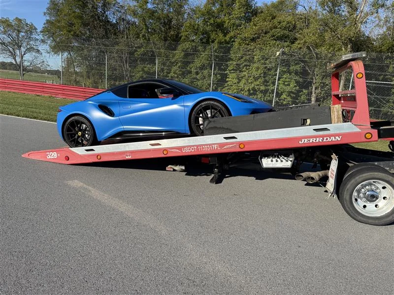

Was finally able to take a day off work to get my Emira on track at Mid-Ohio... my run group was the first of the morning (roughly 46 Fahrenheit out). First couple laps, I drove very reserved, as it was a cold track, and wanted to ensure everything was up to temp. As soon as temps looked good, I started to push a little bit (~half a lap), maybe driving 6/10 (didn't even sniff the rev limiter)... the car abruptly went into full limp mode; had the "Engine reduced acceleration" & "ESC Service required" notifications pop up on the dash. Luckily, was able to get the car well off the racing line before it fully shut down/avoiding complete disaster involving other participants. After trying several times to wake the car back up/start it, I ended up having to be stretchered off the track back to the paddock... my day of excitement & fun turned into ~15 minutes of being on track.
The only "performance" mods I have are GRP titanium exhaust + 3rd cat delete and Milltek valve controller. From what I've gathered from this forum, the Milltek valve controller wiring can overheat/melt and cause similar issues, so wanted to inspect - got the car in the air, removed the rear diffuser, etc. to gain access to where it was mounted... everything looked, and felt the same as the day it was installed. After I buttoned everything back up, and let the car sit for ~1hr, decided to wake it up and got all the same fault codes. Also checked the battery, and it was producing proper voltage. At that point, I threw in the towel.
Fortunately, managed to get the car to the nearest Lotus dealership... needless to say, I am severely disappointed...

Reduced accel sounds alot like the MVC. I can't comment on the ESC service though.
Sorry to hear that, @PS.08 , I hope it's simply the valve controller as well. I learned on the back of my Elise, which I tracked for many years, that you don't want to mess with stuff that is monitored by the ECU in Lotus cars. They're very picky and diagnosis is annoying without generic scanners supporting our cars.
