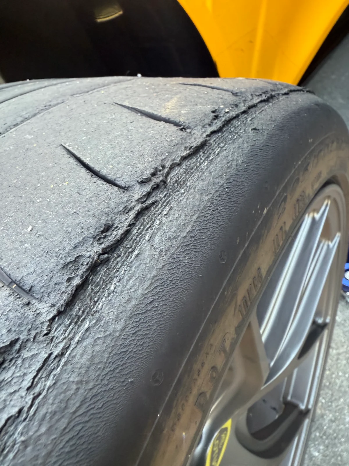

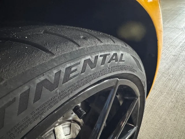

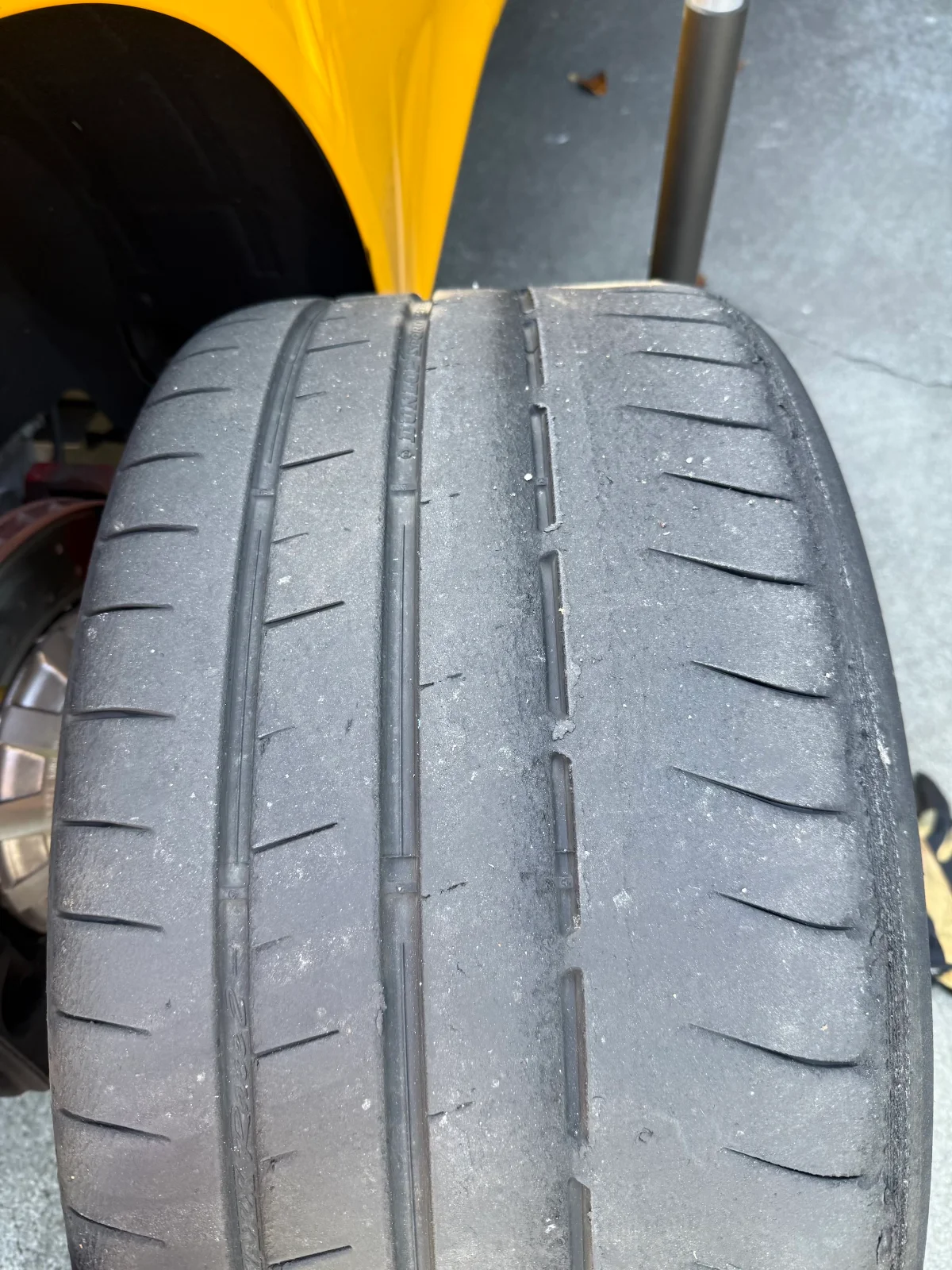

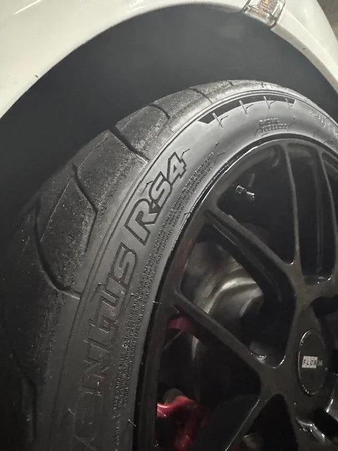

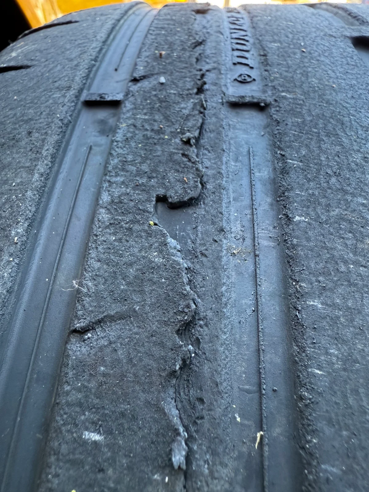

Here are some tire pictures. The Cayman is easy in tires with -1.5 or so camber. I had a shop do an alignment on the Lotus. He said he maxed out the negative camber, but didn;t give me a printout. I htought he said about -1.5 The Lotus is so rough on the sidewalls. The Contis are super forgiving on the sidewalls and still are not happy. Both have a couple track days.

Yeah, I'm not sure why the Emira is so hard on the tires. I see signs of insufficient camber, and signs of overheating. The rear tire is scrubbed off on the outside but plenty of rubber elsewhere. The front tire is losing chunks of thread block.
