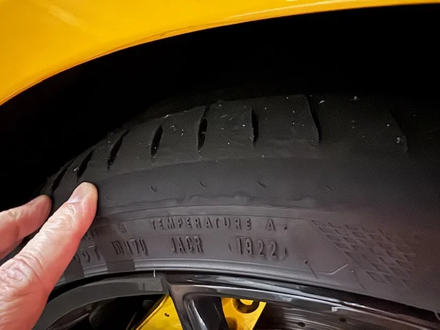

Tire wear is a huge compromise of a lot of factors. If you're still chewing at the edges but don't want to spend the money on hardware, you have a few options - change how you corner, change your tire pressures, and manage temperatures throughout a session.
Would you say more tire pressure to reduce side wear? These are the goodyears.

It does look like your tires were mildly under-inflated, yes.
Interesting. The pro coach wanted them much less than I had them. I start at 26/29. They heat to 35-38. They had them heating to 33-34.

Yes. In lieu of enough camber, tire wall stiffness, and roll stiffness, the two variables you can adjust for free are: tire pressure and your driving. Will you sacrifice lap times and grip? yep, it's all a compromise. Once you start to better understand more cause and effects, I think it begins to make a lot more sense.

Your coach also isn't paying for your consumables/tires. So yes lowering them - to a point - will likely give you some additional grip - but these are street tires, not track tires - so driving the piss out of them will lead to excessive and premature wear.
It looks like they rolled over too much. I set my tire pressures with the help of a probe pyrometer and they rolled over less than yours. i can snap a picture later, as the scrub is still obvious. A pyrometer makes it obvious. Linear temperature gradient on tire = correct pressure. For me, this was very close to 35 PSI hot in all 4 tires. So, you weren't very far off, but you could have driven differently than me, on a different temperature day, etc. At these pressures, my temperatures were in the 160F range in the rear, and 130F range in the front.

Just to clarify, that picture was the OEM GY tires. Those lasted 2.5 days. The Continentals lasted much longer. With much more aggressive driving.

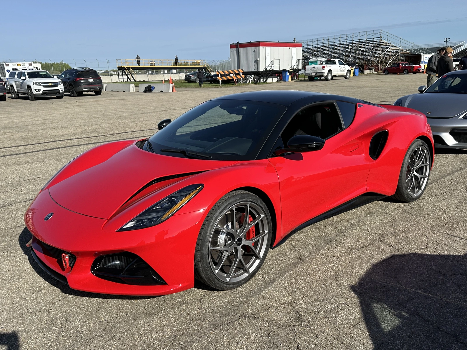

8. Here's a photo, showing it wearing its new shoes (Aerie V2's...saving about 25 lbs...but then I'd added almost 25 lbs of sound absorbing/deadening material...oh well):
