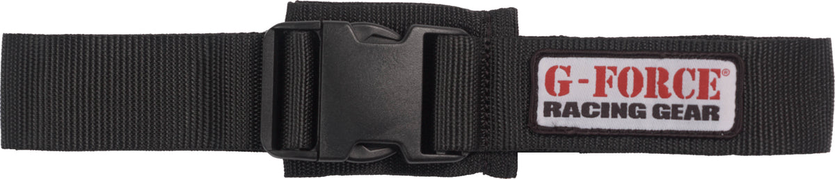

You might try this. It's not elegant, but I've heard it's exceptionally effective. It's literally an adjustable strap that goes behind your seat and around your torso to secure you to the seat.

I had a CG lock in my gear - it was so old the spindle for the tightener rusted apart, so struck out there. Also, the Emira driver's seat doesn't ratchet, so that tight seat belt trick doesn't work. That torso strap looks hilarious - I wonder if it works.

Never heard of these. Kind of reminds me of a different type of restraint...

Mine is a late 2014 build, I4. Takes a few jerks, but it will lock. That and the chest strap mentioned above held me fine. Have many years with harnesses so "fine" means no issues sliding around. It has an oem roll bar and air bags so that's what I am hoping works if I ever need it.

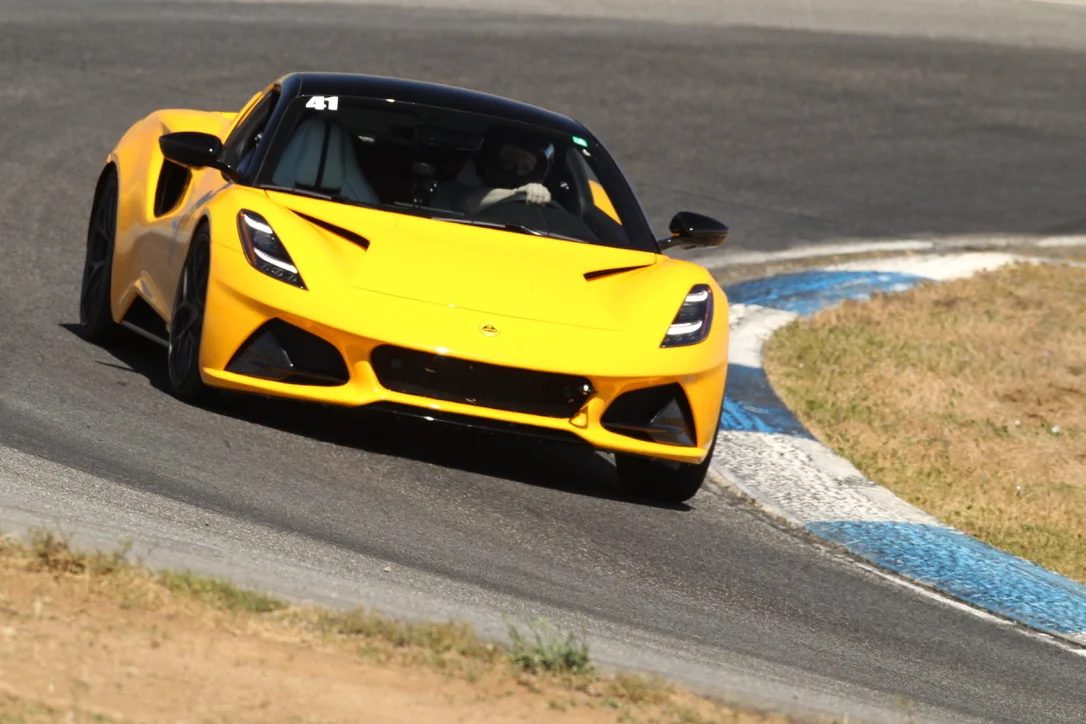

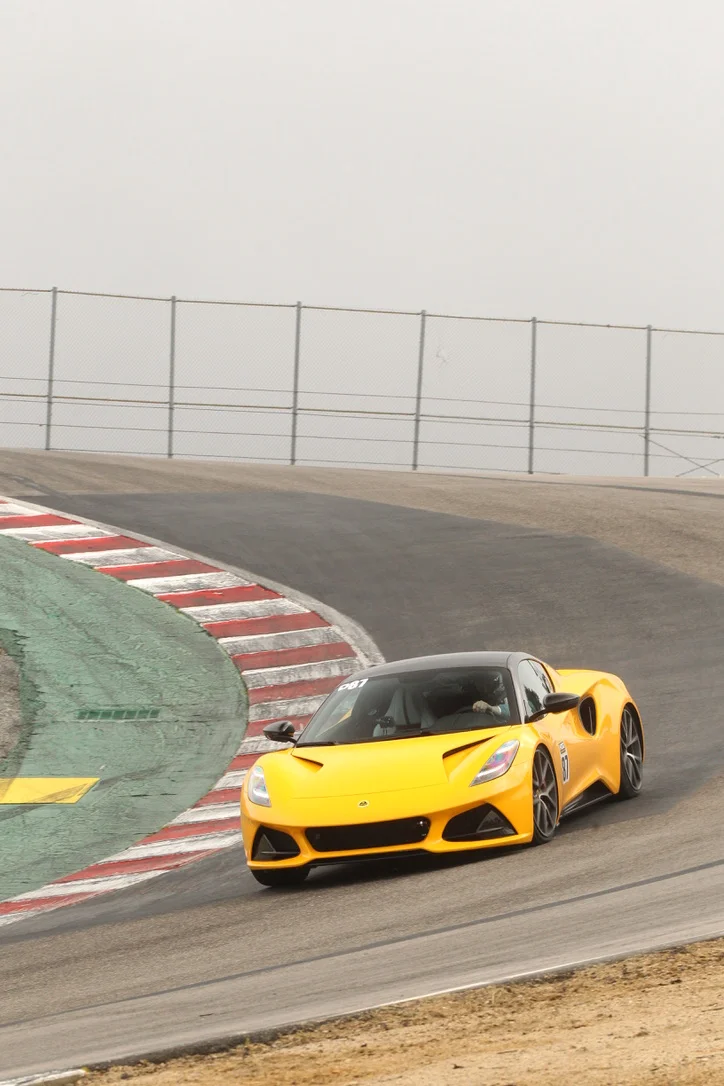

Sadly, I have no video from my first track day, and extremely overexposed, unusable video from my second one, because these Aim Smartycams are a pain in the butt to configure. I still miss the occasional session recording due to strange behaviors.
The car definitely rolled and pitched a bit more with the touring suspension. With the Nitrons, it still leans over, but that's ok, because that's actually more grip than making it totally flat with stiff sway bars.
I found a photo from each track day with the most visible lean. The one on the right, on the softer springs, clearly leans more.

Thanks, understood. I'm fine with pitch/dive/roll - weight transfer is a beautiful thing. Controlled weight transfer though haha. My sport suspension - visually - compresses just as much under load. I'll have to visit Laguna later this year in the Emira. Anyways enjoy your new upgrades!

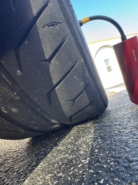

On tires, I burned through the GY stock in 2.5 track days. Cords on the sides showing. I did an alignment to get more camber. Not enough though. Then I went with 200 TW Continentals. I got 9 days from those. I might have had a few more, but I picked up a nail. So Tirerack will pay for one, so I did a new set. I ordered the same. I hear Cup2s are good, but only for 2 days.
I got a quote for a local guy for custom control arms to get more camber. $6500. That's too much for me.

I'll be keen to hear your feedback on the DS1.11 - a pad I would try next as well. Tire wear is a huge compromise of a lot of factors. If you're still chewing at the edges but don't want to spend the money on hardware, you have a few options - change how you corner, change your tire pressures, and manage temperatures throughout a session.

The biggest cost is tires, brakes and maintenance from tracking. I destroyed a set of touring Goodyears in one track day (front right was toast), my PS2 Cups also didn't fare well. These Dunlops I'm using now seem to have 2 track days in them, they're about 1/2 done after one track day, but the 2nd half goes faster than the first half. It costs exponential $$ for each additional second you shave off.
