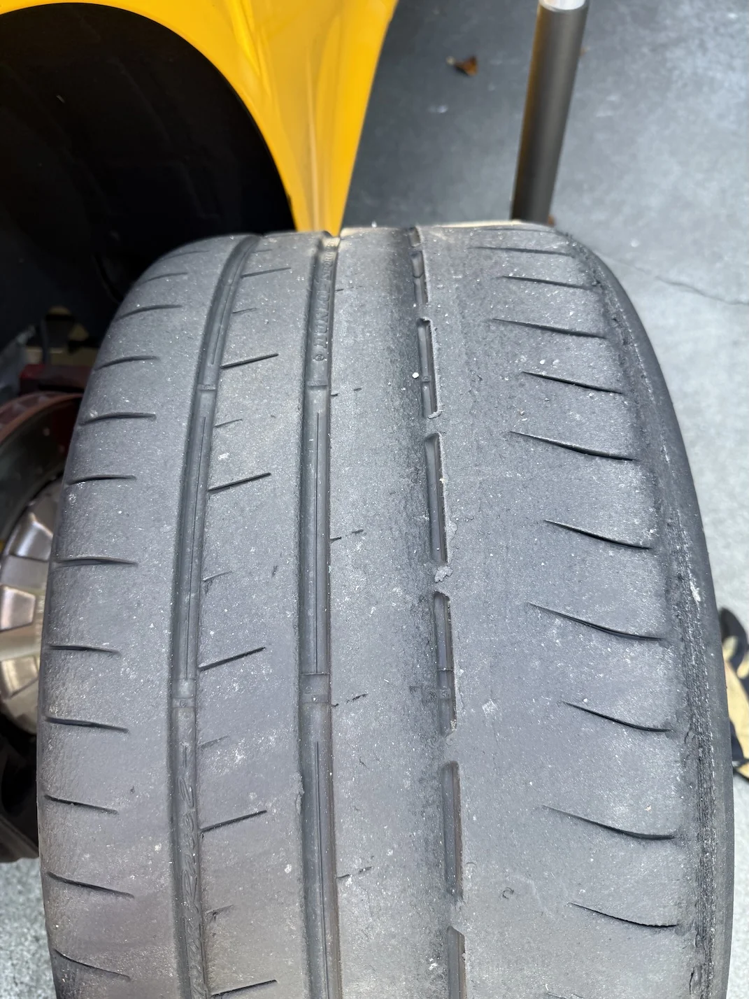

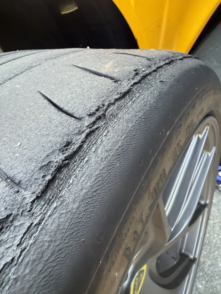

Here's what happened to one set of my tires. This was on the first track day I used them, 5th session of the day (25 minute sessions). The inside of the tire is like new.
View attachment 86890View attachment 86889
This was one of my first track days, with stock touring alignment on stock suspenson. The tires were a little bit under-inflated, from what I can tell.
Since then, I've maxed out camber, but I can't get enough on the OEM steering arms.
It's tire dependent too. PS2's wear better, CR-S even better.
sidewall stiffness plays a huge role here.
Oh, for sure. I think that's what led those tires to wear like that (Dunlop Sport Maxx Race). The CR-S don't destroy their outer edges like that, but I have a much more linear uneven wear, with the inside being hardly touched. I've ordered a set of your A-Arms @mr.suntorytime , and intend to increase negative camber to make it better. I did some ghetto engineering, and carefully measured the thickness difference between inside and out, front and rear, and I think I need about -2.5 degrees front camber and a little less in the rear. Right now, I'm at -1.5F and -2.0R.
Yep, thats close to what i run. Should do the trick for you.

ouch. I maxed out stock camber which has been helpful and generally my tire wear has been quite good (with the exception of last weekend, which I ascribe to 90+ temps on a track with a brutally long right hander that chews up tires). How has your tire wear been since maxing out stock? I think I got front -1.3, -1.5, rears -2.2
It's been much better since I maxed out stock, but I push the car hard, and the dynamic camber loss just kills tires. My car is slightly lowered due to Nitrons, so the max camber available is a tiny bit different due to the ride height change. With Nitrons, you have to lower the car by at least 10mm, so I lowered it as little as possible. I got 1 track day off the original super sports, mainly by destroying the fronts. Then I got 2 track days off the LTS PS Cup2's with max stock camber, and the 10mm drop due to Nitrons. It looks like the CR-S will be good for 3 track days, no more. Once the new A-arms arrive, I'm hoping for 4 track days. We'll see.
Just switched out my front tires and the inside on the right was more worn (the very long right handed is banked so apparently the right takes it on the inside of the tire)
