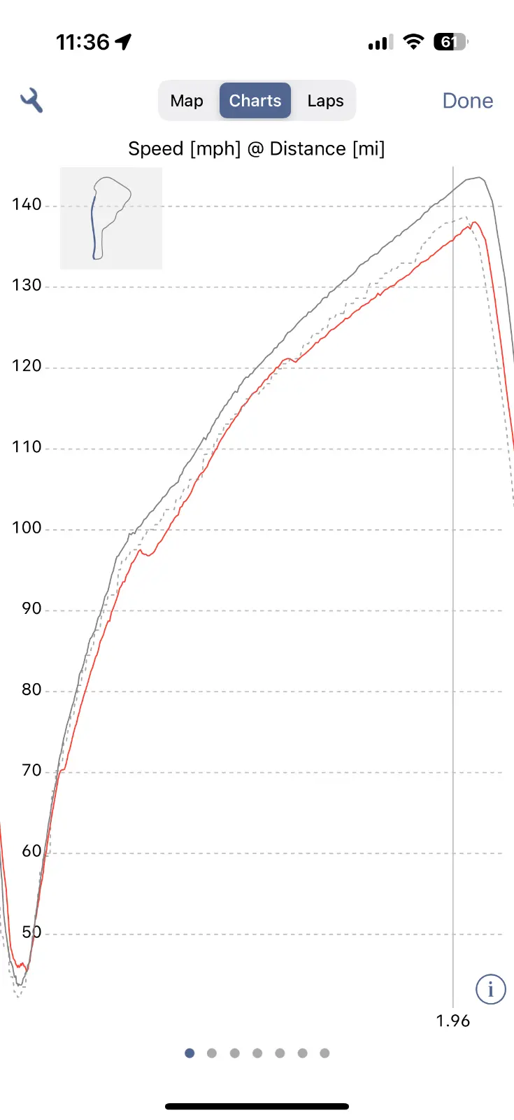

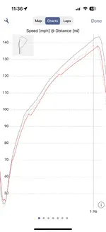

The engine and gearbox are legit. I've attached a plot of acceleration on the back straight compared to the Cayman. Y'all can poo-poo the IPS automatic but it's lightning quick in track mode (see the dips where I'm shifting the Cayman) and almost always got the right gear. It felt better on the track than it does on the street. Only issue was occasionally in turn 5 it would stay in 4th instead of dropping to 3rd. Engine stayed strong throughout the warm afternoon, whereas the Cayman would start to lose power as it got hot out, even with a 3rd radiator.

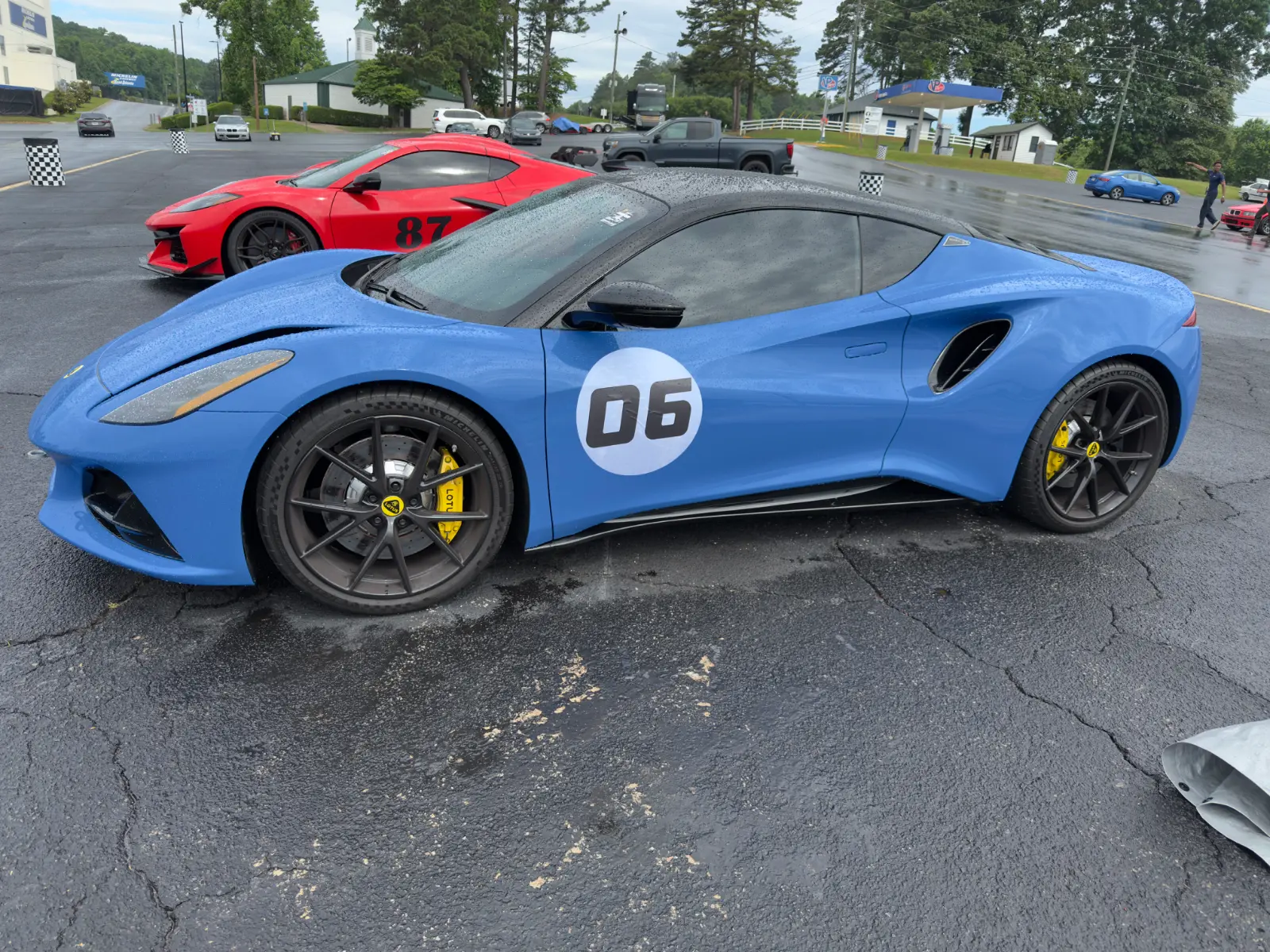

Even at the track, the Emira gets way more attention than any Porsche and it looks great with a number on it!

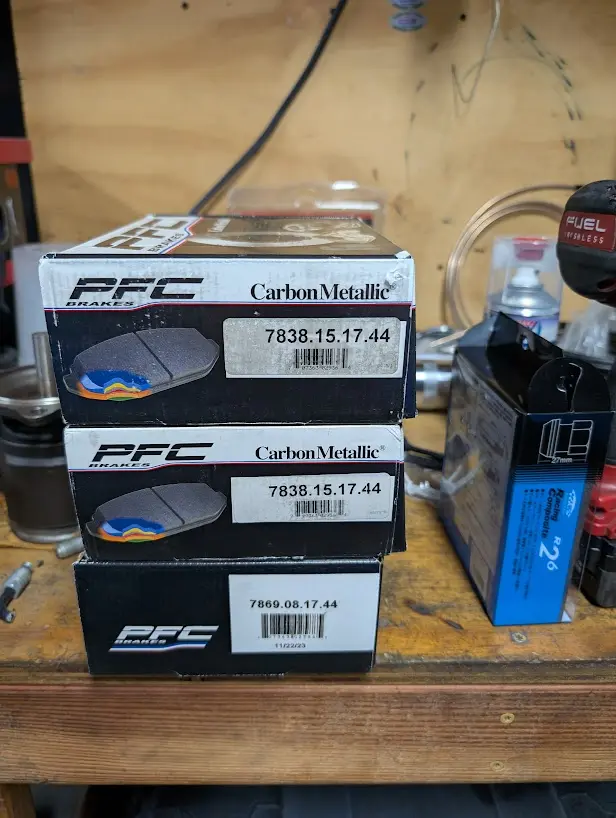

Have you ever tried PFC pads before? If you haven't and you're looking for something different, I'd recommend you try a set. They aren't cheap, but very good characteristics all around.
While I agree that the Emira brakes are overboosted, I'm able to modulate the brakes to my liking. Naturally it was not like that in the beginning, I needed some time to get acquitanted with it. But now both street (with different pad) and track, I can threshold, release, and modulate to my liking.
I've had great success with PFC pads on other platforms and tried the 15 compound in the front and 08 in the rear for this car, for track work only.

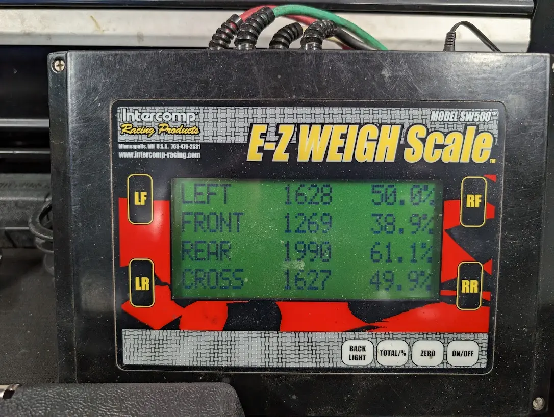

The comparison of the Cayman comes up often, but the Emiras 39/61 weight distribution mimics a 911 much more than a Caymans 46/54 distribution.

I source PFC pads from the folks at SpeedFreaks. Great service/support and good pricing. If you have questions about which compounds to try, give their team a shout and they'll steer you in the right direction.

This is what my V6 touring with a full tank of fuel and no driver looks like. OEM config aside from 3rd cat del and tools removed.

Yeah, the previous discussion of pads is what made me try the PFCs, which I got from Discoveryparts. I picked the 08's based on their lower Mu.

Thanks. This is fully 911 weight balance.
Except that the 911 has more weight behind the rear axle making it rear engined. Positioning weight ahead of the rear axle is a critical distinction of mid engined cars.
Right on, I mentioned this in another thread. It's not just blanket weight distribution split by the middle of the car. It's also about the front and rear weight's proximity to the center location. The more weight you have closer to the car center's proximity and closer to the ground, the better. This is why the 911 is a very different handling car despite having an overall similar weight distribution (it's rear weight even though the same percentage, is further away from the center).
Weight placement/location matters even within Front/Rear distribution.
Totally understood on the theory and not judging in a vacuum based on one factor, but I cannot ignore what I've observed between driving Cayman, 911 and Emira when they exceed their grip limits - as subjective as that might be. I'd keep a more open mind in either direction as a benefit for driver skill development.
