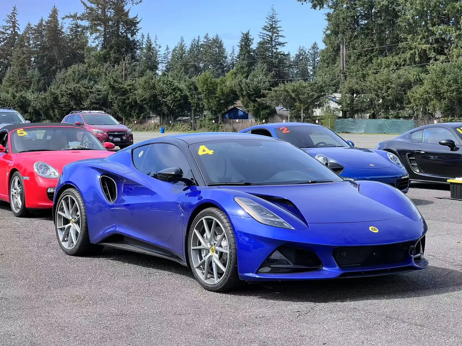

I'll add a few more data points here. My car is the 6MT with touring suspension.
Some observations.
- OEM fluid can't handle the heat of track duty, even when it's fresh. I got soft pedal on 1 day old fluid from dealer.
- EBC SR-11 brake pads have too much friction for street tires, they're meant for slicks. Totally undriveable on the street.
- EBC RP-1 worked great together with Sport Cup 2's (LTS spec).
- Touring suspension is way too soft, I've got Nitrons coming, will track them a couple of times then report back.
- I've tracked the OEM SuperSports, the OEM PS Cup 2's, and now I'll be trying Dunlop Sport MAXX Race (80 treadwear tire). The SuperSports overheat in ~5 laps at laguna seca. Cup 2's were much better, lasted 25 minute session. Both feel very similar, but Cup 2's are a tiny bit more grippy. Other than heat management, surprisingly little difference. The dunlops will be for my next track day. I have a set of GRP forged monoblock wheels now.
Surprised that there isn't much difference between SS and Cup2. I was contemplating switching from SS to AD09 (a lot cheaper than Cup2) or SportContact 7 to keep some street drivability in the wet and longer life.
The huge difference between SS and Cup2 was heat tolerance. I bet the SS is better in the cold too, but it doesn't get cold where I live.

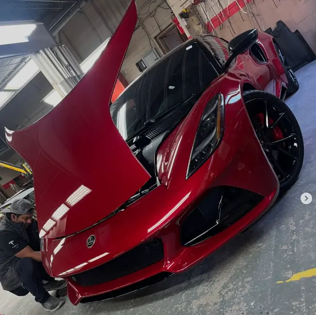

Just took my Emira to the track first time yesterday. Here are some of my impressions so far:
- The car drives super well on track. As a track novice I did not push it too hard. Very balanced chassis overall. It did tend to understeer but not too bad.
- I tried both Sport and Track mode. The TC did not kick in. Rear end was very stable compared to my previous GR Supra.
- Cup 2 tires provided excellent grip, and they did not overheat during my sessions.
- I changed the brake fluid, so it was holding up well. The brake was strong for the first few laps, but the OEM pads started to fade after that.
- The manual gear box was a bit hard to work with on track. I had GRP short shifter installed. It made the 2-3 shift smoother but also more difficult to tell which gear it's going into.
- I also experienced the power cutoff when I hit the rev limiter as I didn't want to upshift in the middle of a corner. It was like hitting the brakes. I wished there could be a few more hundreds of RPMs to play with.
- The car sounds great on track. I had GRP intake filter, 3rd cat delete and VC all open. Personally, I think it sounds better than GTS4.0 (also on track).
- The seat is worst part. It was fine on the streets, but it barely provided any bolstering on track. I struggled to keep my body up in corners.
1 more month until track day at New jersey motorsports park on 5/18. Anyone joining me?

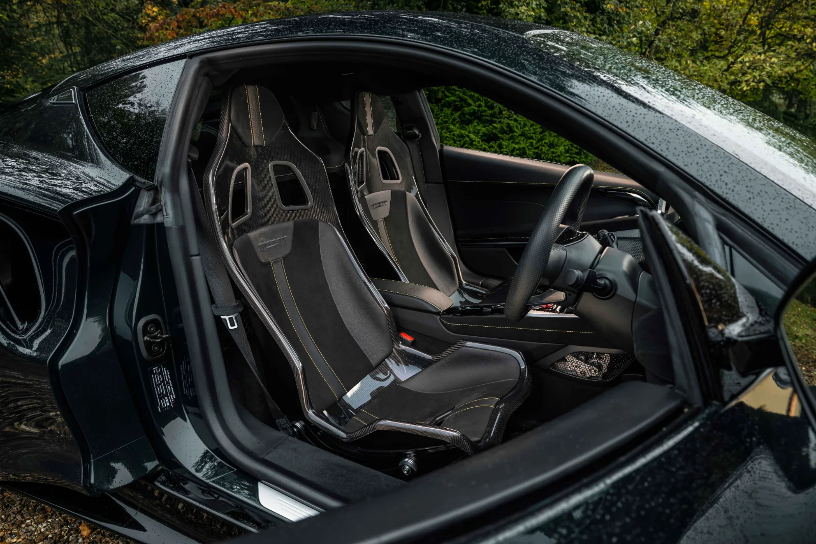

Why don't you consider using our B10XL Emira styled seats. You would be solid in the car, up to 4 inches lower and the car would be 30 kg lighter if both seats are changed. There is zero comfort compromise. They are more comfortable on long journeys.

It is on my list, but I prefer seats that kept the reclining feature for easier access to the storage space behind. I don't track my Emira very often so still would like to keep the daily drivability as much as possible. But either way I will need to try them first.
I have had my seats in the Emira for two years, I pull one seat forward and put the bag through the middle. The problem with all the functions is they all add weight and with the split seat it compromises the shape, especially around the lower back. I have been racking my brain on how to do it without ending up back where the OEM seats are.

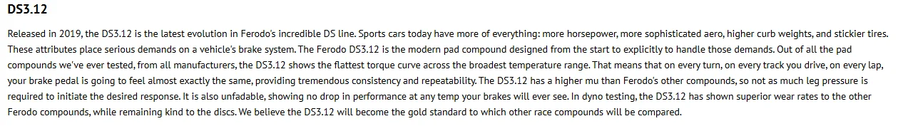

Has anyone used these race pads and what do you think of them?

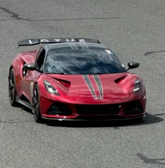

I guess I'll start this TRACK TALK!
Phase I mods:
GRP exhaust for sound, weight loss & extra power
Milltek valve controller because I like it loud all the time
Rotora H6 pads until I get upgraded rotors and pads
Castrol SRF brake fluid is a must for everyone tracking
Antigravity 40Ah battery for weight loss
JUBU carbon front splitter for downforce
JUBU carbon engine lid louvre to replace rear glass to save weight and decrease engine heat
JUBU carbon swan neck 5 way adjustable for downforce
Carbon canards for downforce
GRP third cat pipe for sound and power
Eventuri air intake for sound and power
GRP harness bar with 4 point seat belt harness
Full XPEL fusion PPF and ceramic coating on calipers and wheels for insurance
GRP Carbon steering wheel with JC werks madtrace clubsport magnetic paddle shifters
Running the sports suspension with the Cup 2s until I run the tires and rotors into the ground for Phase II
I'll probably end up throwing in some Tillets or Nogaros, but are you still running with the factory seats and a harness? How is that working for you?
